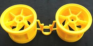

2.2 truck tires are pretty common, a bit of ca should be able to stick modern 2.2 tires to them fairly easily. Blackfoot extreme wheels appear to be hex drive instead of funky 5 tube of the og.
- Attachments
- blackfoot extreme.jpg (9.79 KiB) Viewed 1107 times

Those look promising. Right type of offset and even a period correct look. I'll order a set up and report back after the results. I think those in combination with these we may have a cheap modern option.

Yeah, we strayed off course. I was looking for a cheap modern 12mm hex type wheel that may have close to JRXT offset. We may have something in these Blackfoot Extreme wheels, combined with the adapters I posted. Also nice these Blackfoot wheels have an 80's look about them and colorful.
As to tires, yes plenty, I was just pointing out something like original width Blackfoot wheels would not work with modern tires. Visually these Blackfoot extreme wheels look like a standard 2.2 truck wheel.
