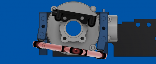

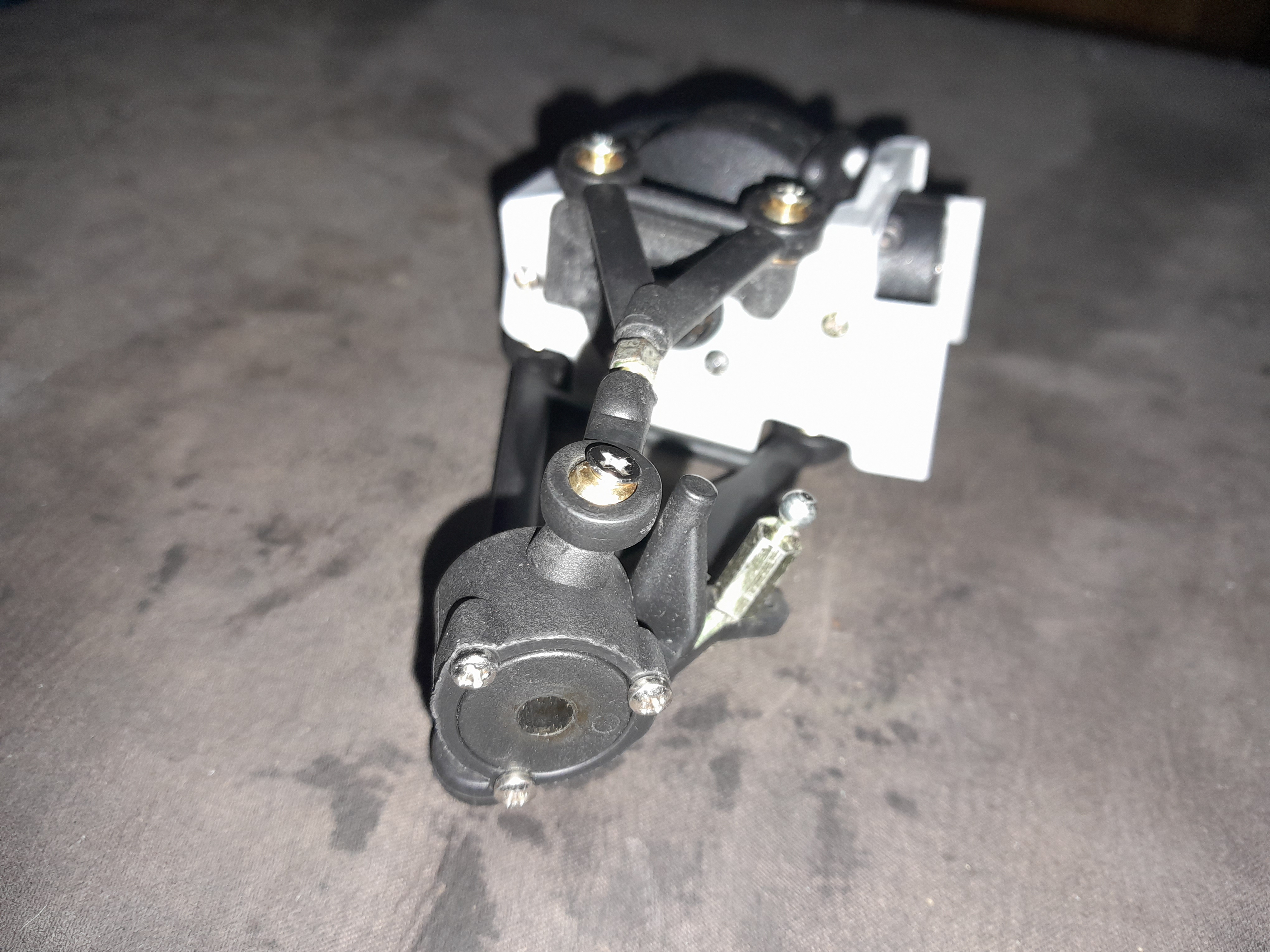

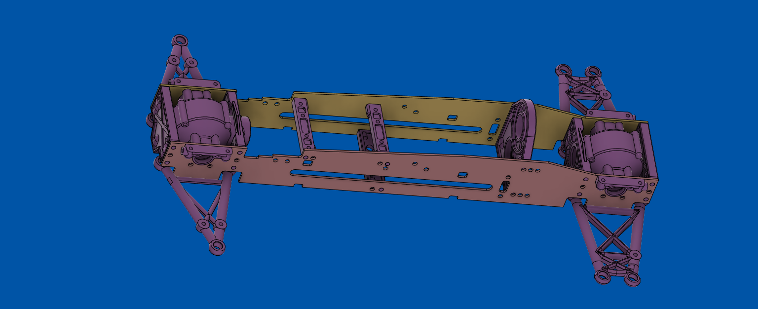

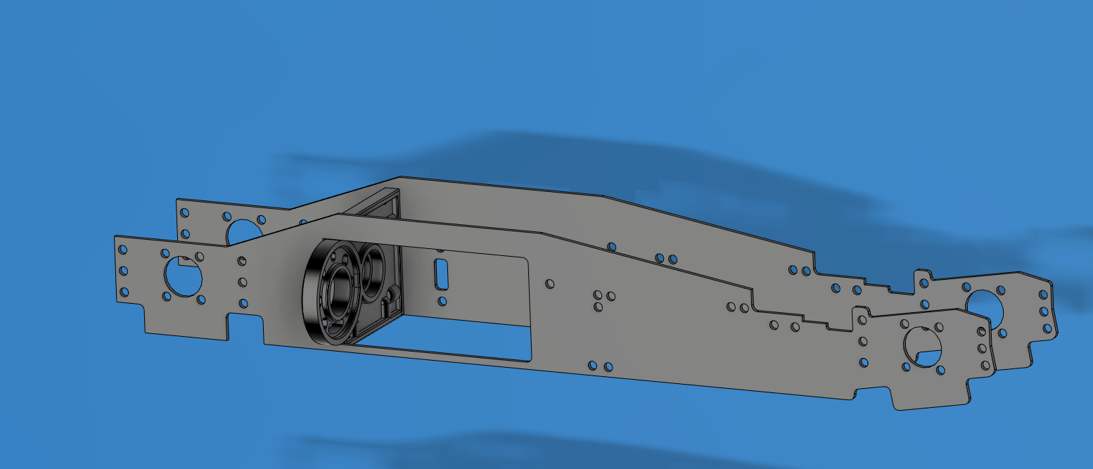

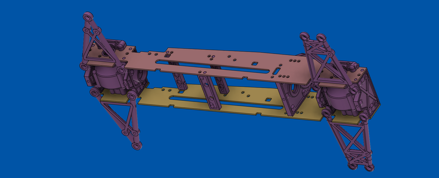

Been thinking of this for a while. I've got a fair pile of Coyote transmission parts and I've already CAD modeled the Tag Pro10 suspension but I want to take it a little further, I'm planning on changing around the front suspension to give the arms a 15 degree angle and doing something else with the chassis to maybe lower the COG and give more battery options.
Anyway, I wanted to start with a proper CAD model of the stock chassis so I could be sure of the fit for the trans.

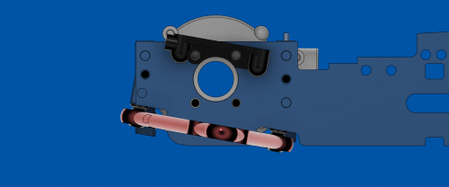

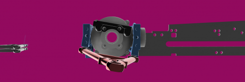

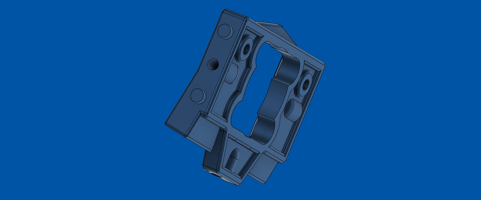

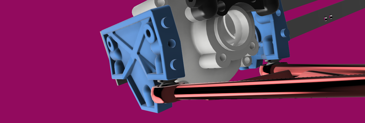

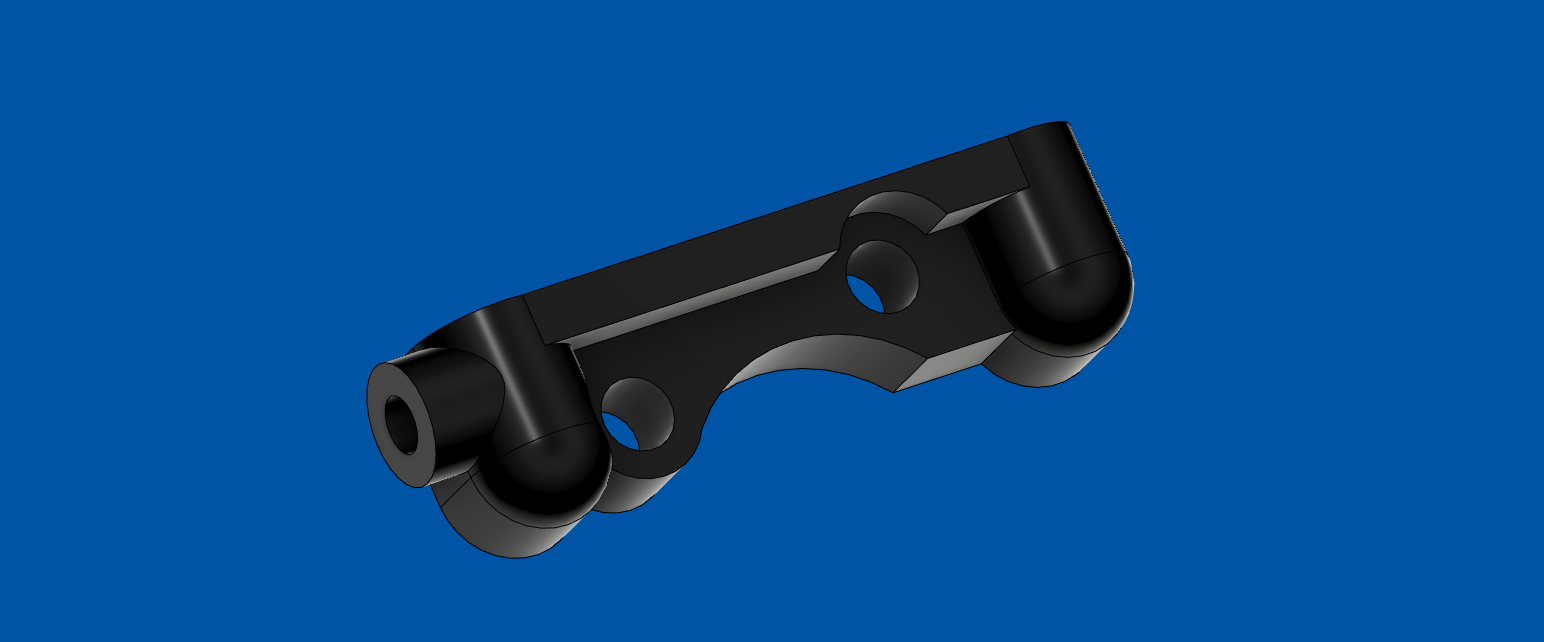

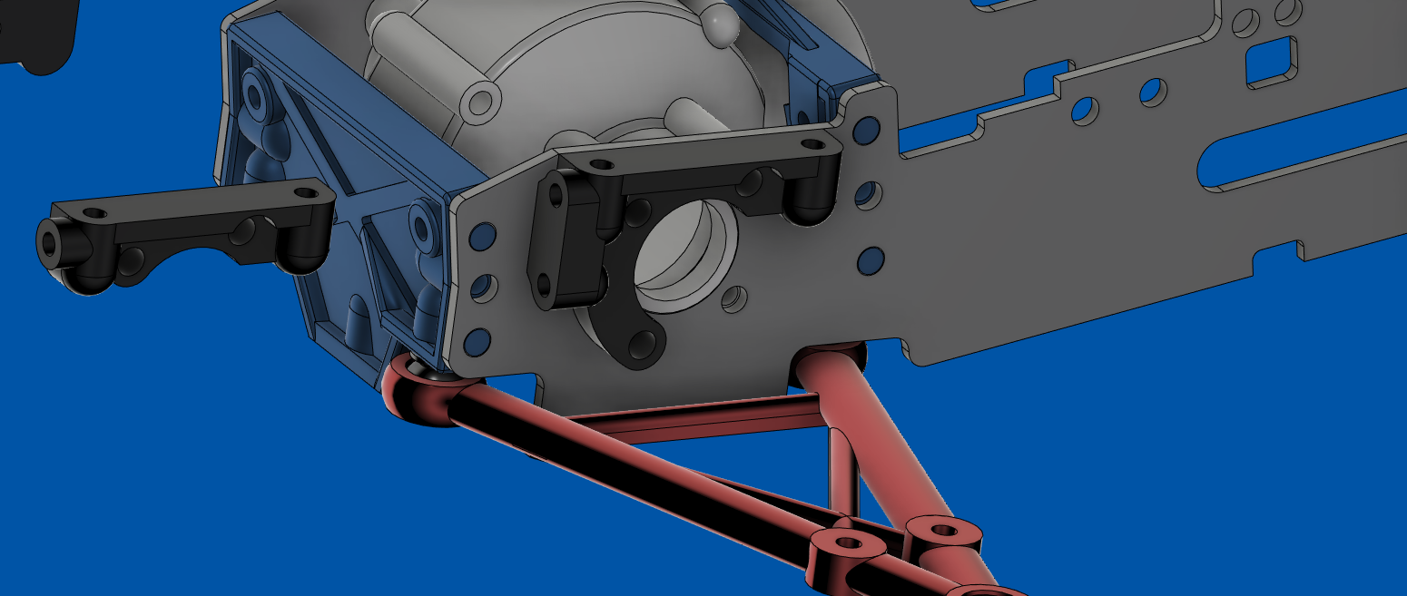

This has been waiting on my having two minutes for a while now but this is the next step , this adds 10 degrees kick to the front arms , its about as far as you can go while retaining some DNA , what I've done is modify the front bulkhead , the bulkhead behind the diff pumpkin and the top arm mount so the arms mount ten degrees rotated around the diff outdrive .
The chassis will need minor modification for the front bulkhead fittings and of course its bottom profile , in the last shot you can see how much of the chassis plate needs adapting as its pictured with an early style chassis mounted the other side of the diff , the diff position is unchanged so the transmission needs no modification . I've just noticed the front bulkhead needs further work to move the under guard screw mount up .

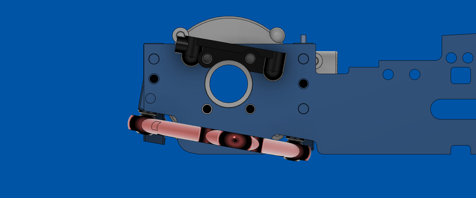

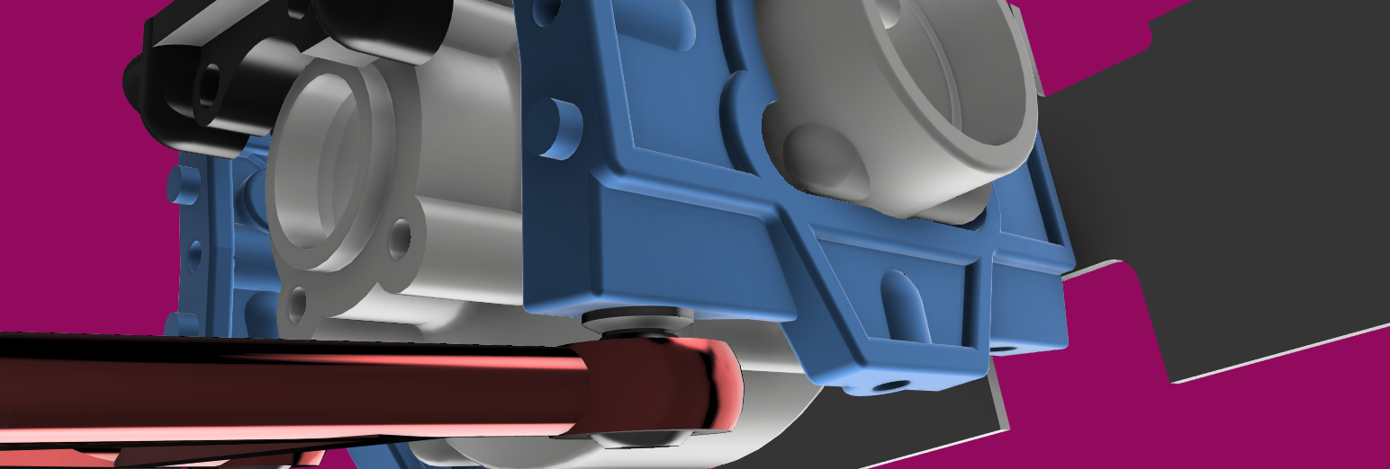

It's a bit of a challenge , I've just sorted most of it but it will need a guard under the rear screws for the bottom arms as they will be a lowest point , that's unavoidable though .
Mr. ED
Posts: 5483
Has thanked: 62 times
Been thanked: 62 times
Re: Coyote Rethink
Post by Mr. ED »
maybe incorporate the guard into a new bumper: tamiya did this often

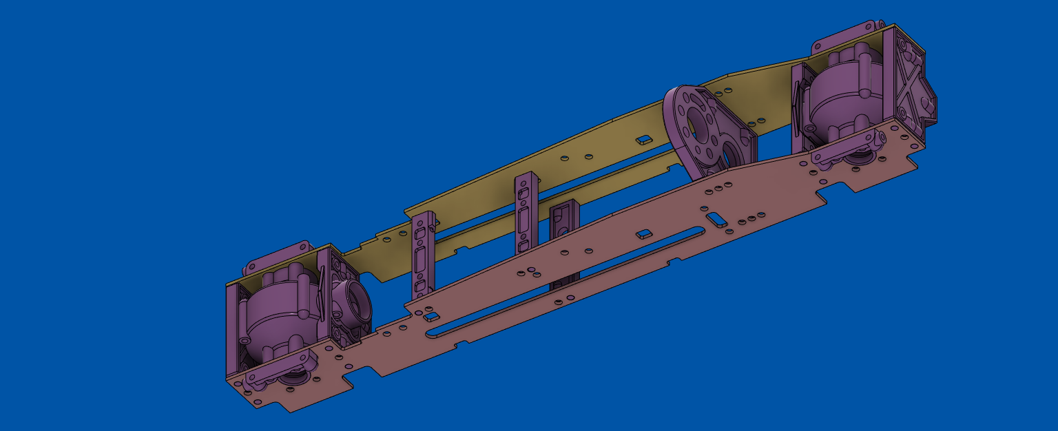

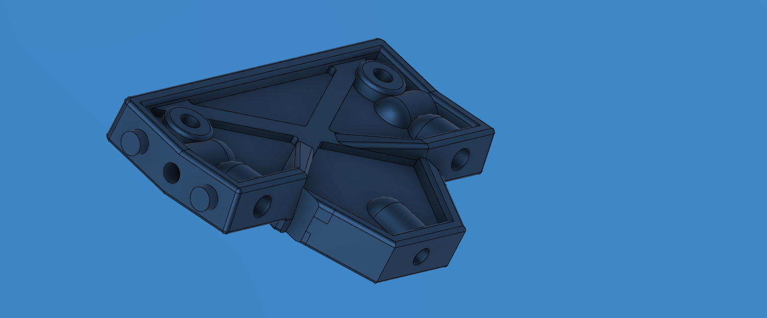

A little chassis rectification to fit the suspension mods and the top arm/shock mount modified to be able to mount a shock tower .
Ultimately the chassis may look very different as I'm thinking of moving the motor to one side , the battery to the other and using a mostly two deck chassis , upper and lower in a more modern way possibly with just vestiges of the stock left ,right chassis plates . Not sure yet as that may change the DNA too much for my liking .

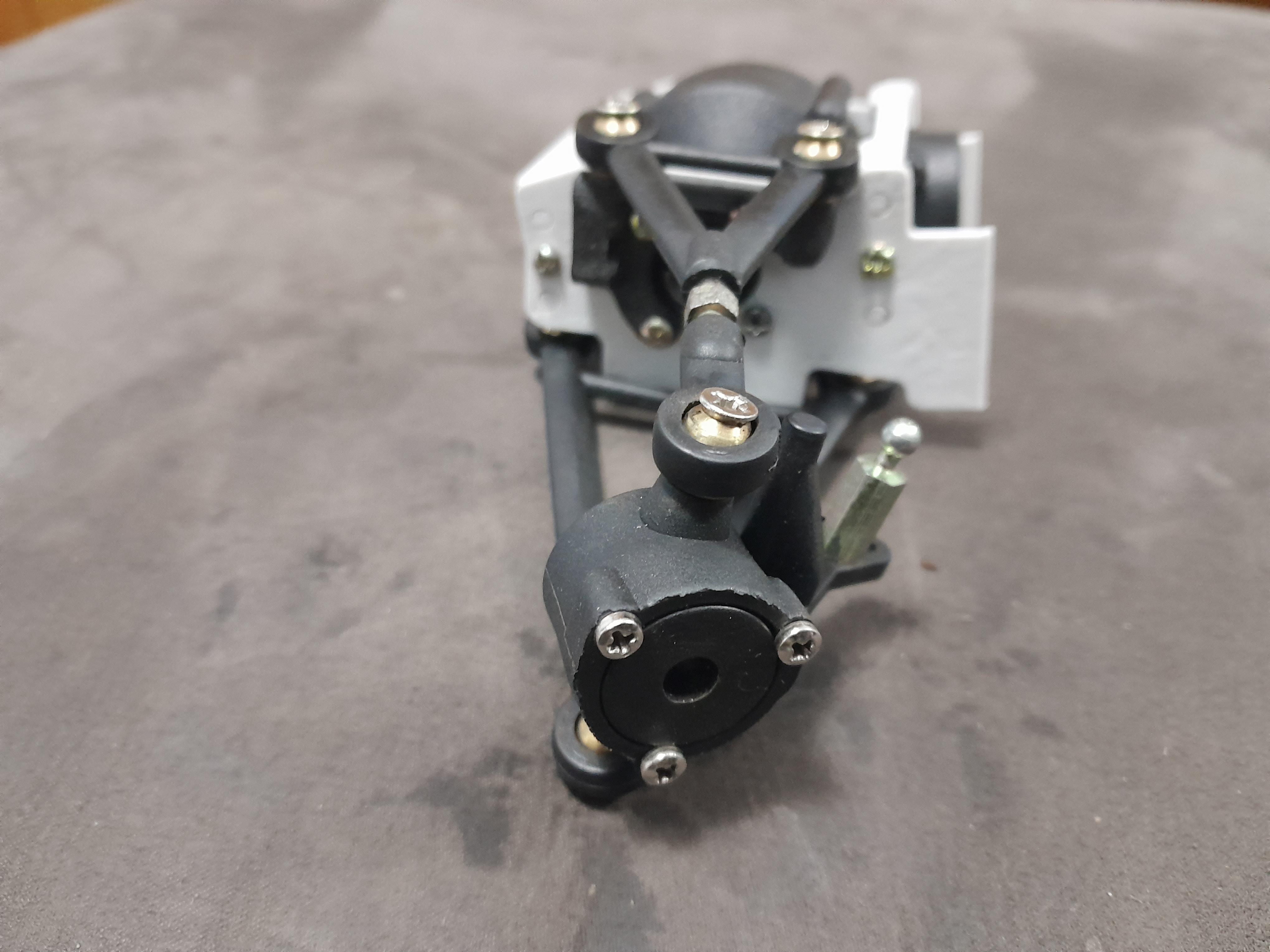

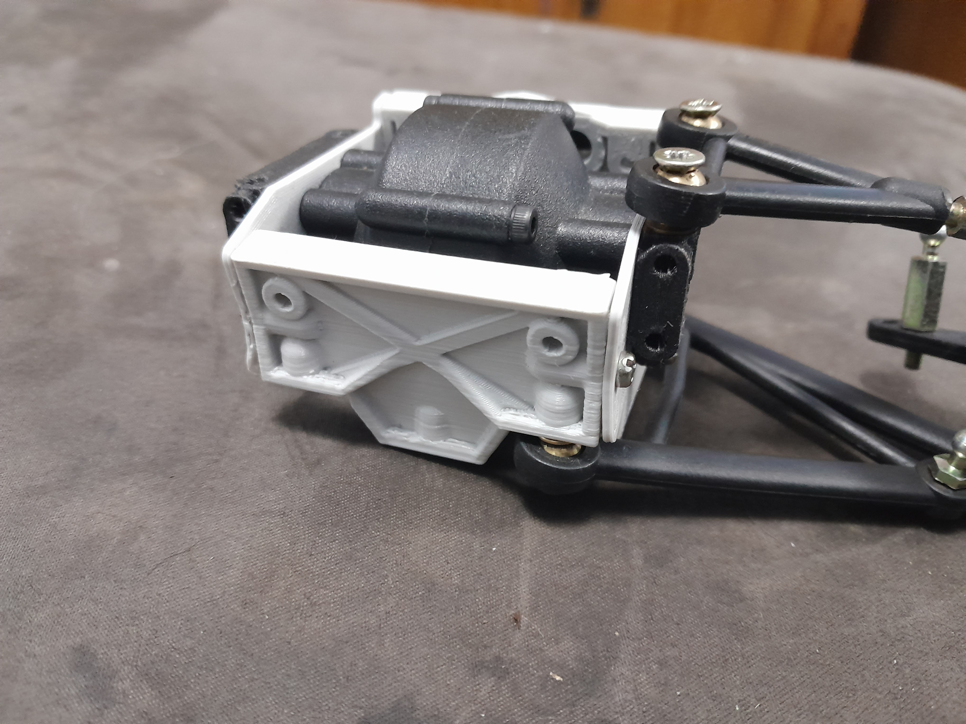

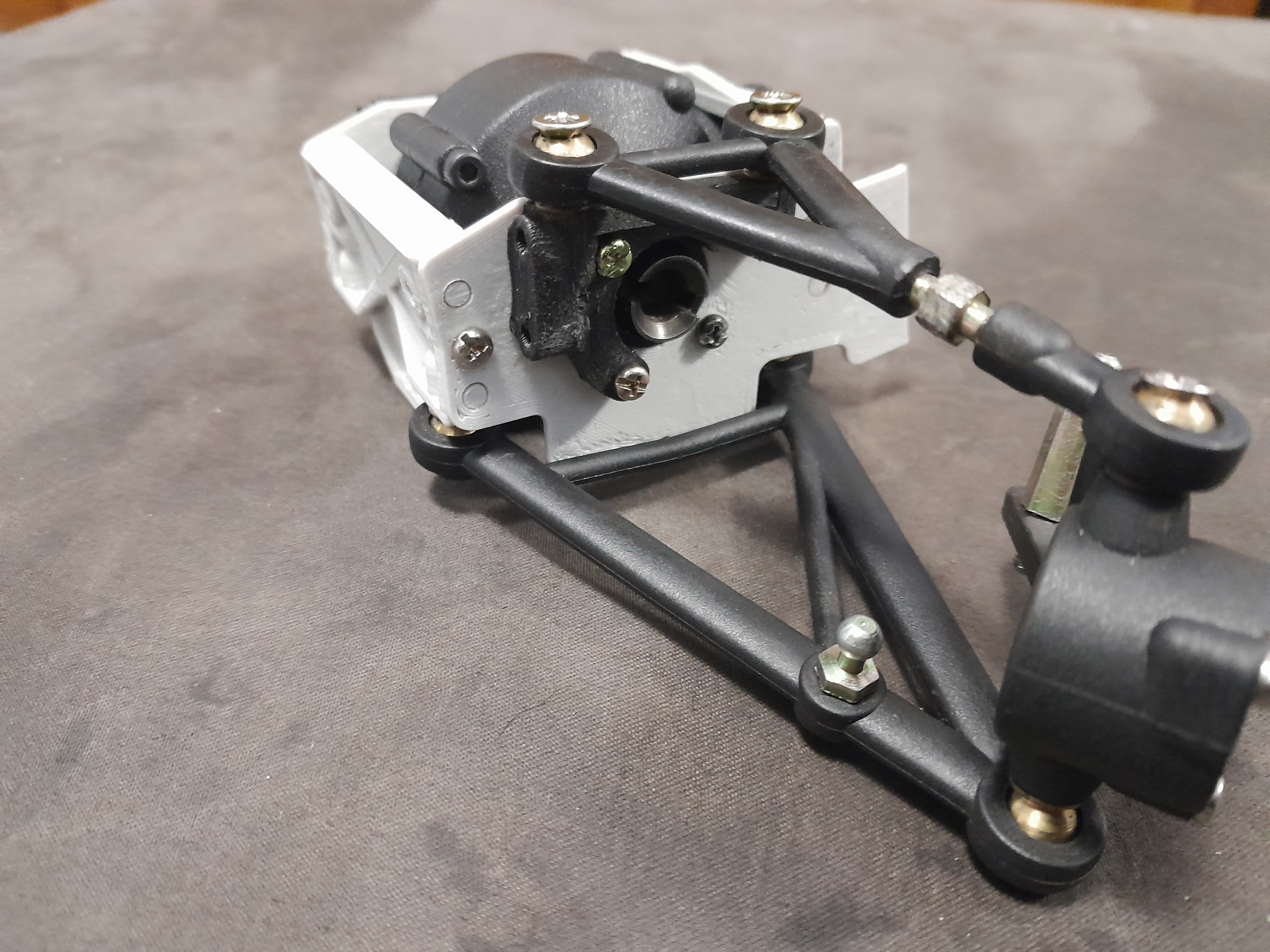

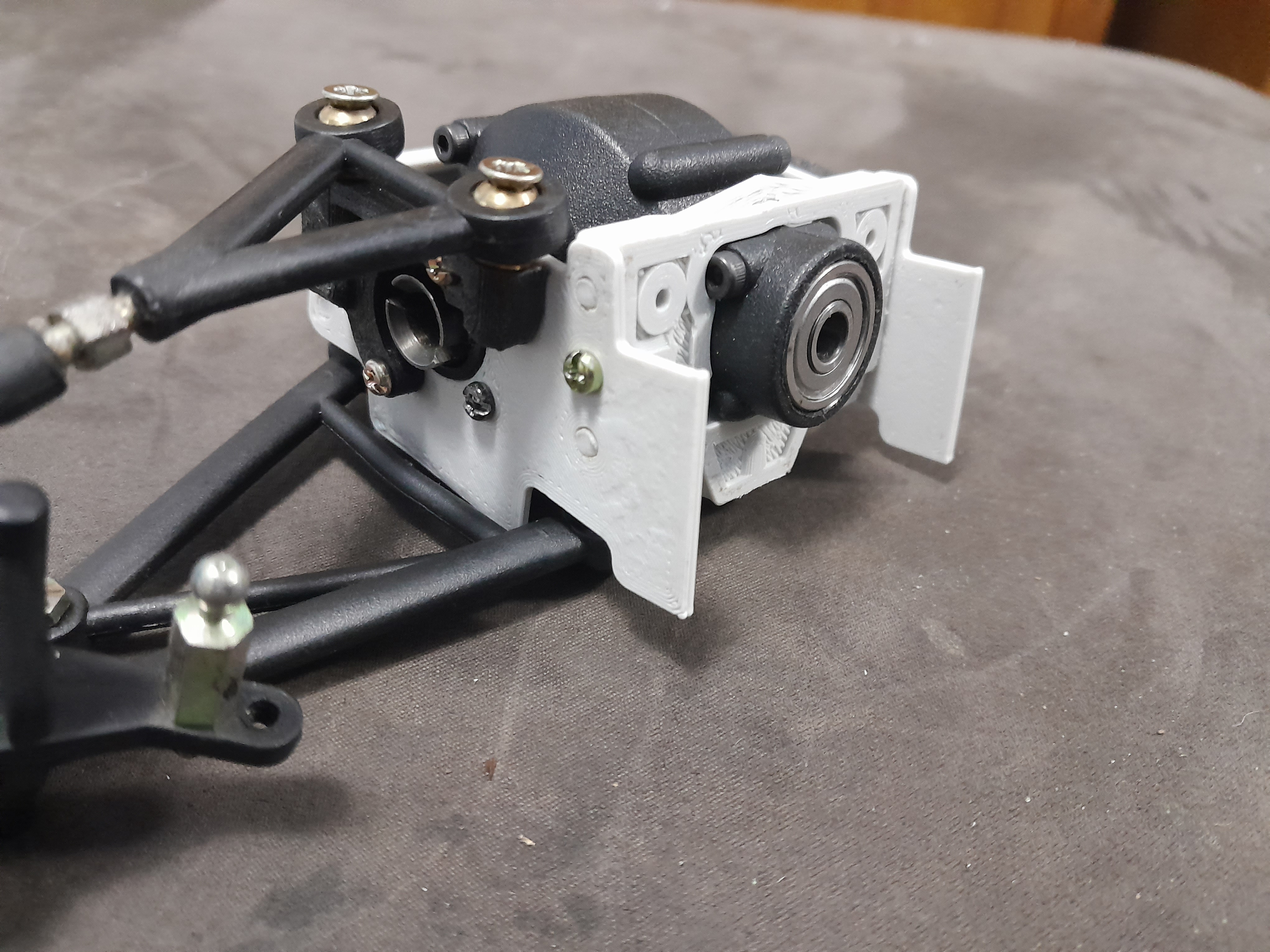

Test print of parts , the chassis plate is only the front section and the cut is a vertical cut so you can use it as reference.
