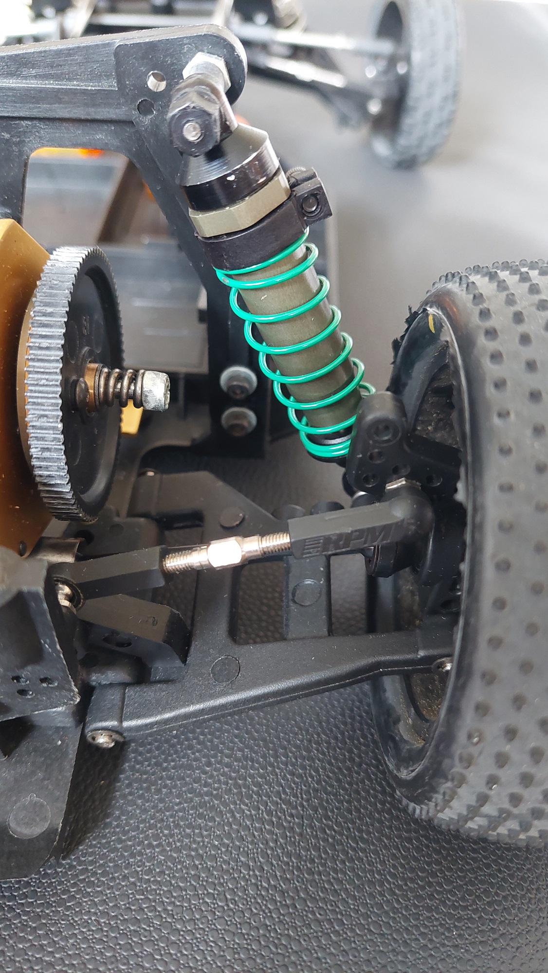

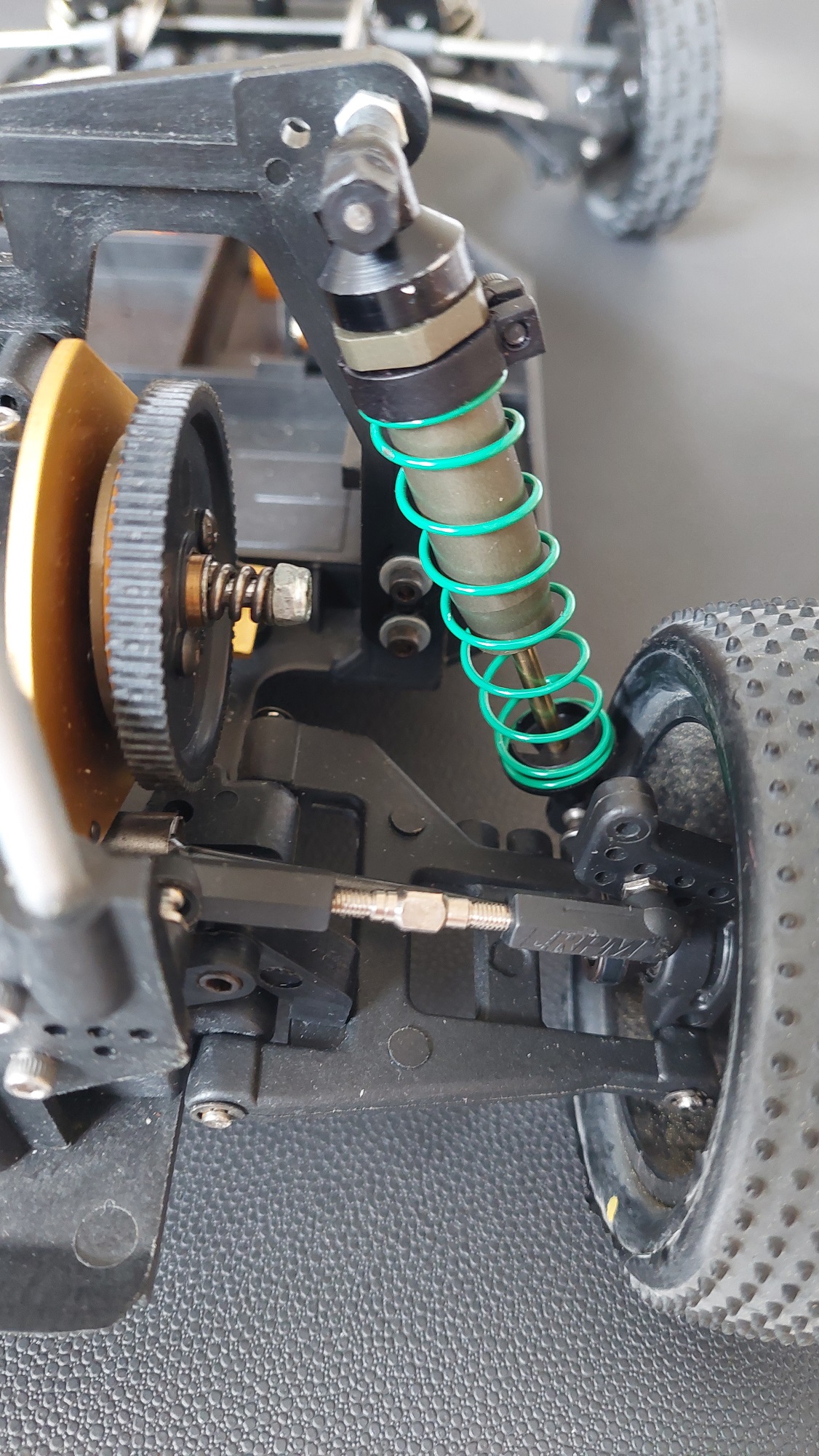

I'm running 1.02 shafts in 1.32's. Down stops depending on track, currently 1 mm. Low profile spring retainer.
I think this is fine running 2.2 wheels. Pictures on top and full compression.

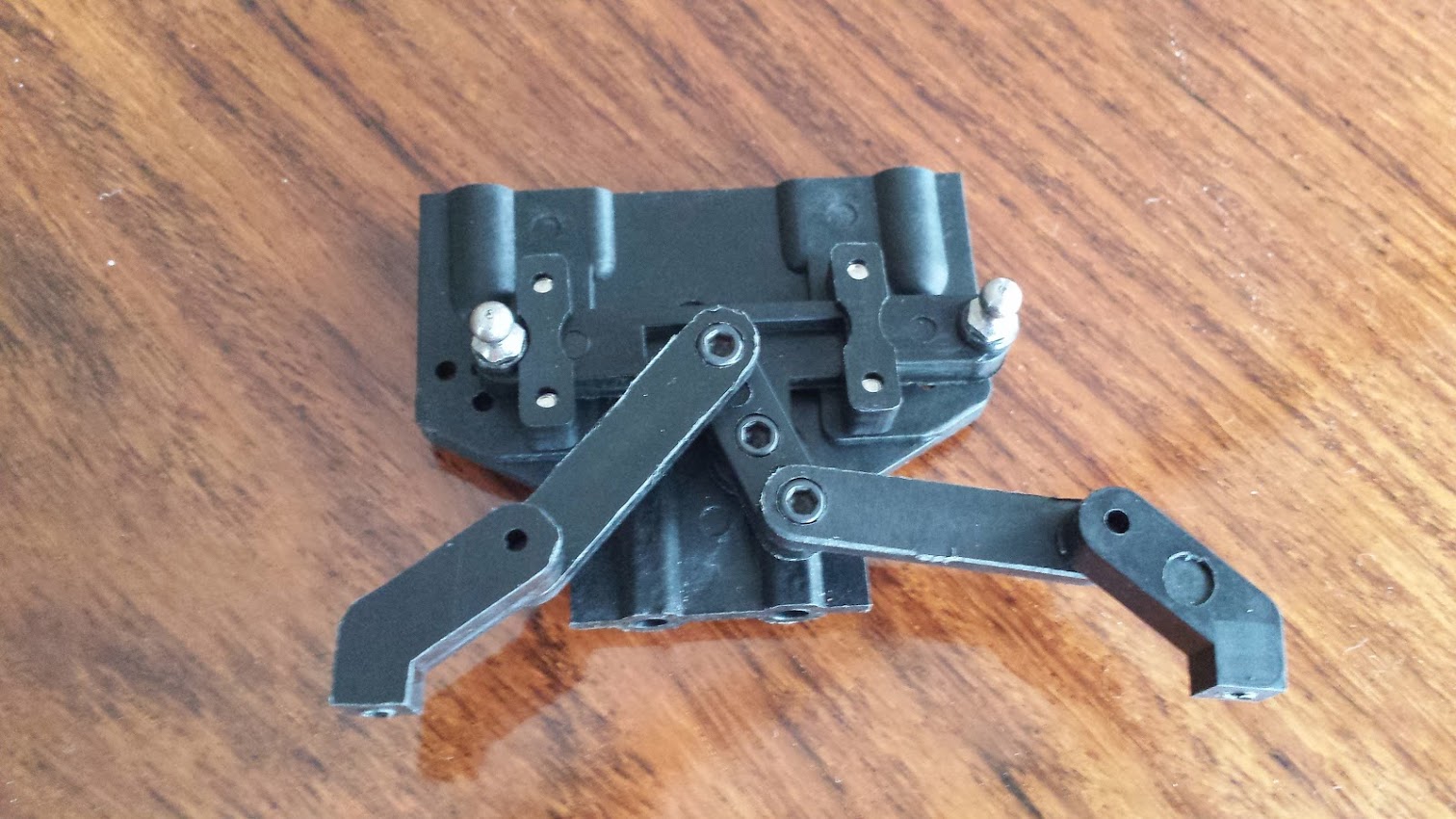

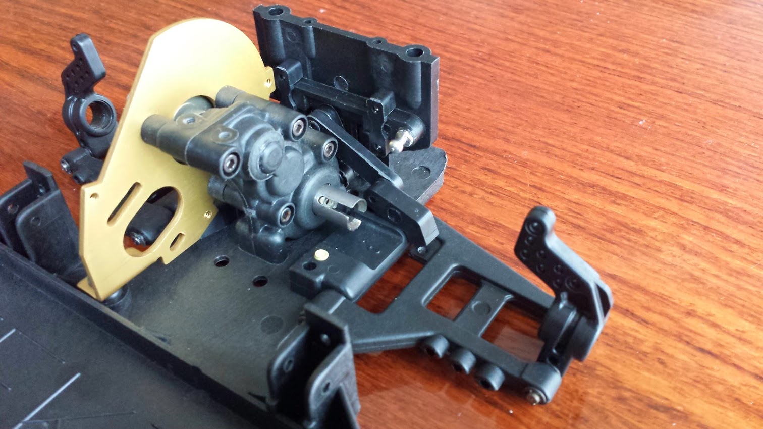

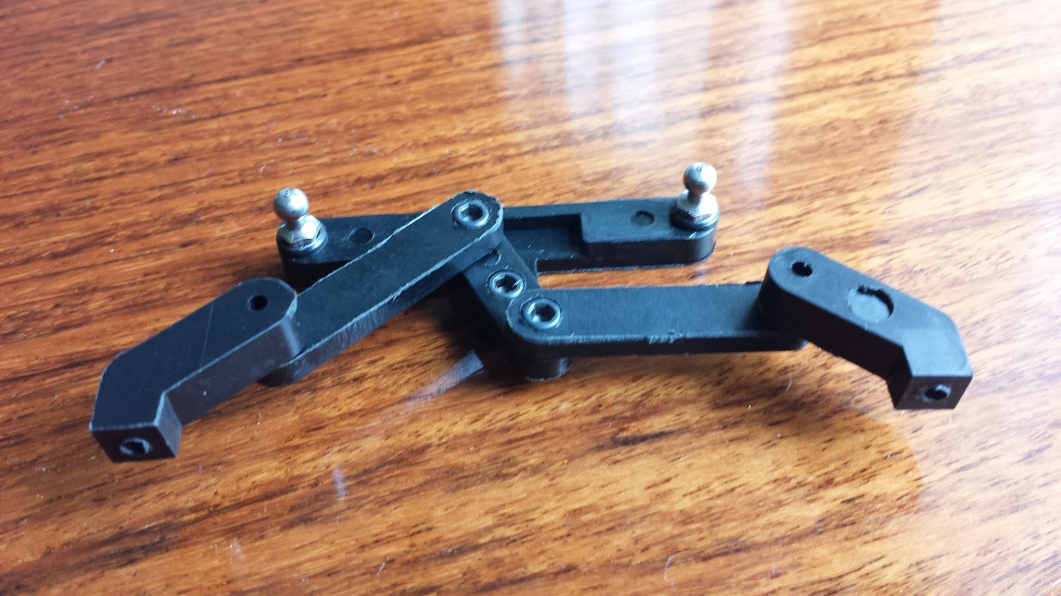

There is a watts link sort of deal in front of the trans. There are arms that go from that to the a-arms. Then it's attached to a bar on the topside that the camber rods are attached to.
If using the proper 2038 losi hubs, you can roll the chassis left to right and the rear camber will not change. The tires stay perfectly planted, straight up and down.

I had some pictures from when I built mine. Think they illustrate the principle. Setup with the Losi 2038 hubs and 0 degree arm mounts.
