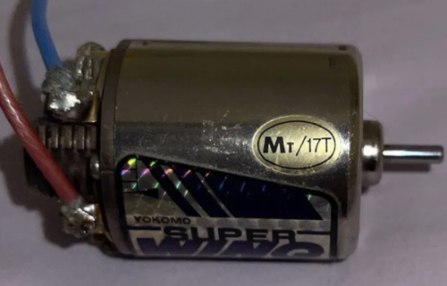

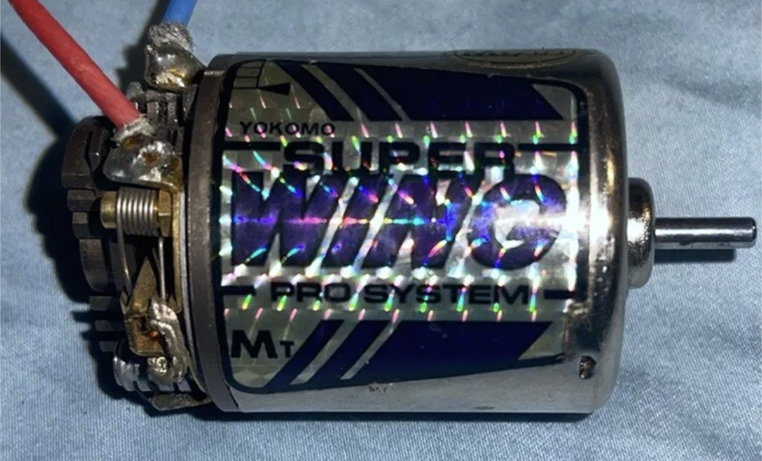

Yokomo SuperWing Pro System:
MT is 17T
RF is 18T
MT is 17T
RF is 18T

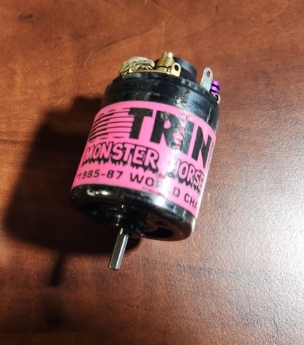

Here's a pink label Trinity Monster Horsepower 1985-87 World Champions motor I tested out today. Motor has some gahones, 38,000+ rpm at 7.2 volts.
I don't see any Trinity Monster Horsepower motors listed in the reference guide. If anyone has info/specs on these motors please share.

Very cool! That's one of these: Monster 1700 Power Series
They came with a small paper sticker dot with a letter on it to identify which motor they are. Most have lost the dot.

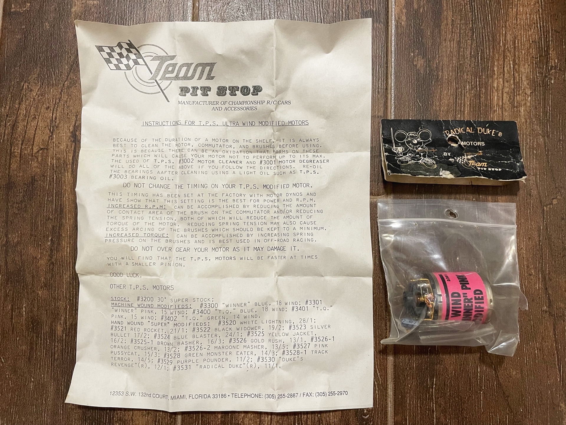

Lowgear, when you have time there’s nearly 2 dozen Team Pit Stop motors listed at the bottom of the instructions that your could add to your guide.

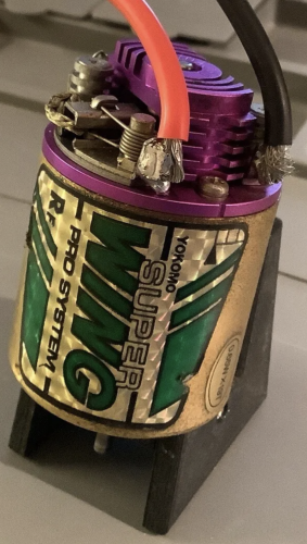

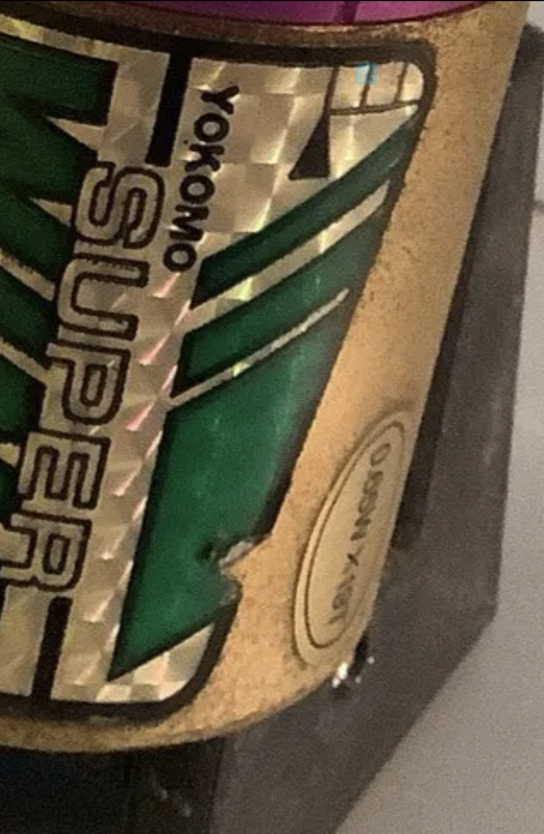

Several moths ago I've bought a RF Wing Stock to made an addition to my small collection. Seller have been so kind sending me some old advs allowing me to know something more about Wing motors:
YMW4 Wing 4 Modified Motor 16 turn single
YMW2 Wing 2 Modified Motor 15 turn single
YMW RF Wing Stock Motor 23 turn single
YMW BG Wing Stock Motor 15 turn single
