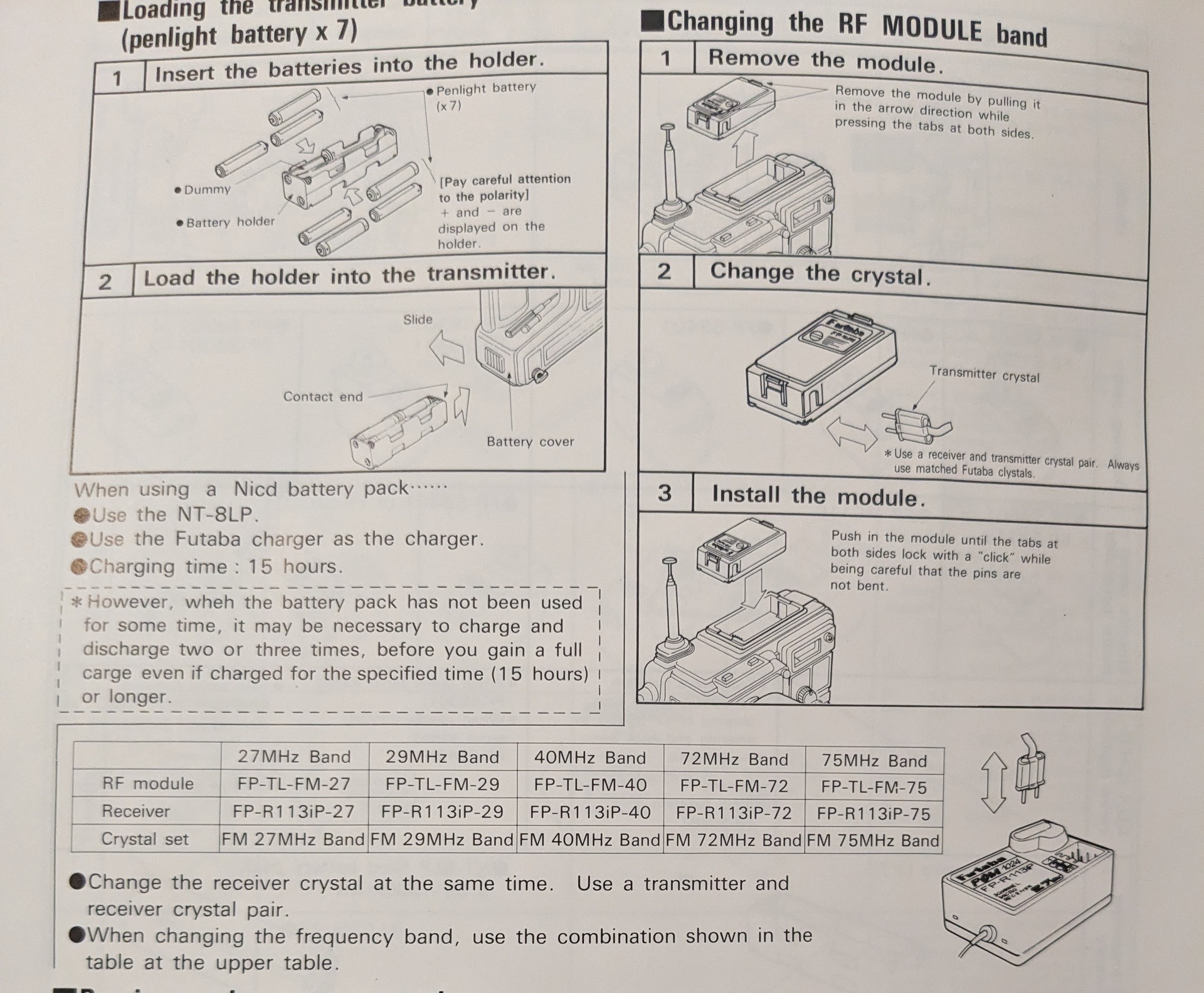

- The module that came with the unit is FP-TL-FM, but I'm looking to get some extra modules and saw someone listed a FP-PK-FM module - does anyone know if that would be compatible with this radio?

You can swap channel crystals from 76 to whichever you have on hand. You are not breaking FCV regulations by doing so. Additionally, any Futaba surface module will work in the PCM 1024. I have used the 27mhz AM module, FASST module, and a converted KO Propo ASF module without issue. I'd stick with Futaba surface crystal sets, but have used Hitec and Airtronics/Sanwa AM crystals as well.

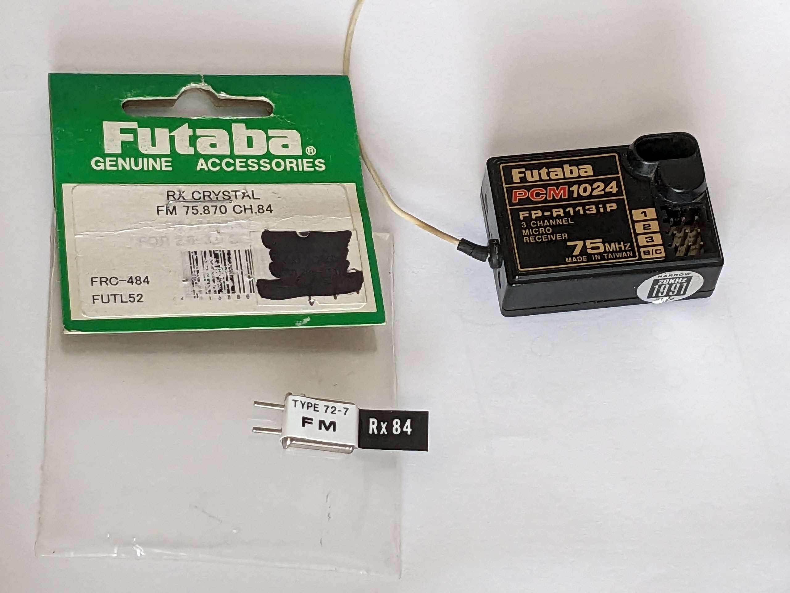

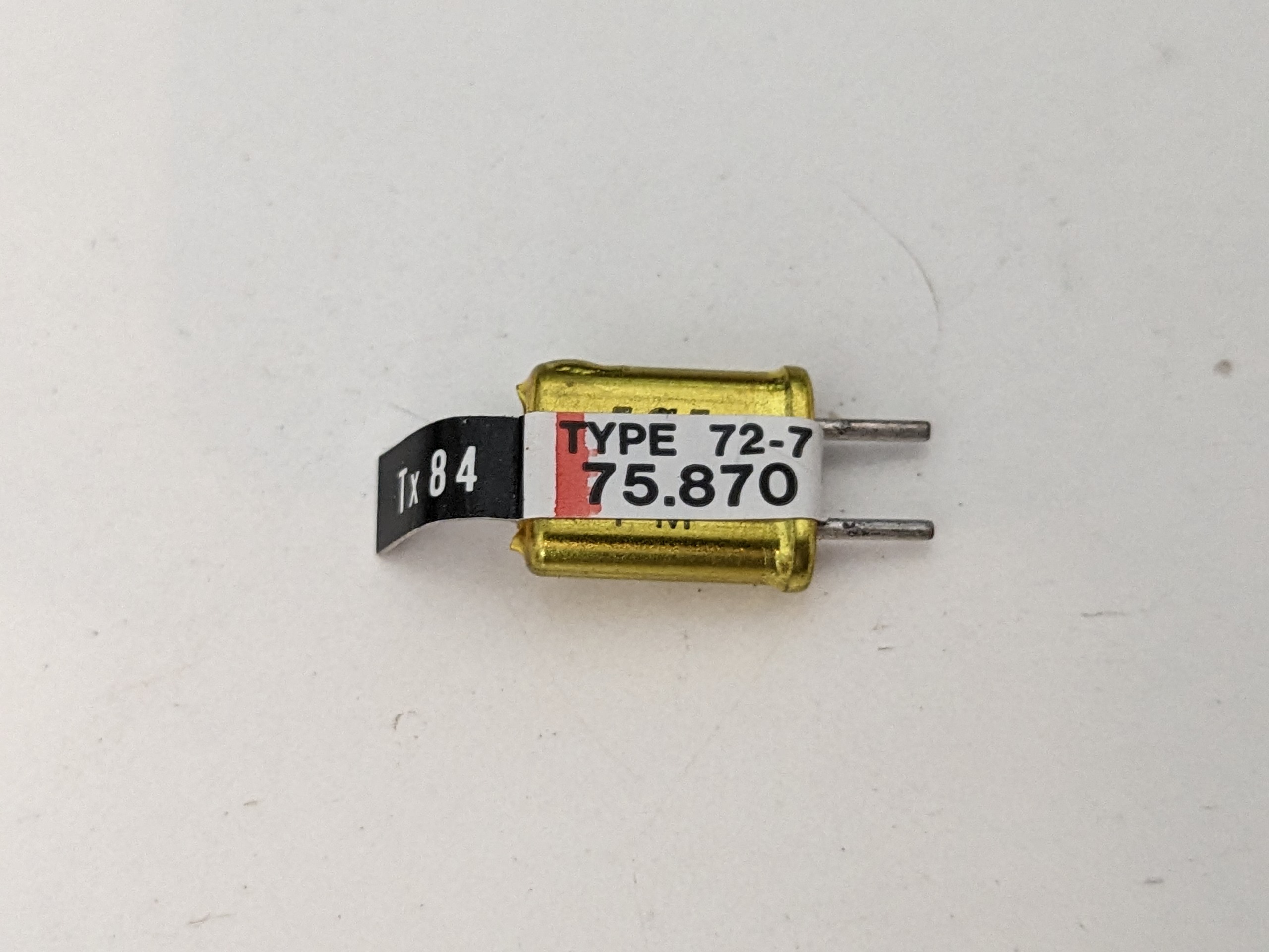

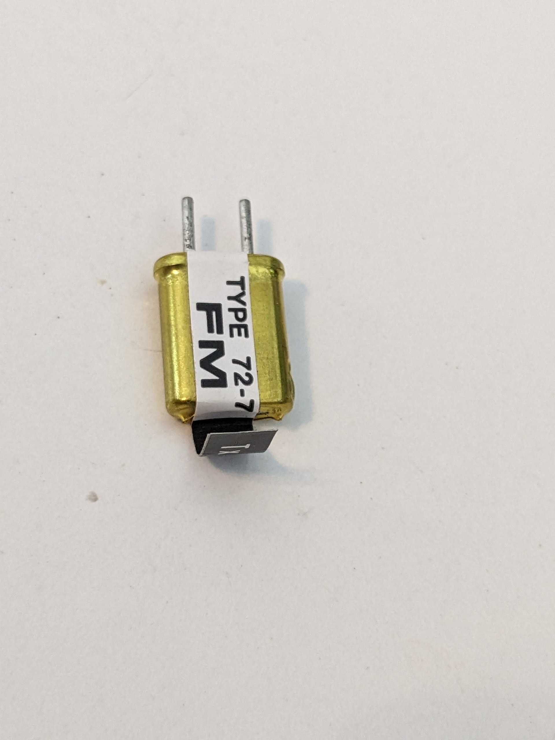

I picked up one as well and a separate receiver. The module has a TX crystal in it, covered be a square aluminum sticker. Mine has a Futaba type 72-7 crystal. I have a same frequency 72-2 RX crystal purchased but not in hand yet.

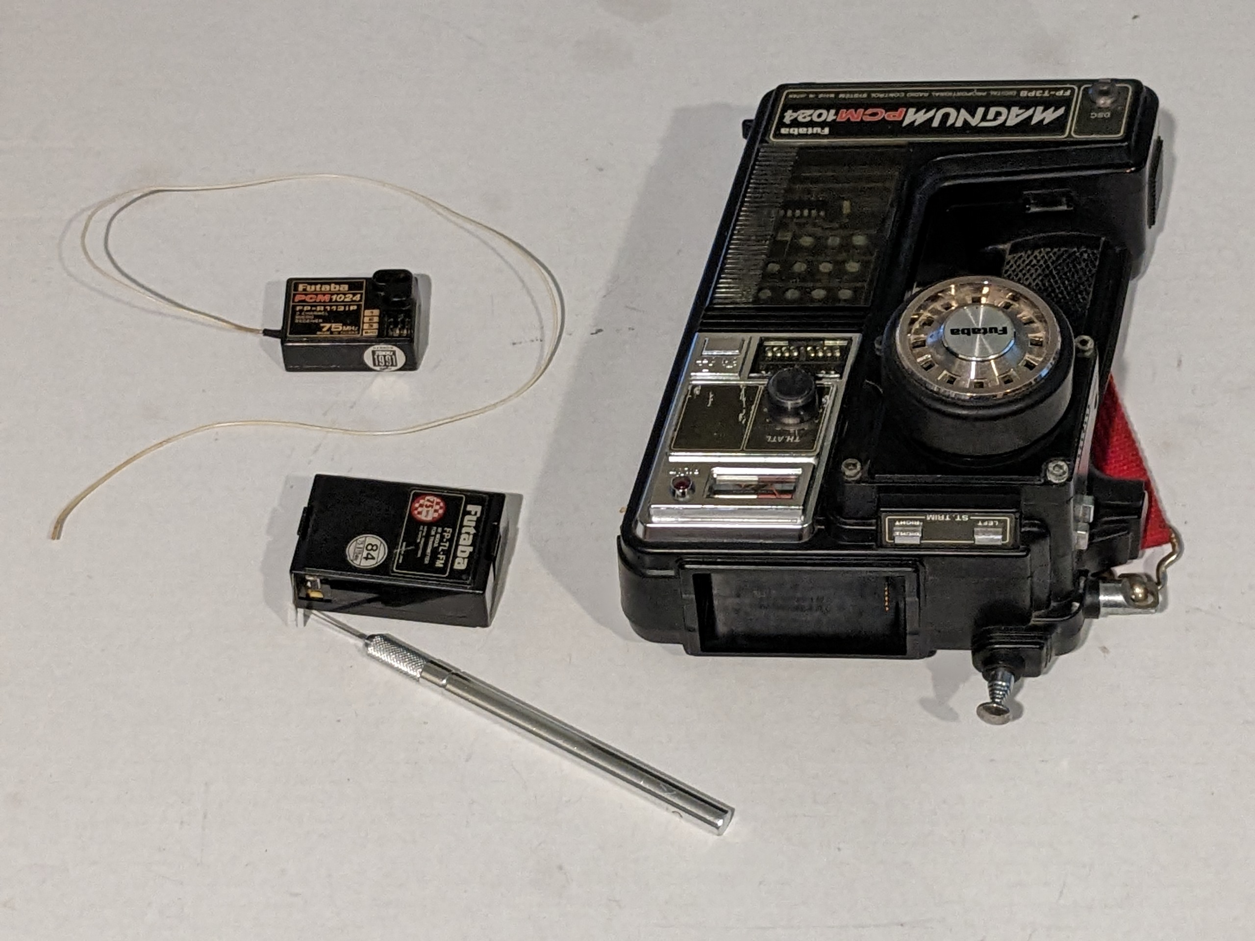

Type 72-7 RX crystal arrived and works great with this receiver and my FP-T3PB PCM 1024 radio.

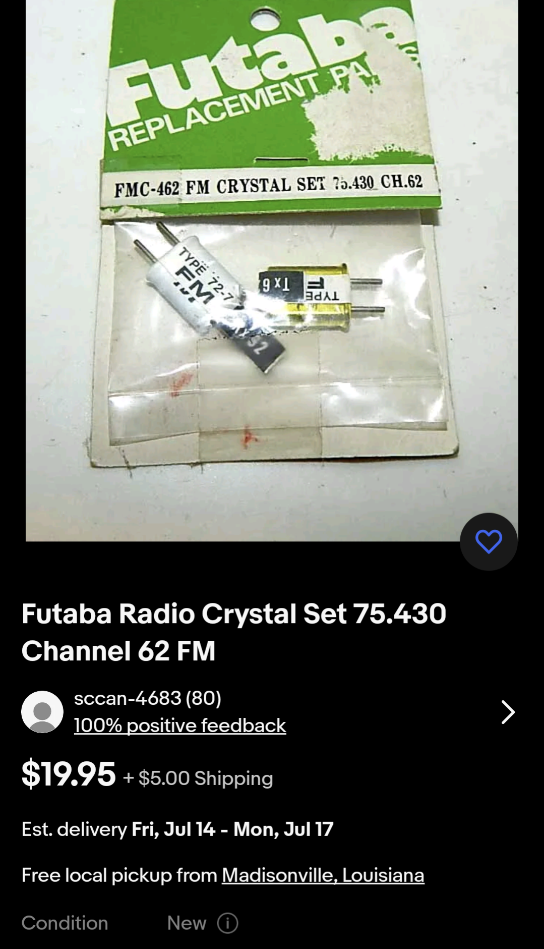

Frankentruck where did you get this from? Is this single conversion? Do they sell pairs that also come with the TX crystal?

I got it from eBay. There is a set of type 72-7 crystals listed. I don't know anything about dual conversion other than I see some airplane radios use it.
