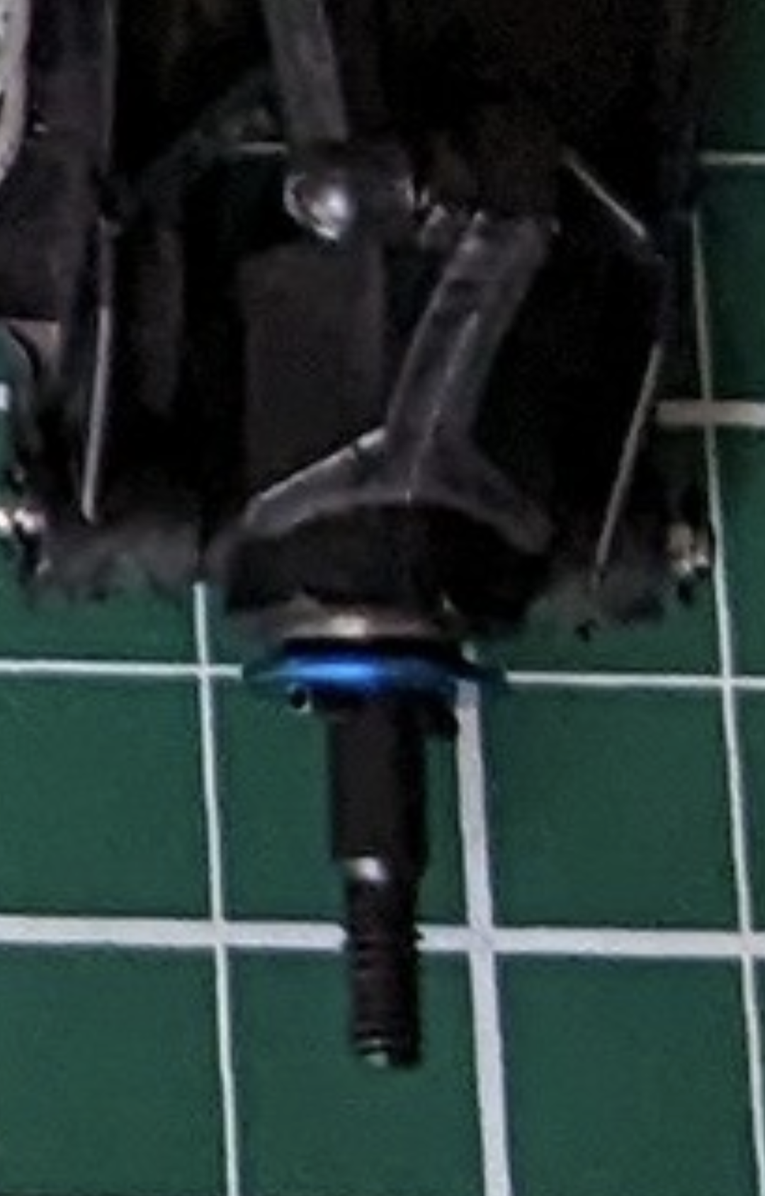

Hey guys, forgot to add this to the main post! The reason I’m doing this swap is because ever since I installed the RPM rear oversized bearing carriers I keep destroying wheels. I’m running shiny MIP CVD’s and 3/16 axles with real 1/2x3/16 bearings and I left the shim placement stock (thick shim on the inside and two thin shims on the outside).
How many shims do you guys have success with and where is what I’d like to know! Thanks again and all help is much appreciated

Are you using rear wheels meant for 3/16" axles? If you are and are still destroying them, you could add the little washer shim that the B4 & T4 use. It will allow you to lock the wheel in place to it when you tighten the rear axle nut. That should make it harder for the axle pin to destroy the rear wheel.

Yes sir I’ve got the right wheels and I robbed the axles and wheel spacers off of my B4 like you suggested! Worked like a charm, just had to order another set so the B4 isn’t out of commission lolFrankentruck wrote: ↑Sun Oct 01, 2023 7:28 am Are you using rear wheels meant for 3/16" axles? If you are and are still destroying them, you could add the little washer shim that the B4 & T4 use. It will allow you to lock the wheel in place to it when you tighten the rear axle nut. That should make it harder for the axle pin to destroy the rear wheel.
