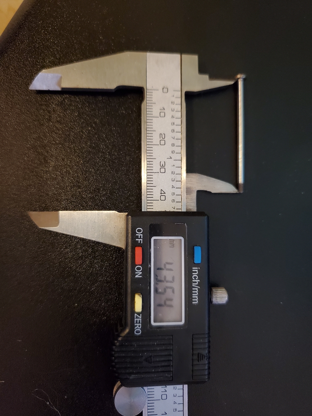

I´m searching for a long king pin for one of my projects and have seen the one for the TLR22 cars.
Part # TLR234098
If someone have such car, could you please check the dimensions of those king pins?
I´m interested in the length of the plain shaft including the thread, the overall length and the overall diameter (3.0 mm or other?).
Thank you

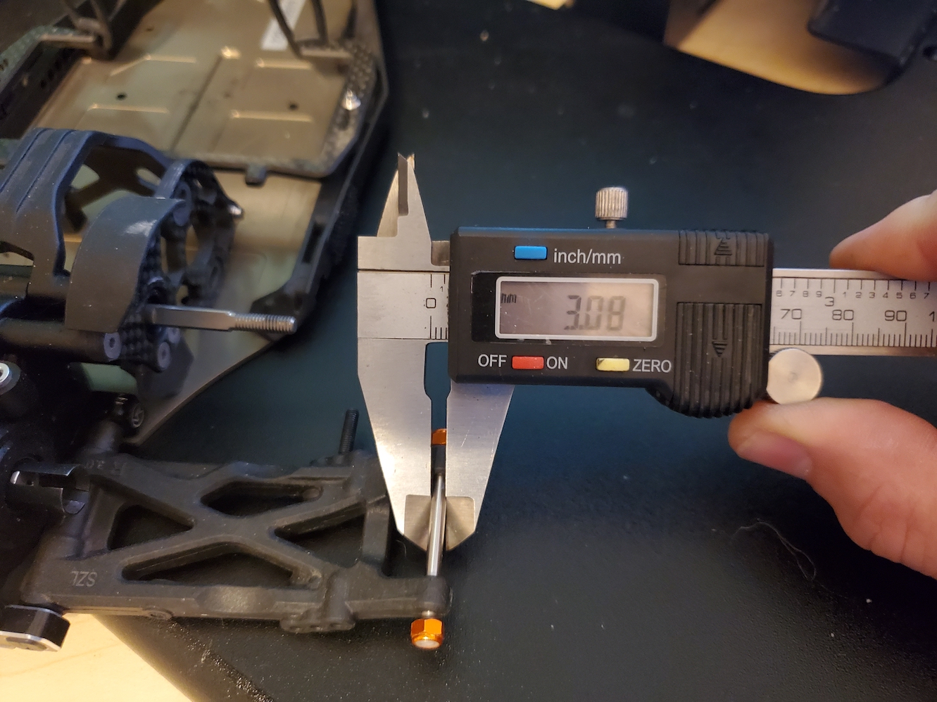

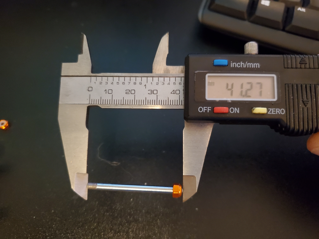

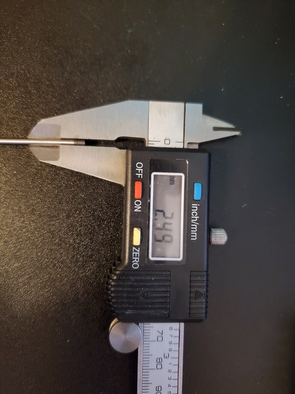

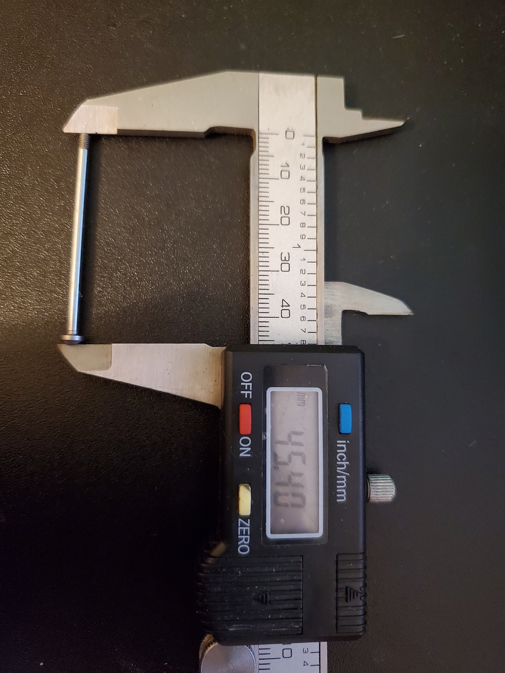

If you don't get an answer before next week, ping me then. I have that part, at least for the TLR 22 4.0, but it's in a buggy that's packed for an outing I leave for tomorrow.V12 wrote: ↑Tue Oct 17, 2023 1:45 pm I´m searching for a long king pin for one of my projects and have seen the one for the TLR22 cars.
Part # TLR234098
Thank you

Re: TLR22 king pin questions
Thank you!
Unfortunately that means I can´t use those king pins.
The length is around what I´m searching but it´s to thin.
Someone know king pins which are around that length but either 1/8" or 3.0 mm for the shaft diameter?
The type with the thread would be nice but oldschool type for e-clips will do the job also.
