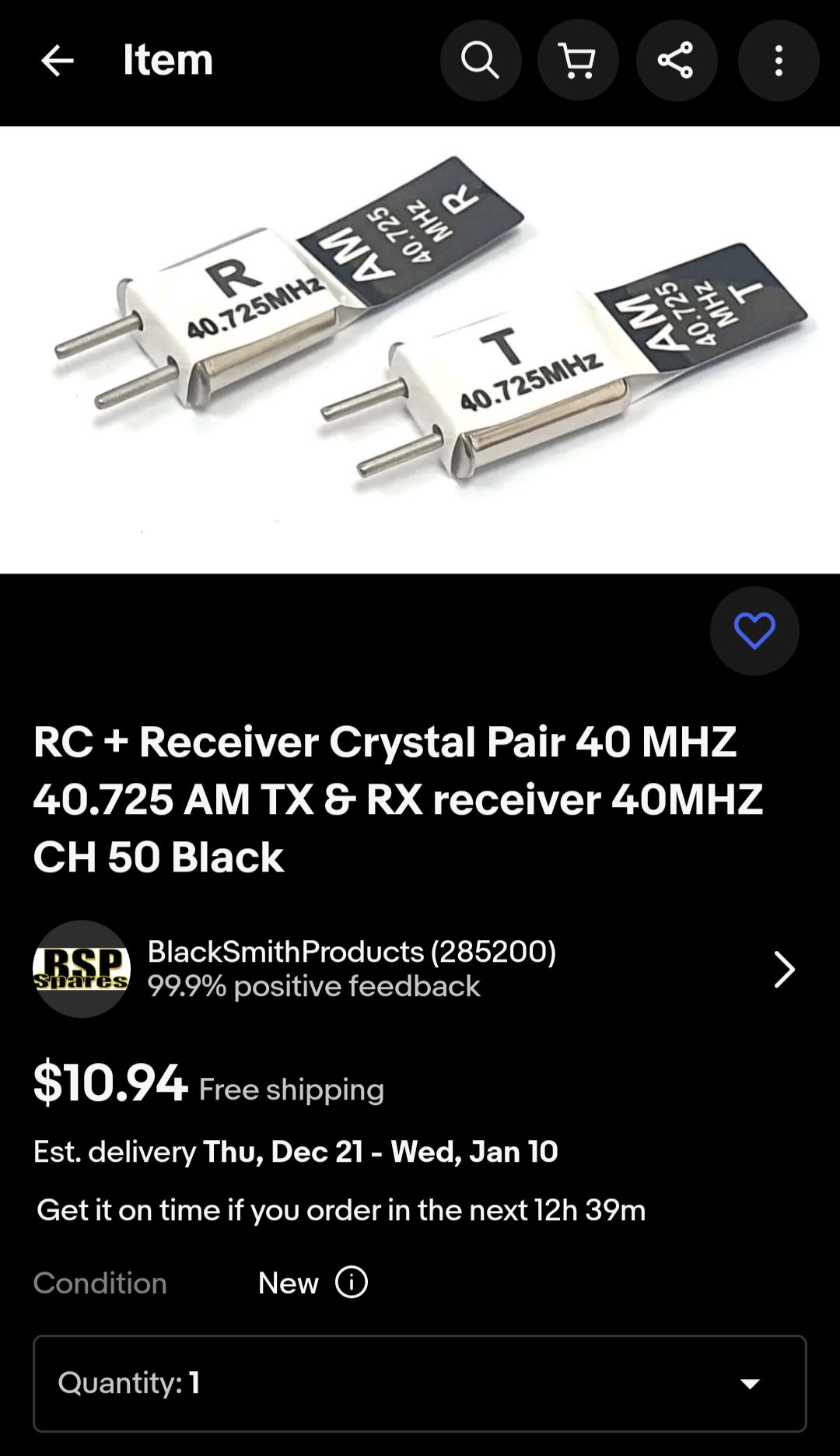

Thanks so much Gomachv.
Where can I find, a set of AM crystal for this tx (and rx)?
On the net I find lot's of 41.040MHz crystal sets, but all are only FM.

I thought the frequency was 40mhz, not 41mhz. Maybe 40 is close enough?

Thanks Franken,
it's really 41MHz have a sticker on the remote.
It's working too with 40MHz set crystal?

Hi at all, sorry for the reupload.
I try it the Dash transmitter (41 MHz AM) and the 40 MHz crystal, with a techniplus AR-201 T2M 41 MHz AM receiver.
It's working at half, the steering and the throttle working in one sense only. When adjust the trimmer,
is slight better on the inverse side, but not all. I understand the Sanwa / Acoms are not fully compatible.
I find many Sanwa receiver to 40 MHz; can i use it if the transmeitter is 41 MHz AM but both crystal are 40 MHz?
I'm in the range?
Thanks at all.

I try again with the techniplus receiver, and is working perfectly!
I stupidly reverse the servo, on the transmitter with the dip switch :oops:
As soon as possible i make a video.
