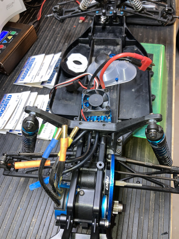

So it looks like I just need slipper hubs and a body. I have the body mounts and wheels/tires. I also have a full hex conversion. I’ll have to decide on wheels and tires and go from there.
I’m digging the blue
Brand new gear diff trans, it was built a while ago for something. I guess it was this.
You can also make hinge pins from bulk 7/64” hardened rod or even long shank 7/64” drill bits and a rotary cut off wheel.

I prefer a 1/4” long 2/56 SHCS and a washer to the tiny 1/8” long 2-56 BHCS that always seems to back out. This never does.

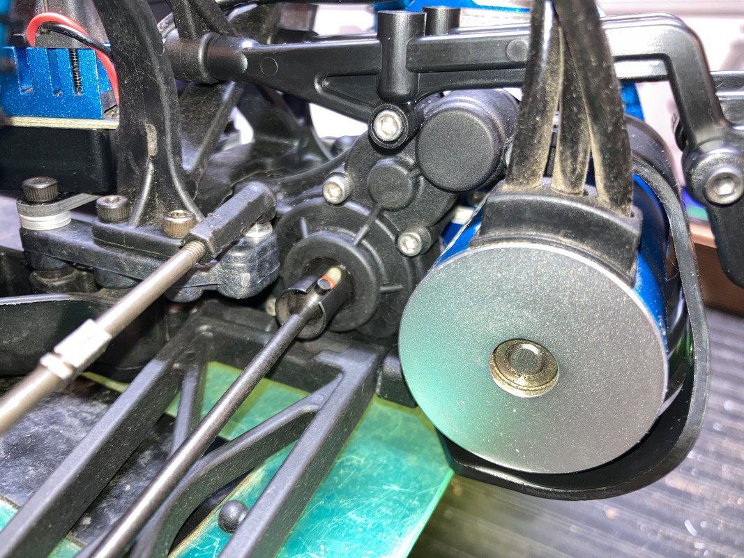

I used T4/GT2 front body posts for the front SC10 body mounts. GT front body posts for the rear sc10 mount. I like how they have stoppers built in and are not adjustable. I checked with my other stock SC10 and the body fits with plenty of room.

After a little cleanup, I can tell this chassis used to have a rpm chassis brace and front bumper.
I bought the chassis with turnbuckles, front tower, front arms and top plate. And the wrong chassis plate! It came with a T4/B4 chassis plate and wouldn’t accept my gear diff so I had to open one of those.
