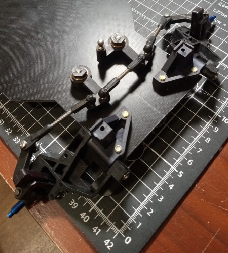

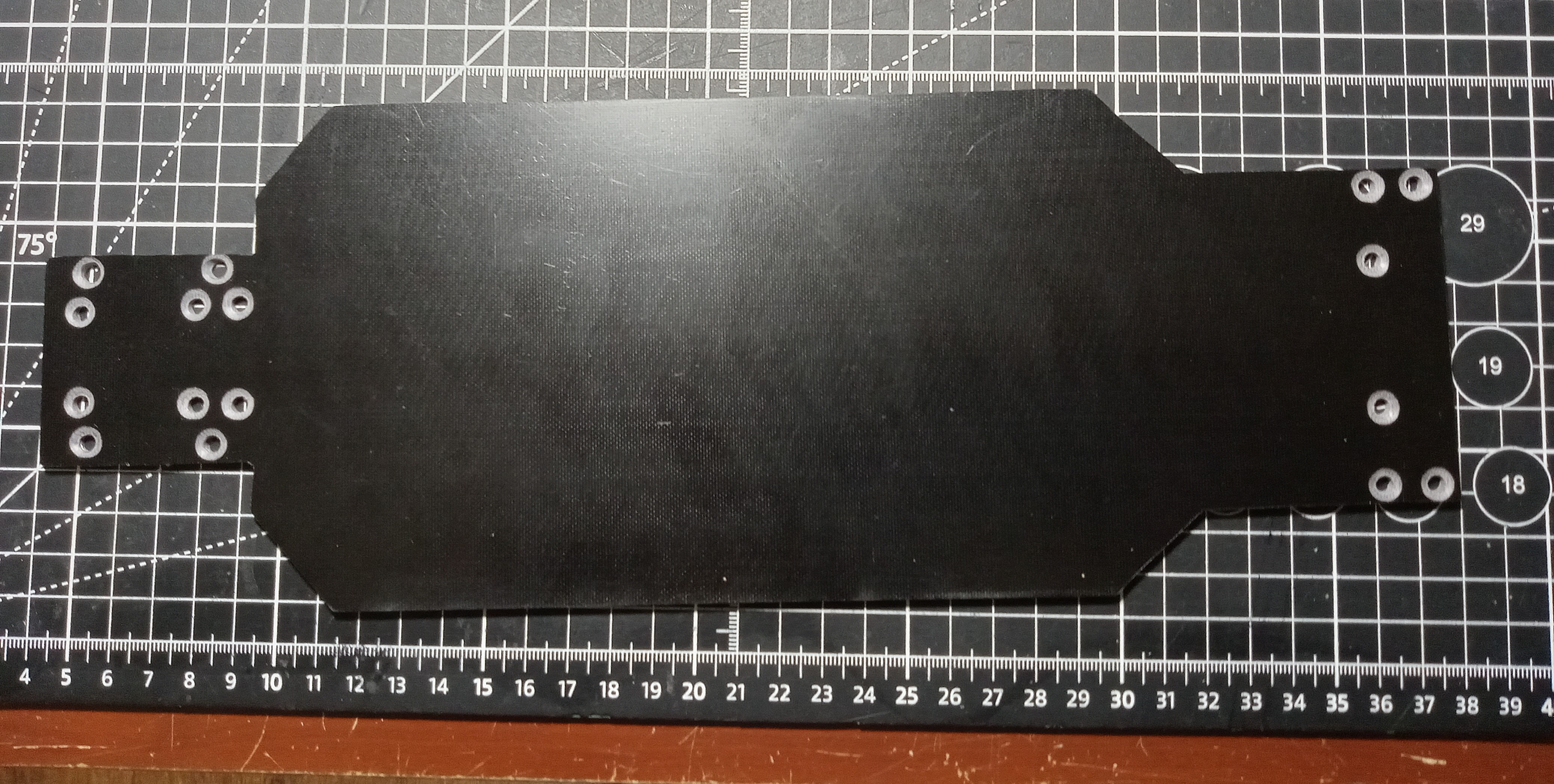

Well, the building itch has hit me again. I was going through my old parts box, and found I had almost everything to put together another RC10...I already have one, so I've decided to experiment. I picked up a sheet of 3mm G10 and using only the parts I have, build a mid-motor road car, much in the style of a drift chassis.

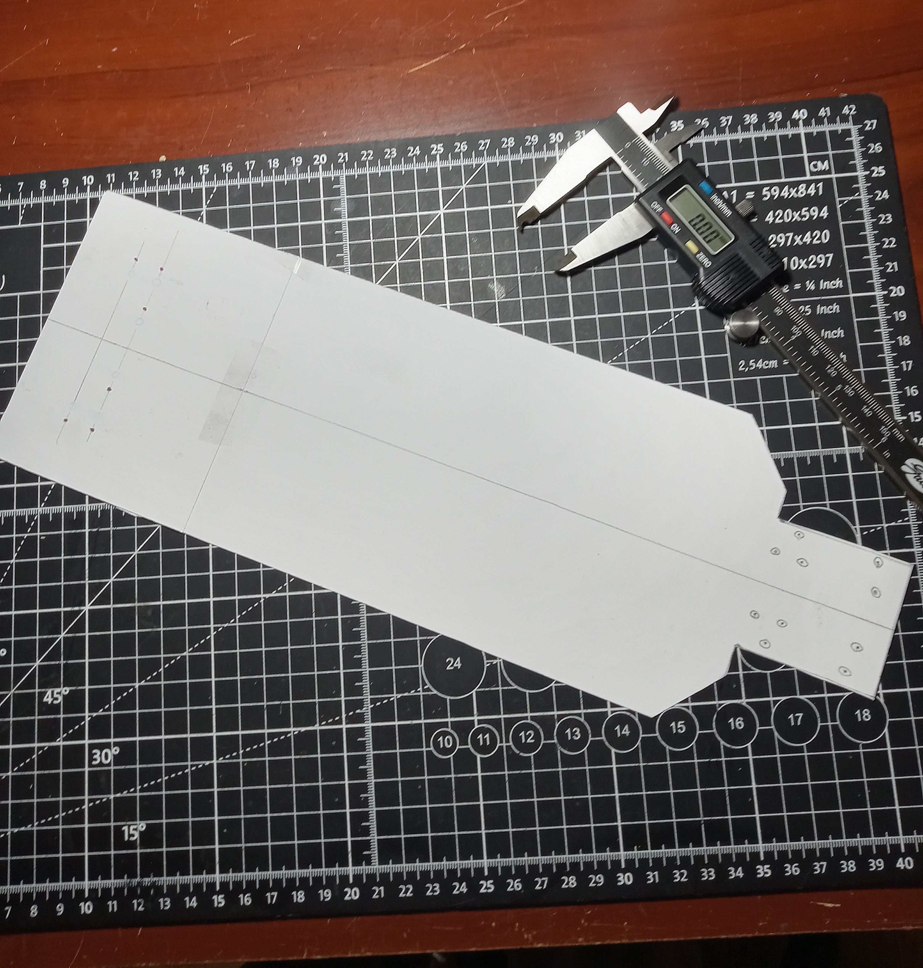

I'm pretty limited since I don't have a 3D printer, CNC, lathe or the knowledge to use them. All my fabrication was using a scroll saw, dremel and hand tools. All I'm really hoping for is a neutral-handling car to run on the street. Here's my initial progress, so far:
Paper template to lay out the chassis.

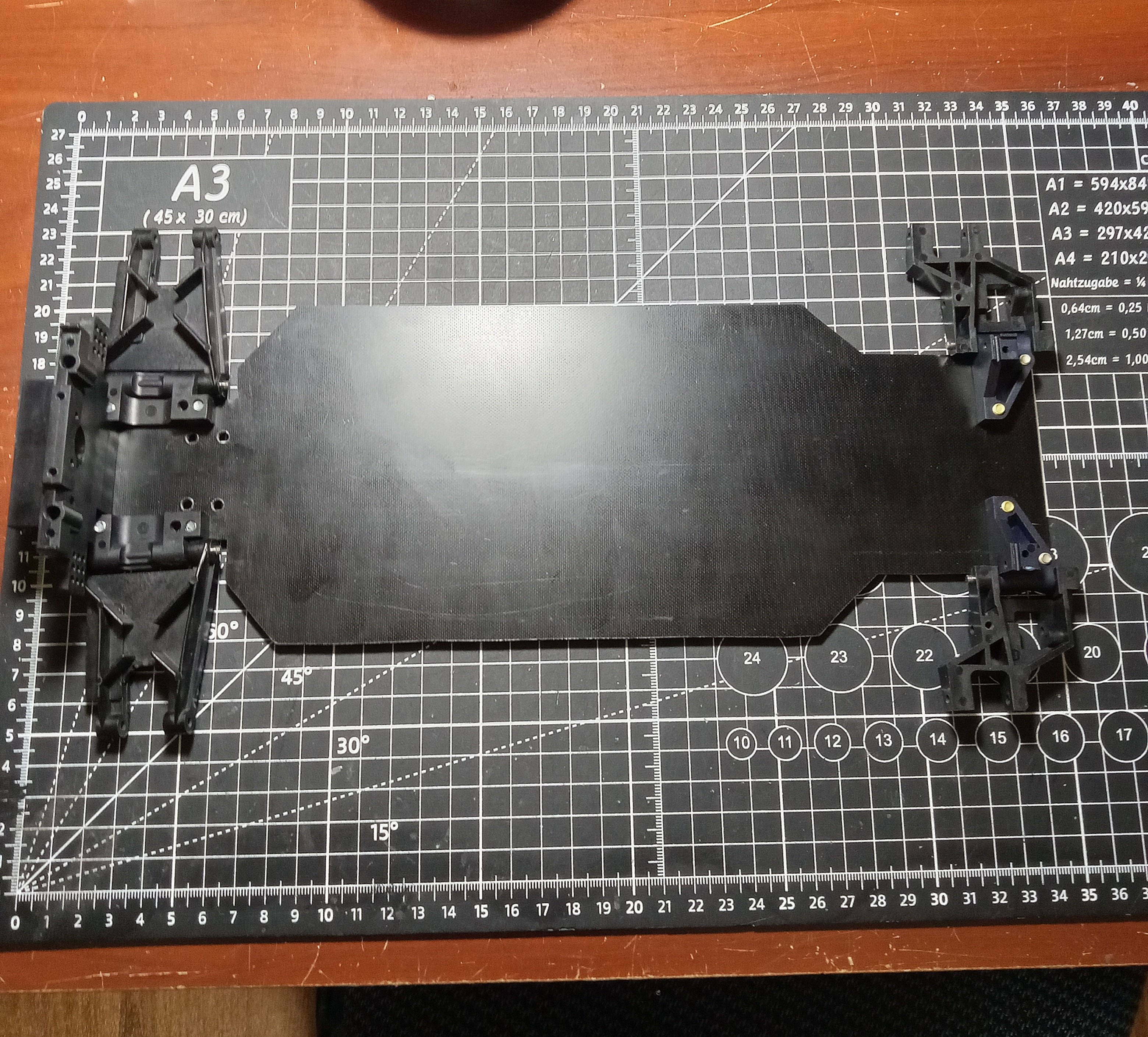

First cut with holes countersunk.
Initial suspension mounts.

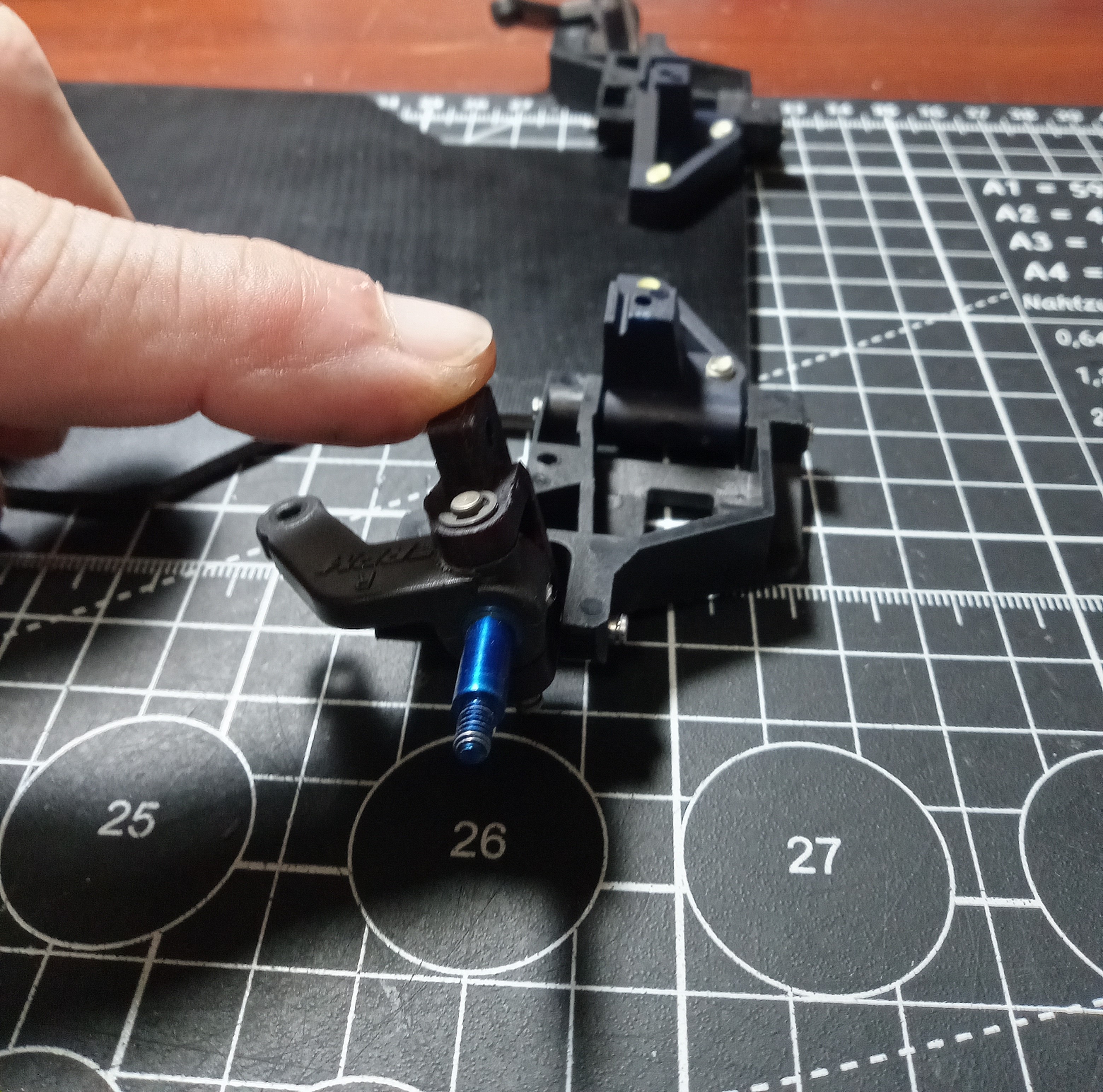

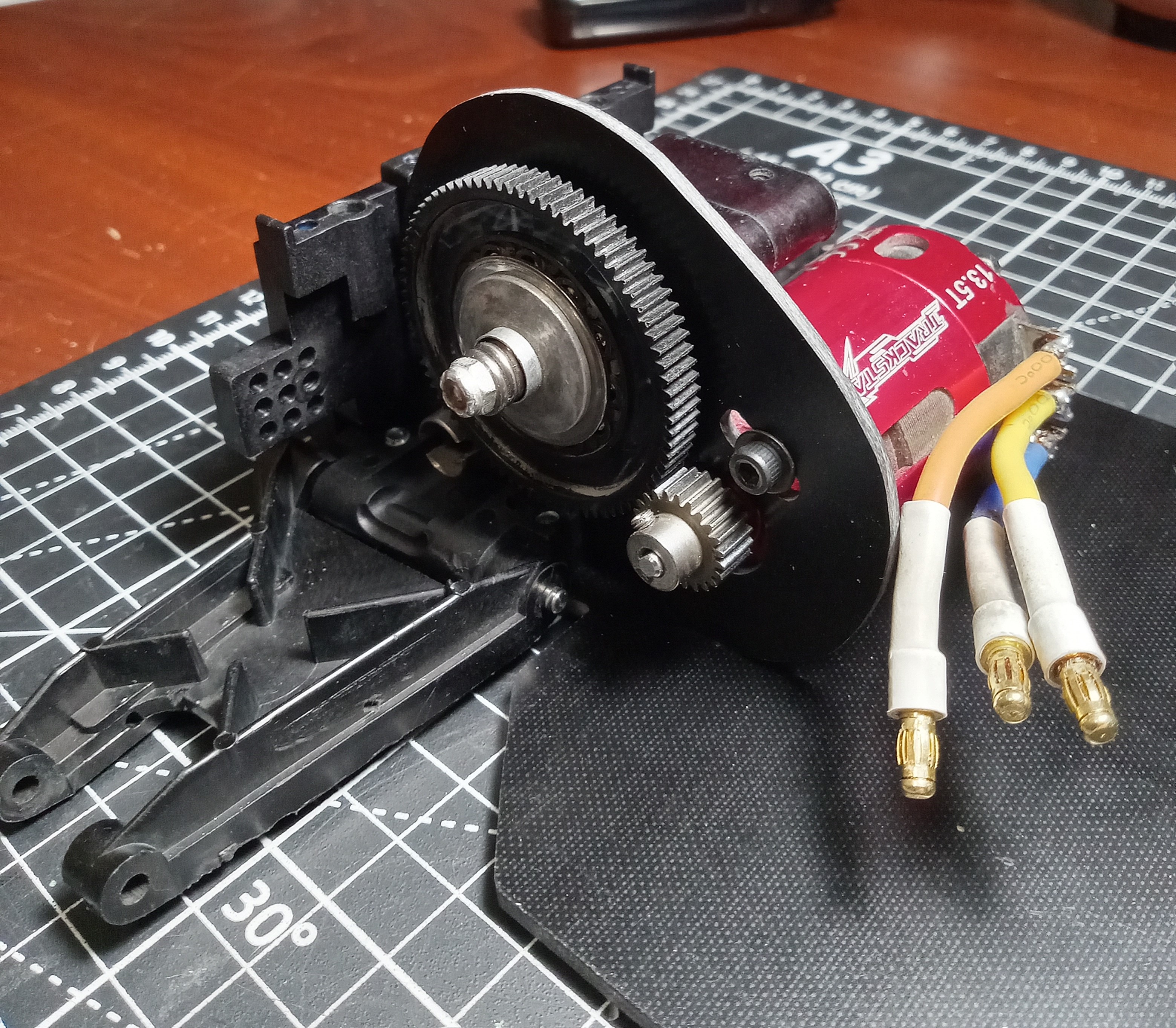

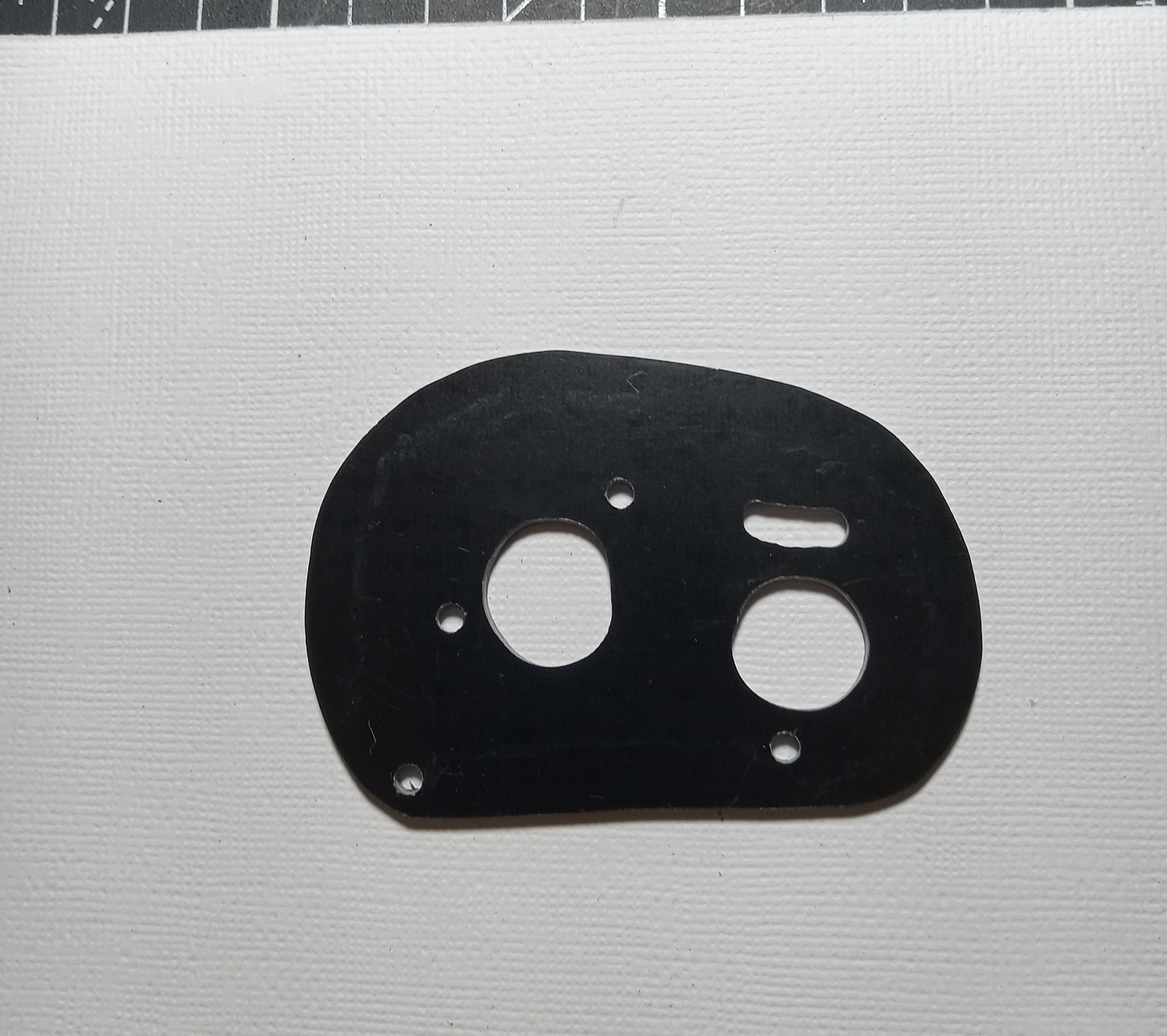

I managed to get a bit more done this evening. Since the chassis has no kickup, I used an old trick some people used back in the 80s, by shaving the stops out of the caster blocks and swapping sides. I found some RPM axle blocks (I have no idea what they fit) and filed them to fit. Also, fabricated a motor plate from 2mm G10 (That may change).

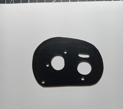

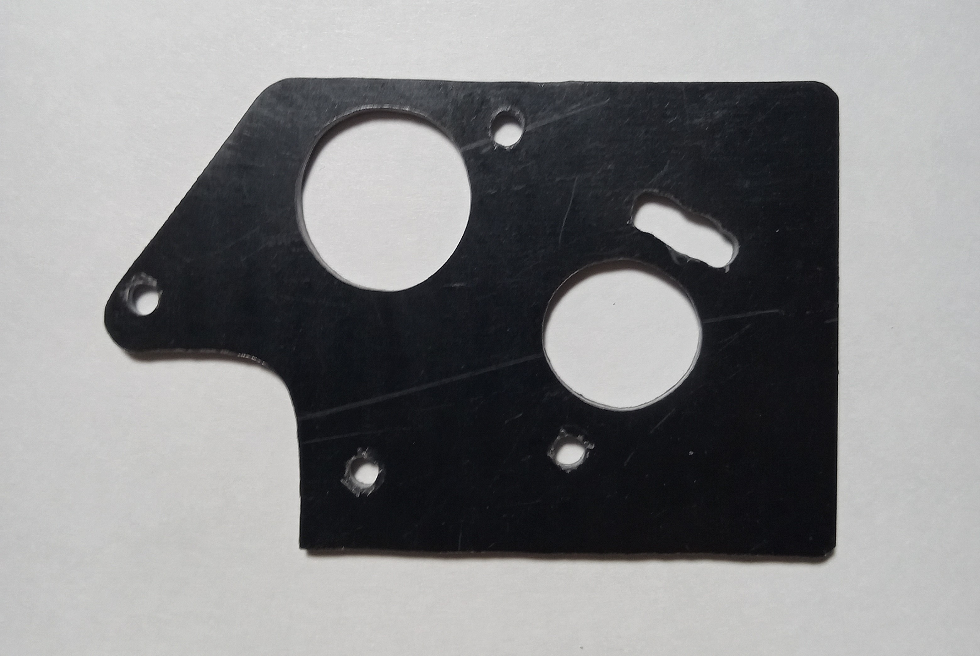

I decided to remake the motor plate because one of the screw mounts was a bit too close to the diff plate. This time, I went for a more "industrial look", instead trying to mimic a stock configuration...

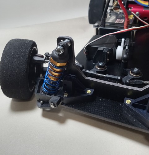

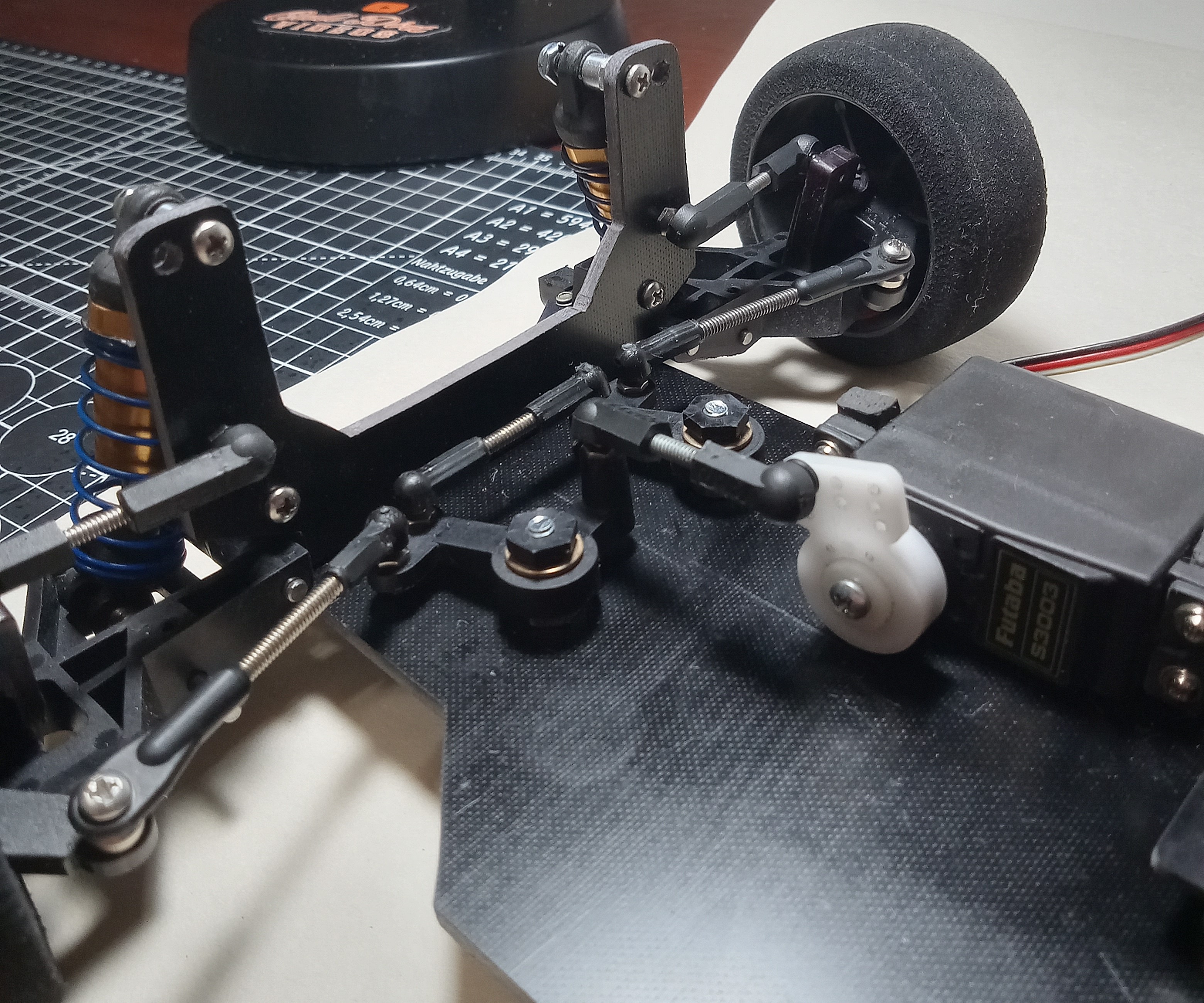

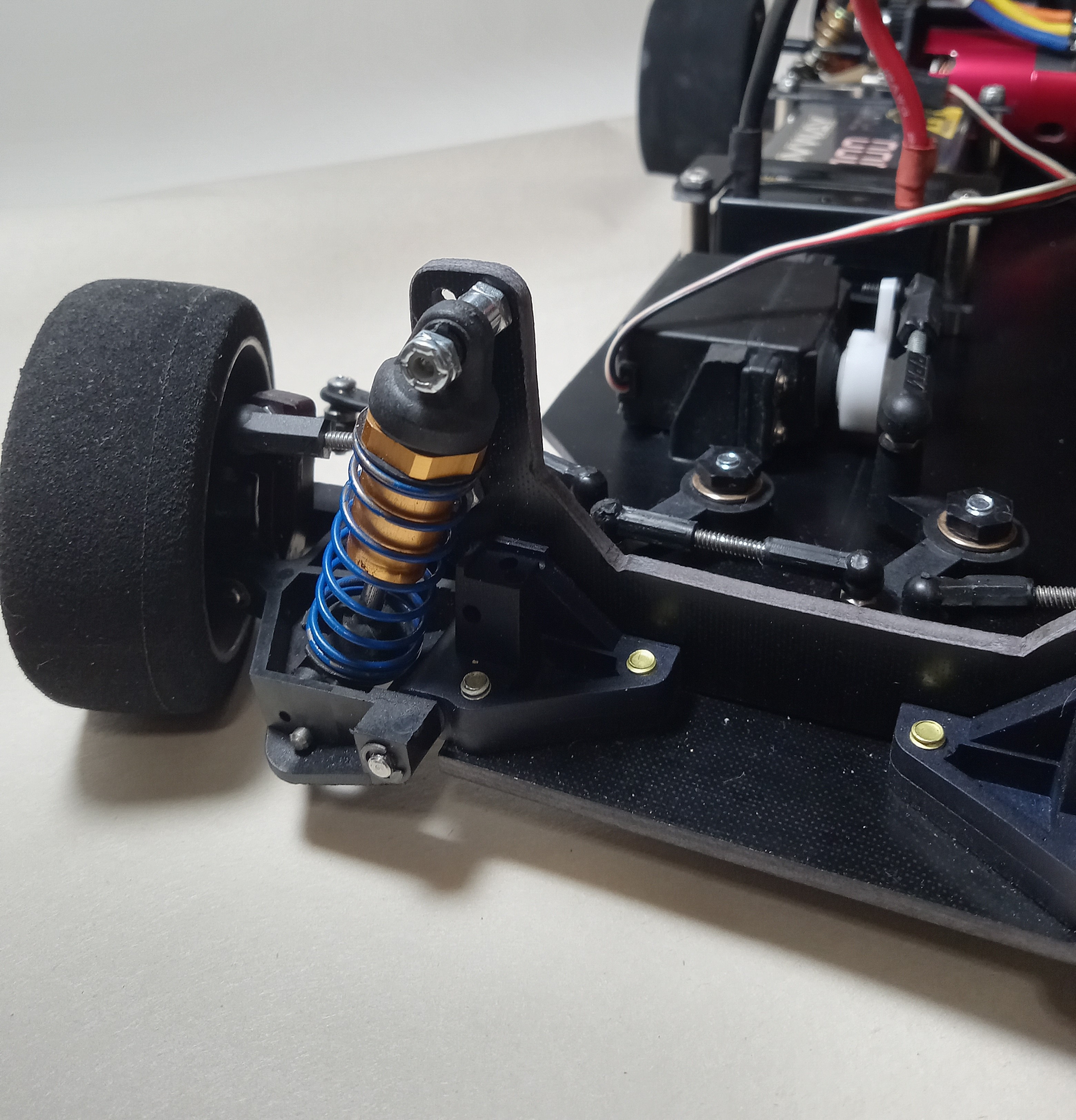

After the motor mount, I cut a tower to use with short shocks, and got the rear end functional.
Finally, I got the bell crank mounted. I'll need to cut a shock tower for the front, because I widened the front stance by 1/2" over the stock width.
I didn't get as far as I wanted to today, but at least it's starting to take shape.- Frankentruck

Thank you so much! I don't know what bearing mod you're referring to. All I did was flip the top shaft so the motor spins the proper direction, and fabricated a motor plate to fit.Frankentruck wrote: ↑Sat Mar 25, 2023 7:38 pm For your 6 gear transmission, are you doing the outdrive bearing mod?

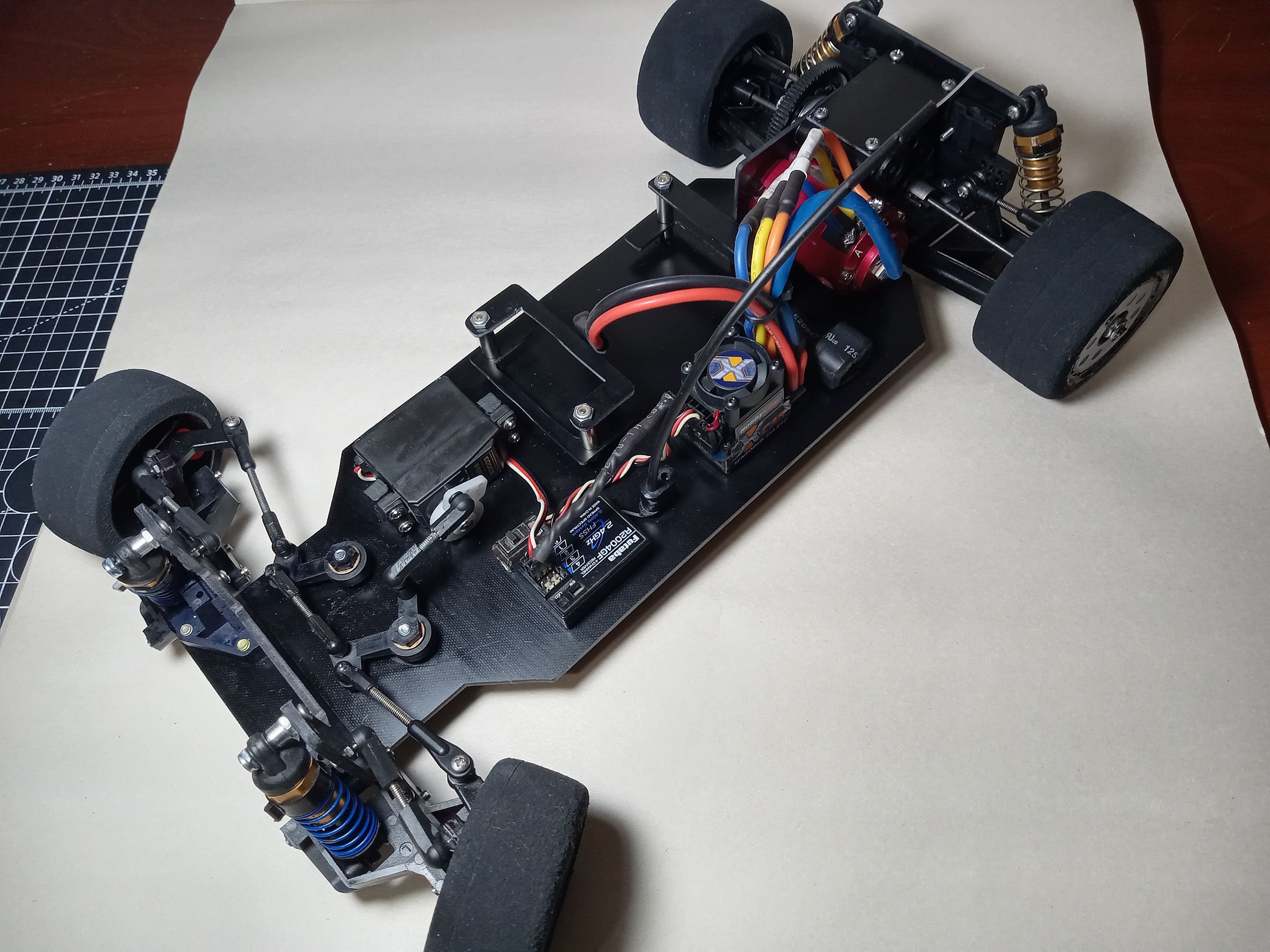

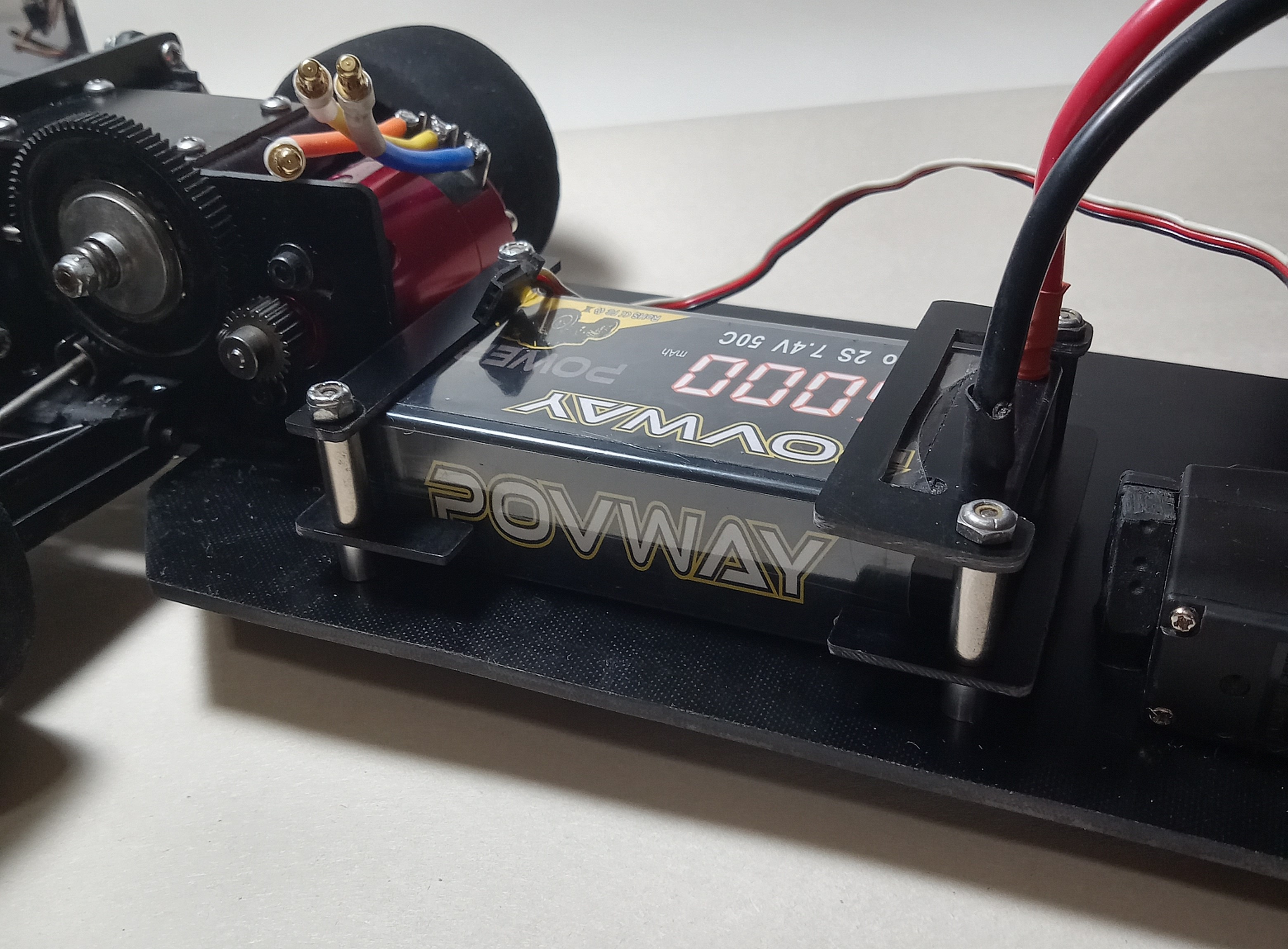

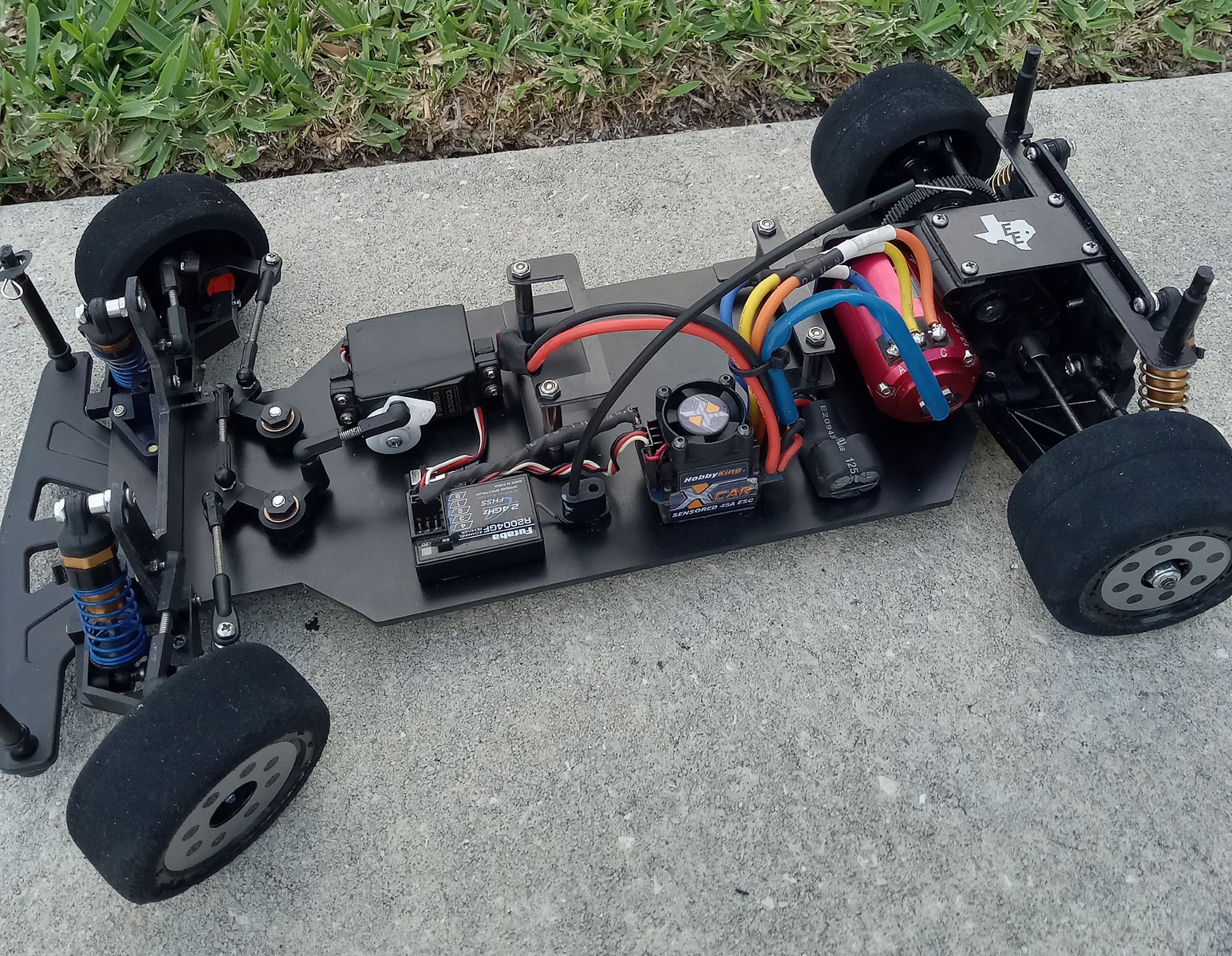

Here's today's progress... I got the front tower cut, mounted and all the steering linkage hooked up. The car has about 3/4" of ground clearance when all the running gear is in. Also, I got the battery tray built and installed. I used the poor man's method of balancing the car by standing a 3/8" socket extension upright and balancing the car on it. I kept shifting components around until I got it equal left/right. If I had to take a guess, it's about 60-65% rearward weight.

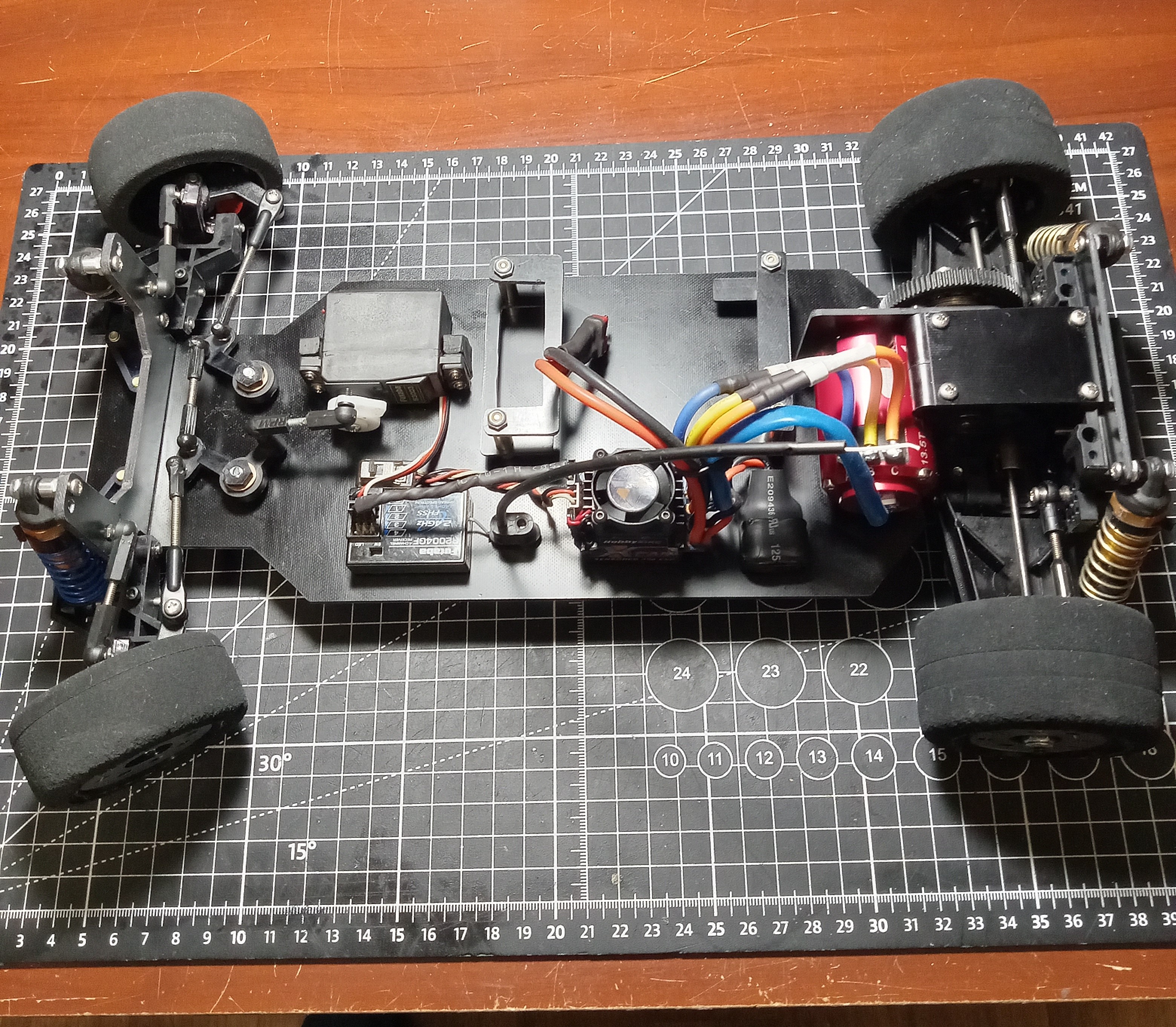

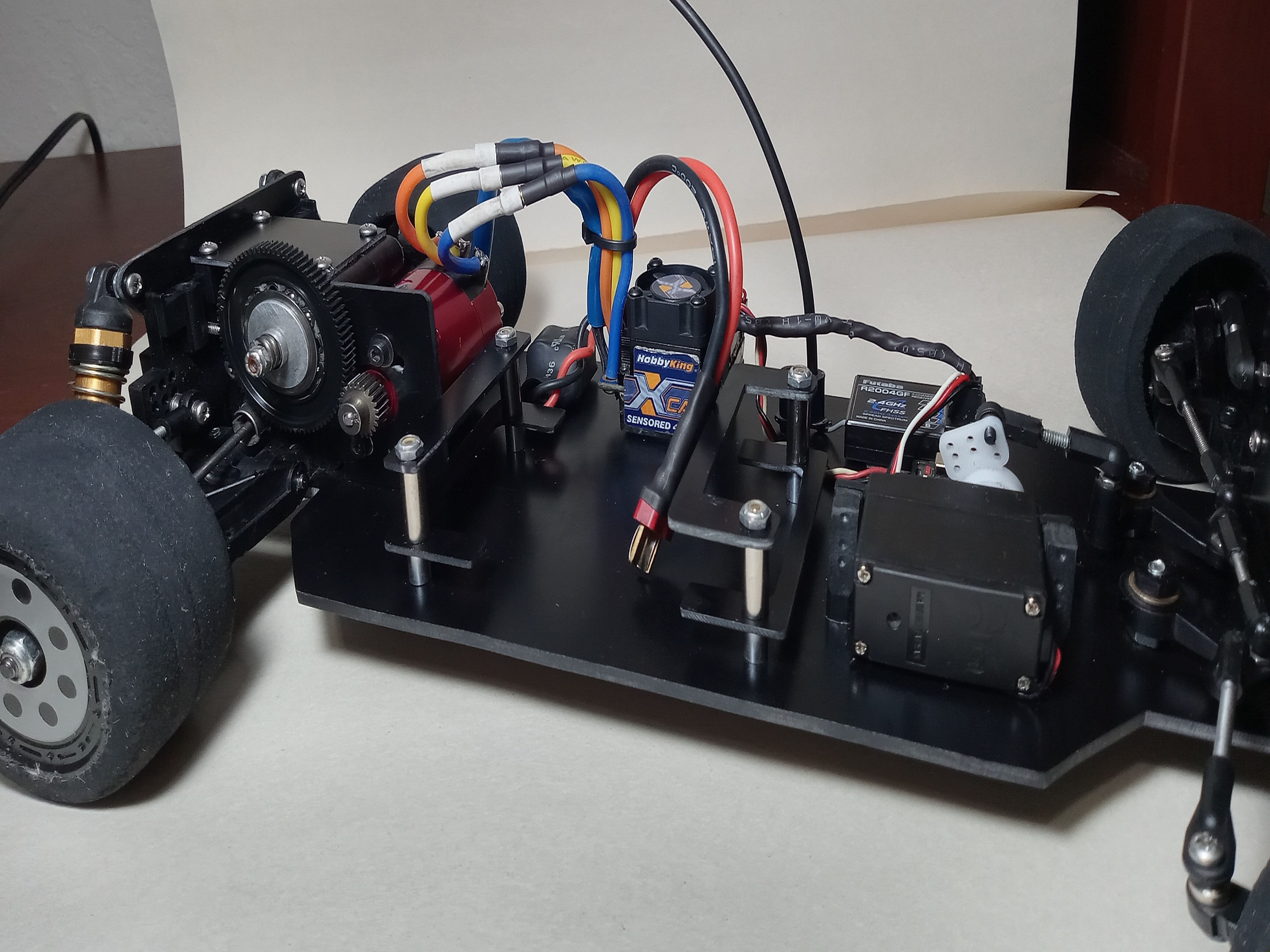

The BASIC car is complete! I got the electronics cleaned up and installed. Installed new bullet plugs on the ESC, and I shortened the servo wire (and found out age is catching up with me trying to see it
). ....I haven't taken it out yet, but I did bench test everything. ...Next thing is to fabricate a bumper/body mount and install the body (also recycled).

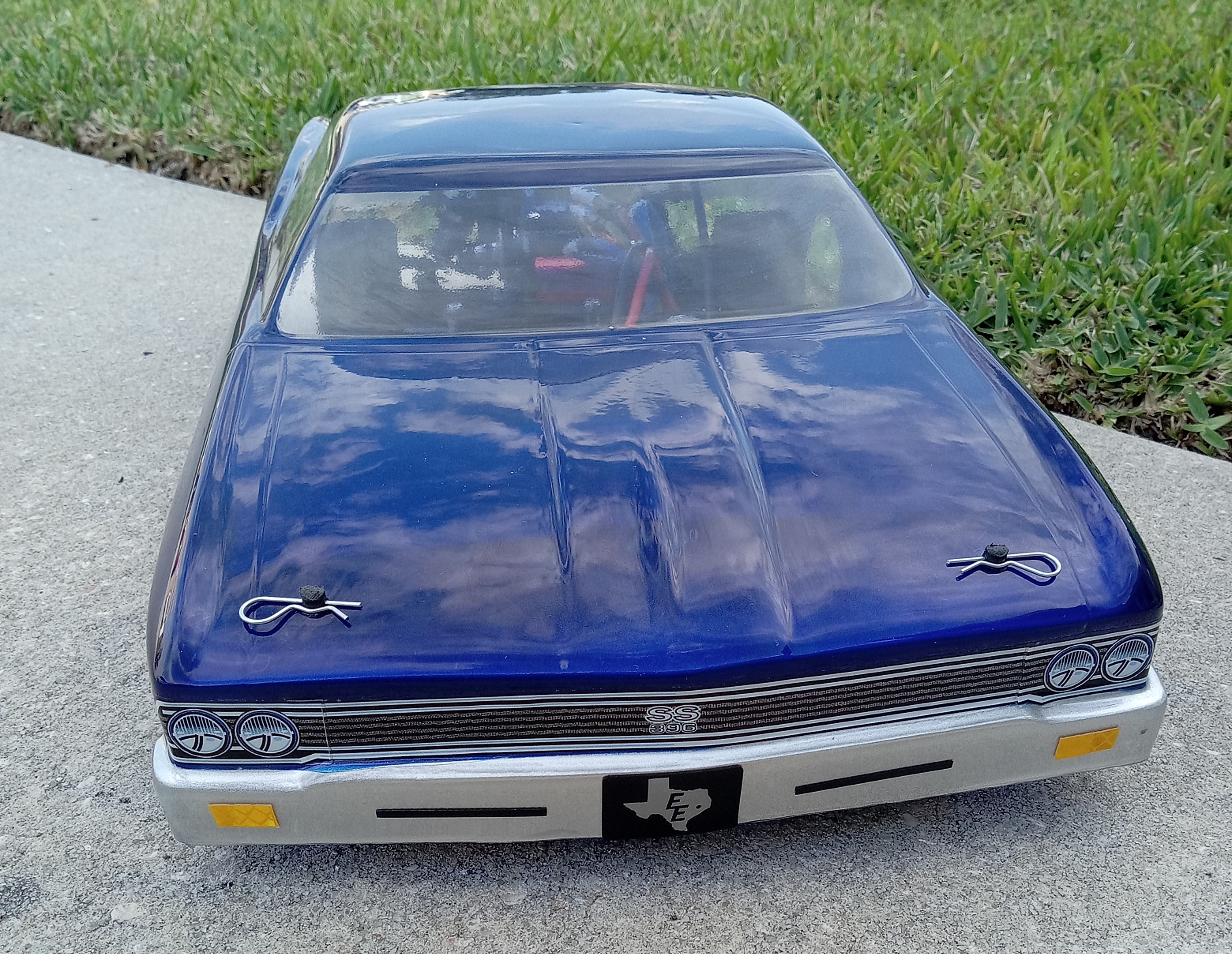

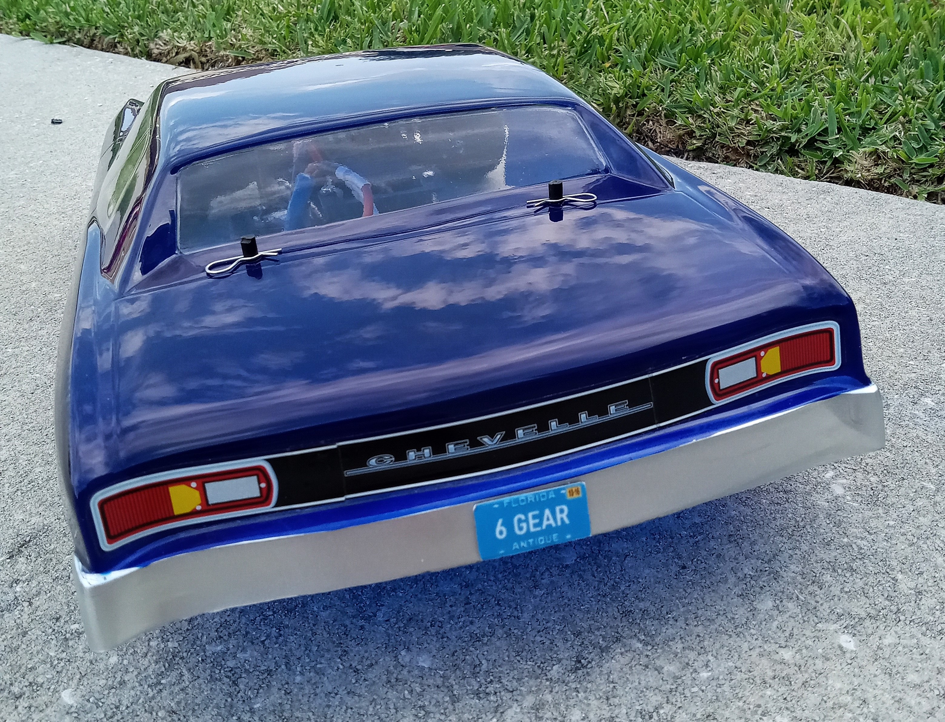

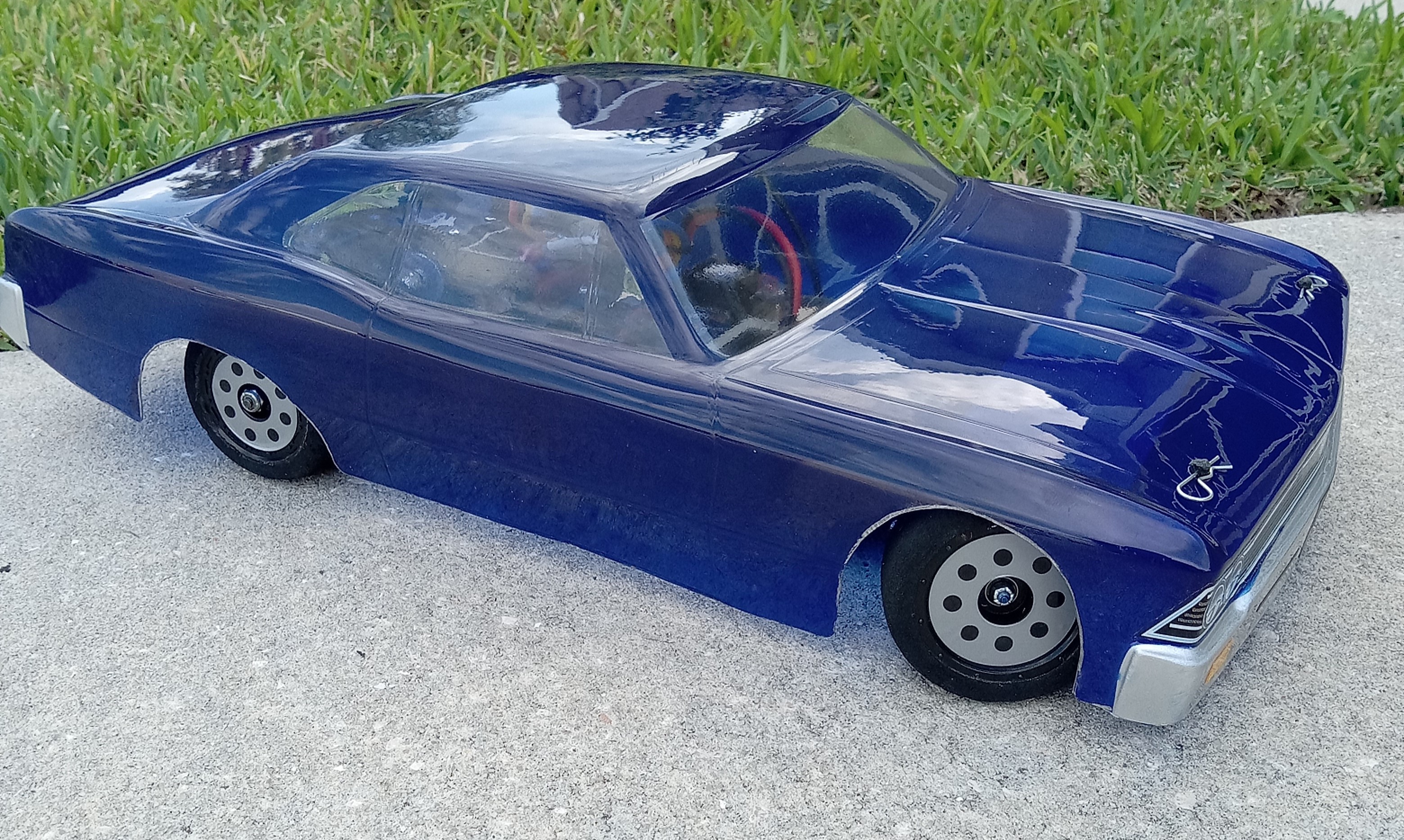

I've completed the project today...Used an old RPM bumper that I heated and flattened out. The rear was cut from G10, but I may redesign it. I've accomplished the goal of building it entirely from parts, including the body. That was a bit of a trick getting the holes to line up with the mounts. I did have to open the rear wells a little, but at least there's no extra holes.
