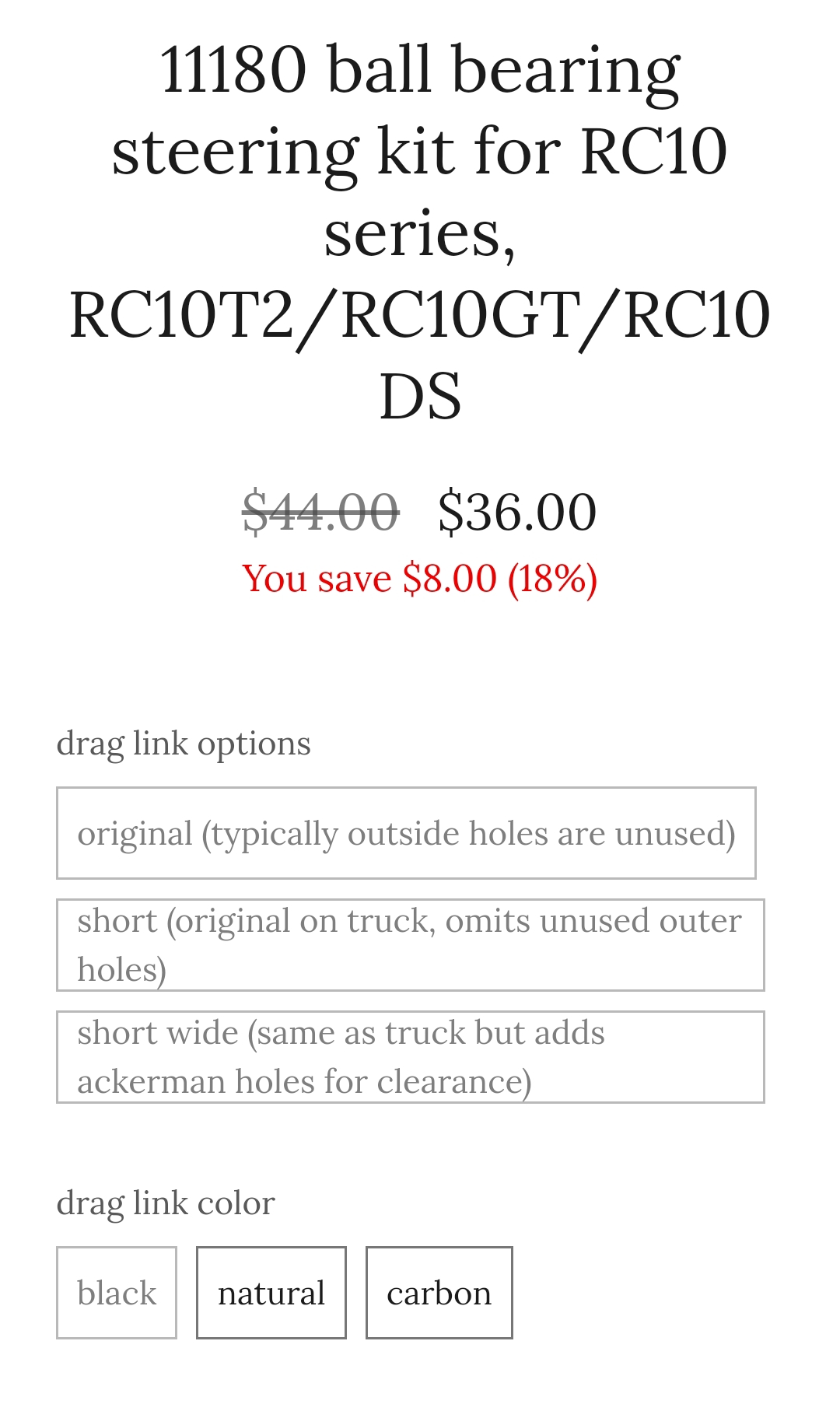

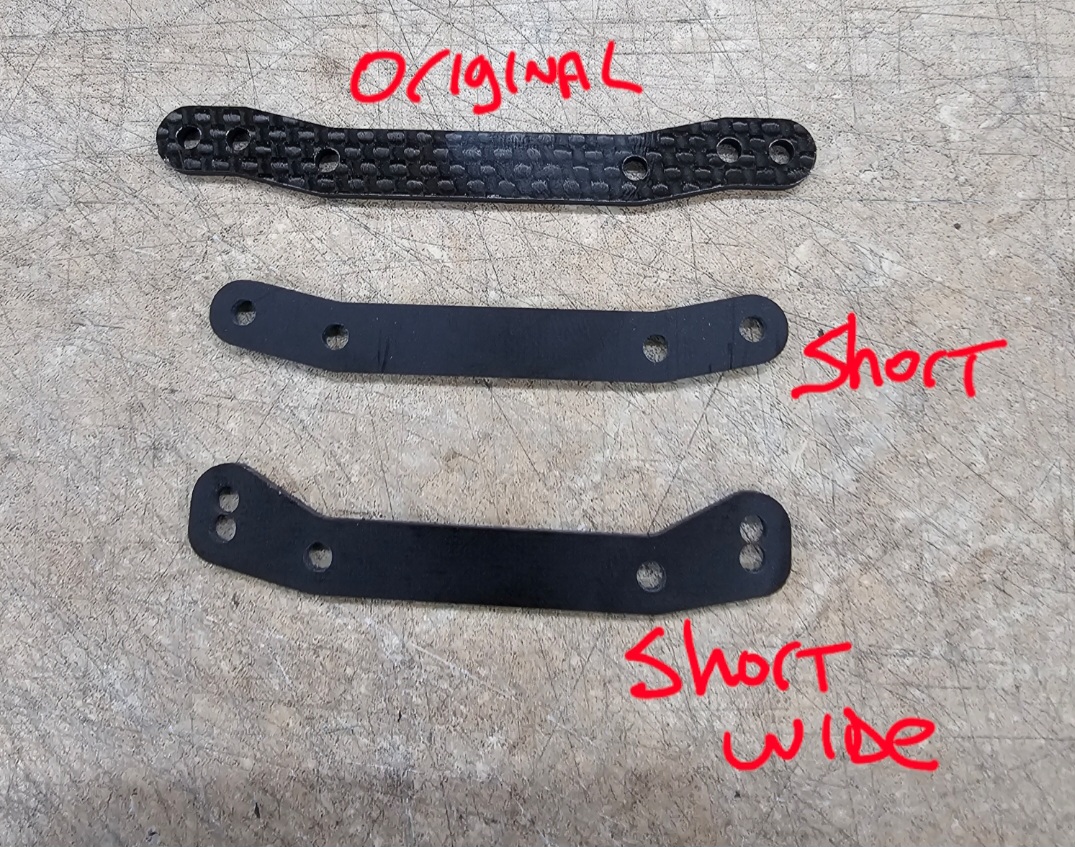

I just got my RC10GT partially reassembled, and discovered that the steering is worse than useless. I want to get a Factory Works ball bearing steering kit for it, but am utterly lost as to what these 3 drag link options are. Is there any difference? Which one do I need for my GT?

the three options will all physically fit, however for your application the "original" is not a great option as it was for the original rc10 buggy. It fits, but the shape is less desirable. the other 2, the "short" and the "short wide" are both perfect, the wide version offers an extra set of holes for more steering adjustment. Really it doesnt matter between those. On a buggy the wide version helps with the tight clearances that you dont need to worry about on a truck.
