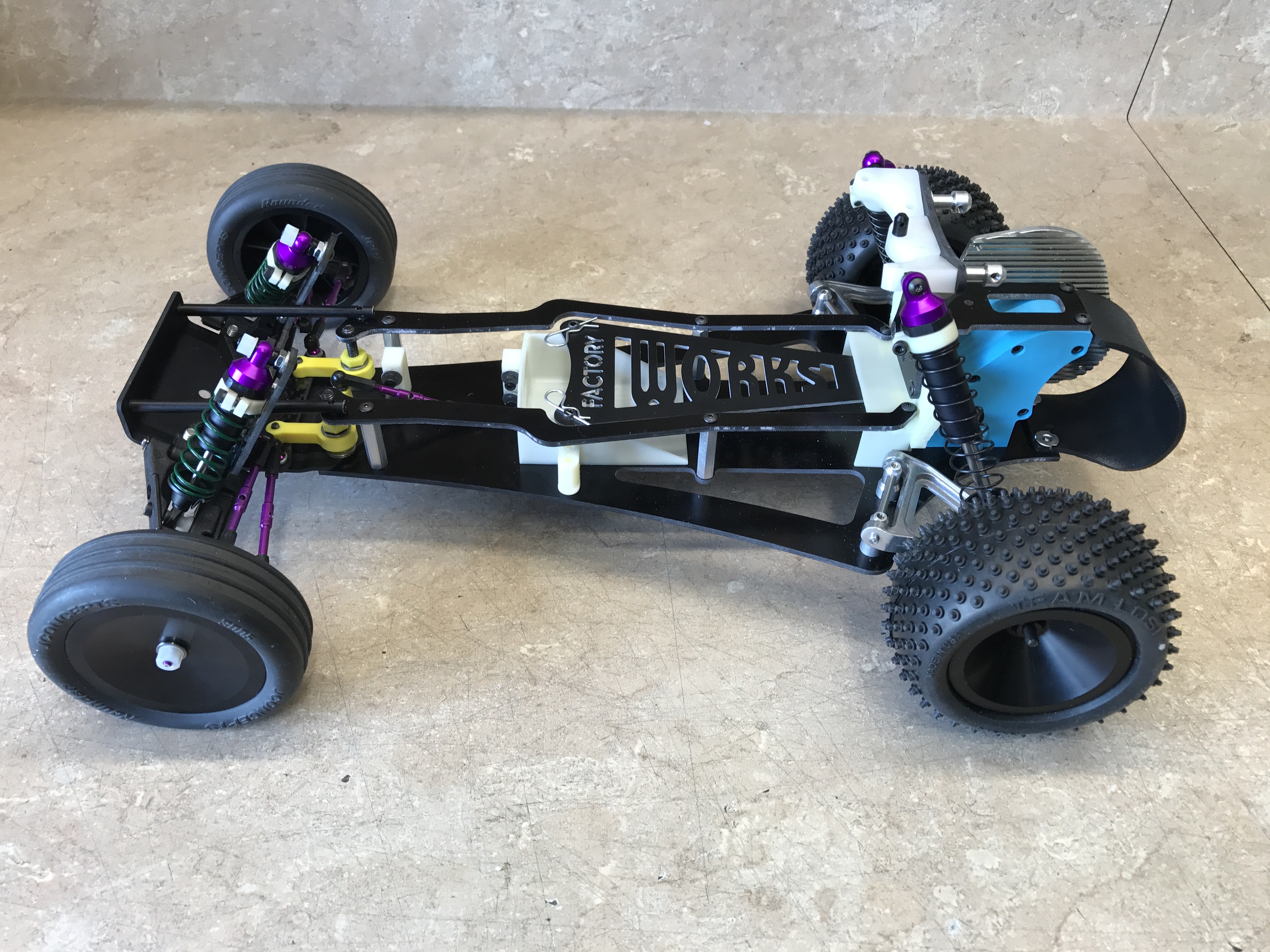

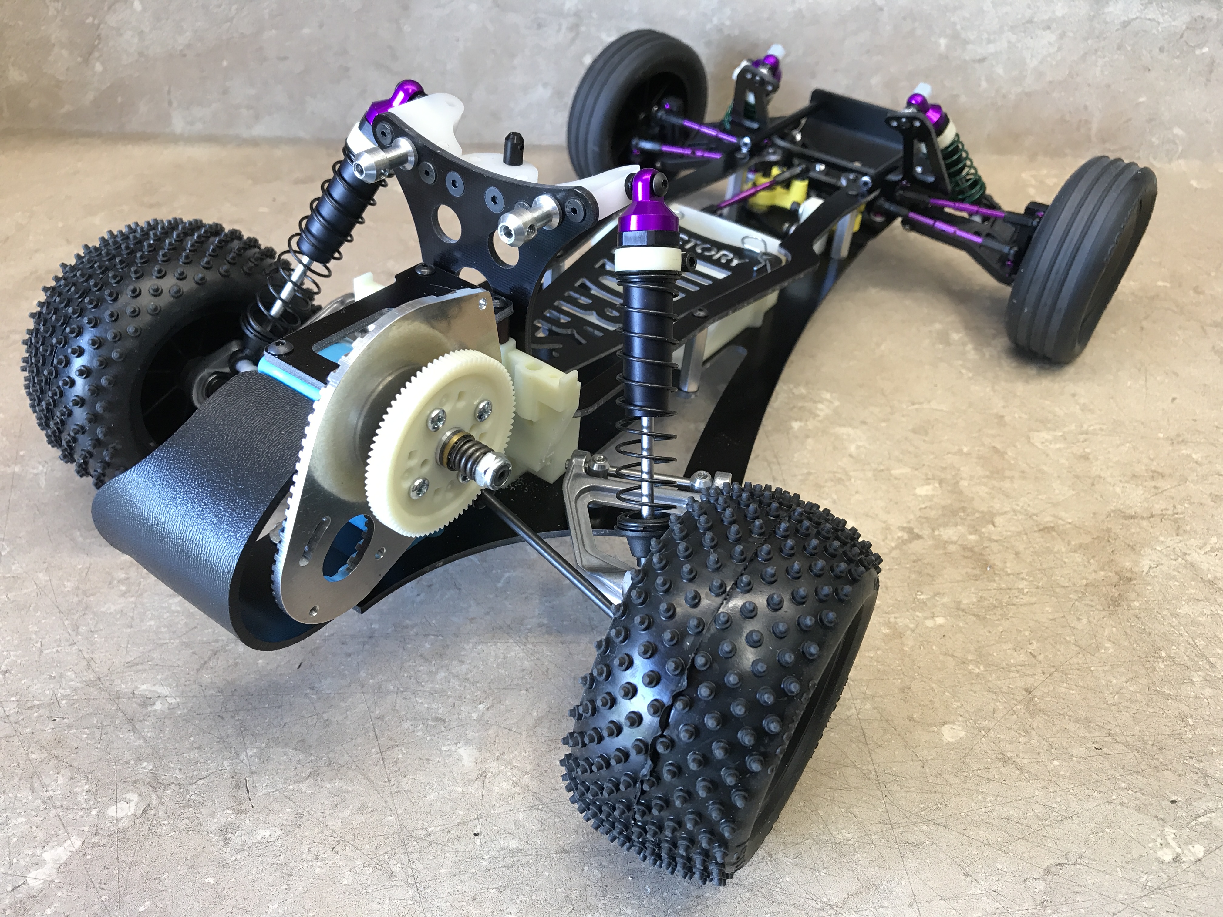

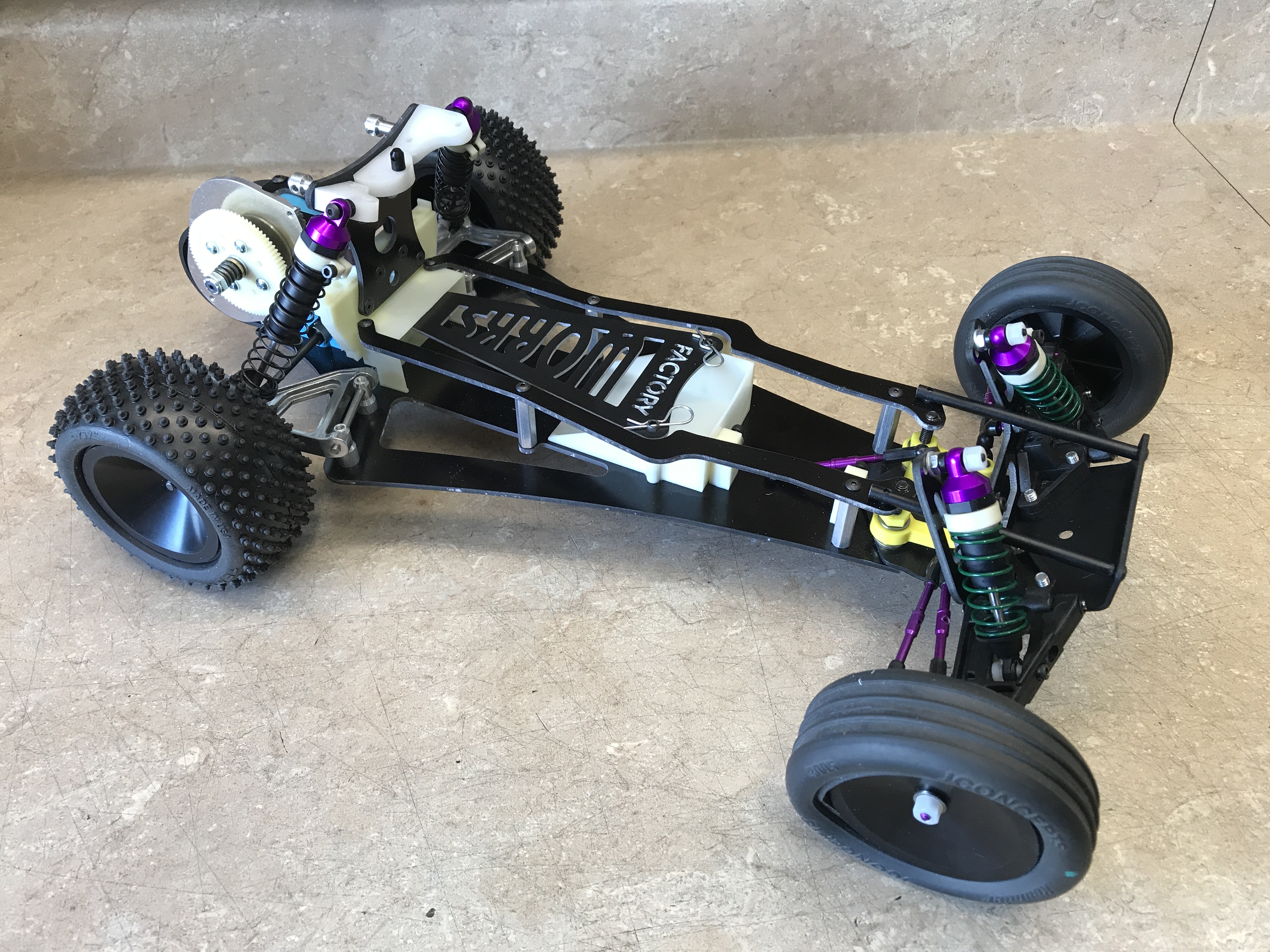

Factory Works C2.1 conversions

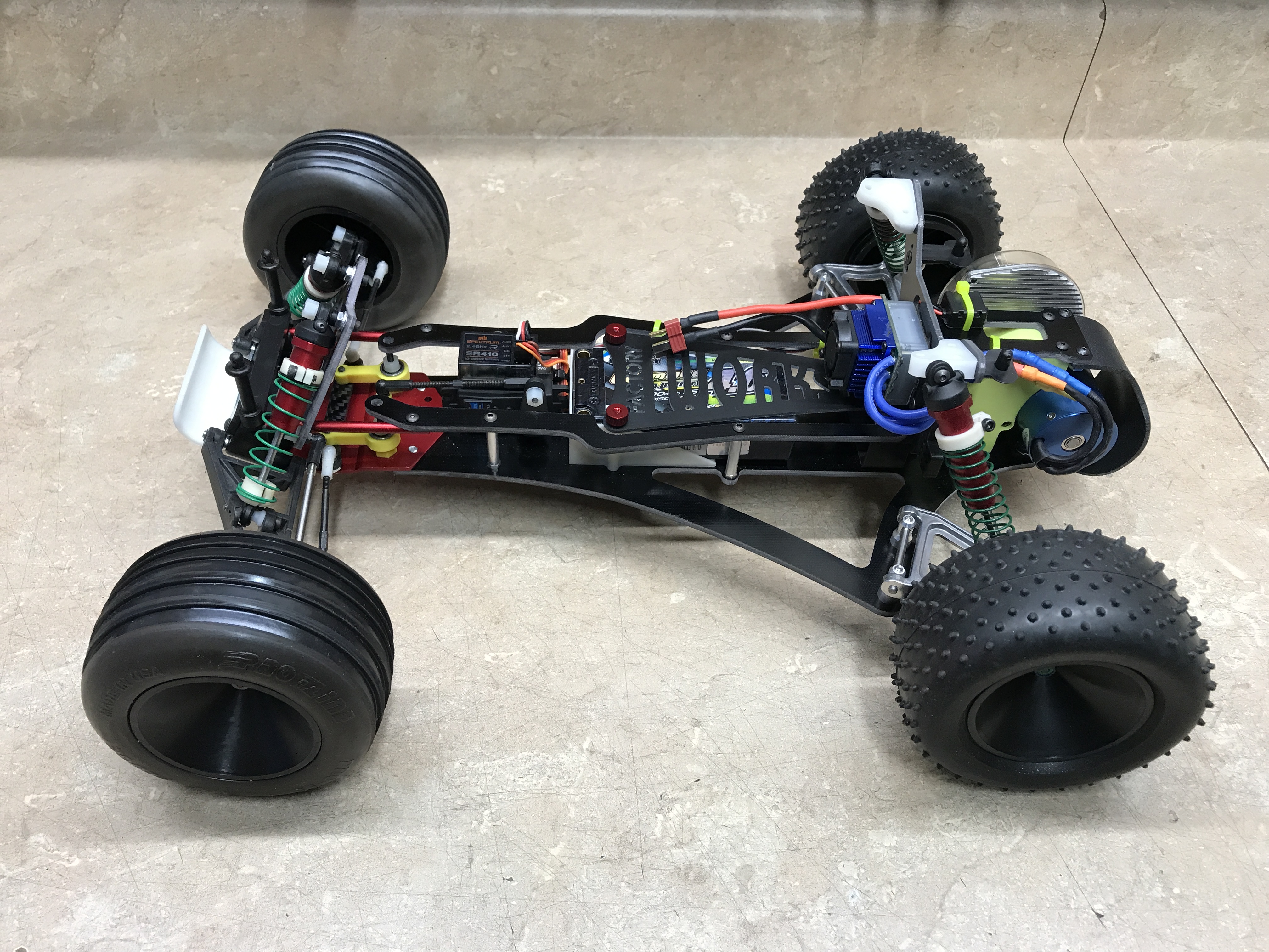

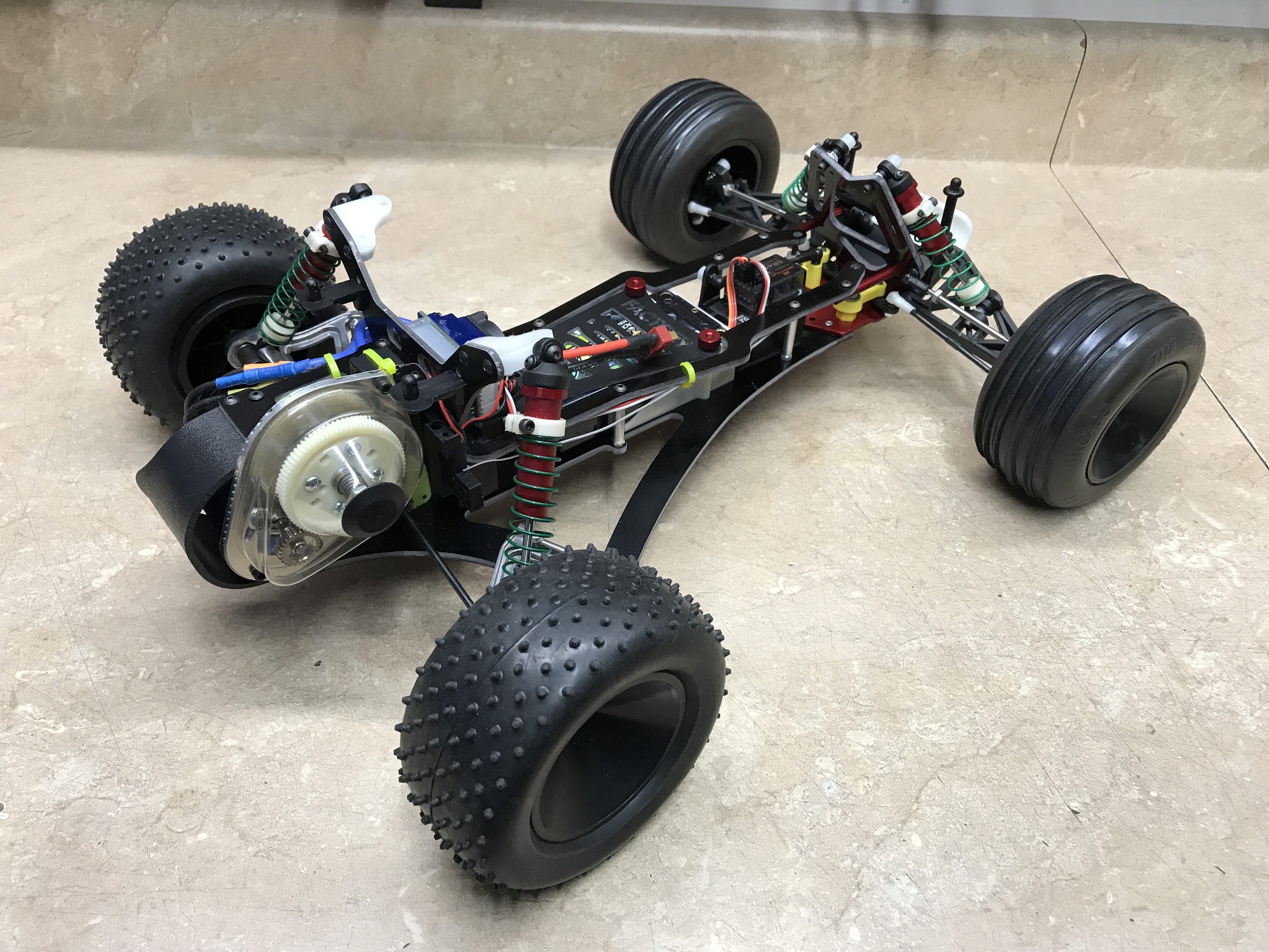

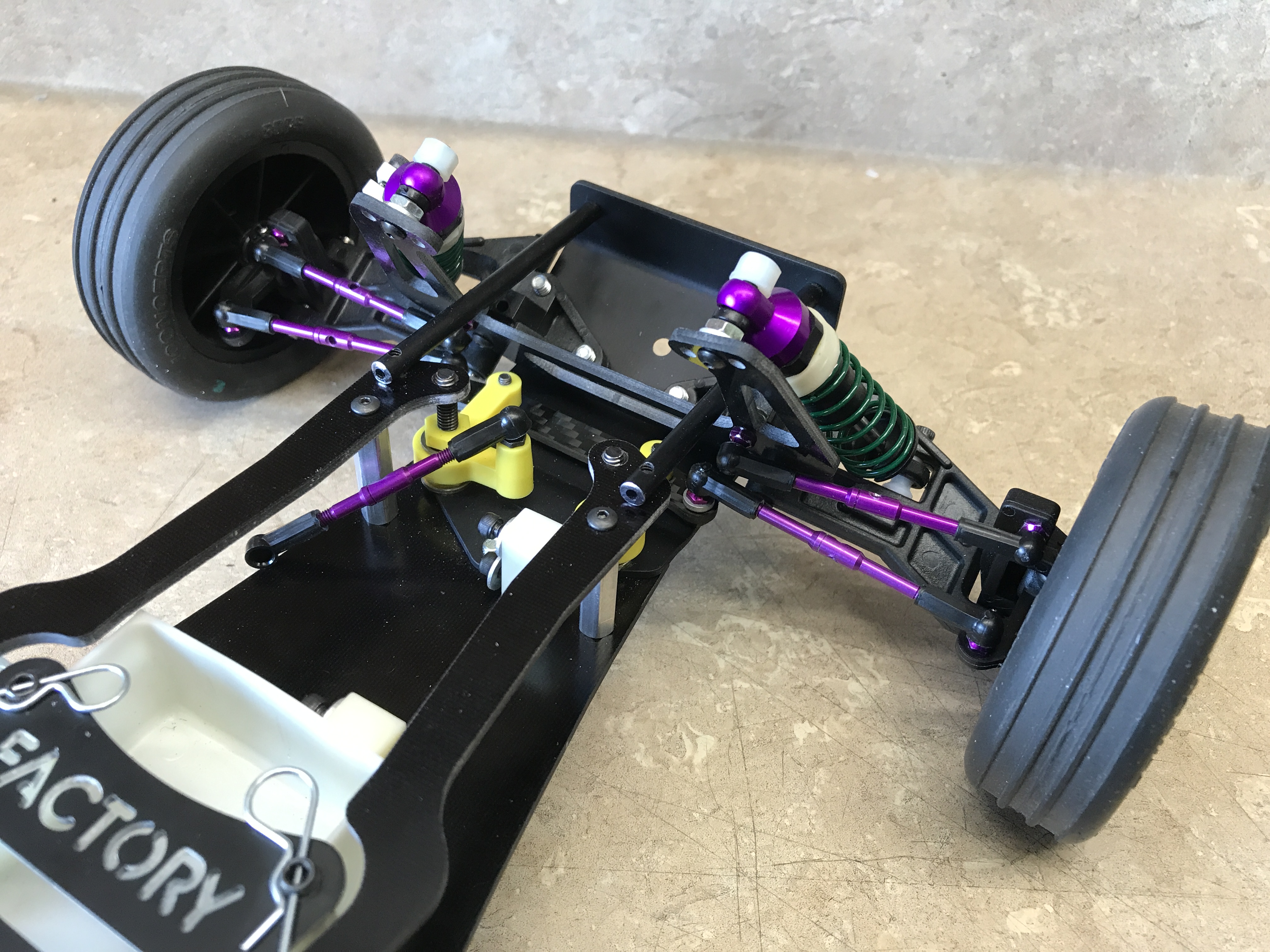

Well, the C2 chassis was due for an update. The "2.1" versions have a narrowed chassis and are braced for rigidity. They are now drilled for the Lethal Weapon and 6 gear, and can be special ordered for stealth. The truck version requires A&L or Worlds steering and will require narrowing the rear rims or spacing the wheels slightly (The wheels don't rub, but the tires can) The fitment of electronics is tight, so smaller receivers and speed controls are preferred.

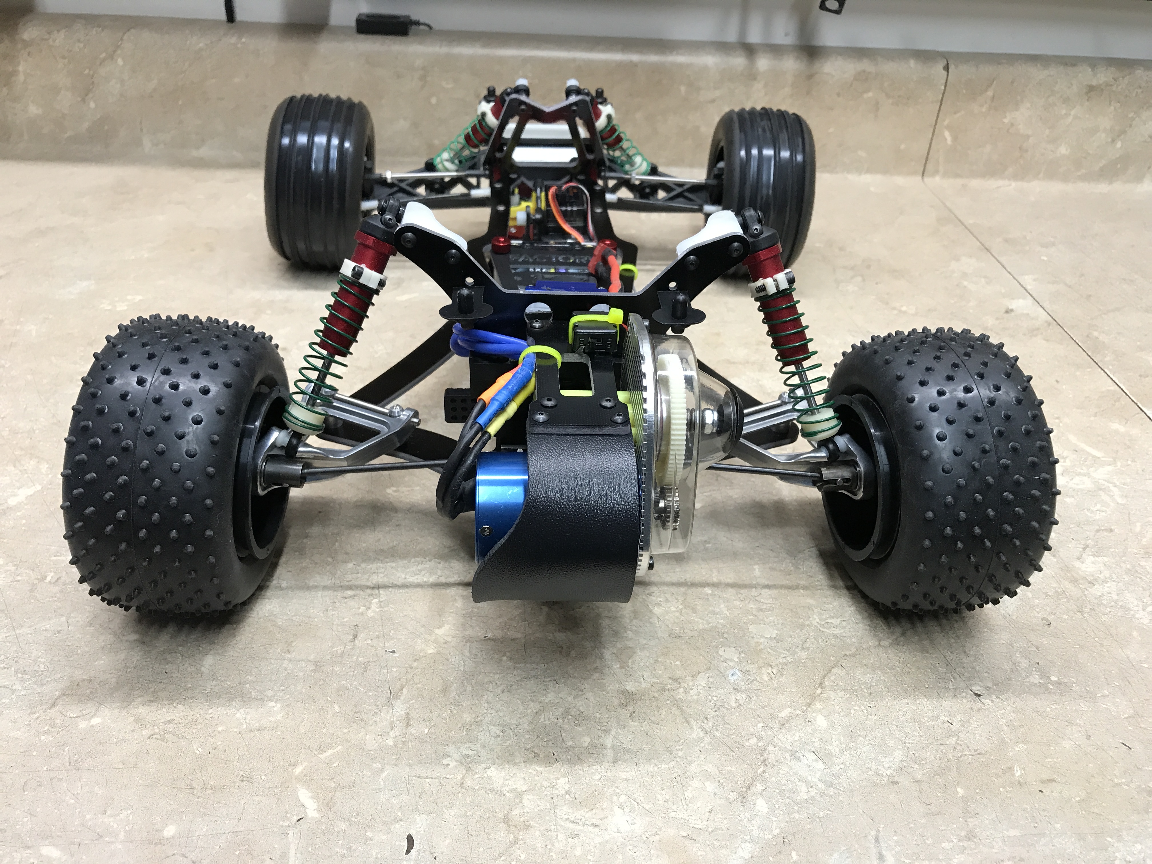

Hi Jeff,

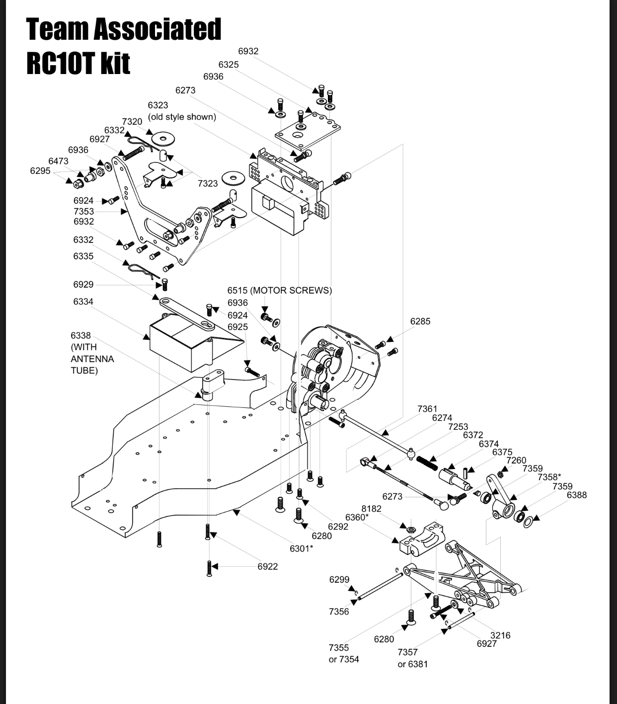

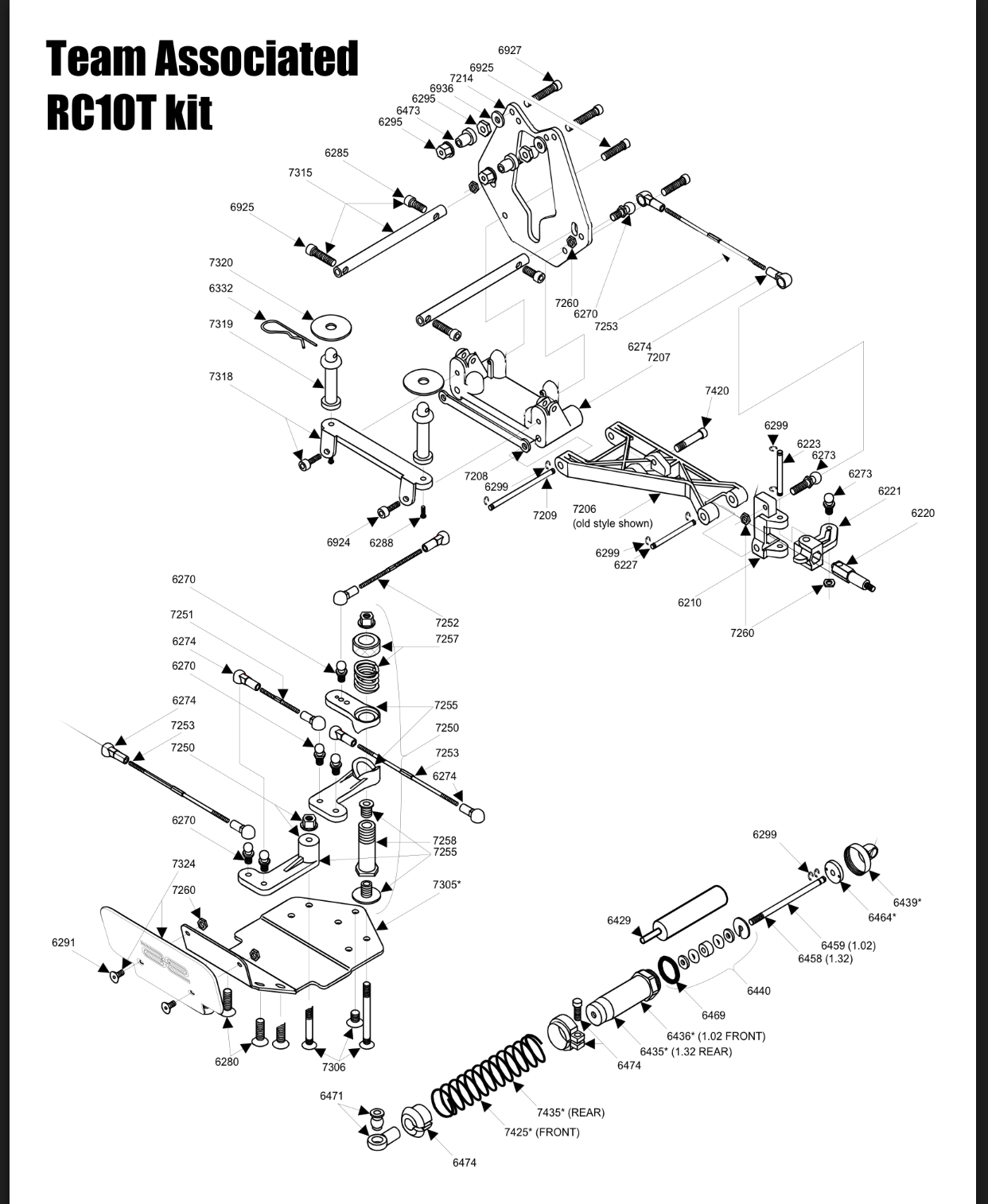

I'd like to build a truck on the C2.1 platform. I don't now anything about Associated truck parts and will need some serious help! The only thing I have for parts are a Stealth transmission and some Worlds re-release front end parts (plastics). When you get time, could you provide a list of parts I'd need?
Bum on Direct Deposit
Posts: 12335
Been thanked: 3917 times
Re: Factory Works C2.1 conversions
The truck front end is completely different. You would probably be best to locate a clip off eBay. The major parts that are different from buggy are the tower, bulkhead, turnbuckles, arms and hingepins. The buggy caster blocks and steering arms are the same. In the rear there are similar differences on a stock truck but for the sake of the trailing arm chassis only the bones are needed. Note that the rear wheel fitment is difficult on these, as the offset is very close to the trailing arm. A tire with a flat sidewalk will be best. You may want to chop off the inner part of the wheel and put the tire against the inside bead. Price you have to pay to make something work that was never meant to be haha

Thanks, Jeff. That gets me started on the parts search. If I get confused, I'll be back. :wink:

You can also modify a buggy noseplates to fit a truck bulkhead if you come up flat on the truck nose.

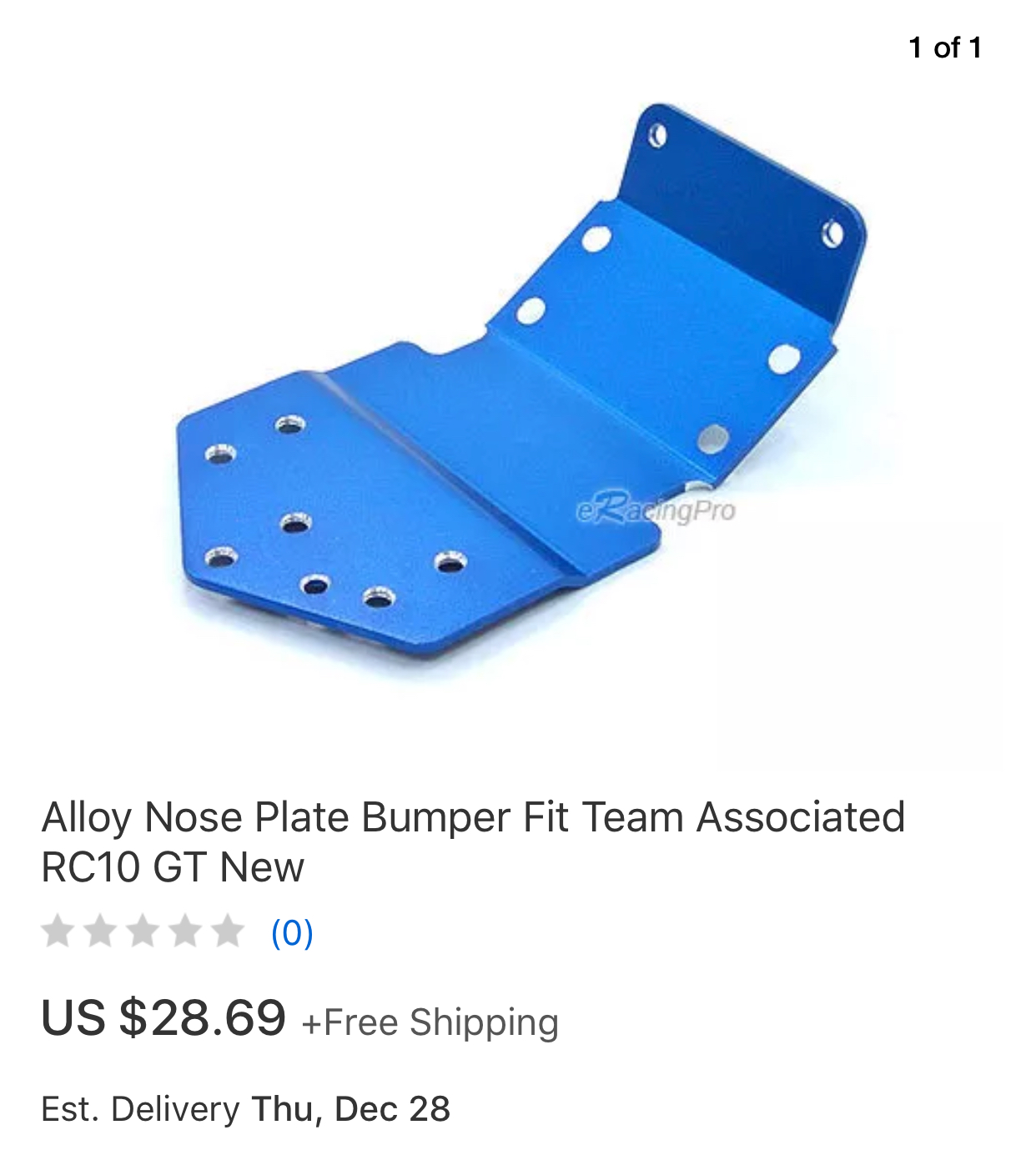

Although personally I’d probably just buy one of these aftermarket jobs
NomadRacer
Posts: 1467
Has thanked: 81 times
Been thanked: 79 times
Post by NomadRacer »
Heck yeah, aftermarket looks to be the deal!

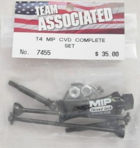

Will these CVD's work with the trailing arms?
Posts: 12335
T4 is too long I’m pretty sure :shock: b2 and b3 would be fine.
The other issue is the 3/16 axles. You can run them but they take a special 3/16 x 3/8 flanged bearing to make them work.

Well, I'm not able to find any B2/3 CVD's on eBay. What axles and dog bones would I need?
Ahhh, 10T's right?
