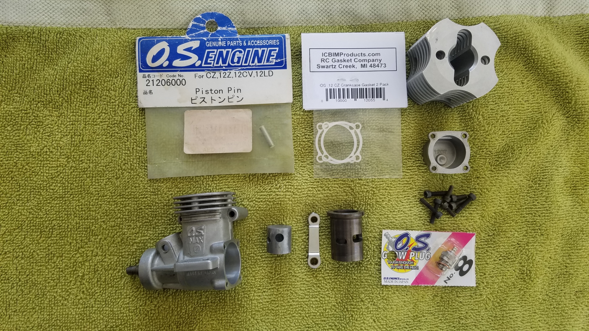

Finally got my OS Max CZZ back together today. New rod from Hong Kong, new piston pin from Dubai. New OS 8 glow plug, Fasteddy bearings and new gaskets. The carb got all new seals too, and everything was cleaned thoroughly.
Then one idiot slammed it all back together. Is it right? Who knows?! But the engine holds some compression. Good compression? Probably not. Good enough compression? Hopefully.

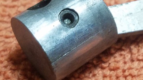

This is what the piston and rod looked like before the rebuild. Same piston that it still has.
os engine 3.jpg (29.05 KiB) Viewed 2372 times

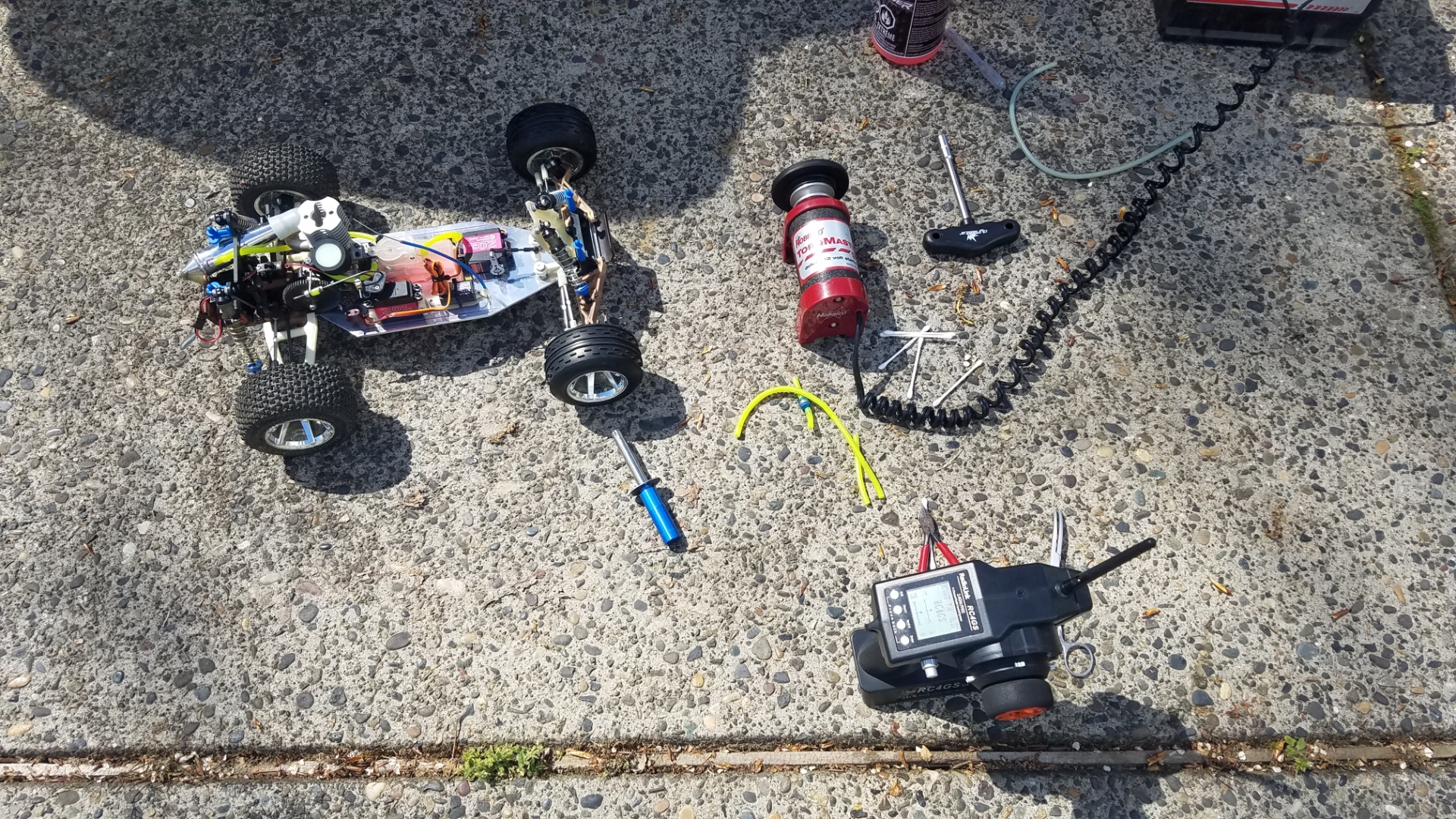

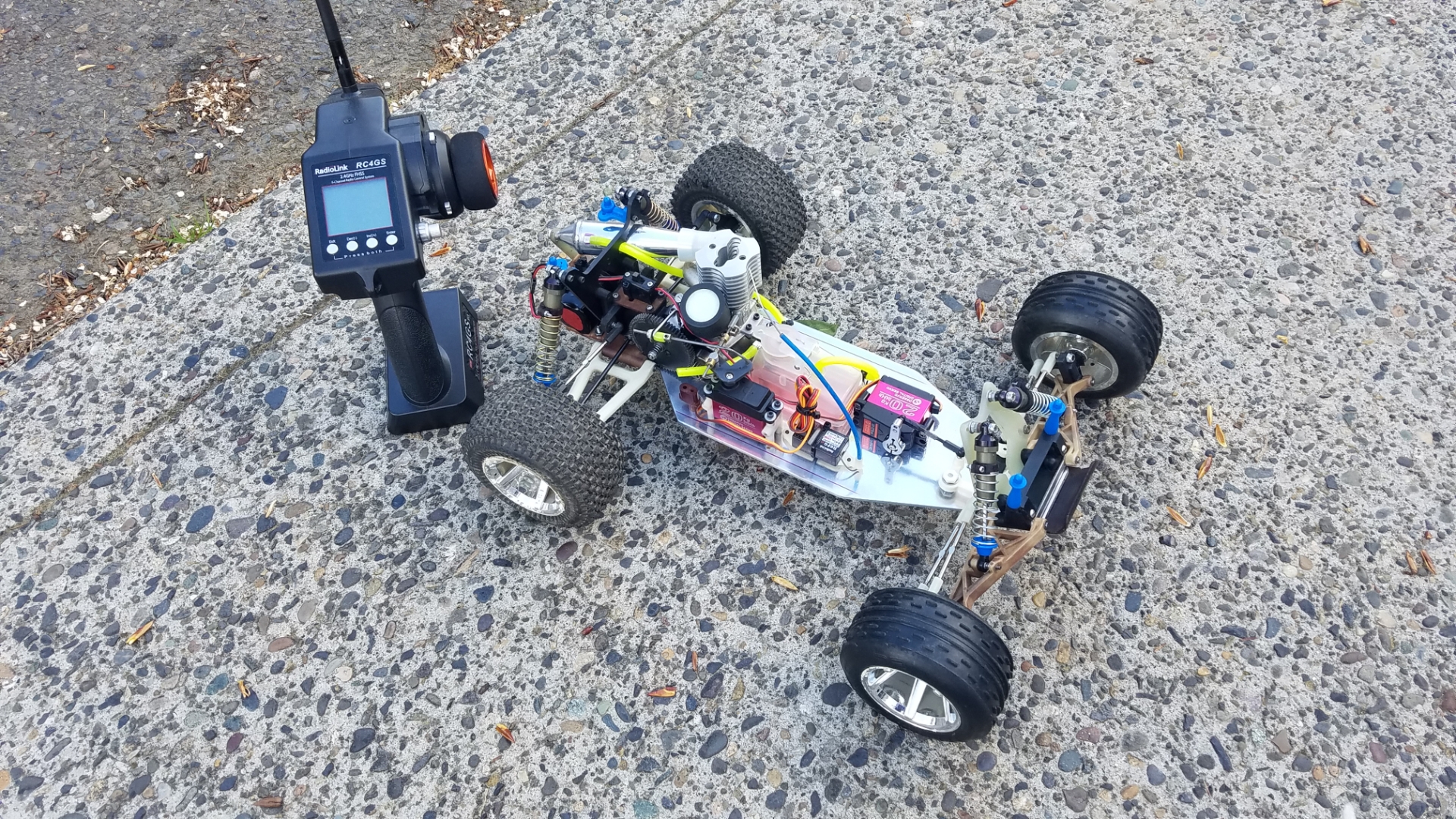

Yes, yes it will. Got it fired off for the first time. It ran horrible, but it moved. Accelerated, braked, steered. Got up to temp and seemed fine. The previous owner tells me it's the first time this car has moved in 17-20 years. It's kind of incredible to me, after seeing what condition it was in when I got it.
Now I need some help. It moves kinda fast at idle. I feel like it might be idling too fast causing the clutch to grab and move the truck? How do I slow down the idle? I have more questions, but I'll save them for once I get the thing to stop on my command, because right now my inputs are only suggestions. Thanks again RC10talk, you guys have helped massively through this build so far.

klavy69
Moderator
Posts: 5208
Has thanked: 639 times
Been thanked: 294 times
Re: The OS CZZ is back together, but will it run?
Post by klavy69 »
ZED32 wrote: Tue Apr 09, 2024 6:56 pm
sounds like you need to shorten up to the 1mm gap mentioned above by RJ with the idle screw. You have a picture of inside the carb at idle?
Another possability is your clutch shoes are sticking. Don't see pics of what you used but if they are the original clutch shoes you can clean them up/sand them on the contact side to get them to work properly or get an MIP 4n1 clutch shoe set and install.

ZED32
Posts: 240
Has thanked: 166 times
Been thanked: 242 times
Post by ZED32 »
klavy69 wrote: Sat Apr 13, 2024 12:12 am
ZED32 wrote: Tue Apr 09, 2024 6:56 pm ?
For one, I had the brakes adjusted wrong, so that definitely factored into it. I'll try shortening the idle gap, and too rich is definitely better than too lean.
