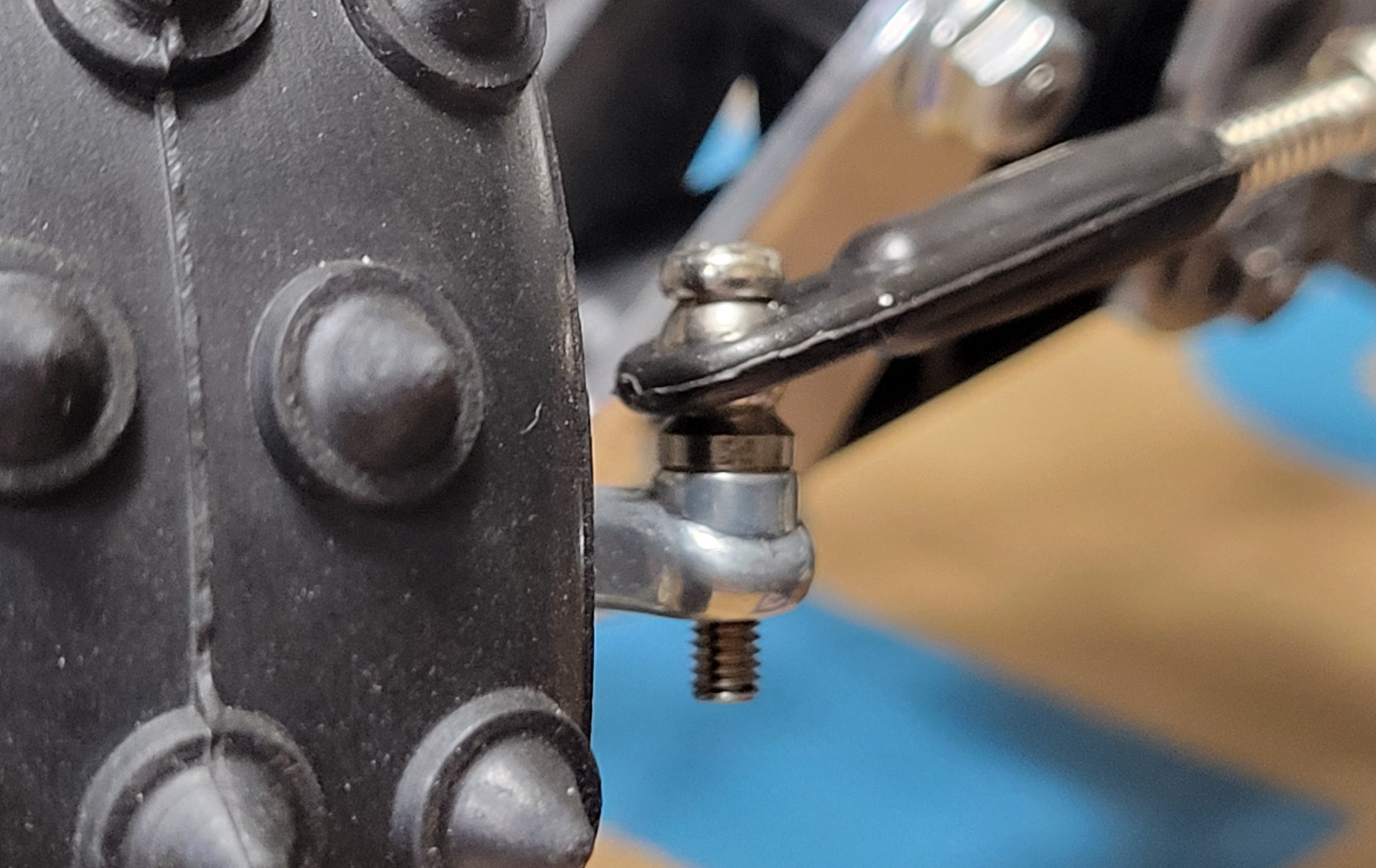

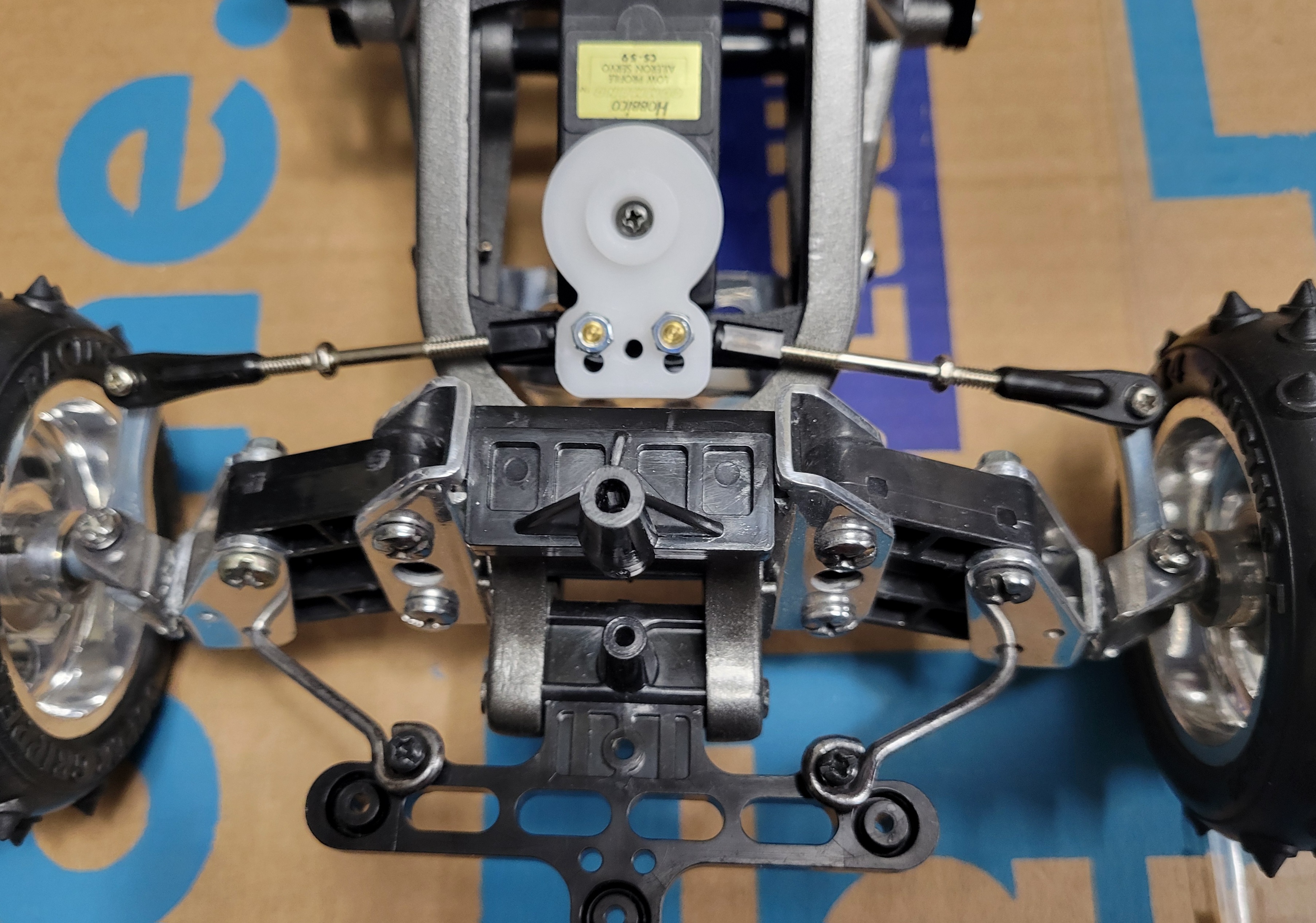

Just got around to fixing mine. 2-56 ball ends and conical spacers. Ball and spacer opened up the allow the M2.6 screw to pass, and plastic end opened up to 3/32.
Traxxas servo saver and 3mm turnbuckles.
