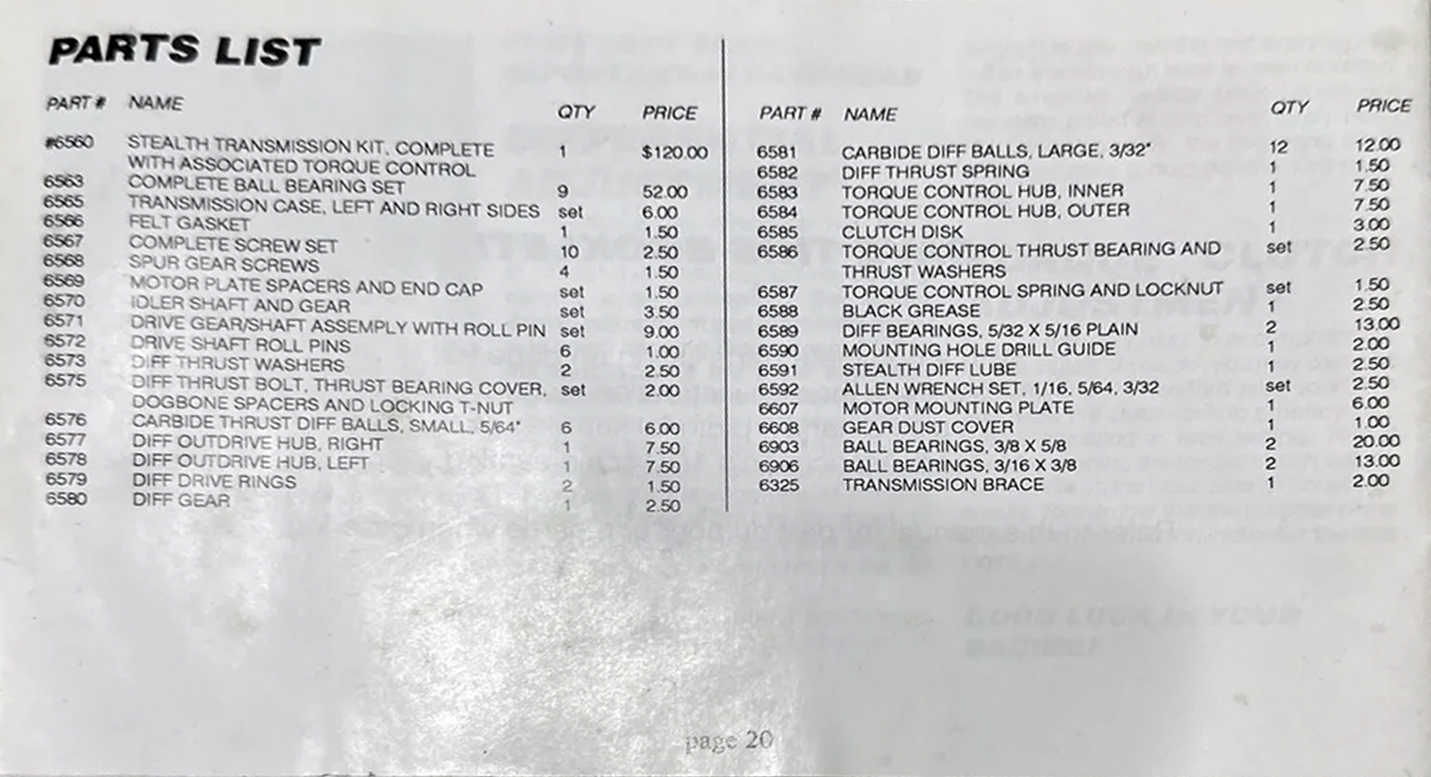

Can anyone kindly list all the parts for a Stealth transmission? I already have the ASC6565 transmission case.
This means I need all the parts for a ASC6560.
I know nothing about the Stealth transmission as I only have the 6 gears version transmission over the years.
Because I want to build the Ten4.
Many Thanks 🙏

Photo of the parts list from the back cover of the Stealth manual...

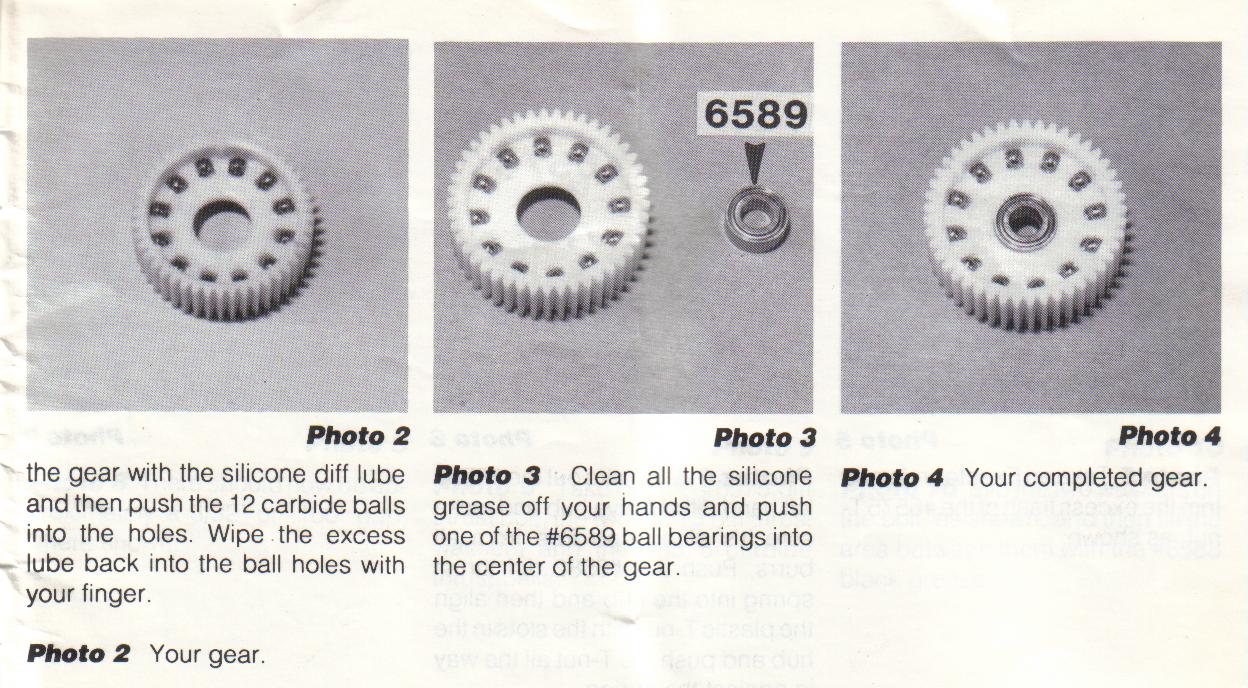

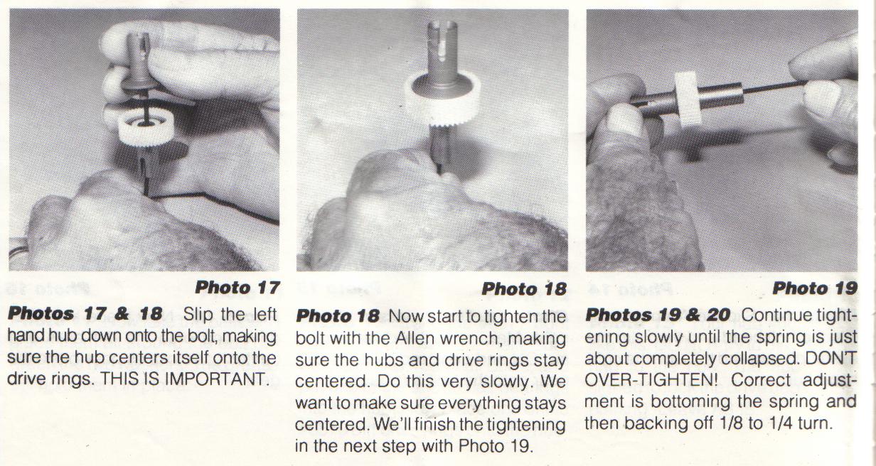

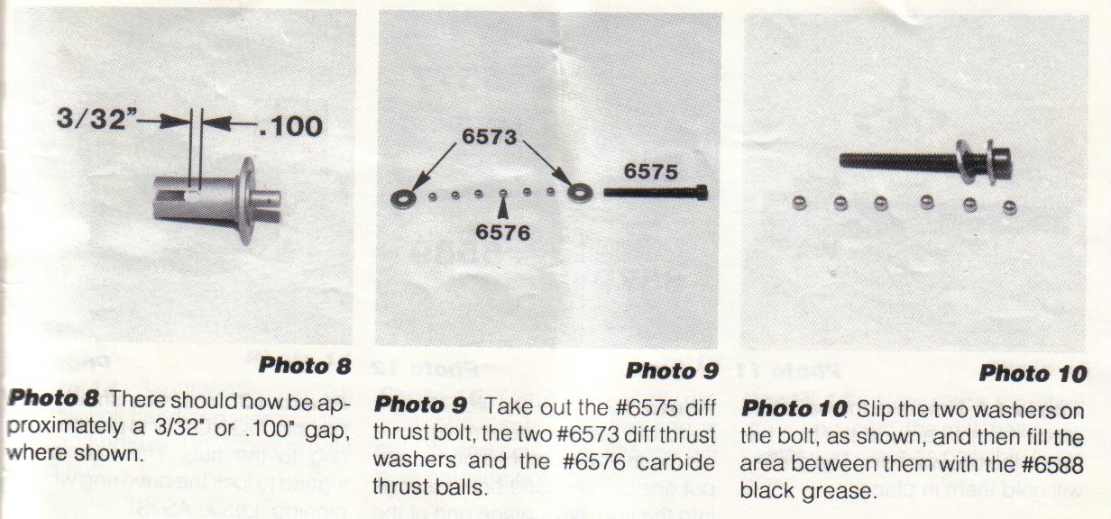

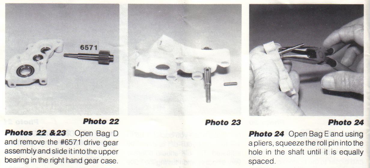

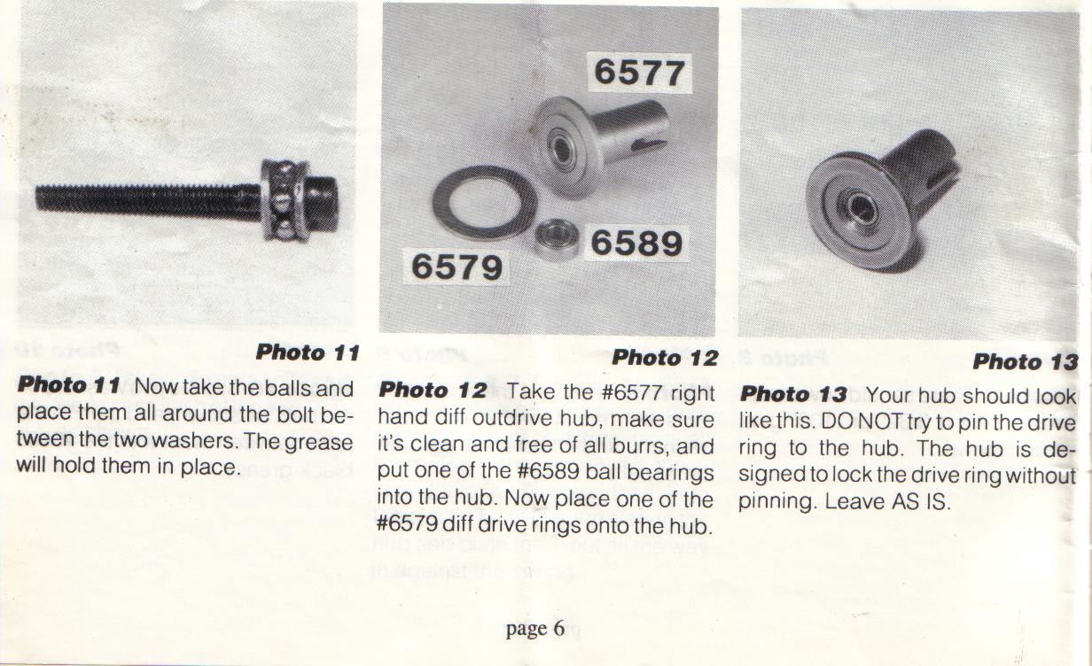

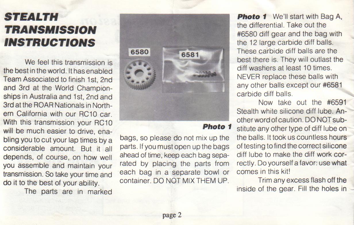

Original Stealth instruction manual, scanned and uploaded by superfly... should you require instructions:
https://www.rc10talk.com/viewtopic.php?t=1454

That idler won't work for the Ten4
FC5687
Posts: 43
Joined: Sat Sep 30, 2017 12:29 pm
Has thanked: 4 times
Re: Need help for the parts list of a Stealth transmission!
Post by FC5687 »
Oh you are right.
So I should get the 6571, not the Idler.
