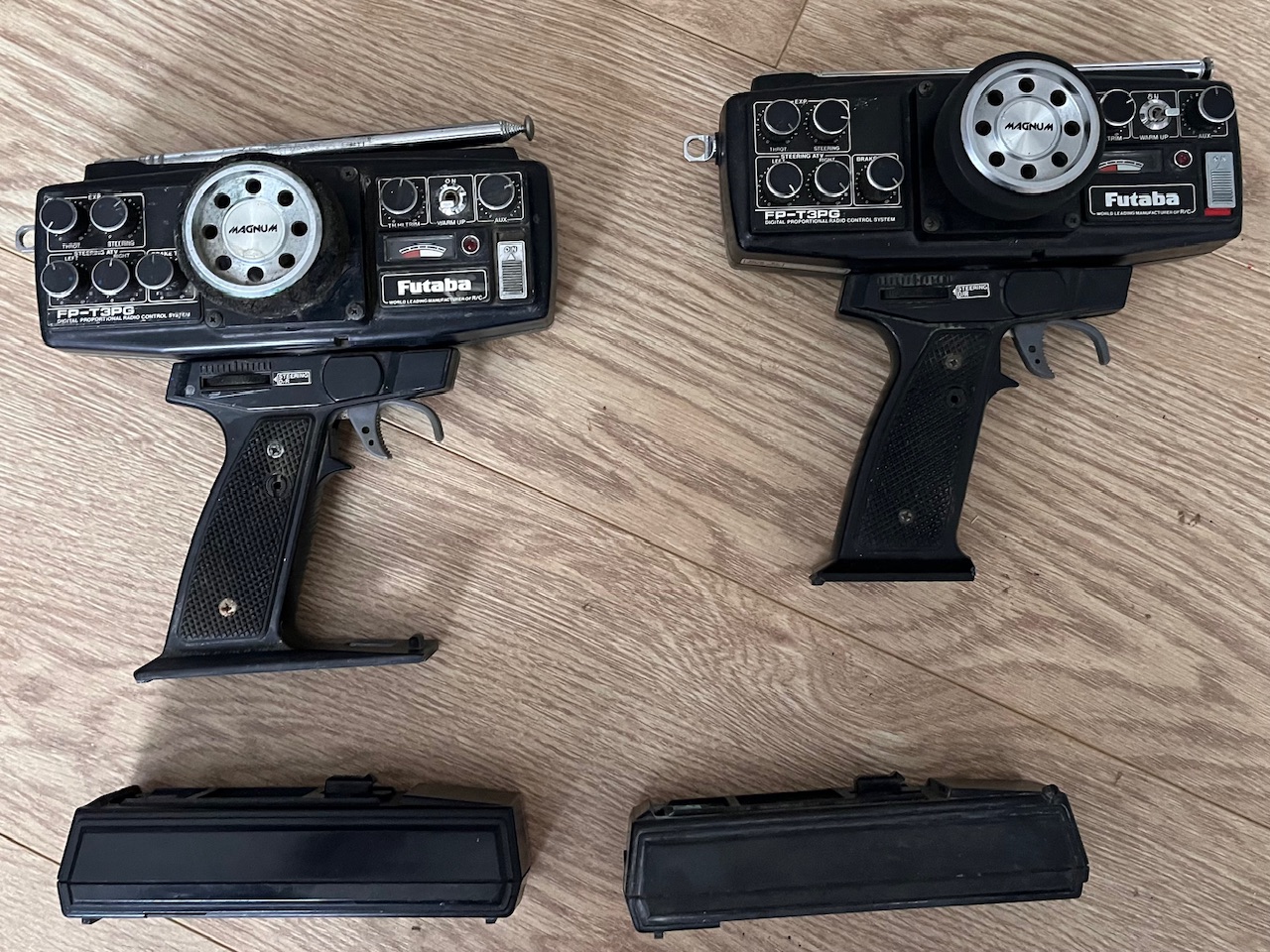

I won an auction on a second more complete one.
The new one was in rough shape with a lot of oxidation on the metal parts. As well the trigger was sticky.
I started to tear down the recent one to see if I can transpose plastics.

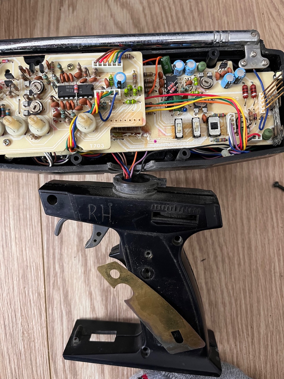

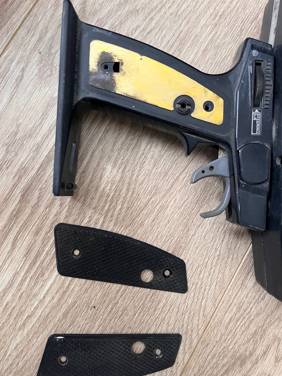

Most unexpected is that the pistol grips are removable.
There are brass plates underneath that are soldered to the negative/ground plane.
The grip portion can’t be fully split until the back of the controller is removed. It holds the split sides together. As well there is a screw in the case right over the split area that controls the tightness of the rotation. It looks like if you tighten this down you can lock the controller at a preferred angle.

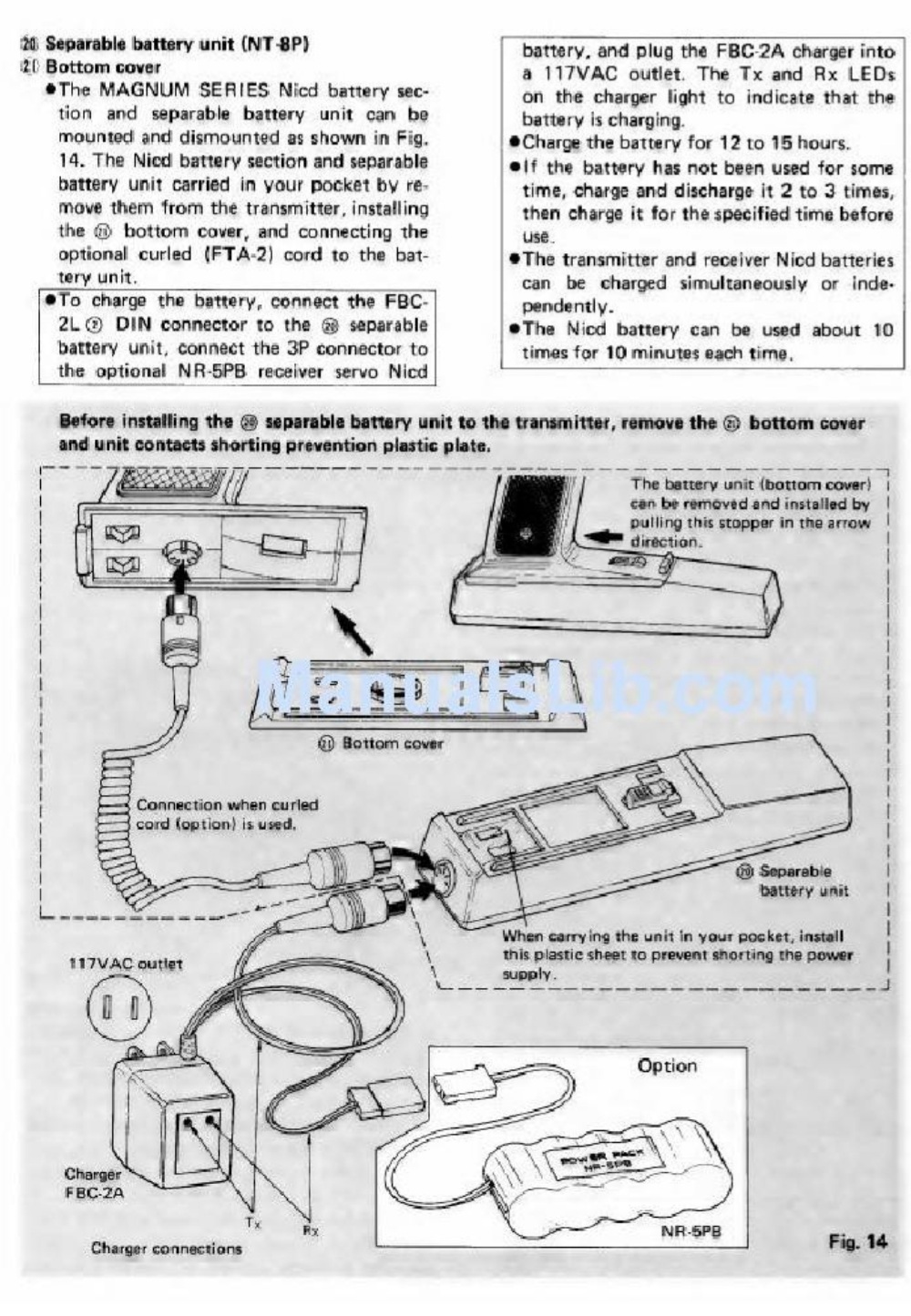

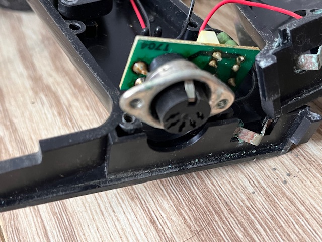

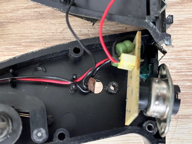

Here is behind the din connector that the controller used to charge as well as for external power.
It looks like it would be simple to use a life or lipo battery externally using a custom din plug.
