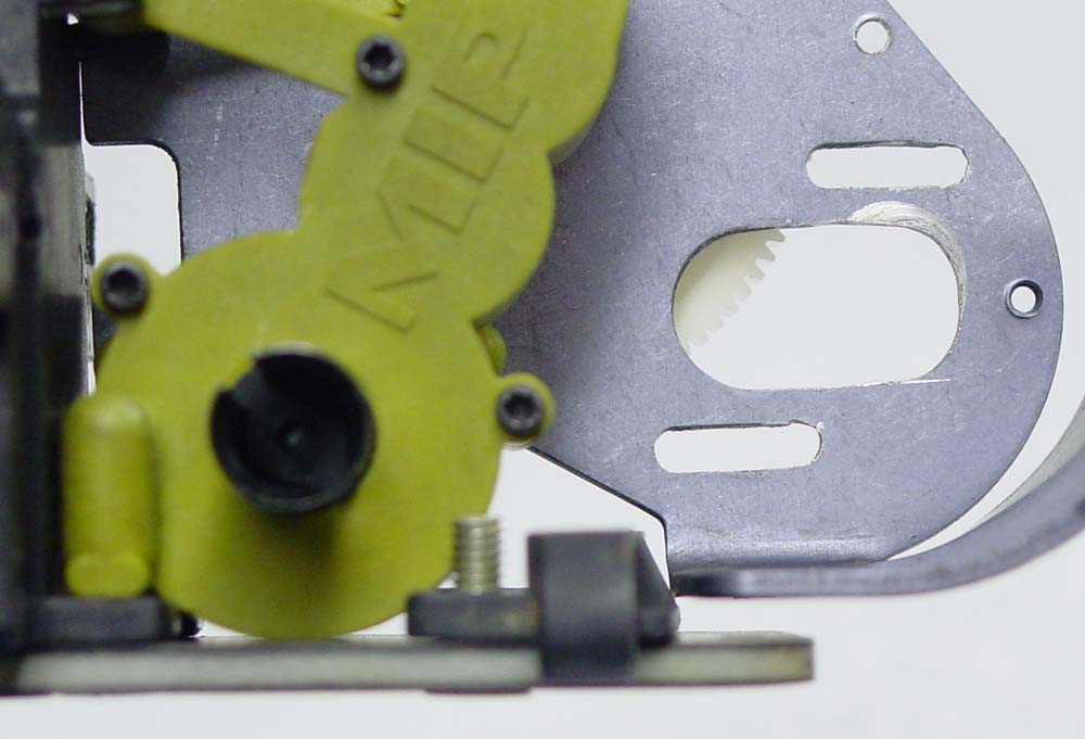

I finally got ahold of a mip transmission for the losi cars. The case is a bit more of a snot green than a nice yellow, but it will do for now.
I got it rebuilt and tried to install it. The instructions specifically say to use the stock screw in the lower part of the motor plate through the chassis to bolt the plate down, but the motor plate is about 1/8" off the chassis. At first I thought that maybe the used motor plate was a little bent up, but that is unlikely as the 2 surfaces are nearly parallel, and a nip plate I put on after the pic had the same gap. The bottom of the gearbox is flush with the chassis, and the lower mounting area is flush down on the bulkhead tabs. If I recess the chassis like the xx-retro trans requires, then the top screw will not line up with the bulkhead.
Did I do something wrong? are they all like this? I could use a spacer and a longer screw I suppose.

well, the first thing i had typed up was to say..... just stick some washers under the motor plate. but i didn't want to seem like a hack, ya know?
then, i remembered the scan i the archive. and what does mr. moore say to do? just stick some washers under it.

I agree, washers would be quite hack, but Shims are perfect for the jobscr8p wrote:well, the first thing i had typed up was to say..... just stick some washers under the motor plate. but i didn't want to seem like a hack, ya know?![]()
then, i remembered the scan i the archive. and what does mr. moore say to do? just stick some shims under it.![]()

aconsola wrote:I agree, washers would be quite hack, but Shims are perfect for the job![]()
.030 plastic shims to be exact.

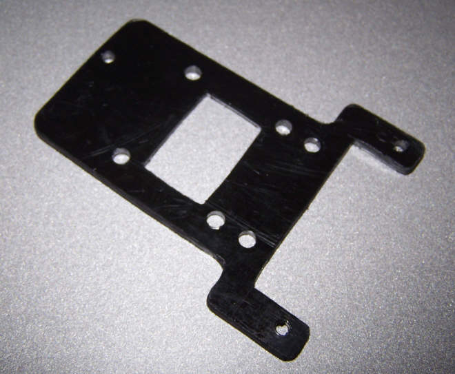

In my opinion, the MIP solution is cheap at best.
The real solution would be to cut a slot in the chassis (not all the way through). This has happened to me in the past with the trans and this was the only solution that worked when using one of the plastic chassis (pro se, lxt, jr2).
With the graphite chassis, you can space the rear bulkhead and motor plate so that everything lines up...but I don't like this idea at all.
Ironically, I'm building a jrxt and this is the step that I'm currently on. I'll post a picture of the slot when I'm done.

the slot isnt to bad to do I had to do one in my Prose for the retrofit trans, i just used a dremal drill press, I put a grinder bit then set the depth stop so I didnt go through, and held it down and moved the chassis around like a mill? it worked fine. looks good and the trans fits flush. some of the Losi plastic chassis come with the slot factory cut, my LX-T and Junior 2 has it. my pro se didnt?

I did the same thing when I fitted the MIP to a pro SE. The slot in the plastic chassis seem to be a little bit narrower than the one needed for the MIP.bearrickster wrote:the slot isnt to bad to do I had to do one in my Prose for the retrofit trans, i just used a dremal drill press, I put a grinder bit then set the depth stop so I didnt go through, and held it down and moved the chassis around like a mill? it worked fine. looks good and the trans fits flush. some of the Losi plastic chassis come with the slot factory cut, my LX-T and Junior 2 has it. my pro se didnt?

I would think that If you slot the chassis to get the transmission to sit lower then the top 2" screw mount into the bulkhead would not line up. Also it looks like you would have to cut the ears off the backside of the bulkhead where they sit under the trans mount points.

I didn't feel like getting a whole bunch of graphite dust on me, so I didn't slot the chassis. In addition, it looks like the slot would have to be almost 2.5mm deep. Don't want to take the chance of messing up a perfectly good piece, so I made a spacer out of kydex.
I have a decent surplus and it was pretty easy to cut. It provides support for the entire rear suspension. I also had to modify the transmission case by cutting a small portion of mounting point just above the 2 screw holes on the bottom. By doing this, the top mounting point lines up better.
