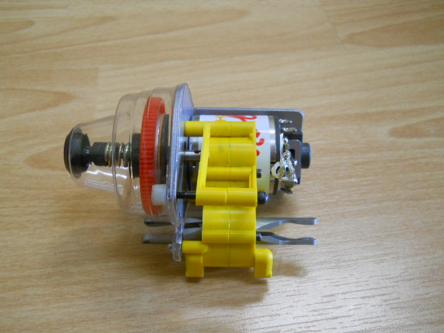

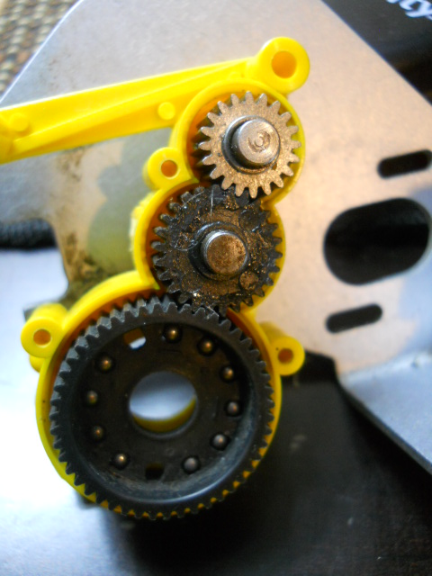

well i have a wanted list on the gears for this trans and bought the center gear off ebay for $15. was tring to build this on the cheap, THAN i tried the stock gears out of a rc10 stealth just for the hell of it and well....... guess what they all fit!!! had to use smaller bearings but the gears fit fine. the diff gear not 100% sure yet till i get the mip losi outdrives. also havent tried to see if the stock stealth slipper assembly will work yet. so what do u guys think??

Diff. gears are different!hugger19 wrote:well i have a wanted list on the gears for this trans and bought the center gear off ebay for $15. was tring to build this on the cheap, THAN i tried the stock gears out of a rc10 stealth just for the hell of it and well....... guess what they all fit!!! had to use smaller bearings but the gears fit fine. the diff gear not 100% sure yet till i get the mip losi outdrives. also havent tried to see if the stock stealth slipper assembly will work yet. so what do u guys think??
- Posts: 1191
- Location: Spokane, WA
- Has thanked: 170 times
- Been thanked: 23 times
Re: losi mip trans lb 1000 2000
hugger19 wrote:are they smaller??
I have not counted, but side by side comparison shows a larger bearing in the center and the ratio is 2.3:1 compared to the Stealth @ 2.25:1

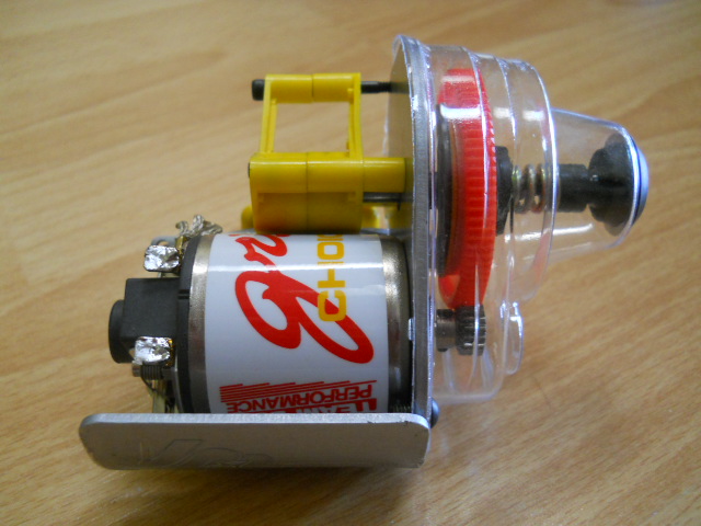

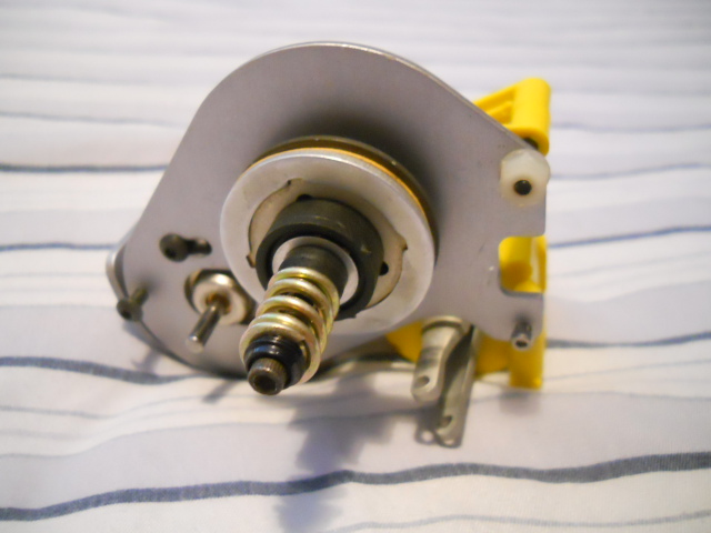

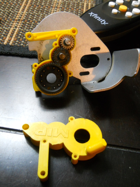

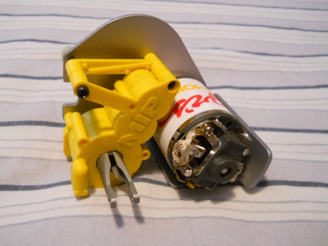

all done. so from a empty case i had laying around to a complete trans. used all gears from the stealth only used different bearings they were smaller than the stealth for the gears. the top shaft i had its a losi/associated hydra setup.
I love transmissions. This is a good lookin' tranny.
Mark
Mark
I really like the look of the out drives . Very nice. First time I've seen one of these.
