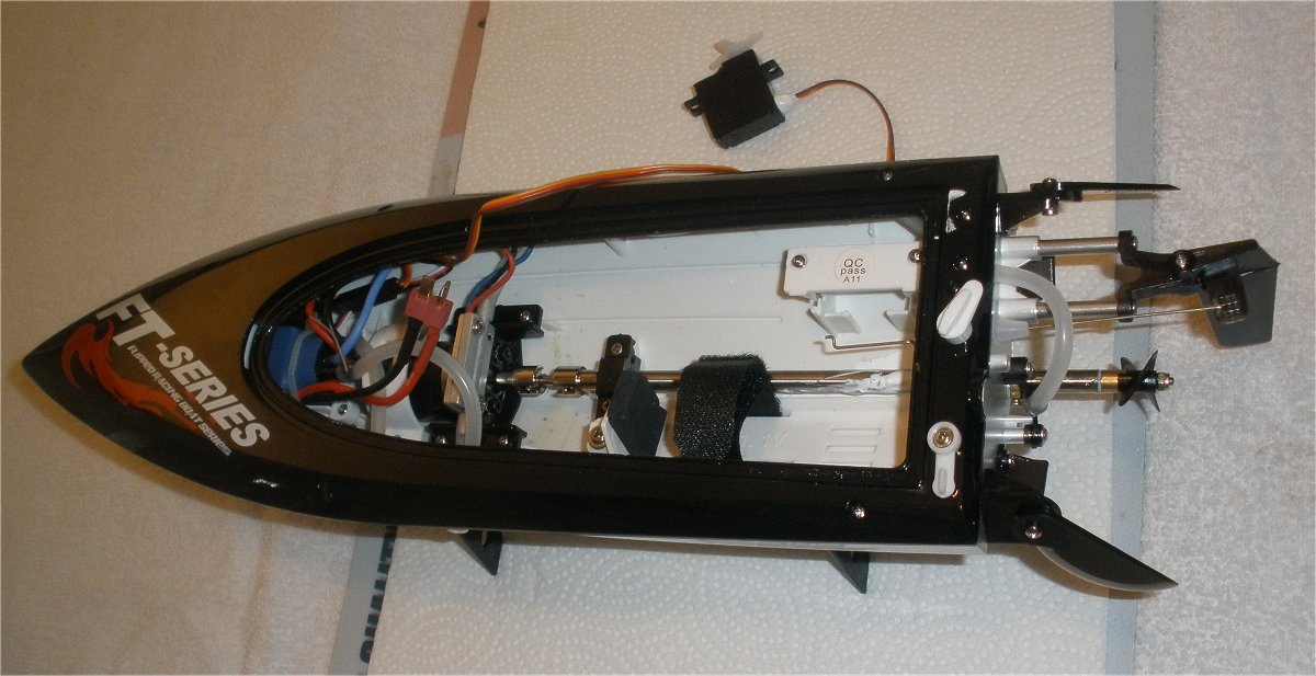

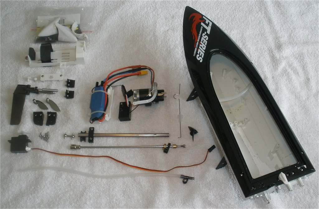

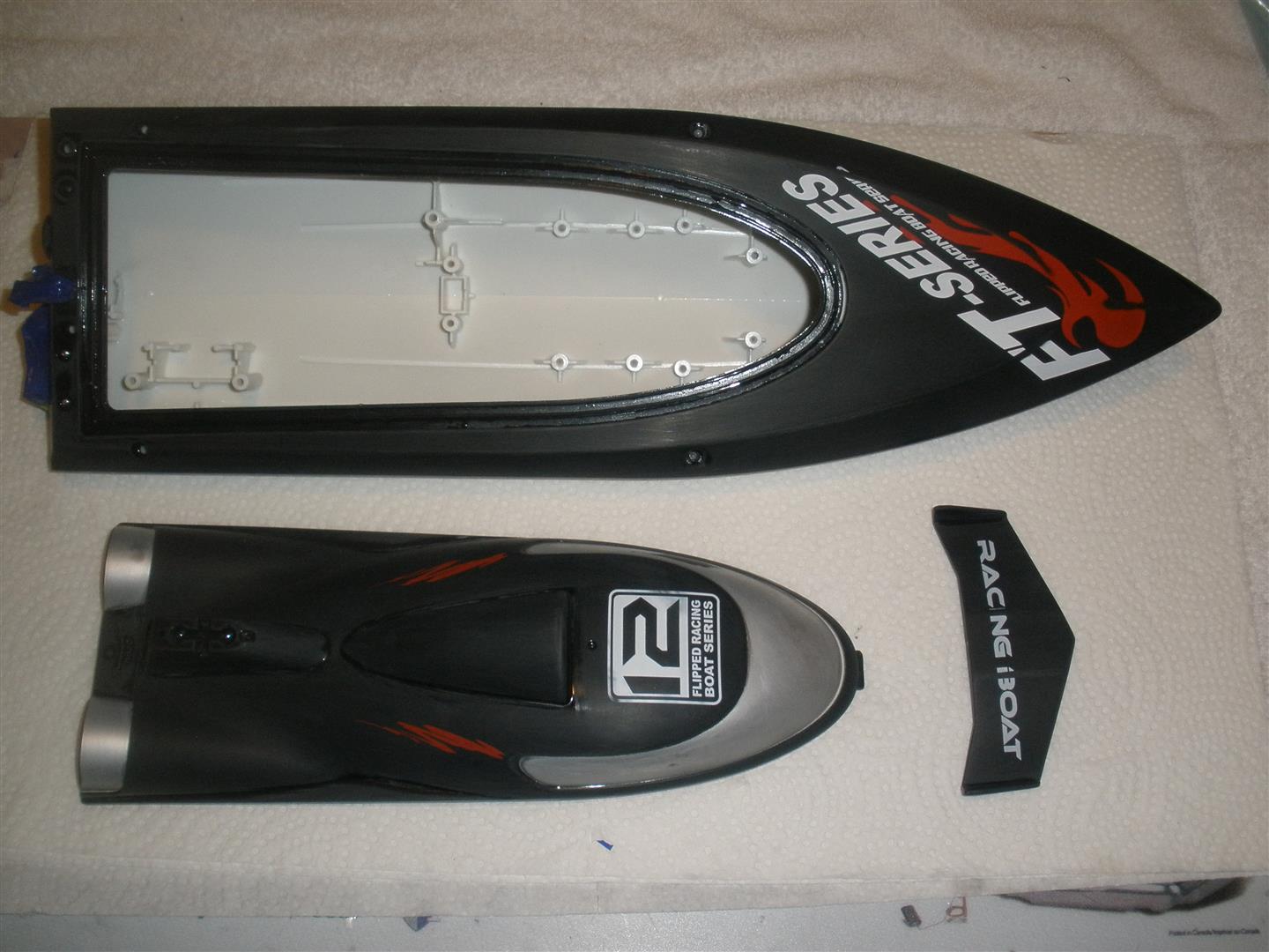

I received the boat a couple weeks ago, made sure the electronics worked because the box it shipped in was really beat up...I blame it on the shipping, not the seller, though. The stock box was packaged well enough to prevent damage to the contents. I'm never satisfied just running something out-of-the-box, and I didn't like the all-black color with cheesy graphics. I want a boat that's a bit more unique and more visible, too. The boat is only about 15" long, not including the prop & rudder. I got the boat on eBay for only $107 CAD with free shipping. Within days of pulling the trigger, I'd already sourced an upgrade metal prop, aluminum rudder assembly, a set of Atomik Barbwire stainless steel turn fins and some colored hose to go with the paint scheme I have planned. The boat comes with Deans connectors, but I'll replace those with XT-60 connectors for better waterproofing.
Here's the boat, stock:

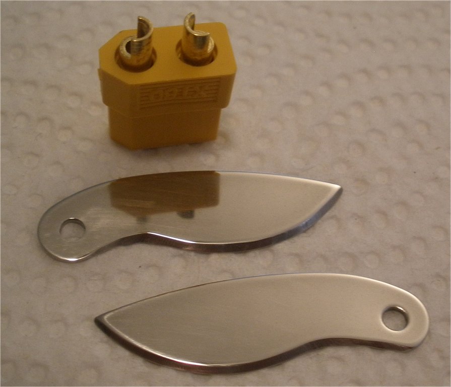

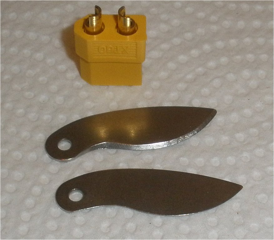

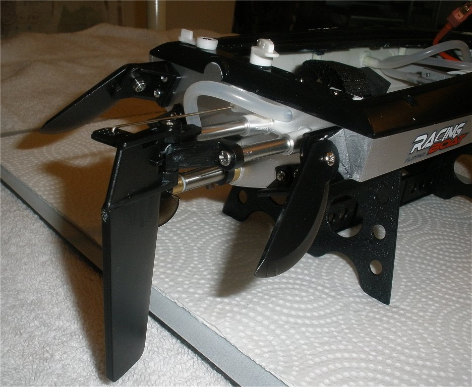

As mentioned, I'm upgrading the stock clunky plastic turn fins with smaller fins for the Atomik Barbwire boat, a suggestion I got from a guy over at RCGroups.com. Stainless can be polished, so that was the first thing I did, before stripping down the boat for painting.

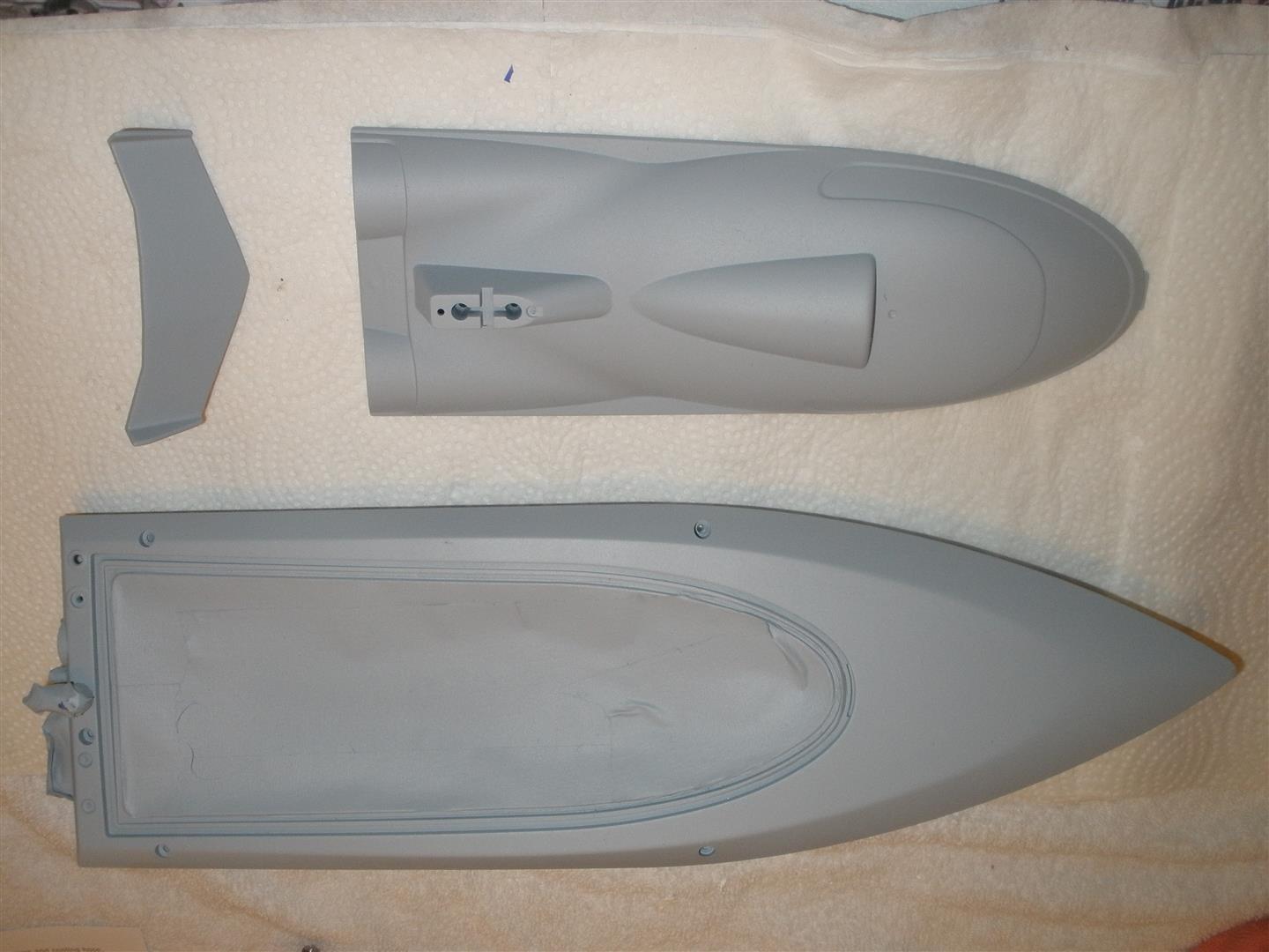

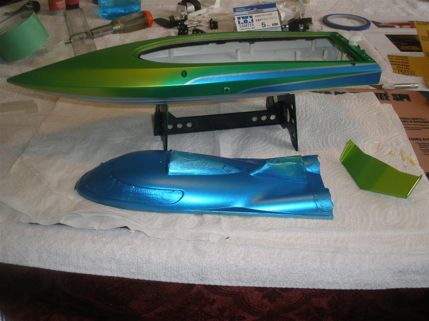

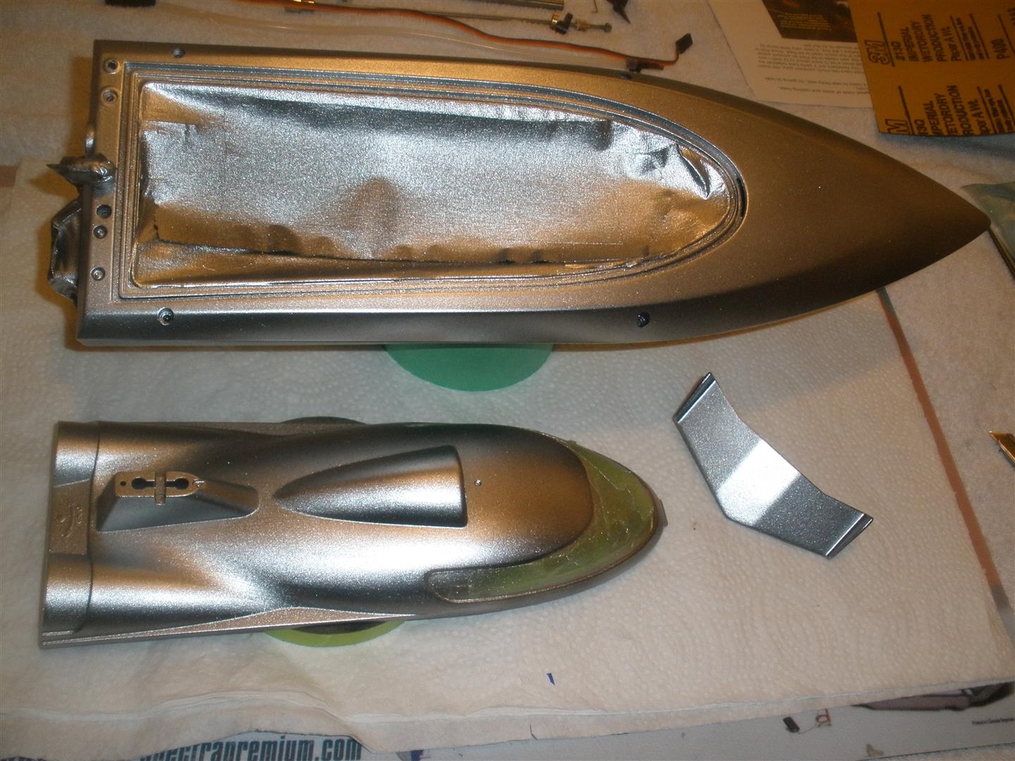

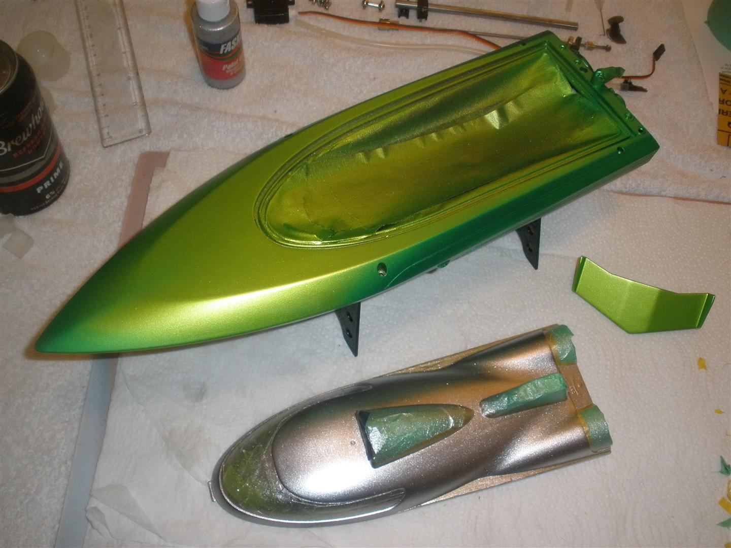

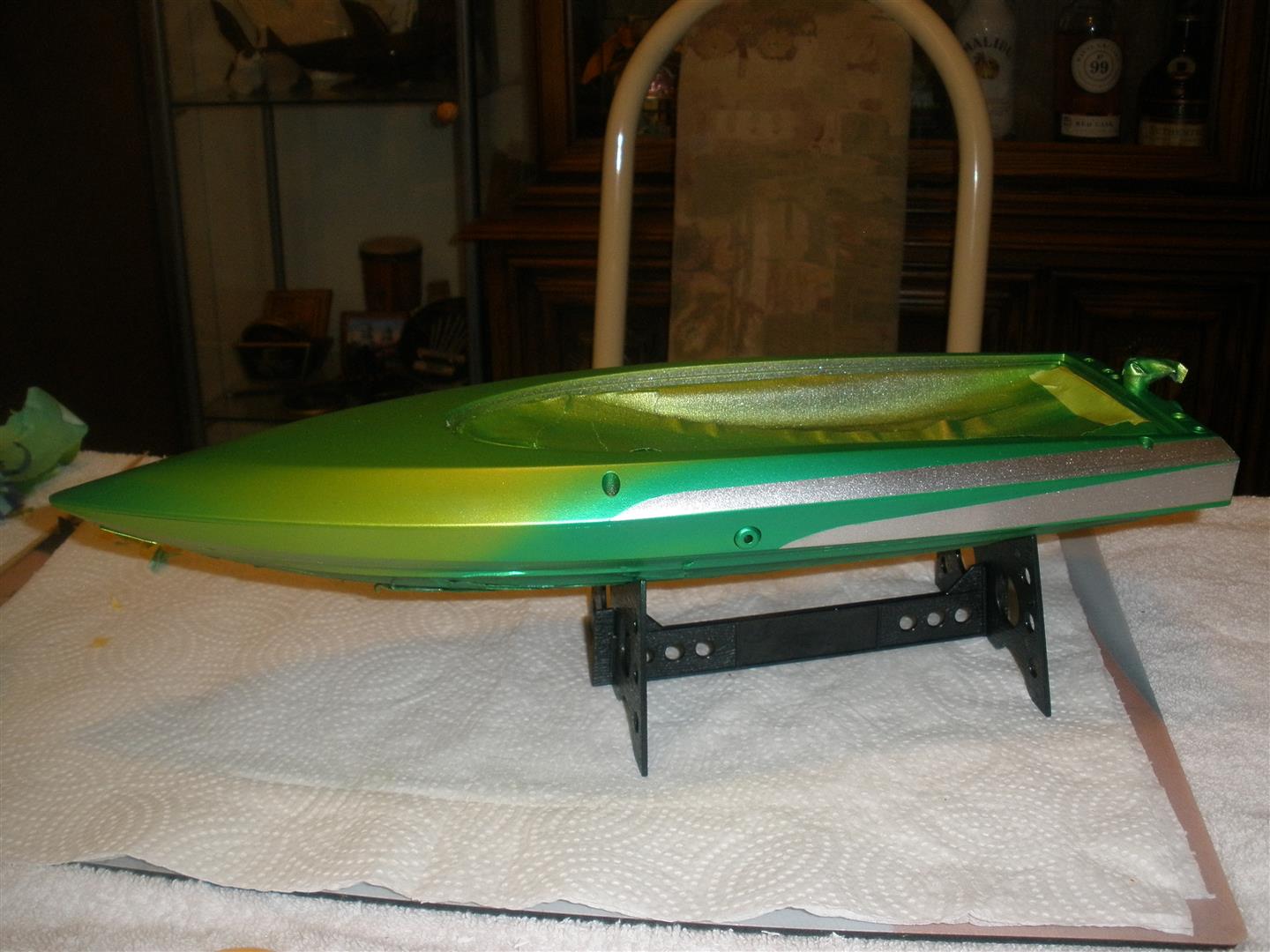

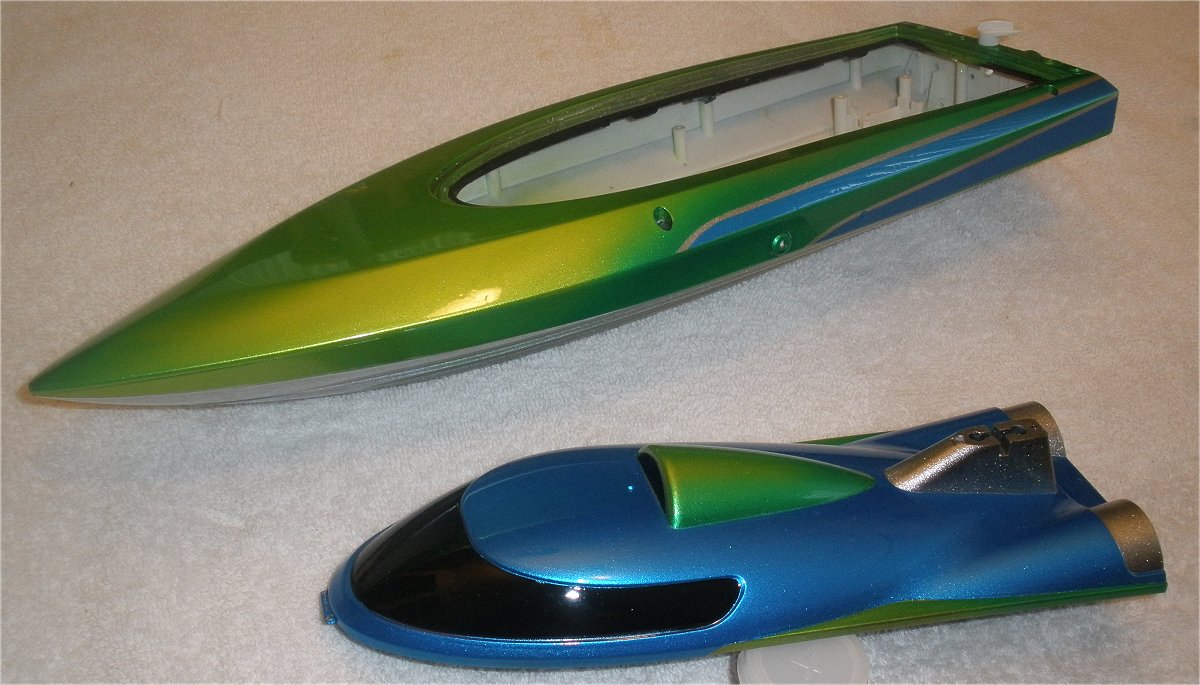

I was disappointed to see the graphics on the boat weren't stickers, which would've been easily removed, but actually stencil-painted on before clear-coating the top, and the ones on the bottom silver hull wet-sanded out very easily. At any rate, I wet-sanded the areas I planned to paint to a uniform hazy texture to prep the surface.
I applied a few coats of FasKrome, to back the green and blue pearls I'll be using.
The green for the hull is a custom mix of lime pearl and some drops of emerald green pearl to make it a bit darker. I then did some fades, a technique that I suck at, but it ended up turning out pretty good. I used the emerald green to fade the lime green into the silver stripes, to make the green and blue stand apart more...and decided to fade the front of the boat too, I was feeling more confident by then.

I then applied blue pearl to the top cover and side graphics...turned out really nice, but I have to re-spray the cover. I noticed a big stringy piece of lint stuck in there; need to let it cure before I wet-sand and repaint. It's looking WAY better than the original black. I can't wait to see this when it's clear-coated and buffed out.

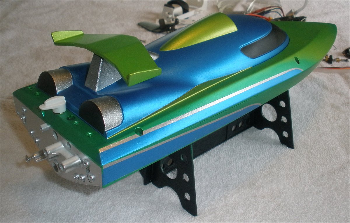

Here is the finished paint scheme, before clearcoating.

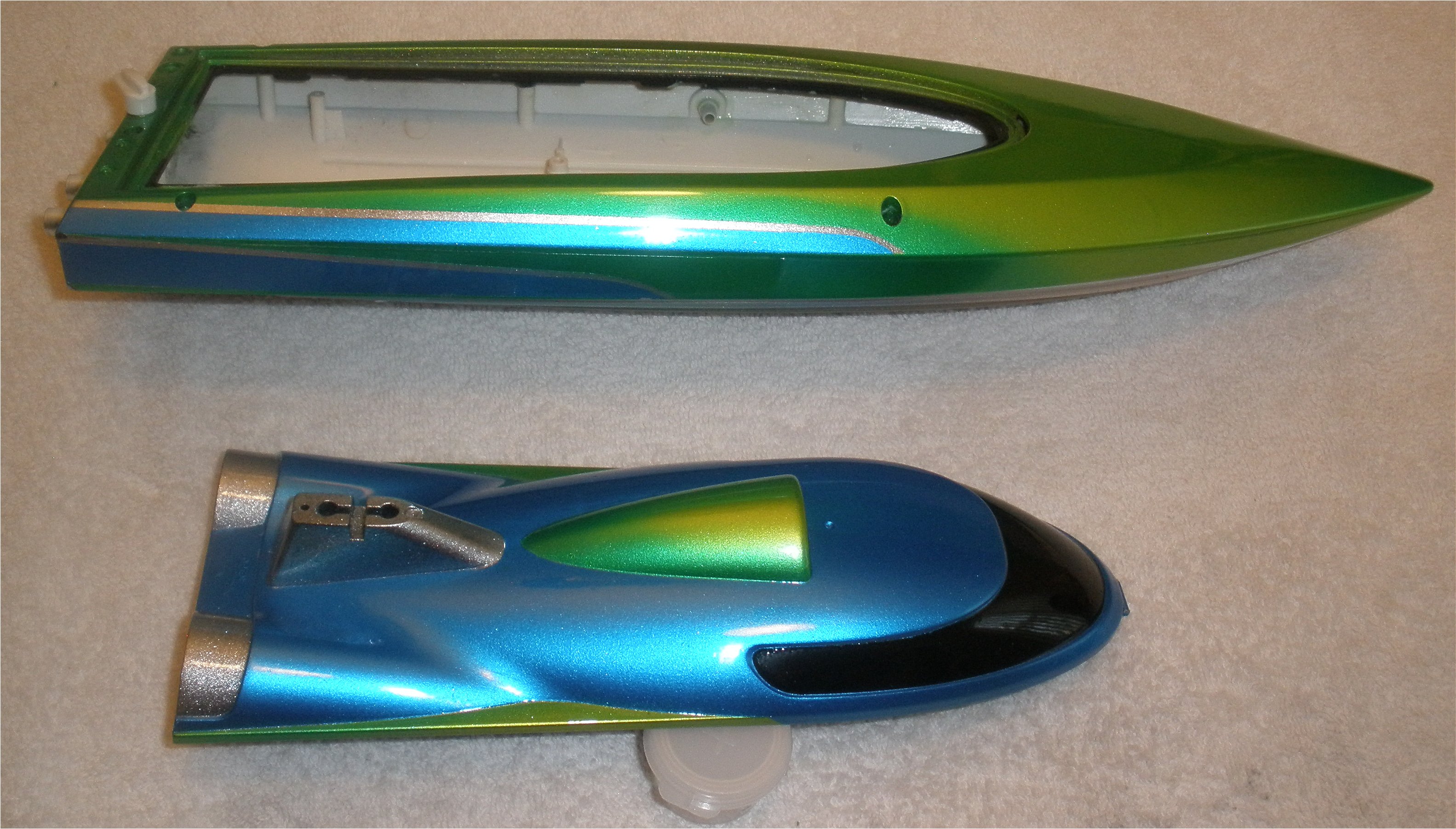

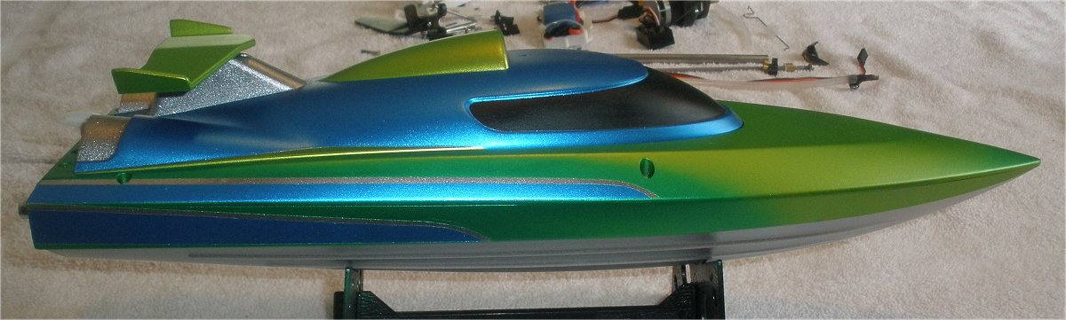

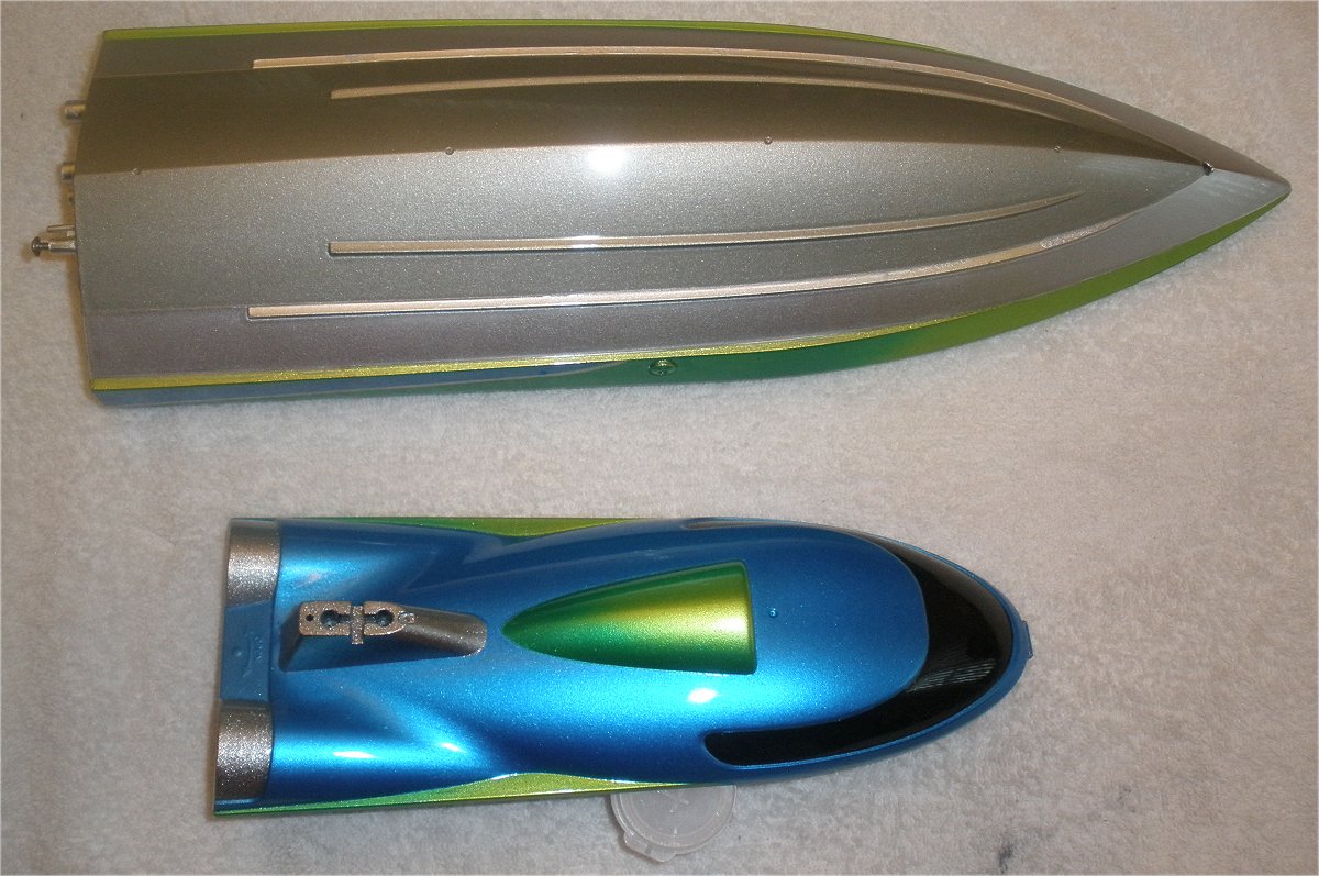

Re: First foray into RC boats: FeiLun FT012

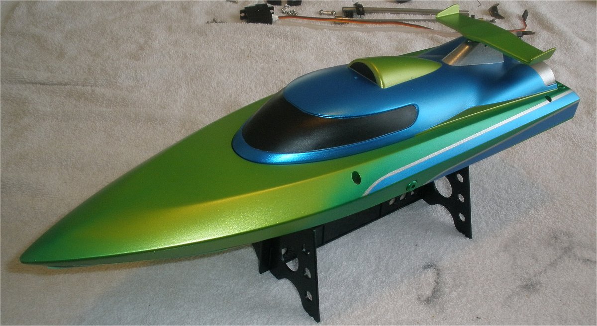

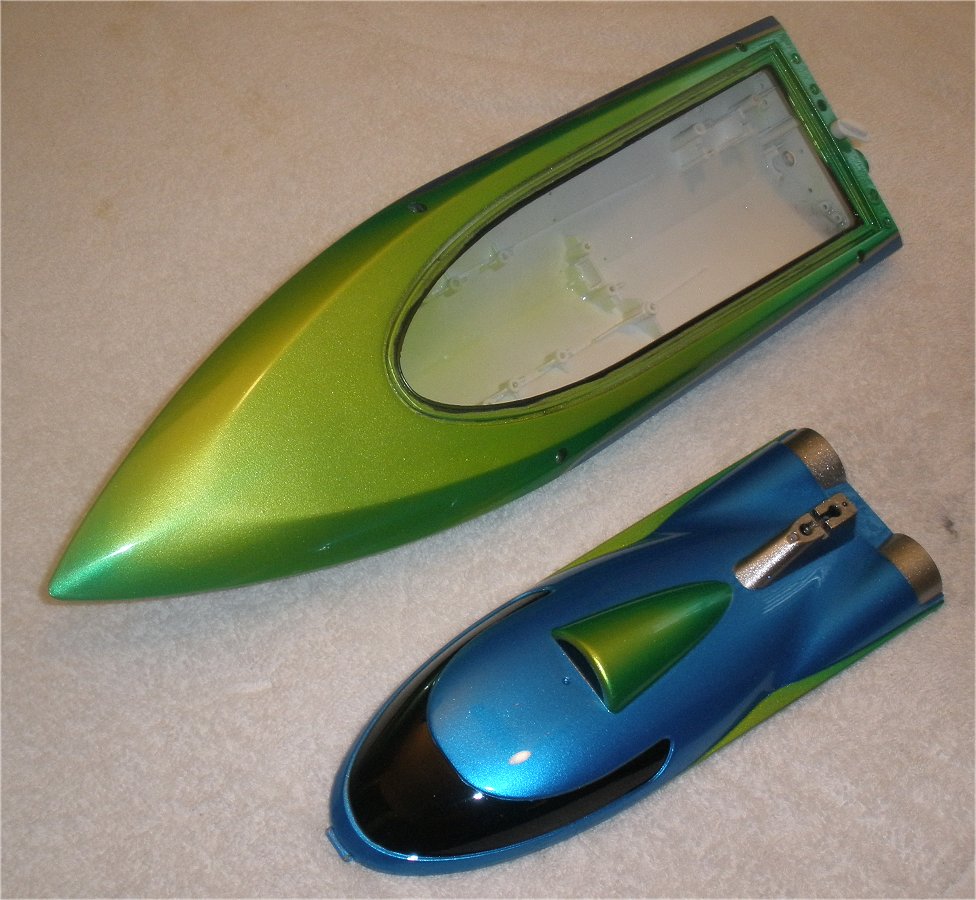

After way too many weeks than I expected, I finally finished the custom paint-job and clearcoat of my FT012. I discovered after buying a decent HVLP spray gun that the learning curve to spraying on 2-stage clearcoat was a lot more than expected...it's a whole different technique than simply spraying paint--something I was getting pretty good at! I researched a ton of websites/online tutorials and YouTube vids, but no amount of reading/watching seemed to be enough. I had to learn exactly how MY particular spray gun worked, and that took trial and error--on a sweet paint job I was so afraid to screw up. And, I didn't just want to pay someone to do it, because you learn nothing from that.
So after going through pretty much every issue clear-coating you could imagine--dry spraying (not enough clear), fish-eyes (unexpected contamination of the clear resulting in spots), a few minor dust nibs (those were pretty easy, just wet-sand them out) and a few runs (clear went down too wet), I think I experienced and learned from every mistake you could make.
Fortunately most of the mistakes eventually were mostly fixable with a lot of elbow-grease and wet-sanding, followed by polishing.

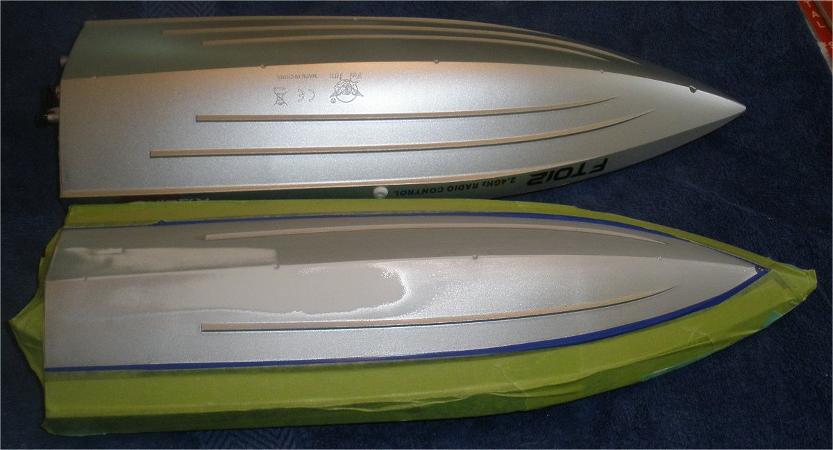

After clear-coating the top of the hull (the part that I painted), it was bothering me that the Chinese company had these raised logos molded into the plastic on the bottom of the hull. I know it probably wouldn't affect hydrodynamics TOO much, but it still bothered me...so I sanded off the logos until the hull was smooth, but had to sand down a tad too much, removing the silver paint to expose the white ABS plastic...so I decided to mask and spray the bottom part of the hull Krylon Fusion for Plastic in a metallic grey. Then, I clear-coated the whole hull. When I unmasked some of the previously-painted areas I masked off, it pulled off some of the clear...so I had to re-clear one side of the hull. Grrr....
After the final clear-coating was done, and an hour and a half of careful wet-sanding, I finally finished the hull paint job, and I can get on with the reassembly.
It's a lot of hours of work to put into a $108 CAD boat, but...I guess it's the hobbyist in us all that isn't satisfied with simply unboxing something and driving it in "RTR" state...most of us take things to the next level, or three.
Hull before:
Hull after:
Finished painting, clear-coating and buffing/polishing:
Hull before:
Hull after:
