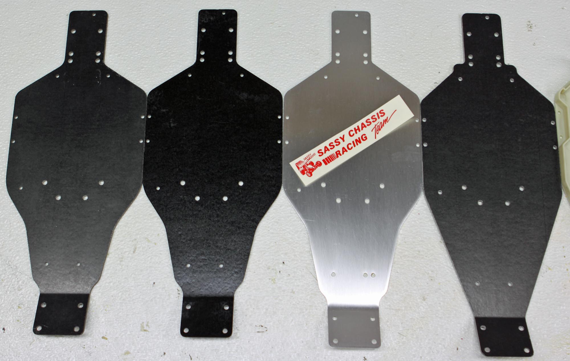

Here are some group pics of my as yet unbuilt losi chassis plates.

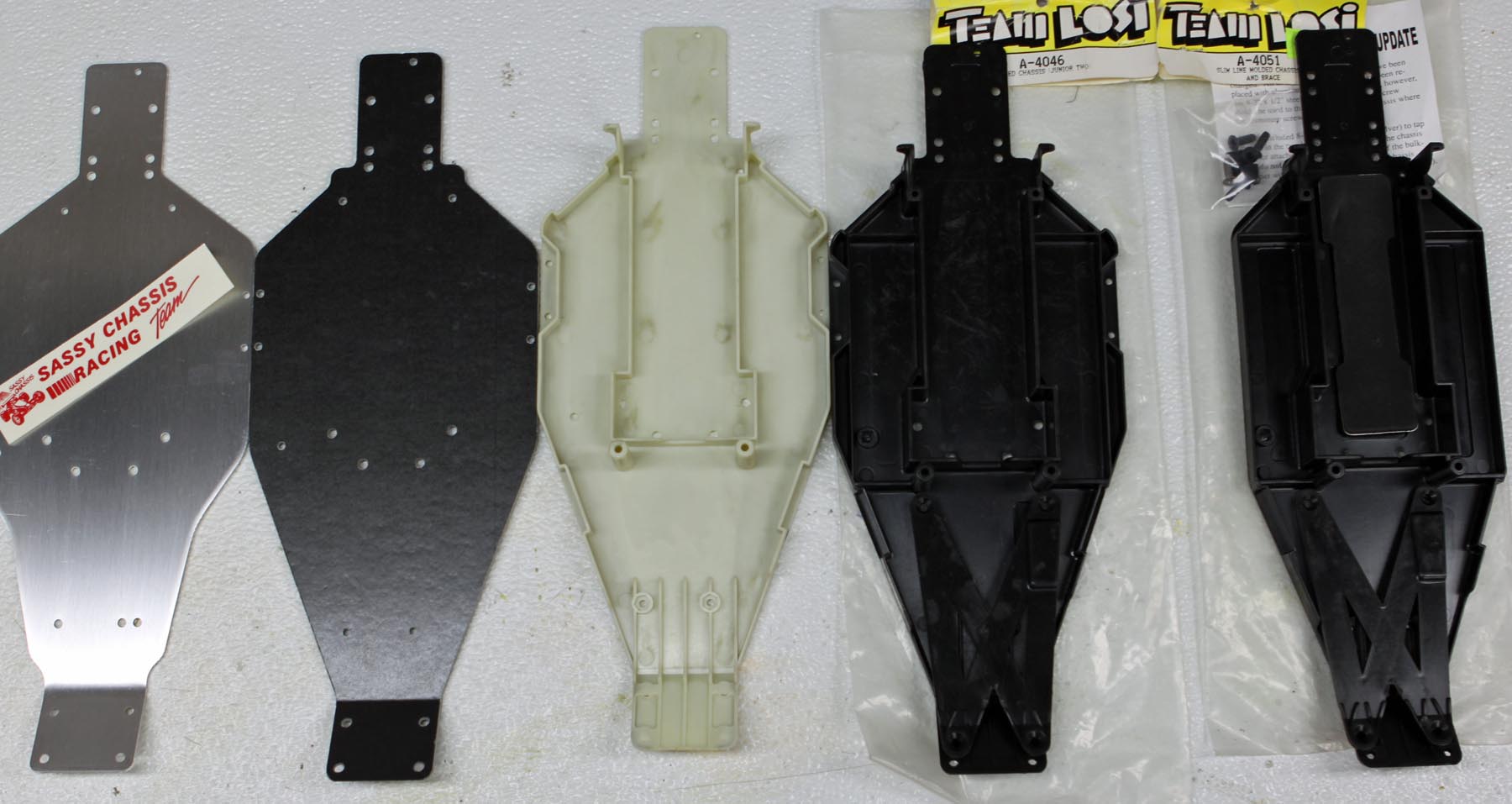

From left to right: lighter jrx-2 with gray core, darker jrx2 with bright white core, Sassy aluminum JRX-2, and a white core JRX-T Sassy,JrxT, White prototype Juinior-2, Late Junior-2 and Late pro-se/lxt slimline The late molded chassis have recesses in the rear to accommodate the xx-retro trans, as well as some other minor differences

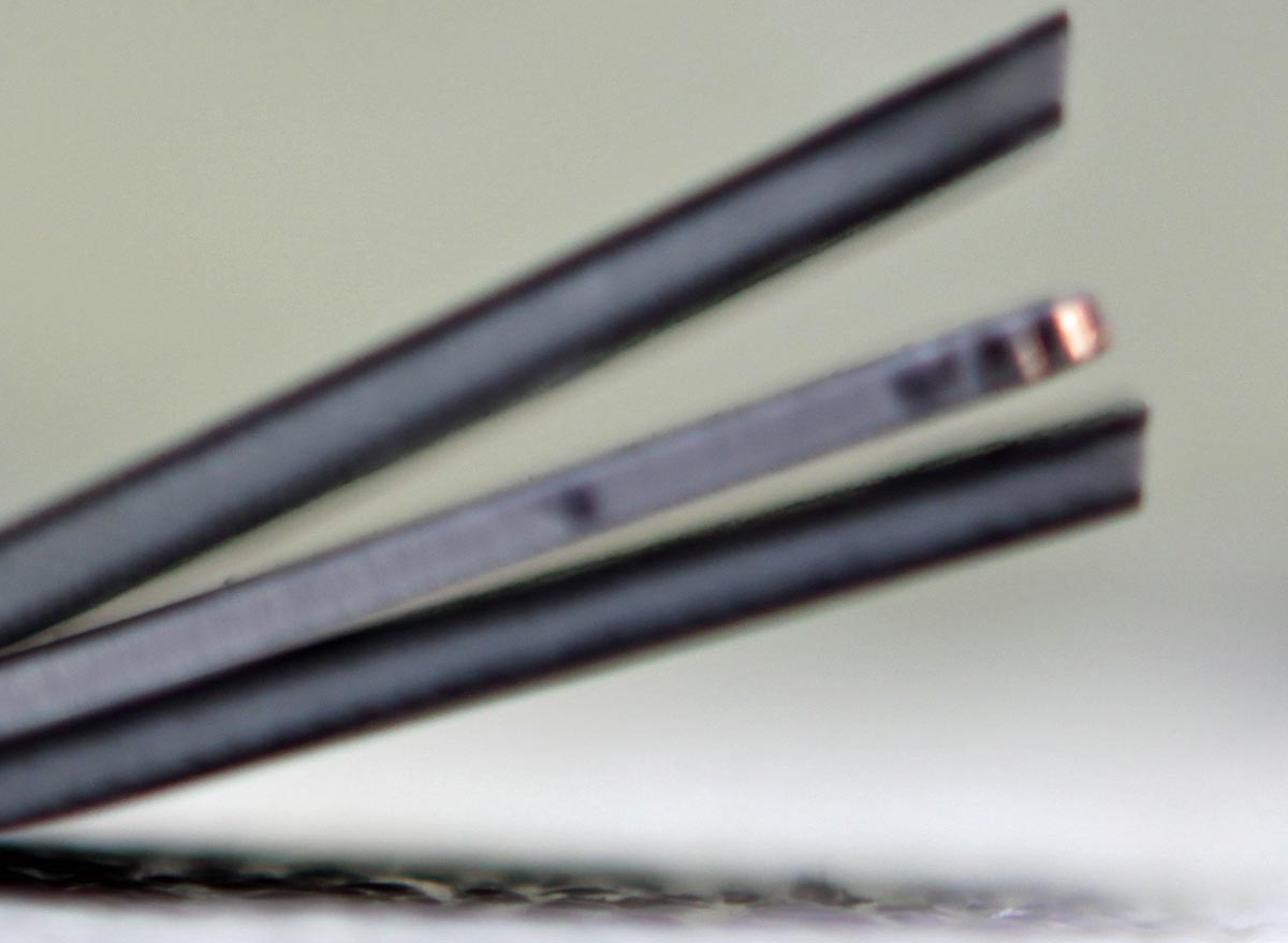

The aluminum sassy chassis is 1/4" longer than the standard jrx-2 plate, and has a slightly steeper kick up angle
this pic is of the sassy sandwiched between a 20deg jrx2 and 30 degree jrx-t

I see none of your chassis have the cut-out for the servo-saver?
Is there a partnr difference for the JRX-T chassis with/without cut-out?
I have 2 chassis at home; one of which the cutout was done professionally (I guess by Losi themselves) and the second was just a recess badly-done with a dremel (clearly by the owner.

Mr ED, I believe it was a running change.

As Joey said, I think in Anthony's original Losi Part variations thread it was discussed as a change from the old style (super flimsy) integrated servo saver bellcrank to the later solid bellcrank, needing a relief for the needed servo mounted servo saver. The one exception I have seen is the later Jrx/2 white core matte/matte chassis still had no servo relief but all the others such as the Jrx/T with the white core (fiberglass) have that reliefJK Racing wrote:Mr ED, I believe it was a running change.
