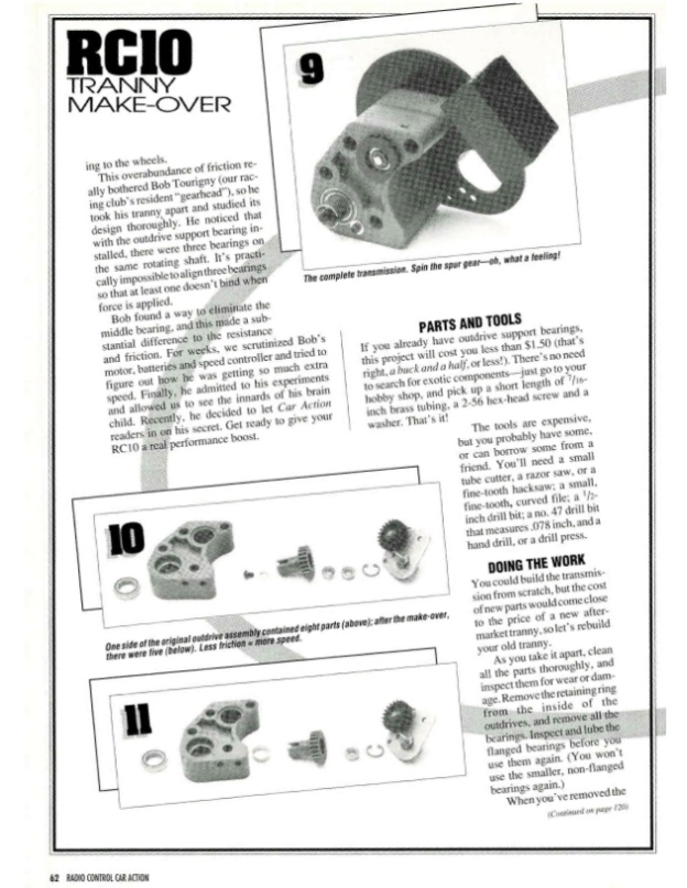

Good 6 gear RC10 article..
Post by Brandon G »
Might have to try this. Makes sense.
Originally in June 91 RCCA magazine...

Post by jwscab »
it works.....there is no magical changes to the trans, but the outdrive is supported better. from that you should have improved life out of the drive and the bone.
