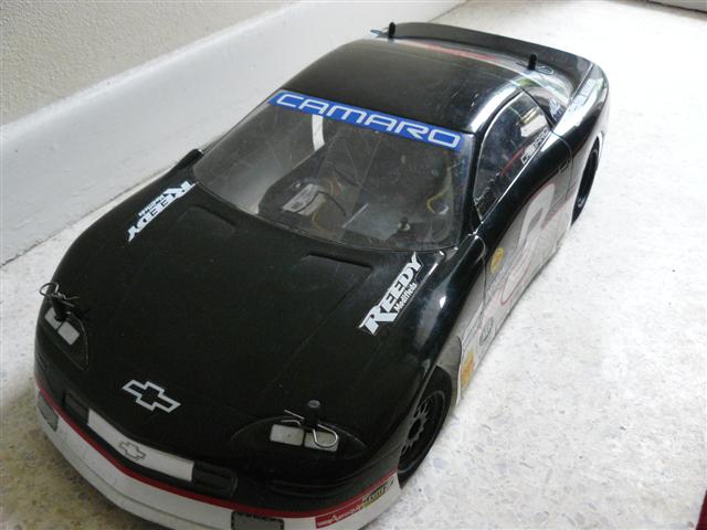

Hello all, you have inspired me and I recently won this DS http://www.rc10talk.com/viewtopic.php?f=11&t=10733
I am looking foward to recieving it and also for any help, tips or pointers you may have in the reconditioning and restoration. For those that dont want to link to the bay I have attached a pic below. More pics when I recieve it, hopefully this week!

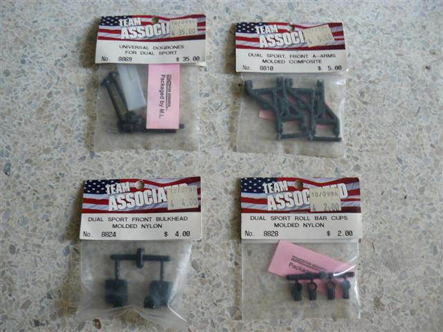

Well I dropped by the LHS and they had some NIP DS parts so I scooped up what they had in preparation for my new arrival, you know how it goes............ the waiting is the hardest part especially with a long weekend in between.

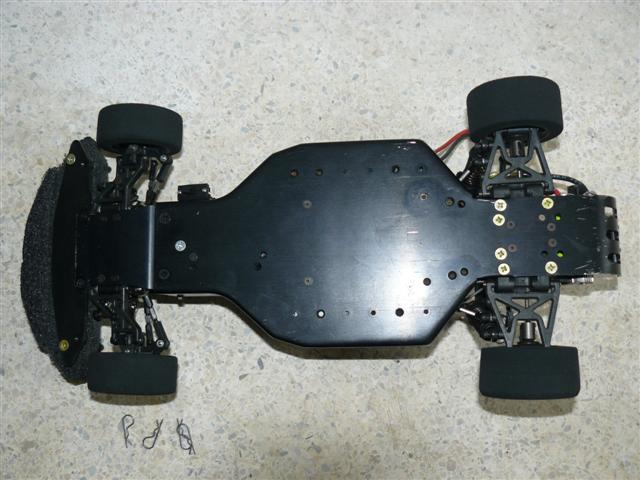

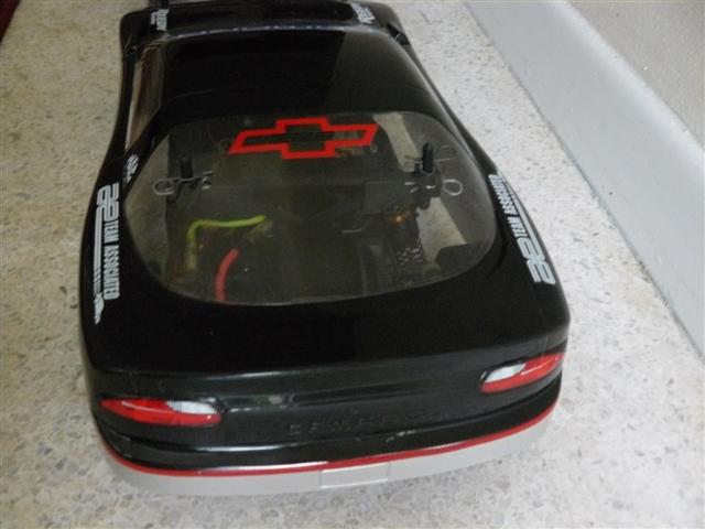

Well she arrived and in good order today Woooo Hooooo the pics below will show you what I received. The questions to specific pic's are in the captions sorry I am still new at this.

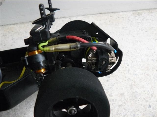

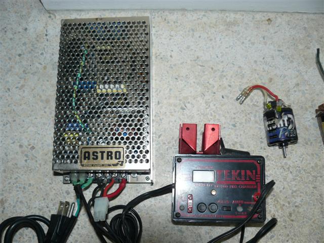

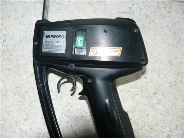

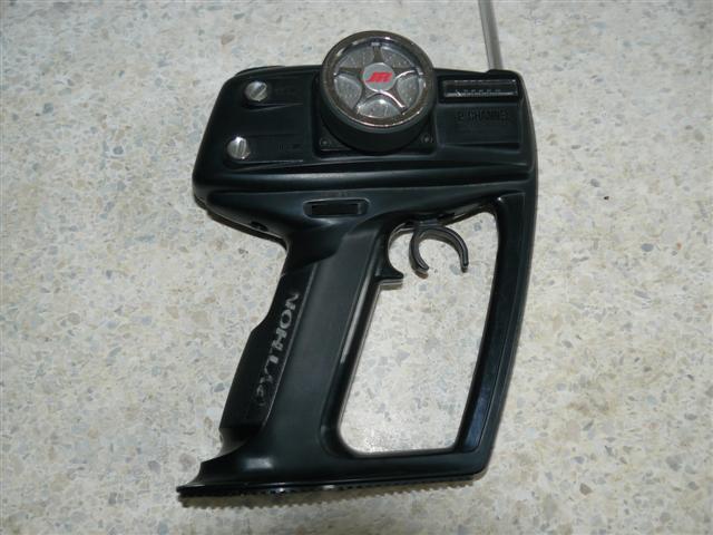

Is this a decent radio?  The radio crystal is 75.830mhz and the receiver is 75.790mhz is the Tx channel 83 and Rx channel 79?

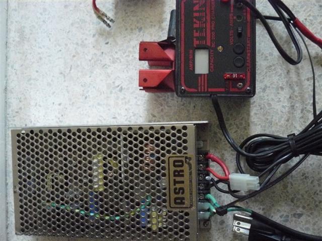

How does the dis charger work and how likely am I to electrocute myself using it?

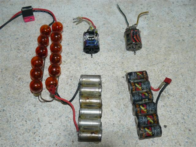

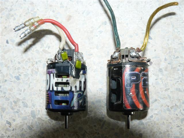

Aside from replacing the lamp wire leads what would one normally do to revive these motors and are they worth the time to do so?

No I wasn't going to leave you hanging and for a dicey as the electronics seem to uninformed me (you have go to see the charger) the car is more far perfect then I expected and I feel I did quite well with it. Now before I ask I will say the transmission is a 6 gear, the steering is mostly or all stock and the original wheels are long gone. I plan to clean her up and run her gently any help to get her there is appreciated and do modern 200mm bodies fit as the wheelbase seems slightly longer then the Camaro body she currently wears?

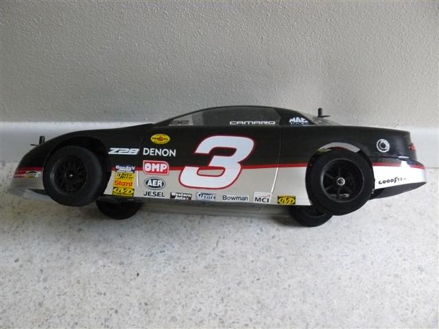

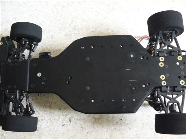

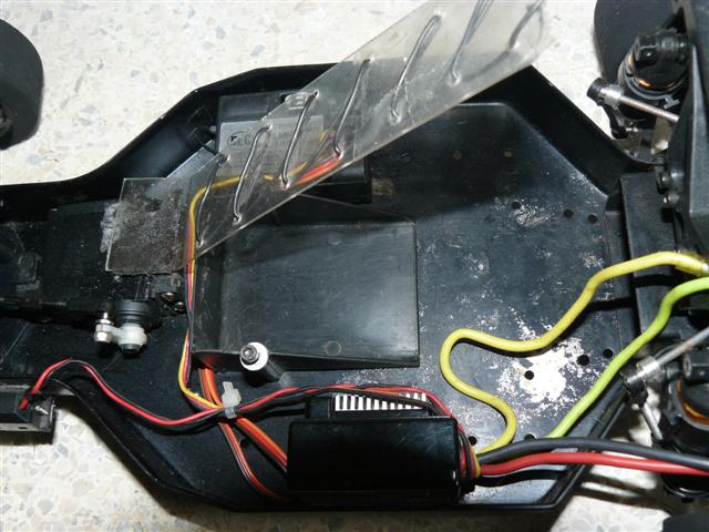

Smiles far better then I expected especially seeing interior chassis marks.

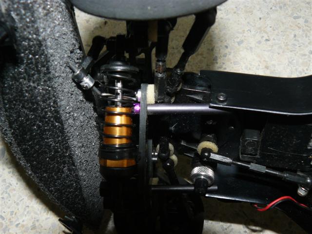

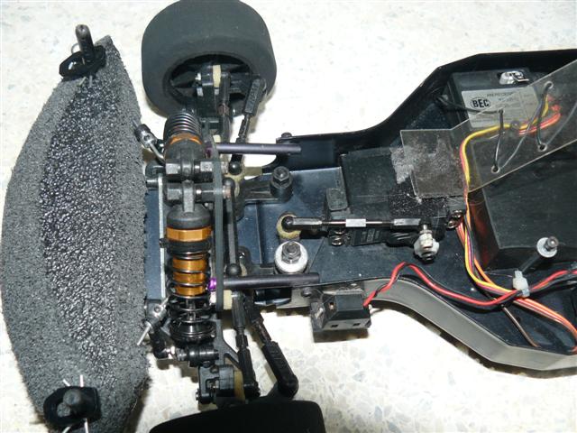

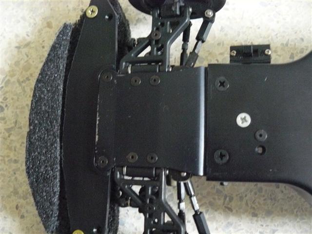

Are the tie rods and ends correct they look a bit man handled?

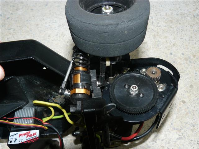

Up dated to 64 pitch and how to find a proper cover what am I looking for?
6 gear?
6 gear?

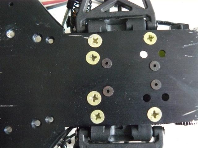

Anything special to look for in a battery hold down?
Motor decent and how to re-black chassis or better to live with it as is?
Are the nose tubes correct?

I charge my NiCads now with a Leisure electronics charger I bought in the 80's how sad is that.

Last few pics. Oh bother with the battery packs new wire solder extc or not worth the trouble? How would I test the cells to make sure they are up to par? The ESC is a Power Pulse by dynamite and idea on the turn limit? And I am really beginning to have a hatred for double stick tape whats so wrong with zip ties or Velcro they both come off cleanly and easily and look neater.

Bout the only thing I can help out on is that its a stealth instead of a 6gear and the radio is useable as long as it works but the numbers you asked about aren't the channels. Your channel will match between your tx and rx but your mhz is alot of times off like you mentioned but pretty much is an AM 75 mhz and should have a channel somewhere between I think 60-99. Will leave the techy questions up to those with bigger computer monitors and better eyes :lol: . Just an fyi...I was the one you outbid on this one. Seen it on one of my random ds searches and thru a bid in to keep an eye out on it but just couldn't spend the money on a chevy #3 :mrgreen: .

Klavy69 thank you for the information on the transmission, do you think the Tx and Rx are a pair and will work properly together I have not fired them up yet but will give it a try.
Oh and if the #3 body means that much to you please PM me so we can work something out I don't think it fits properly and I wouldn't want you to go without unnecessarily.

the radio transmitter/receiver pair is probably fine, but the crystal's aren't matched. So you'd need a crystal pair at a minimum.
the double sided tape can be removed with wd40 or acetone, and either of them shouldn't harm the chassis, just use caution on the plastic parts, wd40 is better there than acetone, since the acetone can attack alot of plastics.
nice car, I'm really diggin' the DS, and if I didn't already have a stack of cars, it would be on my list to aquire.
to test the cells, check the solder connections, and if they look ok, hook up to a charger and see if they will take a charge, monitor them to make sure none get really hot quickly, and if you have a voltmeter, after a good 15 minute or so quick charge, check for around 1.25v per cell. if they are somewhere around that, they might be OK, but if they are still around a volt or less, they are probably no good. Even if they all charge up OK, they might be pretty worn and only hold a charge for a short period of time. If you have a rig you can try them out it, run it around until the pack is discharged, and if it happens really fast, check all the cells, the bad ones will be the ones discharged the most (like 1 or 2 cells might be .9volts, and the others might still be 1.1 or better)

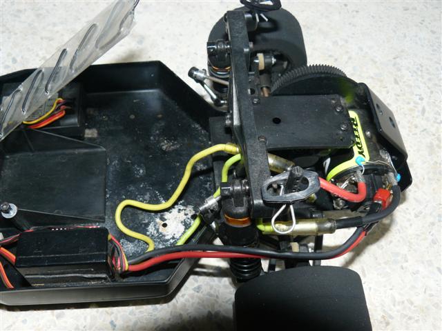

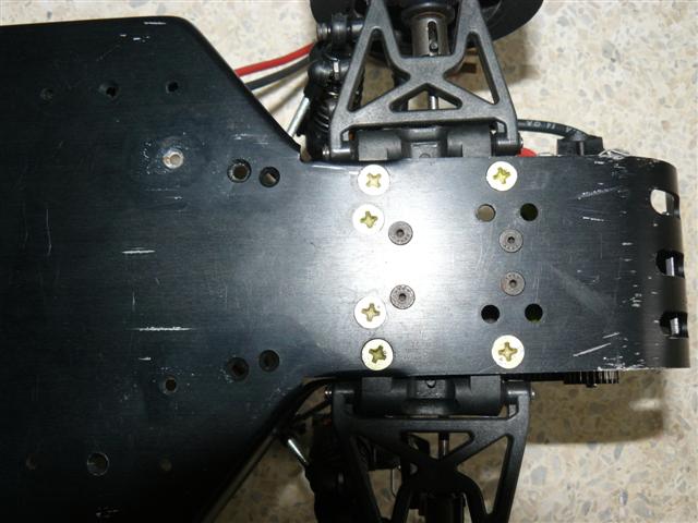

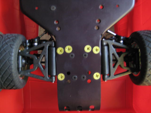

Just a quick FYI regarding the restoration; I'm confused as to why the rear A-arm mounts are upside down...
They should look like this:
Different frequencied same channeled crystal sets will work together but will have alot of glitching and not really worth the hassle when you can pick up a matched set for relatively cheap. I've gotten quite a few sets of mismatched frequencies but once you get around someone else theres no tellin what could happen. As far as the body goes I'd pry take you up on it if it was minus one :mrgreen: ...never really a fan of that number 3 but I'd root for Rusty Wallace any time in his heyday!
Diggley wrote:Congrats on the DS!
Welcome to the club.
Hey Diggley, I have a few 'old timers' that used to run with us on wednesday nights that ran the associated mounts upside down...they said it brung the center of gravity down and made a difference... :roll: was the typical reaction...I'm kinda more the 'just run it' kinda guy myself but these guys would do all kinds of wierd stuff to get that extra edge (in their minds more than on the track I think).

BTW, sweet ride. I like the Camaro body. 8)
