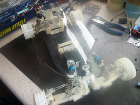

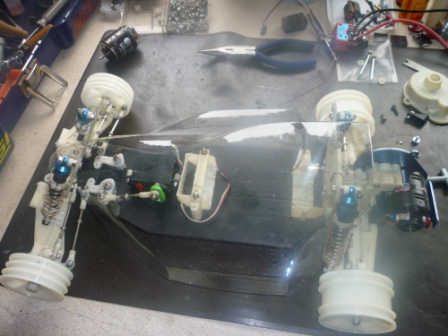

This is what I,ve done to get the feeling of the shocks close to how the RC10 ones "feel"
Front : 1 notch pistons, Losi 40wt oil
Rear : 1 notch pistons , Losi 35wt oil
Tried Losi orange front springs which felt good, but any Losi rear springs (Red ,Pink)were too long
Looking through other cars I have came across Tomy Intruder springs, the fronts are very similar to
the Losi orange and the rears are similar to Losi pinks.
Next is to fit the electrics so that the ride height can be sorted and then drop test to see how the car settles.
Get the body painted ready for the fist meeting early November
Hopefully I,ve managed to attach a couple of pictures of my progress, yes they are TRX3 wheels
Seems sucessful apart from the light reflection of the bodyshell
