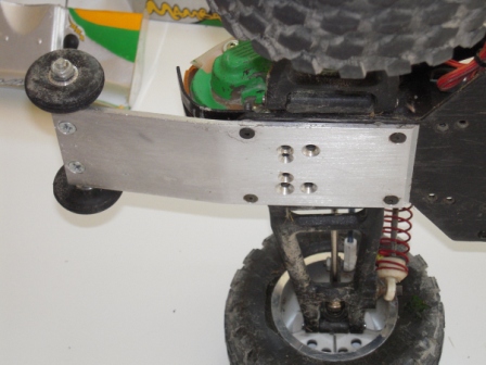

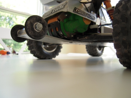

Well, my home made wheelie skis have been bent back and forth so many times one broke off. Is there any wheelie bar out there that would suit my build?
I think Banzibars make one for the T4 and T3. I think I could mount one of those easily enough with a couple of drilled holes.

I don't know about how durable those look. My aluminum strips have been bent back without any trouble. I think I need a thick steel one for this build.

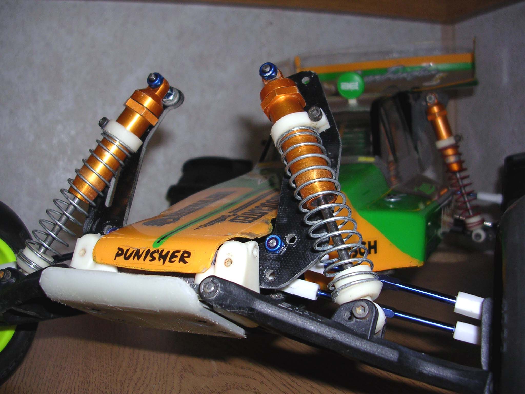

While waiting to get back home I had trimmed the nose plate down so it doesn't catch the air as much, but left enough to protect the front of the chassis. That lip in the front probably contributed to the lifting of the front end.

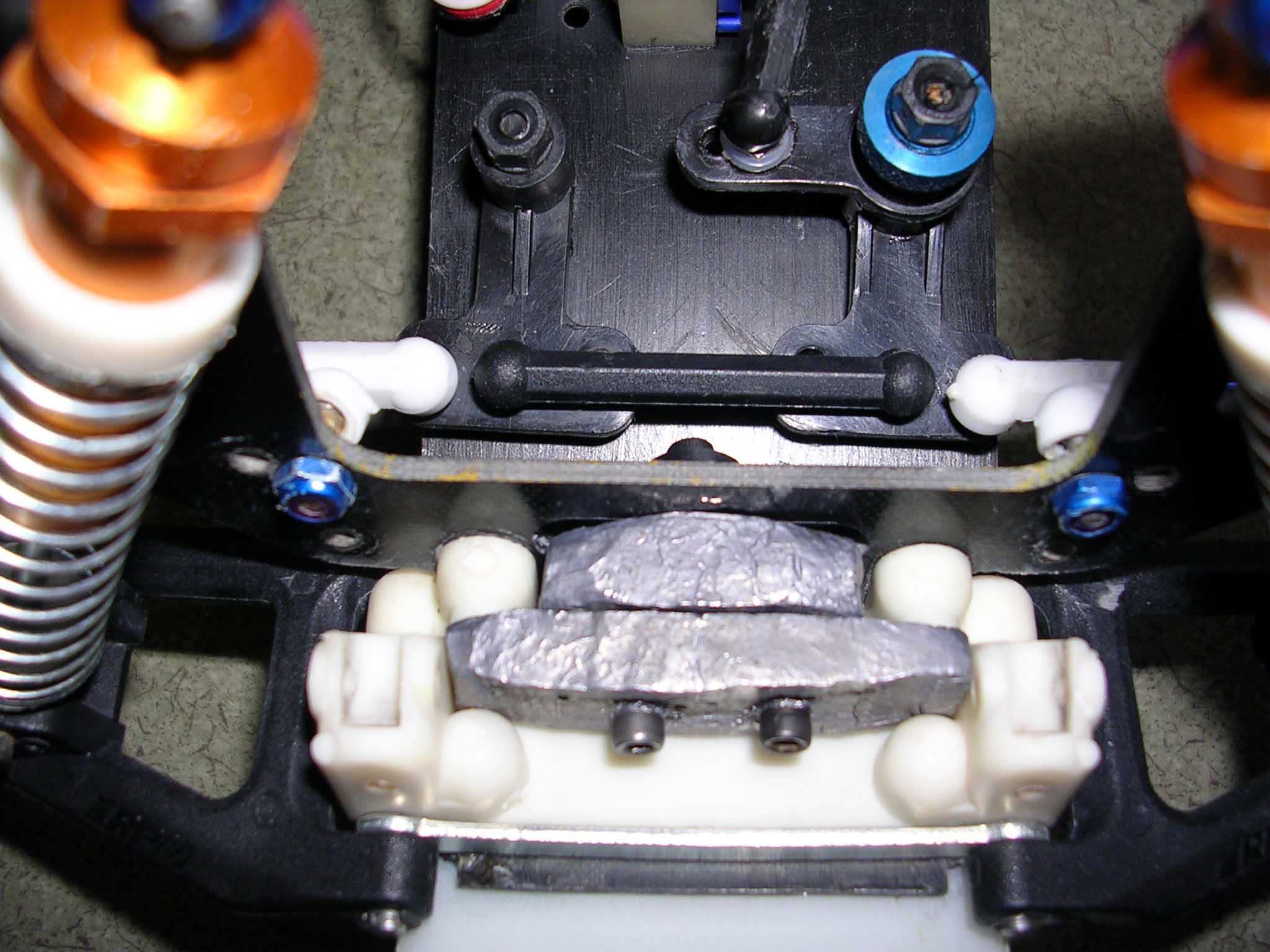

Also I added 2.5 ounces of lead to the front. I took 2 egg shaped fishing weights and molded them to fit inside the 10T bulkhead snugly, screwed them together and then screwed it to the base of the shock tower. These ones shouldn't get dislodged like my last ones.

You may have notice the wheelie bar. It works great, but it's not needed as much with the 2.5 oz of lead in the nose. I haven't strapped a gps to it recently, but I'm sure I can get it over 70 now that the front wheels are on the ground most of the time.

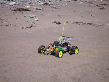

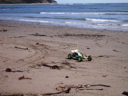

i finally have the beast in one piece AND to the beach. The beach is where this thing belongs...like driving on clouds with a few short stops to look at the girls
I managed to get a short video while trying to drive...not really the easiest thing to do http://www.youtube.com/watch?v=NvD-RksVr5U

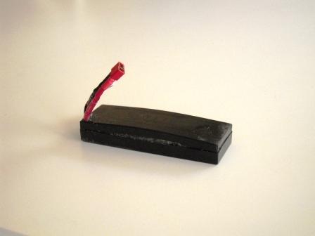

It all came to an end when a wheelie went out of control and I stopped in the ocean. The water just went up a few inches but enough to submerge the battery

Salt water and lipo's dont go well together. That is how you neutralize a lipo!

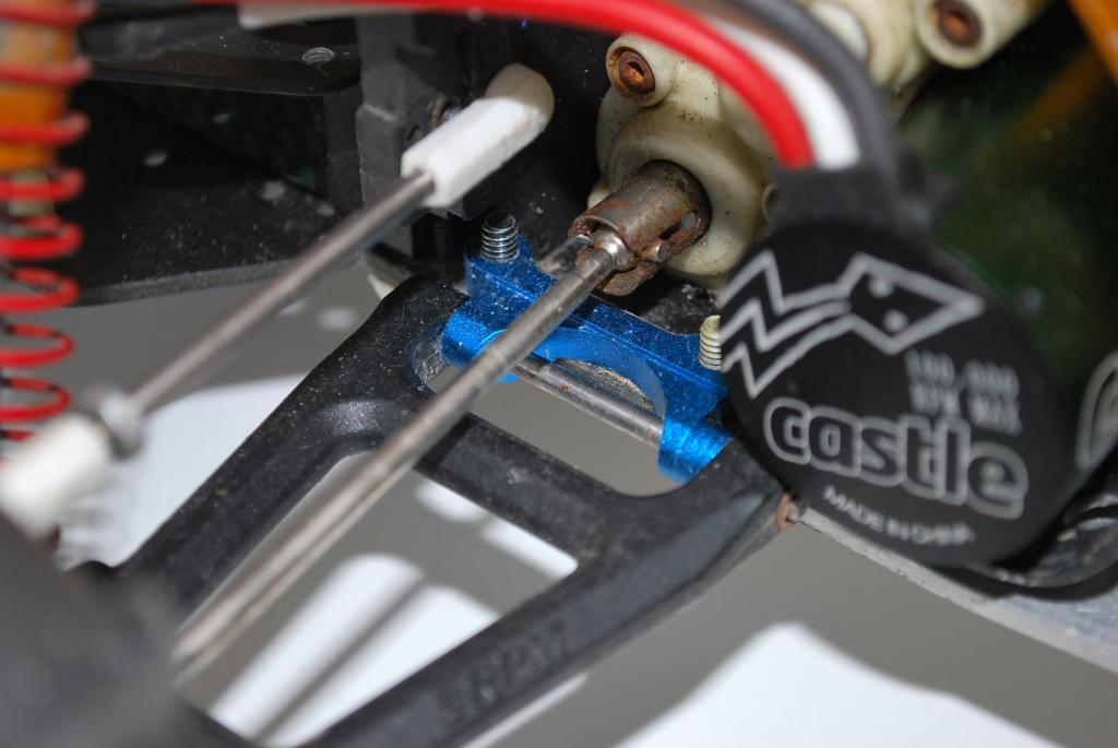

i just got around to seeing if my esc and motor is OK. Since the salt water reached the battery, it got to the motor too. I used a new battery and tried things out. The motor wires got real hot, the wheels couldn't turn very much, but the lights on the esc corresponded properly to the radio. As a precaution, I took the mamba max esc apart and used CLR and water to remove the salty crud inside. As per the motor, I took the 6 screws out but cant seem to manage to get the ends off. Even though the rotor moves ok something is making the motor over heat and not allow the esc to do the work.

I love your truggy!vintage AE wrote:As per the motor, I took the 6 screws out but cant seem to manage to get the ends off. Even though the rotor moves ok something is making the motor over heat and not allow the esc to do the work.
Unfortunately the castle motors are notoriously hard to take apart. The screws strip very easily (both the allen and phillips type), and both the endbells appear to be glued to the center section.
I've gotten the outer endbell off, but I believe it took the use of an adjustable wrench, and the teeth marred it pretty well.
Its too bad they aren't made to be easier to service, as bearings require replacement from time to time, and yours appears to need some interior cleaning.

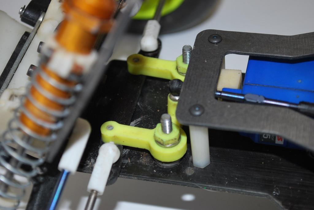

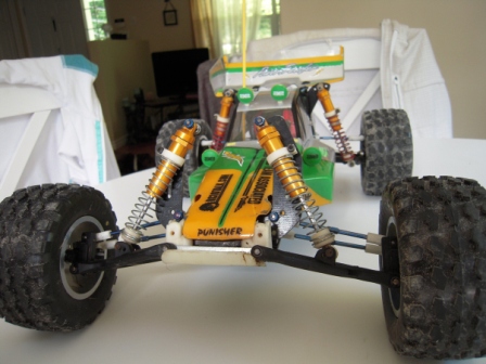

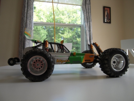

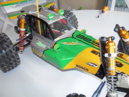

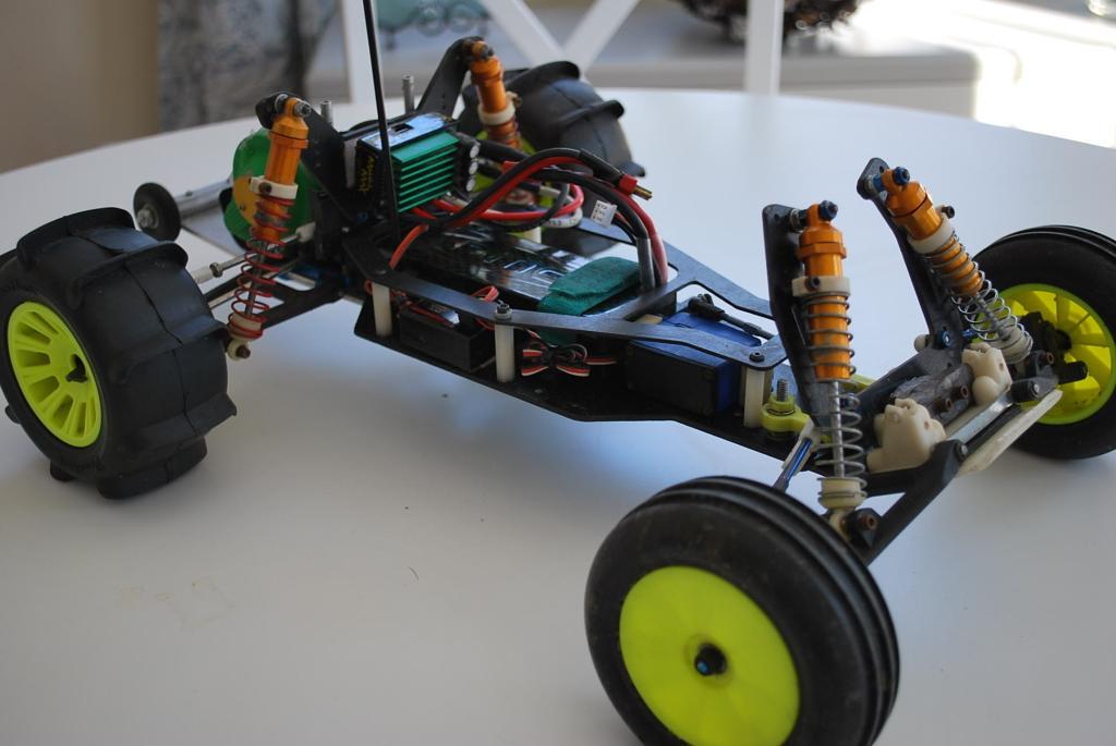

latest upgrade photos, with the cc top deck, 0 deg rear arm mounts, a green battery strap and a different steering assembly (not sure of the make)
