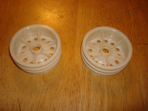

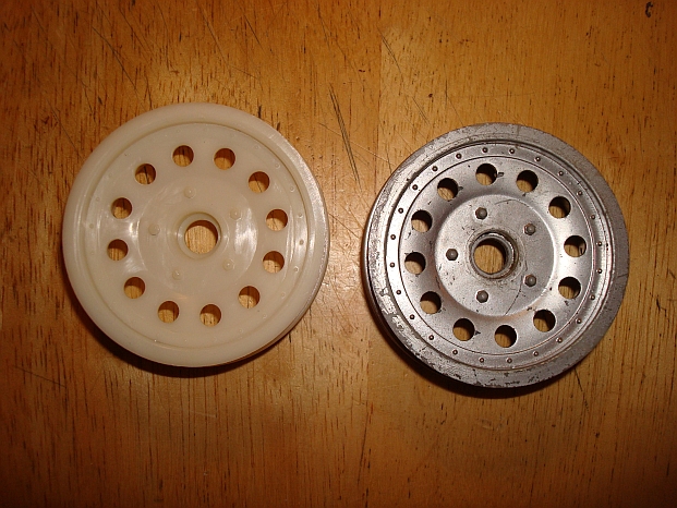

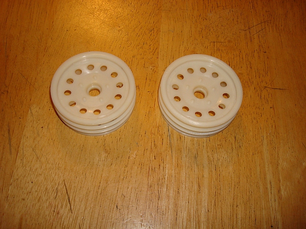

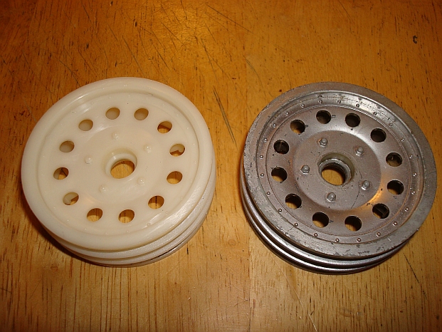

Well, here's another update. I played hockey tonight and left the wheels to soak in Easy-Off all night long. I figure they were soaking for 4+ hours. I was expecting to come home to a puddle of plastic glop, but the wheels were intact. Score one for Kyosho! At any rate, I had to give each wheel a thorough scrubbing with a toothbrush to remove most of the paint remnants. Easy as lickety-split, it was NOT. In fact, there's still paint stuck in little recessed holes in the centers of the wheels. But, I removed 95% of the paint after that good long soak, now they're getting another brake fluid bath overnight.
- Coelacanth
- Posts: 7421
- Location: Alberta, Canada
- Been thanked: 325 times
Re: Removing paint from nylon wheels?
Another update: Finally got the paint off the wheels. It took alternating baths in brake fluid and spraying with Easy-Off. On some wheels, the paint crinkled up and mostly pulled off easily, but on others, NOTHING would get rid of the crusted paint in the niches except going at it with a needle to tease the stuck paint off the surface. I even had to use a new X-Acto blade similarly to remove paint stuck around the simulated lug nuts on the original Optima wheels.
Now, they're a bit discolored, so I'll be trying the peroxide-in-the-sunshine bath. At least I'm happy that the paint is gone, but it was absolutely not a quick or easy-peasy task.
