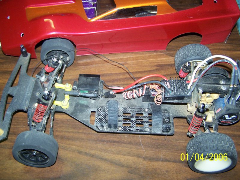

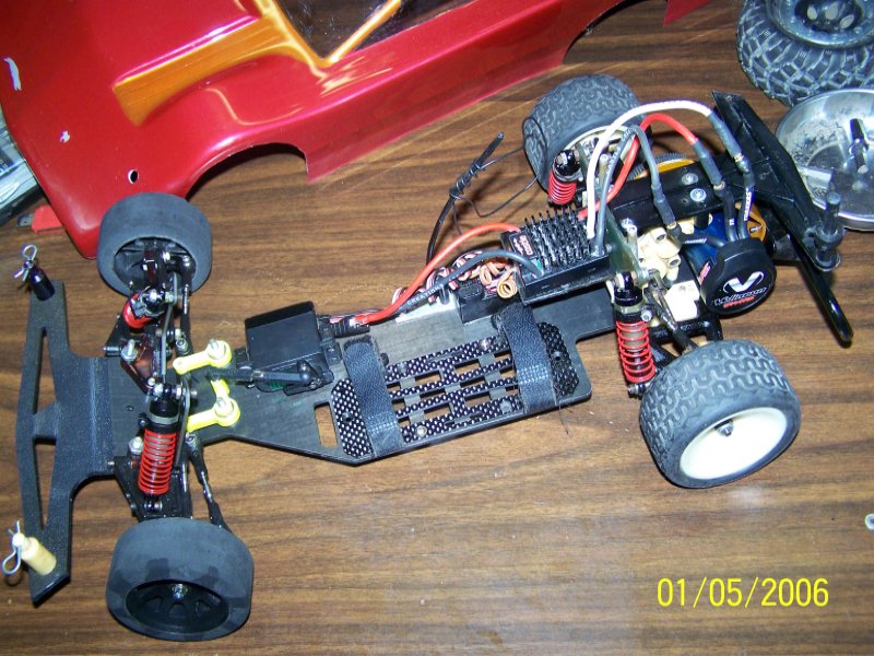

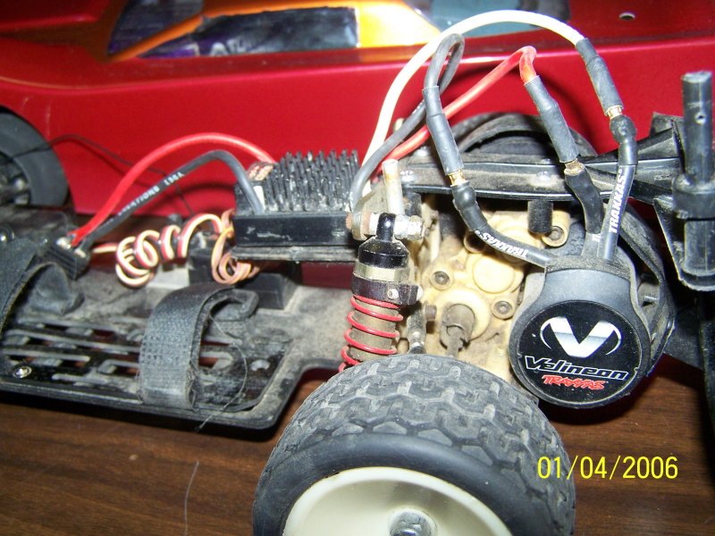

Ok guys after searching around on here for a bit I cannot find any direct info on running a brushed system on a rc10.
Here is what I have.............
Standard rc10 trans dont think its a stealth.
Full bearings not bushings.
Stock gears in the trans.
Traxxas Velineon 3500 Brushless Motor.
Castle Side Winder (I think its the side winder model) ESC
4500 8.4v 7 cell ORION rocket pack.
84 tooth spur not sure what the pinion it is.
TC3 shocks with speedys springs.
Stock towers and arms and such on the front RPM arms out back.
High torque servo.
Full ball bearing steering
Axial battery tray/straps.
Traxxas TQ radio with Traxxas 3ch reciever
My question is will my set up hold the system I have? Will I have to upgrade the car in any way? Will I get 40+mph out of the set up I have?

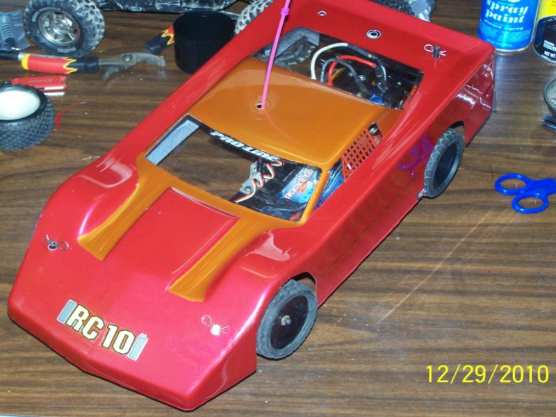

Now I know the car is dirty and dusty that will change tomorrow and I am still searching for the tire wheel combo I want. I am ponding the thought of swapping the axle and carriers for some that will accept 12mm hex this way I will have more option with out searching for hrs and waiting days for new wheels.

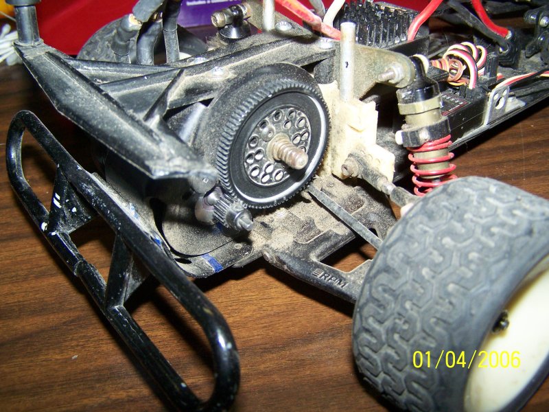

That should hold up just fine, it is the stealth and you would want to rebuild the Diff and make sure it is set correctly as you would likely do with the slipper. I have been running mine with and 6.5-8.5 with no issues. But, it comes down to being built and mantained correctly
Re: Brushless RC10 buggy/oval
Charlie, maintaining is no issue with me. Despite what the pics show. Now how do I know that the diff is set right?

By the feel, and amount of slippage when turning the spur gear with the Slipper locked out and the rear tires locked as well. Chances are that if it has some time on it, is due to be rebuilt. But it all depends on how well that is was built- diff rings are all stamped metal discs, so as a result of being stamped on a press they are bowed and need to be sanded flat on both sides with an increasingly finer grit of paper on a glass surface in a non-figure 8 pattern. As does the thrust washers which are stamped as well, and especially in oval the diff action is key to corner speed and can be as much as 2 tenths per lap faster built correctly.

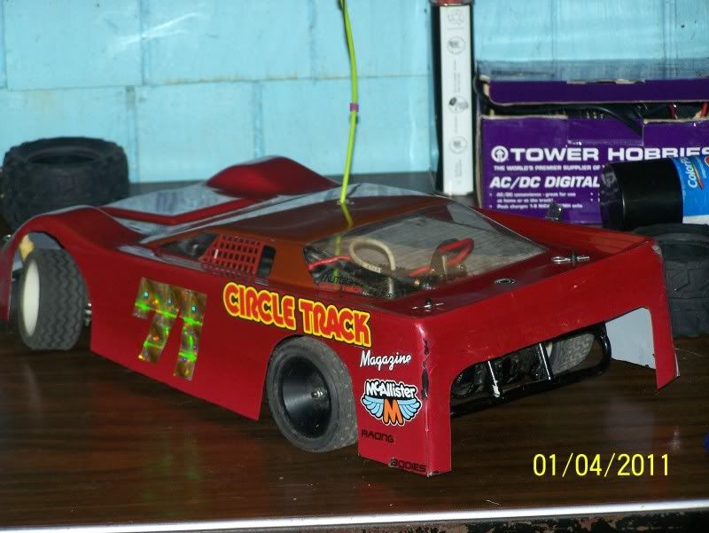

I have 84 tooth spur right now. An I do not want to pass 40mph or I get knocked up a class. and I wont run with 8th scale cars. I plan to run standard buggy wheels with some custom work tires. I have no clue what the spur is, can find out tomorrow. Thursday will be the soonest I can check and see how cool it is runnin. My track has too much dead grass on it so to garland ill have to go.
I'm currently trying to get me some wheels for the car and awaiting decal but here it is so far.
