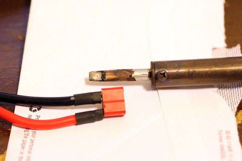

Re: Solder problem!!!! NEED HELP!!!!!!!!!
If it helps at all, this is the size of the chisel tip on my 60W hakko iron as compared to a standard deans connector on a lipo. This tip looks like hell (it's been used extensively and is years old) but as soon as it heats up and you wipe it off on a sponge, it's good as new. it cruds up in the cooling down process for whatever reason.
