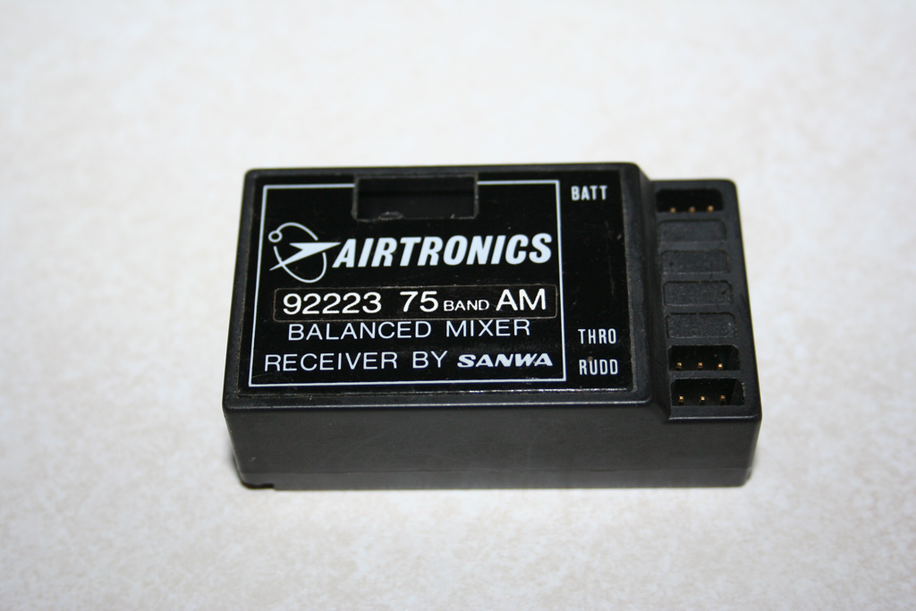

I just noticed that Ruffy's receiver has the same ref. number but says "Balanced Mixer Receiver" where mine only says "2 Channel Receiver", does anyone knows if there is any real technical difference between the two?

I am a bit stuck on the build as I am too lazy to take out the dremel and modify the front kick-up plate (sanding the AE logo, rounding the corners and mill the two front tube screw holes). In the mean time, I found a brand new Sanwa/Airtronics RX that looks a bit closer to the box art one as this one says "balanced mixer receiver" where the previous one only said "2 channel receiver". The frequency, ref.# and color of the antenna wire are still wrong though, but that will do for now, I'm quite happy with it 8)
