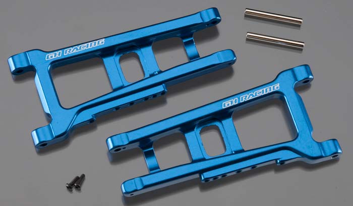

Yep, way too expensive, and lacking the shock mount options that the Turbo Optima arms have. You guys are gonna love this--believe it or not, Traxxas Slash 4x4 front or rear arms by Golden Horizons can be modified to work, and you can find them on eBay for around $20 or less per pair. I'm still working on it but the mods involve:Mad Racer wrote:Hey Marc why not use the alloy ones from Pargu ??? I guess too much would be the case hey.
1) Drilling a *straight* hole through both halves of each arm for the hub hinge pin (this is the hard part, believe it or not; getting that hole straight is half the battle).
2) Cutting off the excess arms and filing it smooth.
3) Add a few small spacers on either side of the Optima rear hub when inserting the hinge pin.
4) Find hub hinge pins of the correct length.
5) Find a way to mount a ball stud on the rear of each trailing arm if the stabilizer assembly is to be mounted; the arms lack mounting holes there.
Advantages: You have 3 shock mounting points in almost the exact same locations as the stock Turbo Optima arms; and, they have a more "finished" appearance than pargu's rough-looking machining.
I'll create a thread describing this mod once I'm finished it.
