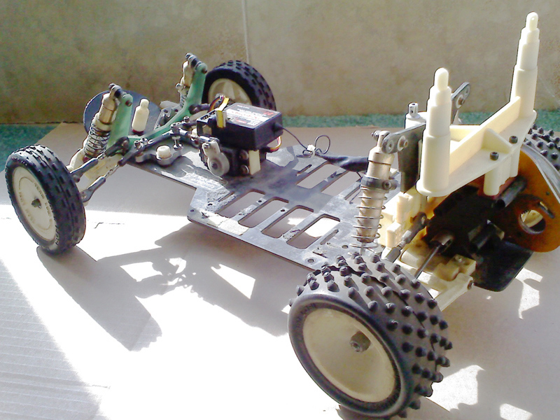

Ebay was very good to me last week. :mrgreen:
First of my new project cars cam today and I'm definitely more than happy with the deal I got. "Houge" chassis roller with a spare A&L chassis and a few not advertised surprises. The auction wasn't very descriptive and didn't have a clear shot of the transmission but I saw a bit of black behind the shock tower and guessed right: MIP SP-1.
Also guessed right on the front arm mount color looking a bit off to be black nylon pieces....they are aluminum....as are the steering knuckles but I didn't pick up on that one. I think they're old WSS parts.
Pleasent surprises didn't stop there though as the SP-1 came with a Torq control hub and the Tecnacraft wing is using old diamond shape wing buttons.

Post by Phin »
Yup. Losi tires/wheels too. Has Kyosho Golds, Tecnacraft turnbuckles up front, and 3/4 of a set of white Andy's arms. What I don't know is who made the front shock tower...it's shaped like an early RC10 tower but it's thicker fiberglass, it's missing the .56 shock mounting hole, and it's a darker green/aqua color. The rear I'm thinking is the A&L tower that goes with the other chassis...by the wear in the mounting holes I'm guessing this was once set up as a trailing arm chassis.
My plans are to rebuild it as one.
