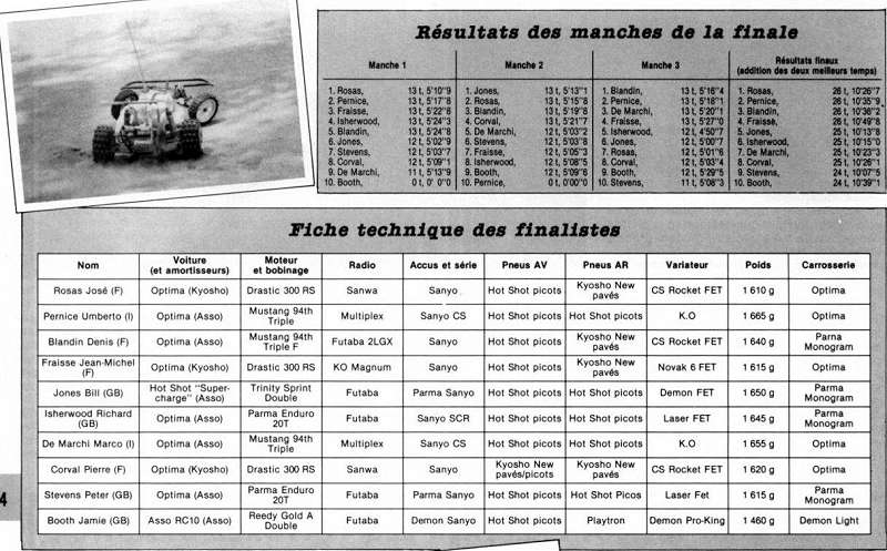

Lonestar: I have a feeling that Drastic motor, or J.M. Fraisses's prototype motor with Drastic sticker was maybe used during qualifying. But in the finals Jose seemed to use Le Mans 240S motor:
I would love to have one Drastic motor to this car, but to be periodic correct I would need a prototype motor with Yokomo can and Le Mans armature.

interesting discussion on motors... Only Jose and Jean-Michel would know what Jose ran as a mill during the mains. JMFraisse was the french Jim Dieter, so his hand-made stuff would be MUCH faster and efficient that Kyosho's own 240S

I did chat about this motor thing with prp some time ago and it seems that in 1986 those Drastic motors were on prototype stage with Yokomo or Kyosho cans and some random armatures around 19-20 turns. They (= J.M. Fraisse?) did later start winding them too and those were then the production motors. The reason why I believe Jose used Le Mans 240S rather than Drastic 300RS (20 turn single) in finals is that the grass track got more slippery during race. Slippery track is more "easy" to batteries and because of this more powerful Le Mans 240S a 19 turn single could be used. He might used that 20 turn Drastic motor in qualifying when there were more grass on track and there comes that one Drastic 300RS info to one magazine and later to Drastic ads too. I might be also wrong and for promotional reasons Jose/Drastic announced that Le Mans motor was used like the front tire thing. He seemed to use Tamiya Supershot front ties and Hotshot front wheels but in equipment used list and in price ceremony there are Option House ties and wheels. Only Jose or his friends could answer to those, but still nothing from him. Personally I also hope that Jose used Le Mans 240S motor since that will be much easier to find and therefore hopefully cheaper too.

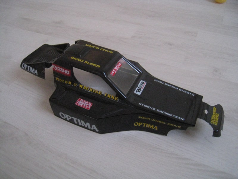

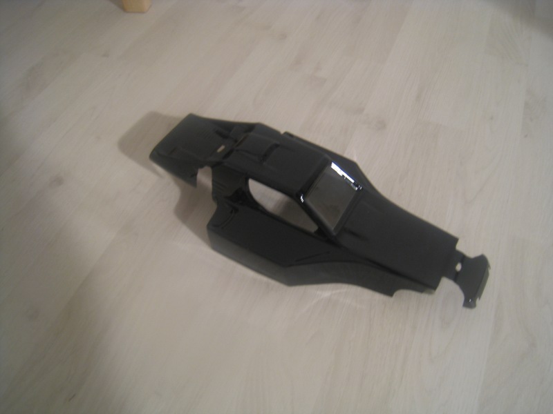

Some progress to this project. I managed to paint the body. Body is a repro from Marwan.

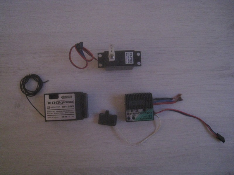

Then something about electronics. Since old Sanwa and CS parts seemed to be disappeared from the universe, I will probably install almost? periodic correct Ko parts instead: The servo and receiver are originally from this car and speedo is almost from the same era.

Then some original Optima decals. I tried to make same mistakes as Jose. Some stickers are not in line, like "sand super" on roof and "kyosho racing team" on hood. Also the sticker in front window is purposely not in the middle. I removed some more lexan around rear shocks too. The first cut would have been enough but now it looks more like Jose's car. From "kyosho" sticker is also purposely little cutter away.
The Drastic stickers to sidepods: I have one, other is hopefully coming soon. Also one more Kyosho's yellow "offraod championship grandprix" is needed above the motor. The only that I have now is in front of front shocks.The other thing that I managed to purchase and modify are Schumacher nicad clamps. Those are NIB parts from practically an other side of the world. I have not managed to find correct white ones (they seems to be very rare), but the blacks are currently OK for me. To make the Schumacher nicad clamps fit I had to drill and cut some plastic away from Optima's nicad holders.
