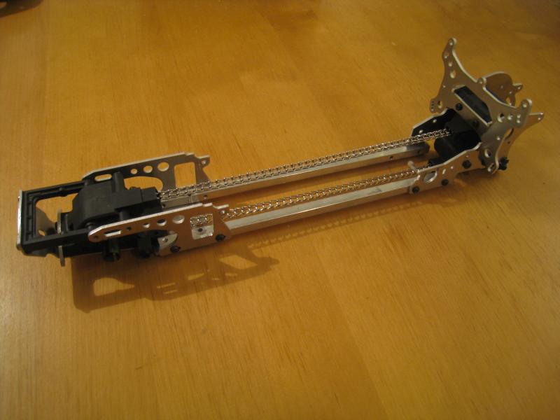

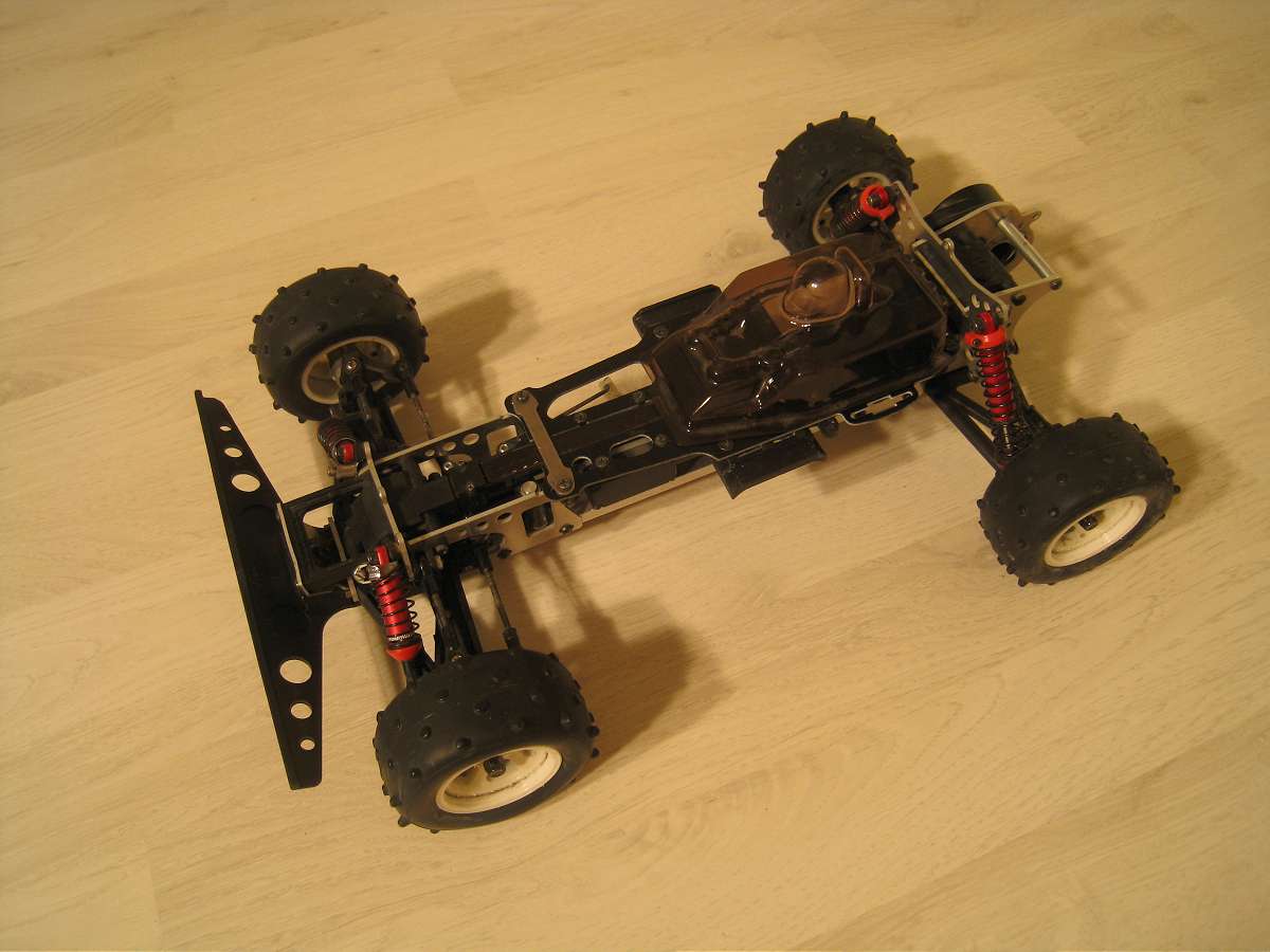

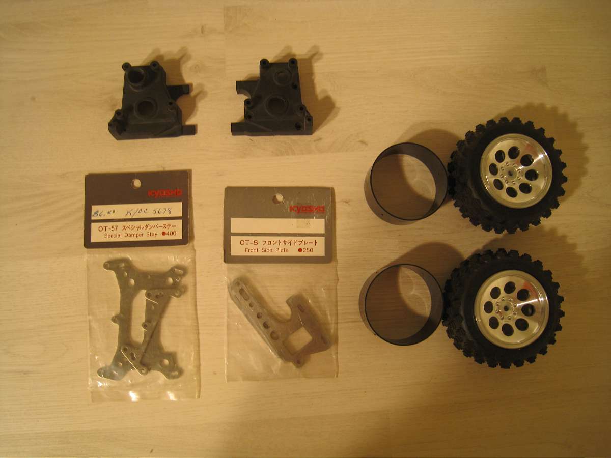

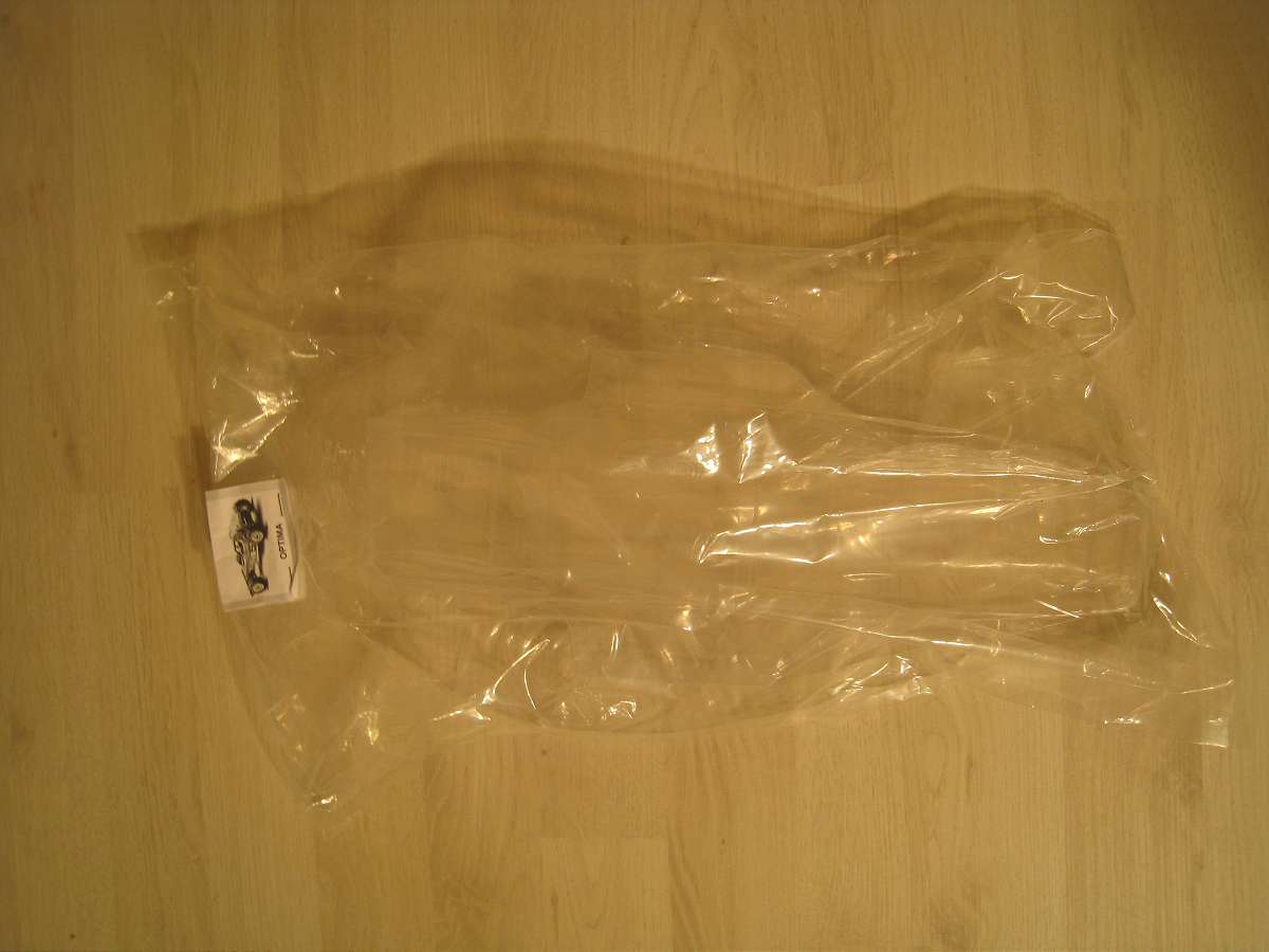

Like some of You might already know, I have started some time ago to build a replica from Jose Rosas euros 1986 winning Optima. The road so far have been a little long, but million thanks to some members here, You guys are just great.
Background for this project is quite simple. I got a Optima that was in great shape, runned only indoors in carpet so no scratches etc on bottom, only few broken parts to replace. OK, what I should do with it? I have seen numbers box art Optimas but as a RC race car driver my choice was to make this a replica of some real race winning Optima. I remembered a race coverage from 1986 euros from a finnish magazine called Pienoismalli and that there was some great pics from Optimas, especially from the winning car drove by a Frenchman Jose Rosas. My choice was clear, this will be it. As a kid in 1986 I have watched those pics so long that and many times and as a Christmas present, I got a Turbo Optima same year so my old HotShot went to retire.

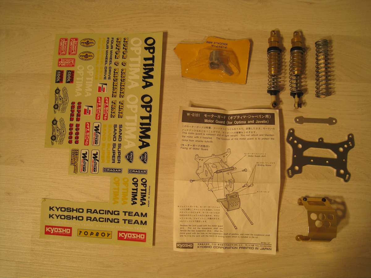

So here are some pics of my Optima and some parts that I have managed to purchase so far: This sticker was the key part to this project. Thanks to prp for finding this to me. Story behind this is long and all I can say thanks Pierre! I still need an another sticker like this. If I could not find one, I would have to reproduct one somewhere.
Jirka

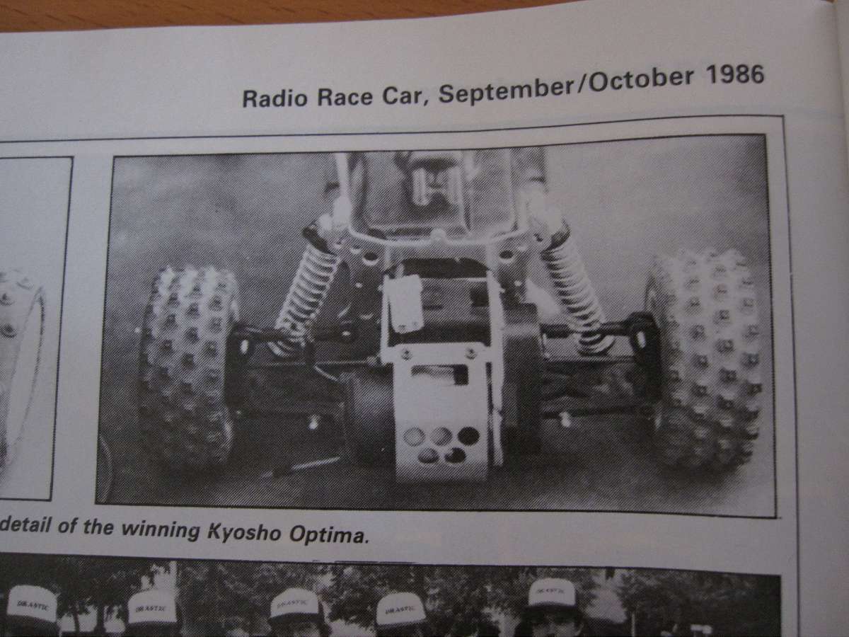

Now it is time for some pics from that race, 1986 offroad euros:

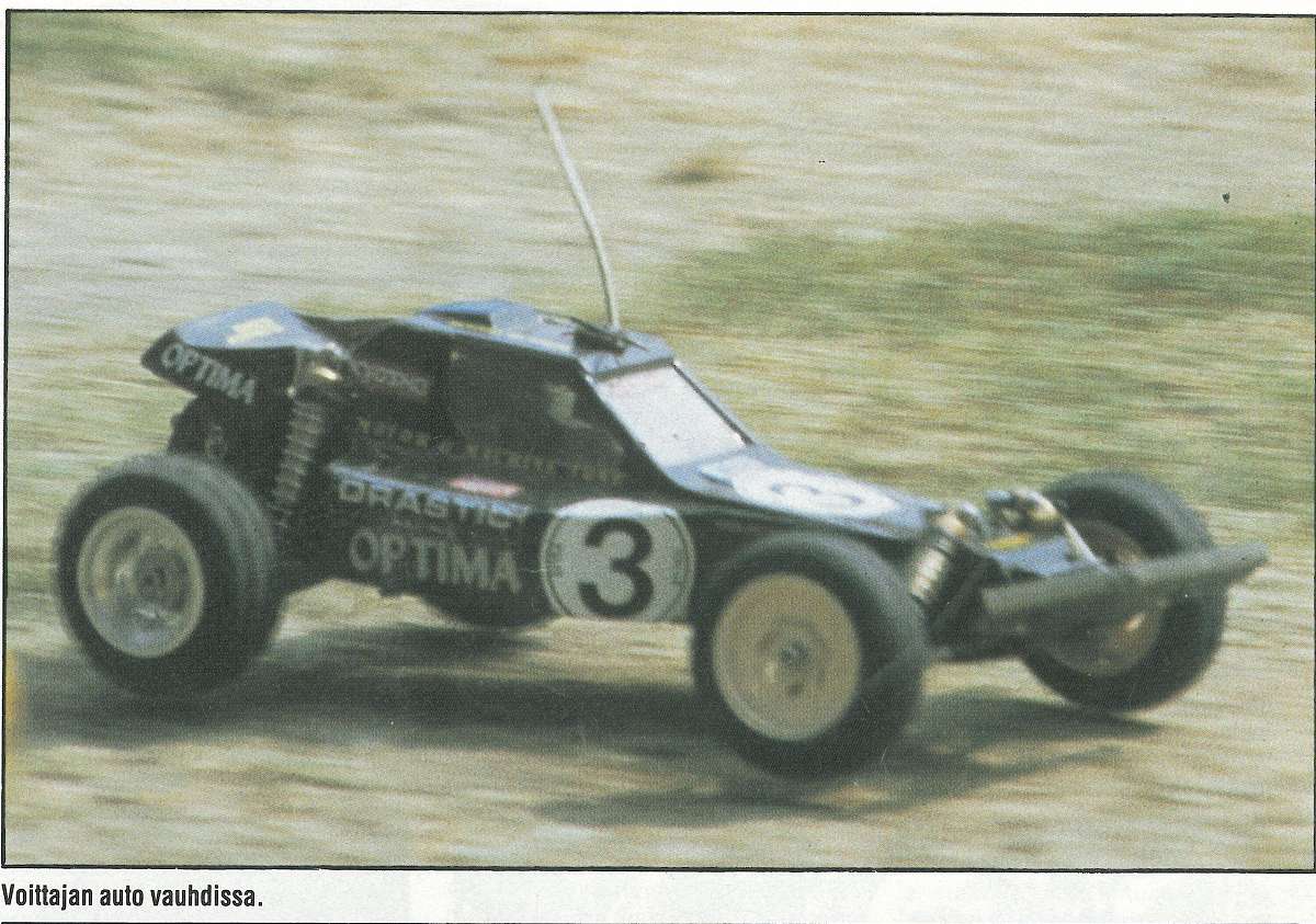

This pic is probably from qualifying, there is number 5 in the car. Also Hotshot wheels and Tamiya tires front and rear are in use, rear stabilizer is in use and there is some preload in rear springs. But here is something odd on the wheels and adapters, are those adapters from Hotshot? I could see three little red overhang in wheels. Could those really be adapters from Tamiya Hotshot or if not, what are those? And if they are from Hotshot, how are they assembled to Optima?
This pic is from Pienoismalli magazine and it is from one of the three A-finals, there is number 3 on a car since Jose qualified third. Rear tires and wheels are now Option House and there are no preload in rear springs. Also there is no more rear stabilizer.

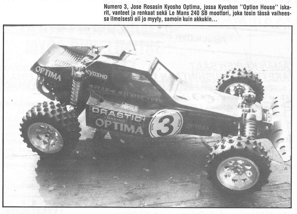

This pic is from Pienoismalli magazine and it is taken after finals. There is now Option House front wheels and tires but probably only because of promotional reasons.

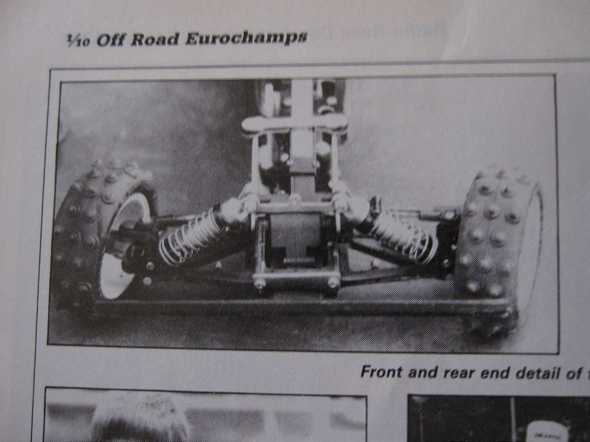

This pic is from RRC and it is taken straight after finals, Hotshot front wheels and Supershot front tires are installed. Aluminum screws here and there but not everywhere. I heard that French Drastic team got those aluminum screws in middle of the race and installed them around their cars during race.
This pic is from RRC too. Some ultra long screws seems to installed on upper suspension arm out mounting. What are those motor connectors???

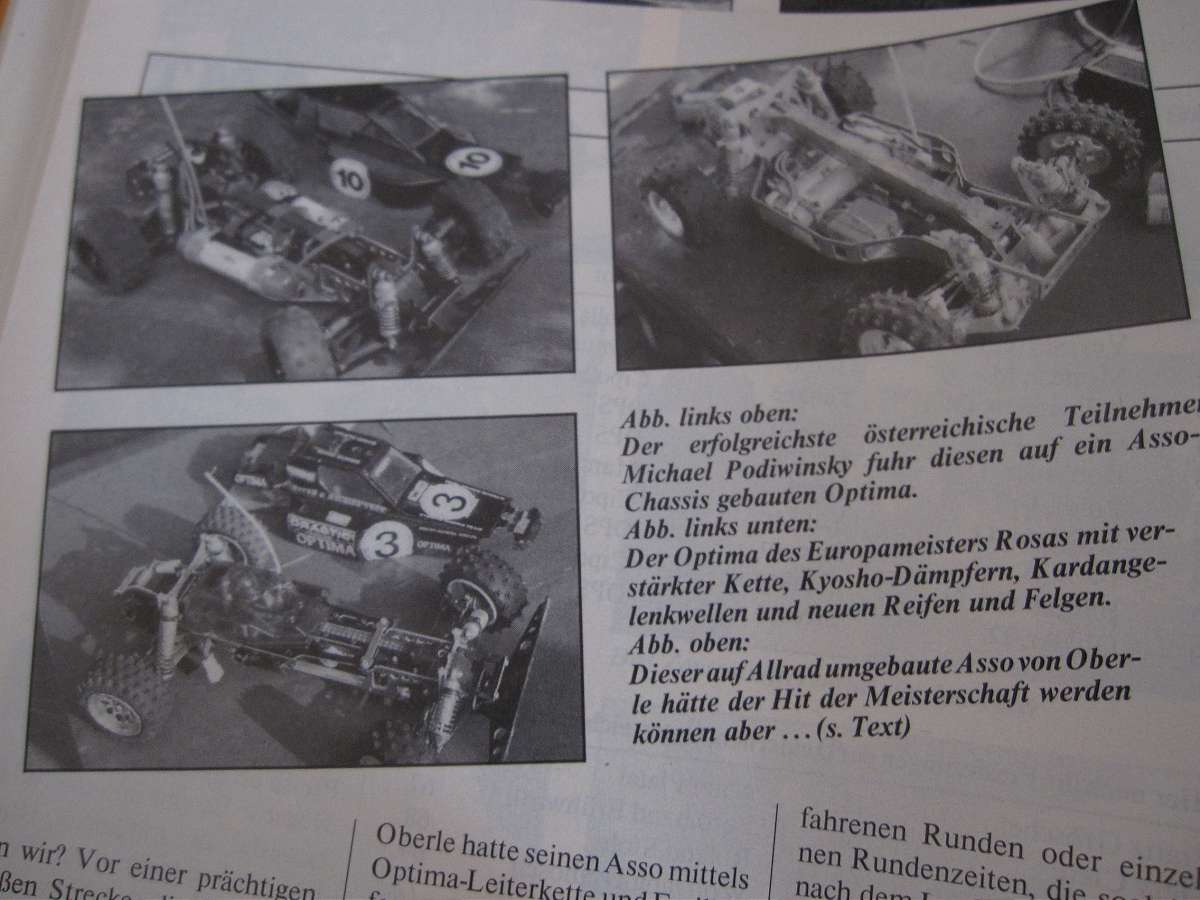

This pic is from some German magazine that I got from member V12 with lot of information about that race. V12 Was driver in that race and he did drive Optima there. Not a bad driver, finished 13th in that race and was the best driver from his country! What are those clear chain cover windows? Anyone familiar with those?

I may be wrong but RW Racing had some adaptors that fitted Supershot rims...could it be the ones he had used?
- Jirka
- Posts: 797
- Joined: Mon Feb 23, 2009 8:40 am
- Location: Europe
- Has thanked: 30 times
- Been thanked: 24 times
Re: Jose Rosas's euros 1986 winning Optima replica
I know that CRP made those adapters, but they were black plastic. Then there where some other adapters in red (just a little darker than Hotshot red plastic was) anodized aluminum, but in those there are only two overhangs.

Here are the CRP ones on eBay:Jirka wrote:I know that CRP made those adapters, but they were black plastic. Then there where some other adapters in red (just a little darker than Hotshot red plastic was) anodized aluminum, but in those there are only two overhangs.

I cranked up the saturation on one of the pics, and you can more easily see the red adapters behind the wheels.

I have a set of those hotshpt wheel adapters: I think they were hot-tricks but they have been taken out of their package a decade ago. They are red anodised aluminium with the conical part just like the kyosho hexes. The part you see through the wheels is another material and colour, not sure what.

That time there were also some red wheel adapters made from red plastic maybe from Tamiya. These were very common among the Optima drivers and I used them also.

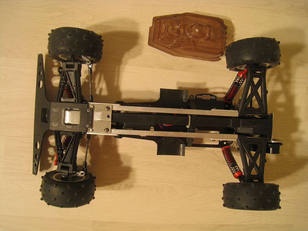

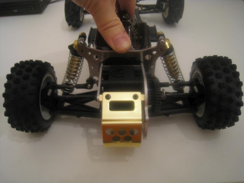

A little update:
After cleaning all parts, the base chassis is done.
Stabilizer balls were dark and fuzzy. The one on right is brushed with brass brush.

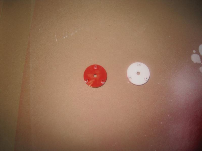

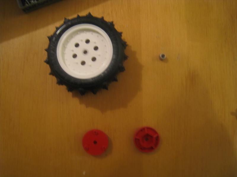

OK, this is not very professional. Since I have not found correct Tamiya adapters, I got some black CRP adapters. First I did drill three small holes to them so they looks like Hotshot adapters. Then I sprayed them first with matte white and after that bright red. Hopefully someday I will get the correct Tamiya adapters.
Now both adapters are done. Painted red on both sides.

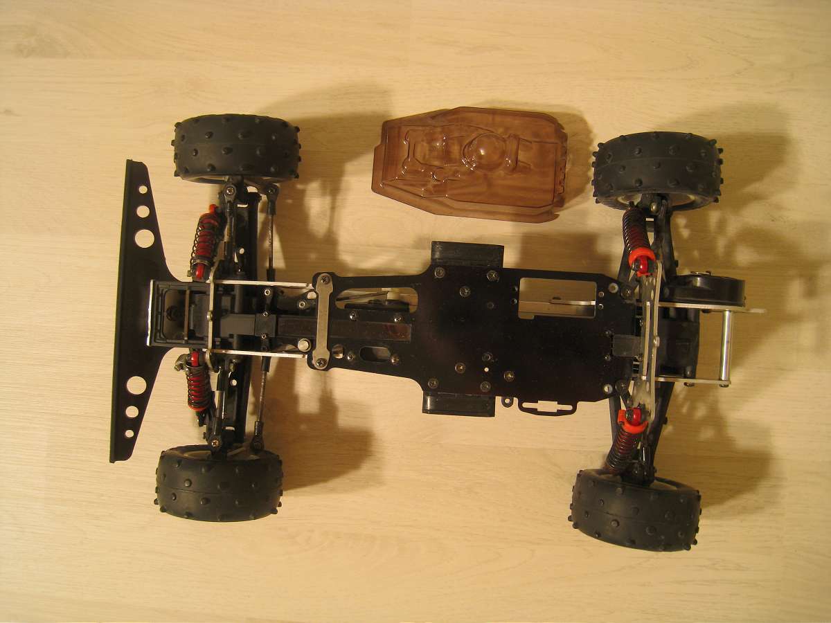

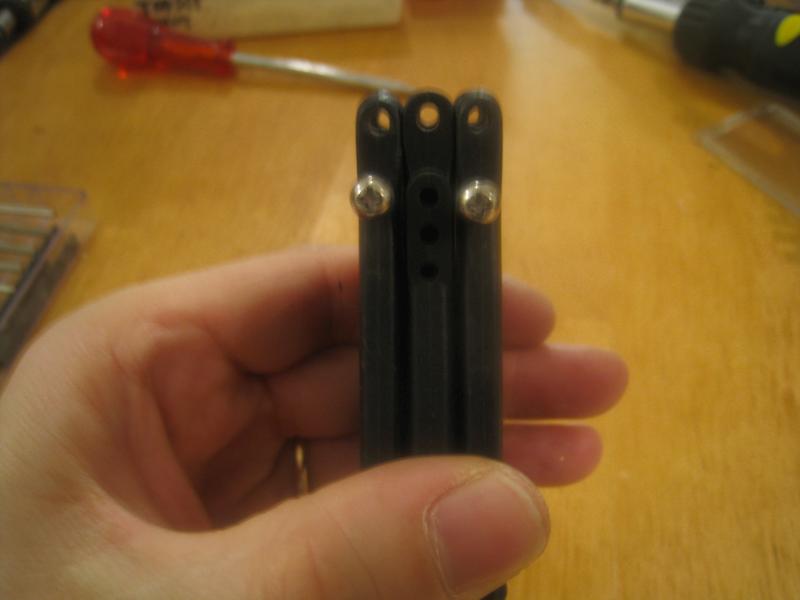

Now I am playing with rear arms. Since Jose installed his rear shocks to lower A-arm rather than to rear hub carrier I am trying to find correct mounting point here, Optima lower arms does not have these shock mounting holes. The car is assembled temporary with Turbo Optima/Mid rear A-Arms and the shocks are mounted to middle hole. It looks close but not quite right.
Now it is better. The outermost hole is closer where the rear shocks should be.
Turbo Optima/Mid arm is in the middle, it is a little beefier also. My modified Optima arms are on both side and ready to be assembed.
Jirka

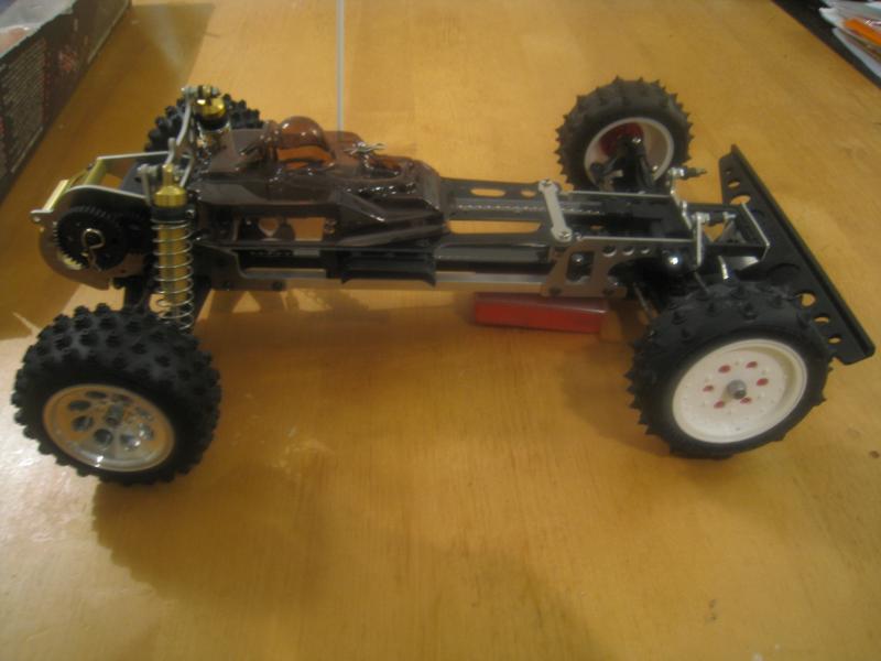

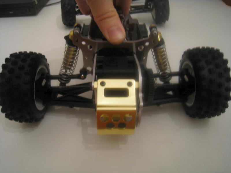

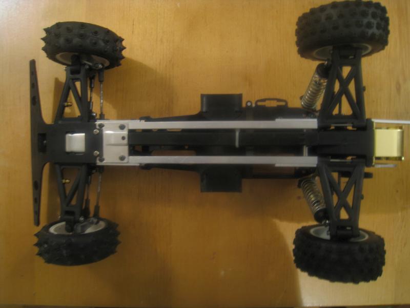

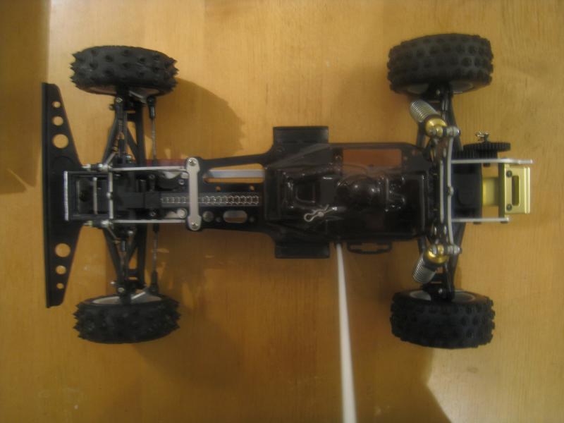

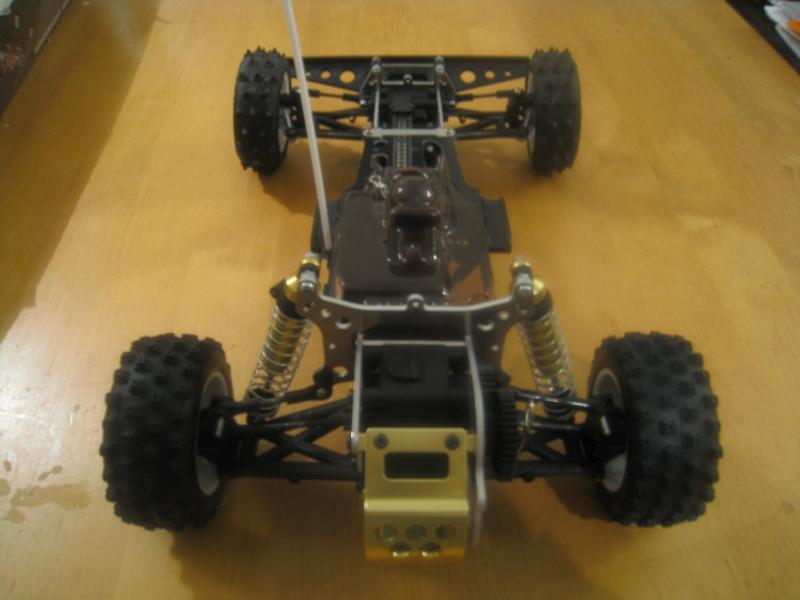

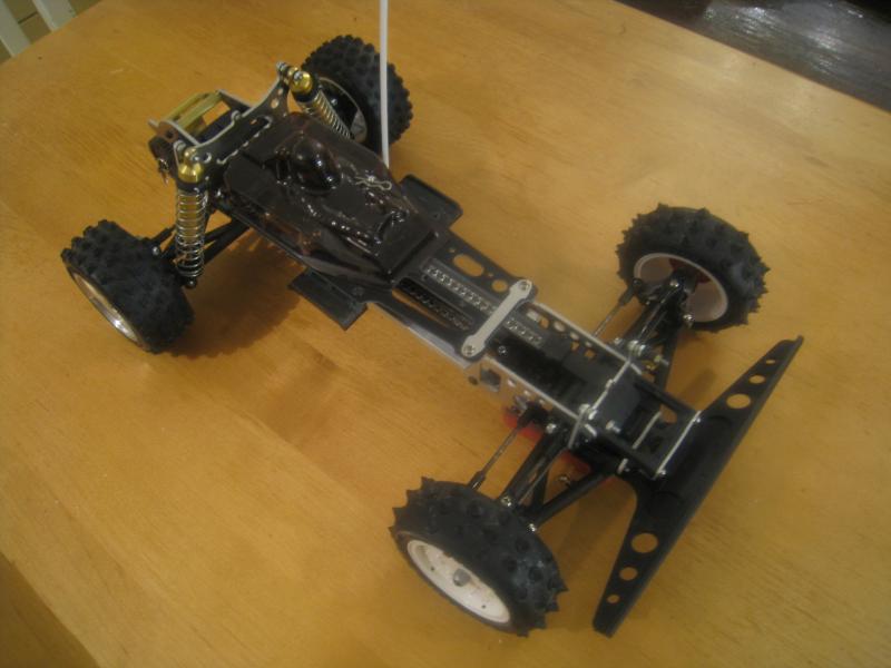

I don't have all the needed front shock parts yet, they should be on their way. This is how the car looks now.
The chain windows are self made clear lexan parts on top and bottom. I have tried to find all correct (looking) screws and nuts too. Kyosho aluminum here and there and also light gray screws and two nuts to every to upper shock mounting.
The correct electronics seems to be the hardest parts to find. Vintage Sanwa servos SM-731 or SM-631 and receiver SRC 2298RS 41MHz seemed to be disappeared. The same is with CS Rocket FET speed controller. I even contacted CS factory, but they didn't have any left. The maybe correct motor, Le Mans 240S, should be easier to find. Still missing part is also one white Drastic sticker to the body.
