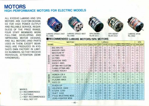

I'd disagree with Coelacanth on the 480T. The reason for this is that 480T was released 1989 in the era when there was 1700SCE cells. With those cells 19x2 would be grate 1:12 scale (= 8-minute endurance) motor. Both 240S and 240SB motors were from mid 80's when there was only 1200SC cells. Both those 240 motors were meant to 4-min offroad I think. Since both 240SB and 480T have exactly same wind thay are really close similar motor. I don't know about their default timing, differences in magnets or can/armature technology, so if there is difference it should come from those. In this case it does not matter what number Kyosho did print to the can sticker.
Here in one pic, I don't know what it "says" but take a look: Also here is a well know "The Le Mans Picture" the the middle of the page: http://theoptimahouse.blogspot.fi/search/label/MOTORS See: 21 Jan 2007
But what should You do now when there are two different opinions? If I was You I would first try 240S with 9-11 tooth pinion on motor and see how that works on car. Then try 480T motor. Since undergearing is less harmfull to motor than overgearing start with same pinion on 480T then there was in 240S and see how it goes. If speed, acceleration etc are about the same as in 240S, then You have right pinion. If not, try bigger pinion. Of cource on first run(s) stop after every 1-minute and feel the motor. If it get way too hot, You have too big pinion. But also remember that use these motor on (race) track, not in backyard etc. If You only accelerate on small area, these are too powerfull motors to and only generates heat. It is always easier to motors to be run on straing and acceleraing from even little speed. If You accelerate all the time from zero, motor taken so much more amps and get hot really easy. This was also a little answer to Your "Motor advice" topic.
Yours Jirka
EDIT: Added a little text, picture and link.
Yours Jirka

I agree with some of the details you pointed out, but you can make some inferences from that picture. A motor that's best suited for on-road racing will certainly perform differently than a motor suited best for off-road. Generally speaking, the on-road motor needs significantly less torque and maybe higher RPM, as on-road cars are far more efficient and aerodynamic than their offroad cousins. There's a reason why the 480 series is recommended for onroad, but the 240 series are recommended for offroad. If the motors were so similar, why would this be?Jirka wrote:I'd disagree with Coelacanth on the 480T. The reason for this is that 480T was released 1989 in the era when there was 1700SCE cells. With those cells 19x2 would be grate 1:12 scale (= 8-minute endurance) motor. Both 240S and 240SB motors were from mid 80's when there was only 1200SC cells. Both those 240 motors were meant to 4-min offroad I think. Since both 240SB and 480T have exactly same wind thay are really close similar motor. I don't know about their default timing, differences in magnets or can/armature technology, so if there is difference it should come from those. In this case it does not matter what number Kyosho did print to the can sticker.
Regardless of what Kyosho have printed out in the link to the second often-referenced Le Mans motor info picture, I'd be willing to bet a 360 Gold AND 240S would significantly kick ANY of the 480 series motors' ass for torque and power. Forget windings and RPM. There's no way a motor that takes its sweet time to deplete a NiCd battery in 8 minutes will out-torque & out-race a motor that kills that same battery in 4 minutes, again regardless of what's printed on the can, the turns, windings, RPM. The 240 will have approximately TWICE the oomph. Period.

I was really really surprised when I saw that both 240SB and 480T have same winding 19x2 made by 0.65mm wire. I first thought that those have to be same motor with different sticker printed to can, of course 240SB have aluminium endbell and machined can, but those features are are more bling bling than make some serious performance differences, maybe more to the cooling. But now I found out that those are quite a different motors: In "The Le Mans Picture" there is info about motors rpm. 240SB 30000rpm and 480T only 26500rpm. I don't know does that difference comes from WET magnets that 480T maybe have, SPA motors were the 1st ones (in the RC world?) with WET magnets. If 480T was released after SPA motors and have WET magnets then this might explain the big difference in RPM. I understand that those rpms in ads does not have practically nothing to do with motors real performance, but if they got those rpms from same lab with same equipment. Also timing plays big part here. I assume that 240SB was measured with default 0-degrees timing, but I don't know about 480T, does this motor have adjustable timing or is it made to the "stock" motor can? I have not seen good pictures from 480T endbell. One more thing that might make some differences is brush spring, if 480T have softer on-road type brushes and 240 series harder springs. But the big difference are those SCE cells that do not create as much torque as earlier SC and SCR cells. Because of this same 19x2 wind might be more suitable to on-road cars with SCE cells than it was earlier to offroad cars.Coelacanth wrote:I agree with some of the details you pointed out, but you can make some inferences from that picture. A motor that's best suited for on-road racing will certainly perform differently than a motor suited best for off-road. Generally speaking, the on-road motor needs significantly less torque and maybe higher RPM, as on-road cars are far more efficient and aerodynamic than their offroad cousins. There's a reason why the 480 series is recommended for onroad, but the 240 series are recommended for offroad. If the motors were so similar, why would this be?Jirka wrote:I'd disagree with Coelacanth on the 480T. The reason for this is that 480T was released 1989 in the era when there was 1700SCE cells. With those cells 19x2 would be grate 1:12 scale (= 8-minute endurance) motor. Both 240S and 240SB motors were from mid 80's when there was only 1200SC cells. Both those 240 motors were meant to 4-min offroad I think. Since both 240SB and 480T have exactly same wind thay are really close similar motor. I don't know about their default timing, differences in magnets or can/armature technology, so if there is difference it should come from those. In this case it does not matter what number Kyosho did print to the can sticker.

Well, I'll conclude by saying this much: I've restored and ran a 480 Gold recently, as well as a 360 Gold, and I've seen what a 240SB can do. The 480 Gold would be superior to the 480T, IMO...and the 360 Gold will kick a 480 Gold's a$$...and a 240SB will kick a 360 Gold's a$$.
A 480T would be a decent, small upgrade over a Mabuchi 540 silver-can motor, but wouldn't hope to compete on a track, either back then and certainly not now. It's a good, mild basher motor. Same goes for the 480 Gold. If you want to really kick up some rooster-tails, go with a 360 Gold or 240 series...but make sure you put in the correct 8 to 11-tooth pinion gear.
