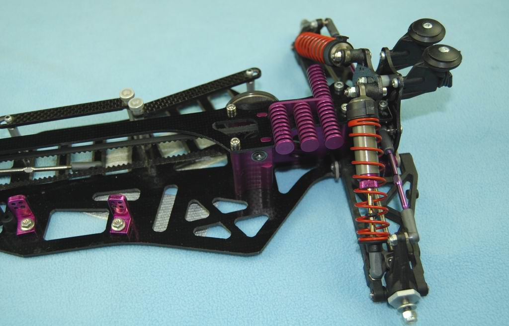

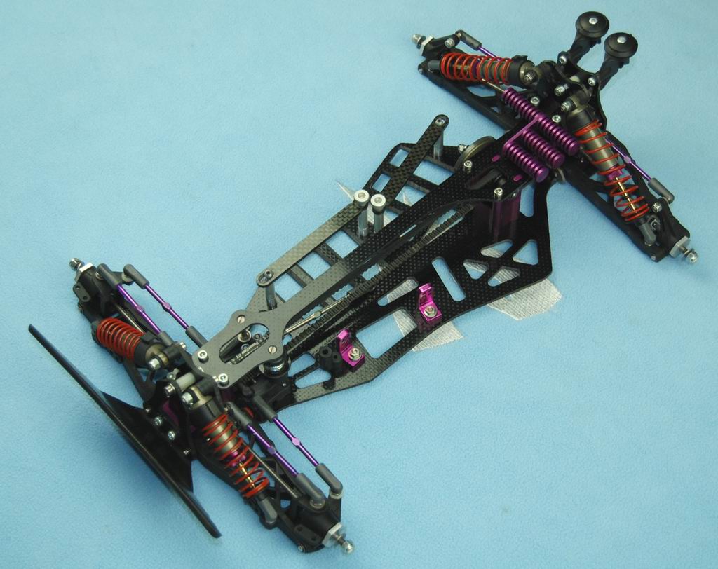

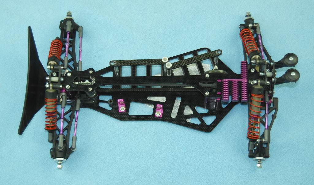

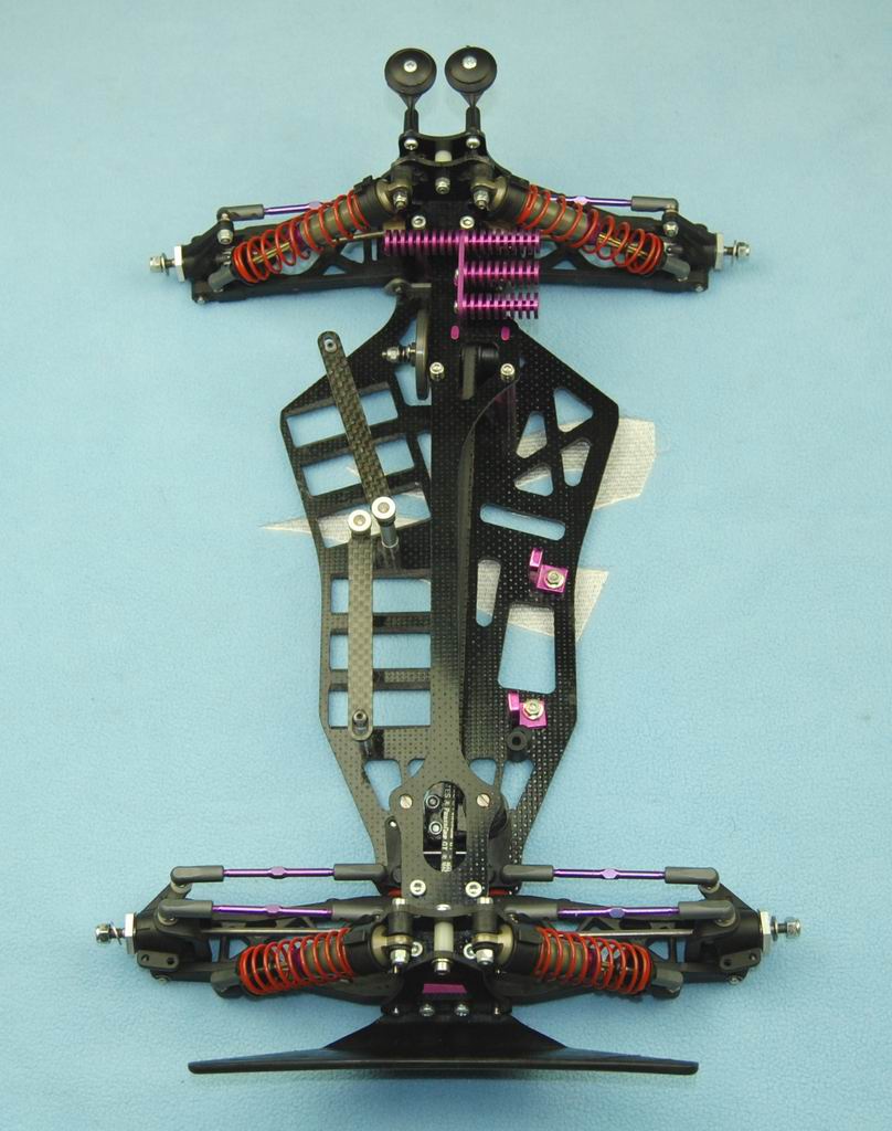

Here's some pics after more cleaning and rebuilding the shocks.
I scored some nice Lunsford turnbuckles which were meant for a Losi xxx4, from a local hobby shop.
These turnbuckles are exactly the right length for this series of cars.
Now I'm just waiting for the new shell, undertray and bearings to arrive.

It's been a long time coming, but here are the pics of the fully rebuilt car.
These shots were taken just before the first track outing and I ran out of time to get shots with the body and new wheels on.
The next pics were taken after racing on the weekend, so the car isn't as clean and nice as it was when finished.
I was pretty happy with the cars performance and it was blindingly fast with the Reedy 7.5. I had a bit of a problem with the ESC overheating due to running 20% drag brake, but this will hopefully be resolved with more weight in the front, less drag brake and cooling holes in the shell. I'm hoping more weight up front will make it turn in better without the need for running so much drag brake.
Sorry about the bad mobile phone pics
