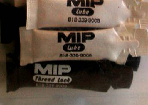

I've always used the black MIP thread lock that's included in the package, never had any issues.
Product # is MIP1013 you get both thread lock AND the CVD lube.
