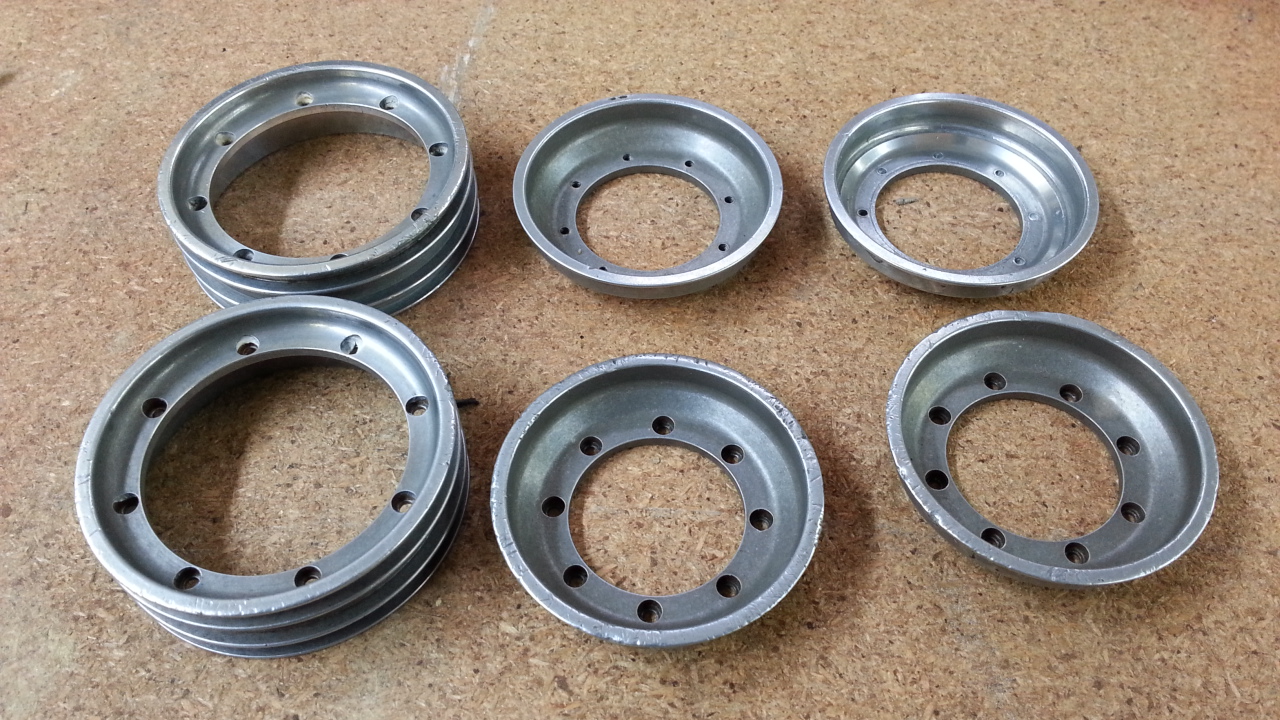

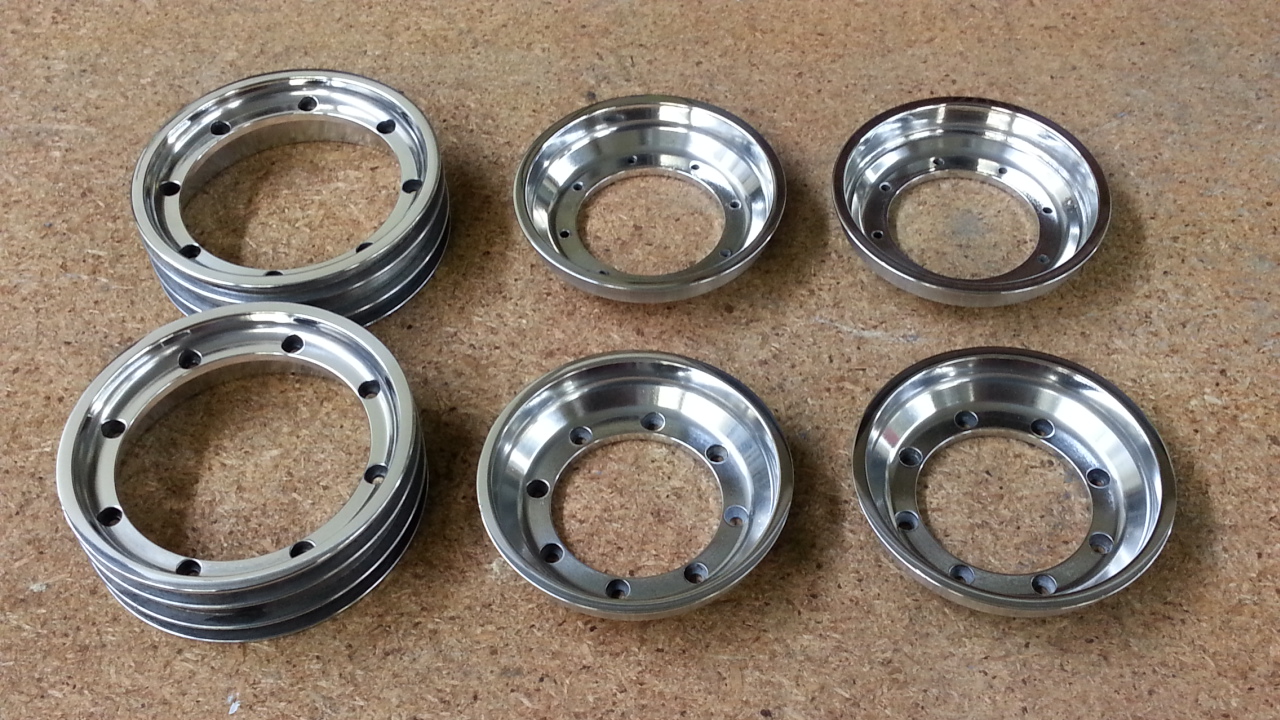

A fellow member asked if I could work any magic on a used set of tecnas. Well here are the hoops, before and after. They turned out decent.

Nice :!:
The beauty of aluminum.

Man, someone actually sent you something R/C-related to finish? :mrgreen:
Those look good! What steps were involved?

I imagine a lot of wet-sanding, rubbing compound & polishing. :) Nothing beats the classy glossy shine of polished aluminum. 8)

well, first the lips on the rear outers had to be straightened. that consisted of setting them face down on a small anvil i have and tapping them around with a hammer. after that, i started with 180 grit to remove the gouges quickly. then stepped down from there. 220, 320, 400, 600, 1000, 1500, 2500, 3000. i set the paper down on the counter top and ran the hoop over it in a circular motion keeping it flat. i had a new mothers mini powerball in the polish cabinet, so i cut it down to just fit inside the hoops. chucked it up in the drill and went to town.
the only thing i sanded was the outer lips. the rest of the hoops were decent, just oxidized. i did rub over those areas with some steel wool to help brighten it up before polishing though.

Those really came out nice! I tend to do mine the same way but I substitute scotchbrite pads for some steps, use a dremel with polishing compound and use Mother's mag polish on them whem I''m done.

Those came out really nice

The key is to get the surface as smooth as possible before putting and polish to it. Once smooth used some cotton swabs with your polish to get a super high shine
