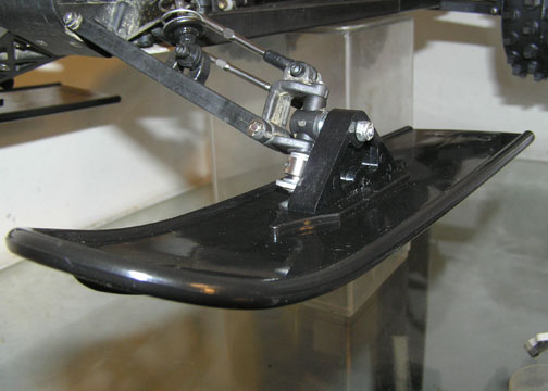

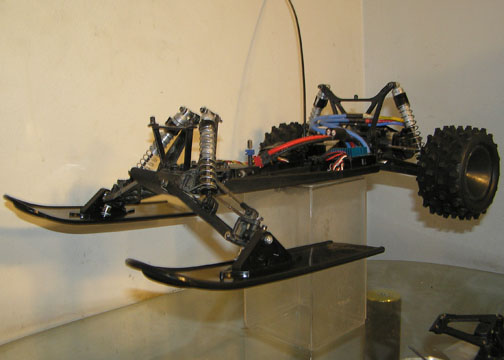

I was bored and want to bash around, we'll see how it goes in the snow :lol:
The Skis are Du-bro Snowbirds. If you try this do not use Park Flyers as they are Lexan, the Snowbirds are polyethelene. I tossed on a rear pair of shocks up front to make up for the loss in ride height. The ESC is a sc700 and water resistant :wink: uh, maybe :lol: I have a spare LRP x11 13.5 BL so we'll see how that goes. Tires are Pro-line Snow-paws *ahem* Dirt-paws :P I plan to run an old buggy body for an over-tray to hopefully keep snow out.

Thanks guys :mrgreen: it was pretty inexpensive/easy and I just needed the skis since I already had everything else - motor, esc, tires etc.
All I had to do is drill the mounts out to 3/16 and make them somewhat springloaded > The skis came with this rudimentary system so they were spring loaded but I had to change that a little due to the unobtainable length of axle needed for a "stock set up", that's why you see normal axles, t4 castor blocks and a long hinge pin used as a king pin used to attach one side of the spring to avoid using their collar/ spring system that I knew wouldn't work :roll:
So... as it turns out, it WORKED :mrgreen: just not in light powder :roll: When the snow turned a little crusty this evening, the ditch digging rear end grabbed and a way it went :lol: I only used a buggy body at this point assuming the extra truck body was just adding weight, I'll have to test that later to see if it matters or not. It was a BLAST :twisted:
The only thing I think could make it better is using carbide studs on the tires and skagging the skis (metal rails attached to make them bite more). I have a lead on some real mini carbide studs made for shoes that I could use on the tires, just not sure what I could use for rails on the skis :?

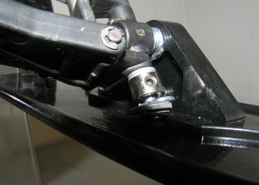

That is awesome! I'm surprised how well it ran, especially without paddle tires! :shock: Looks like it turned better on power than off? Can you show a better pic of how you mounted the ski?

Tried another run today in wet snow, it just dug a ditch and got stuck like it did in powder snow :oops: The skis themselves aren't really the problem, they seem to float over the snow in any condition, it's just the tires and/or weight in the rear that causes it bog down. Maybe a different tire for different conditions is needed or maybe none at all will work in those conditions. I have a couple different tire types, I'll try a few out and see :D
Here's another photo, you should see a little better how the spring is mounted on the axle and attached at the lower end of the king pin. The collar and a few washers were used to keep it from popping off. The long king pin also keeps the ski from rotating backwards. The opposite end of the spring is loaded and pushes down on the rear of the ski keeping it from rotating forward.

How about trying duals on the rear like most winter conversions use? Besides the traction advantage, the larger surface area might increase the floatation since it's putting less pressure to the ground.
