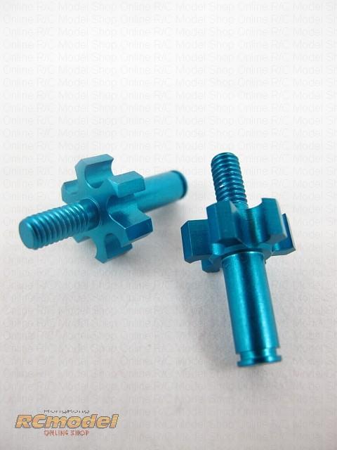

Good point; with in-wheel bearings, sometimes getting the bearings out of the wheels can be a royal pain. And speaking about weight, check out this item I bought which I'll be installing on my OptiMutt project car. I'll call 'em "hexles". :mrgreen: I think they're pretty cool.

Coelacanth wrote: Wed Apr 03, 2013 10:02 pm Good point; with in-wheel bearings, sometimes getting the bearings out of the wheels can be a royal pain. And speaking about weight, check out this item I bought which I'll be installing on my OptiMutt project car. I'll call 'em "hexles". :mrgreen: I think they're pretty cool.
Interesting! Do these let you put hex wheels on the front? If so, did you like them? Can you still get them?
