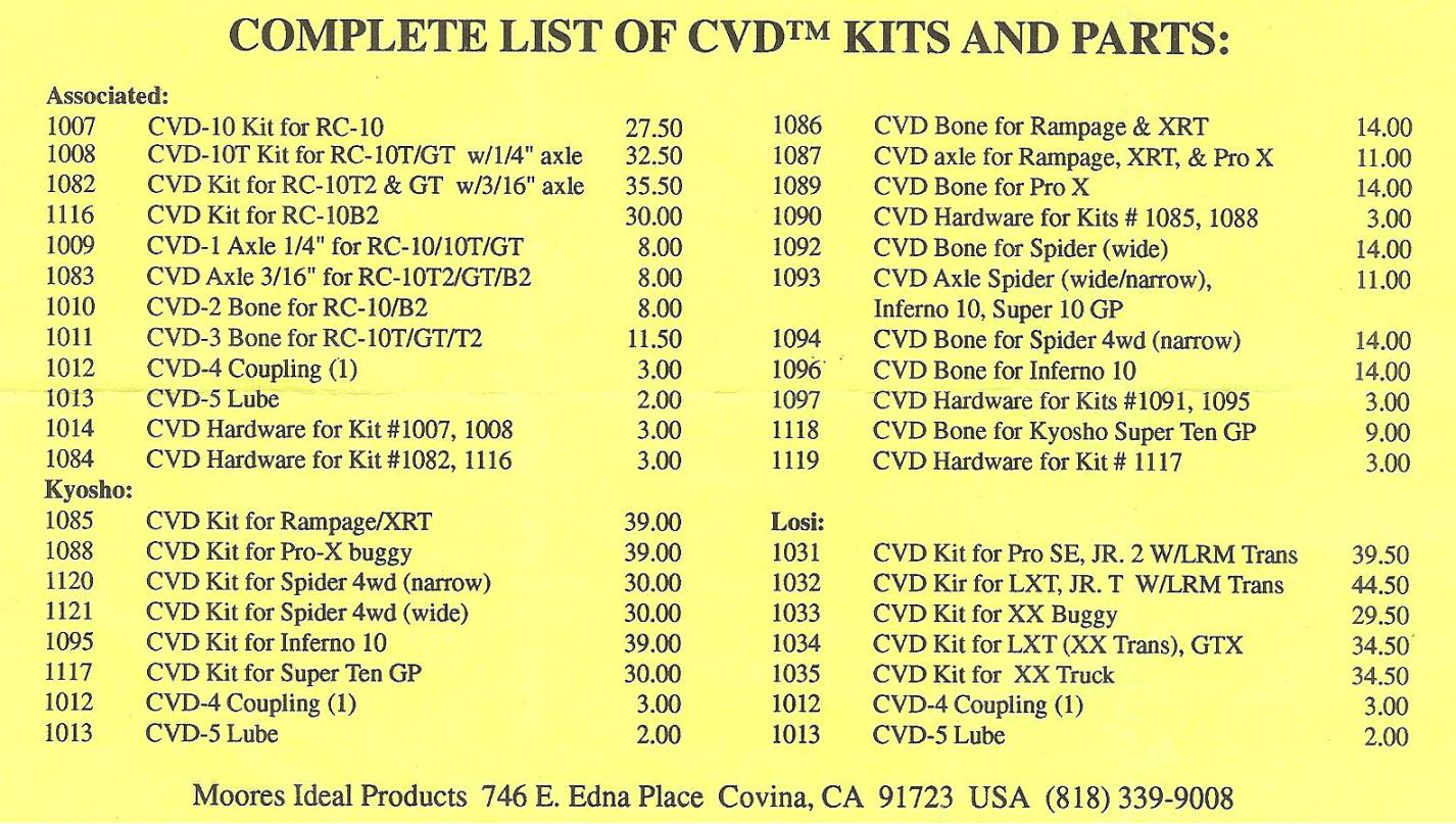

Aaron, any chance you could upload that image to the forum? My work blocks Photobucket and a bunch of other image-hosting sites. That would be simply fabulous.aip47-2008 wrote:Here is an older list from MIP that may help.
I had no love whatsoever scouring the 'Net to find images of those outdated part numbers EvoRevo mentioned...nada on eBay, zilch on the Internet...I don't suppose anyone has those? Without a pic, I have no way of knowing if it might work or not.

Re: CVDs with taper-fit axles?
That's great, Aaron. It gives me a whole lot more to search for. I ended up building a hybrid CVD set for CYANide using info from an old MIP catalog like that, and parts I found on eBay.
