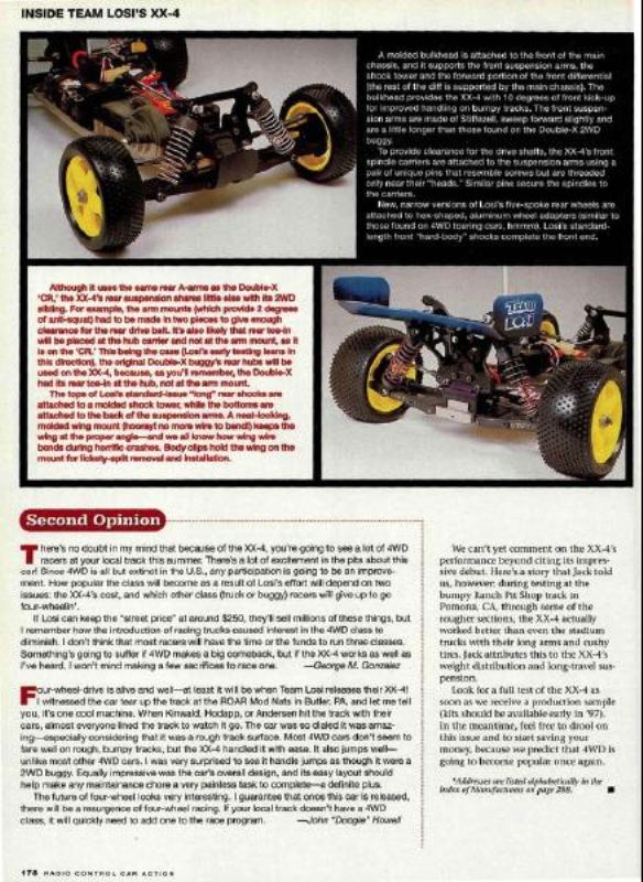

Post by FasterLouder »
One Losi Wheeler I would have loved to have seen was the JRX-S Off Road prototype.
I've owned a few JRX-S touring cars and they are just so smooth...Symmetrical,too.
Last car Gil Jr. designed before Horizon Hobby bought them out.
