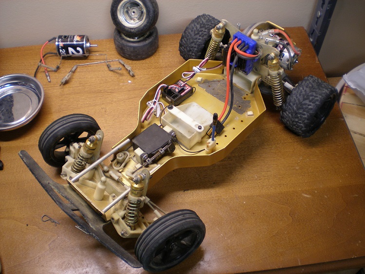

gomachv: Thanks so much! I just placed the order
And for the help, I took some current pics for you guys.
(sorry for the dirt, just came back from testing and tuning)

Re: Modern RPM wide A-arms not fitting correctly.
Yep, I had to cut down the motor shaft with a dremel. I pretty much duplicated the electronics that were in my Slash just to get a good baseline. I thought about brushless but that 12t motor is plenty fast for me. Going to 2.4 GHz was such a good idea, no more jitters from interference.RC104ever wrote:As for the Traxxas motor, I had that in my sons car and it works fairly well. I had to cut part of the shaft off to make it fit under the gear cover though. But it wasn't fast enough compared to my brushless Castle 5700 so I swapped it out and now we are both way too fast
