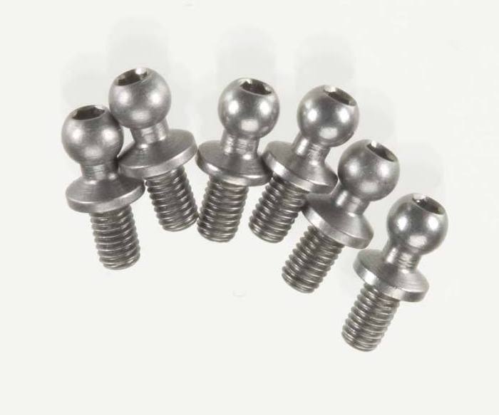

I have a hard time finding ball suds that have a 5.8mm ball, is M3 thread and look something like this…

I use the ball studs and ball cups from the 22. I've redrilled and tapped everything to work. They should be easy for you to find.

Lars, are those threads in the rear arms 3mm? If so, I would suggest using 4.8mm ball studs & ball cups. I never liked Kyosho's use of the larger 5.8mm balls and open-ended ball-ends because they wear out too fast and pop off too easily. Ball cups fit on a lot tighter and the design helps prevent a good amount of dirt from getting inside & in between the ball & cup.

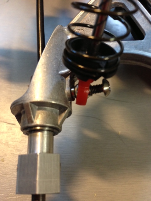

I think I need open ball ends, when I use Yokomo balls as in the picture above the arm doesn’t fall down the last 4-5mm

I used these Delrin open-end ball ends also for the top half of my stabilizer assembly, as the stabilizer wire needs to protrude through the ball ends. Delrin is harder and more durable than plastic, they go on nice and tight and should last longer and have a lower profile compared to a ball cup.Hcp22 wrote:I think I need open ball ends, when I use Yokomo balls as in the picture above the arm doesn’t fall down the last 4-5mm
