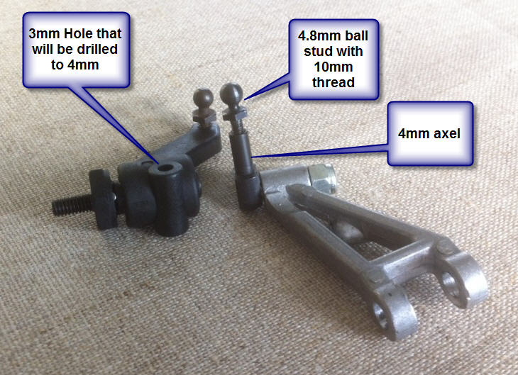

Lars, I don't know where You need "4.8mm ball studs with long 2.6 mm thread (10-12mm)". If we see a picture of Your "problem place" we might help You to make a workaround to it. Might it be possible to install 5-7mm collar under the ball studs? And if You start to machine parts, do them rather like Mr.ED suggested, if possible.
Jirka

Jirka wrote:Lars, I don't know where You need "4.8mm ball studs with long 2.6 mm thread (10-12mm)". If we see a picture of Your "problem place" we might help You to make a workaround to it. Might it be possible to install 5-7mm collar under the ball studs? And if You start to machine parts, do them rather like Mr.ED suggested, if possible.
Jirka
Convert Scorpion to 12mm Hex...
Cheers
Lars
My Feedback
