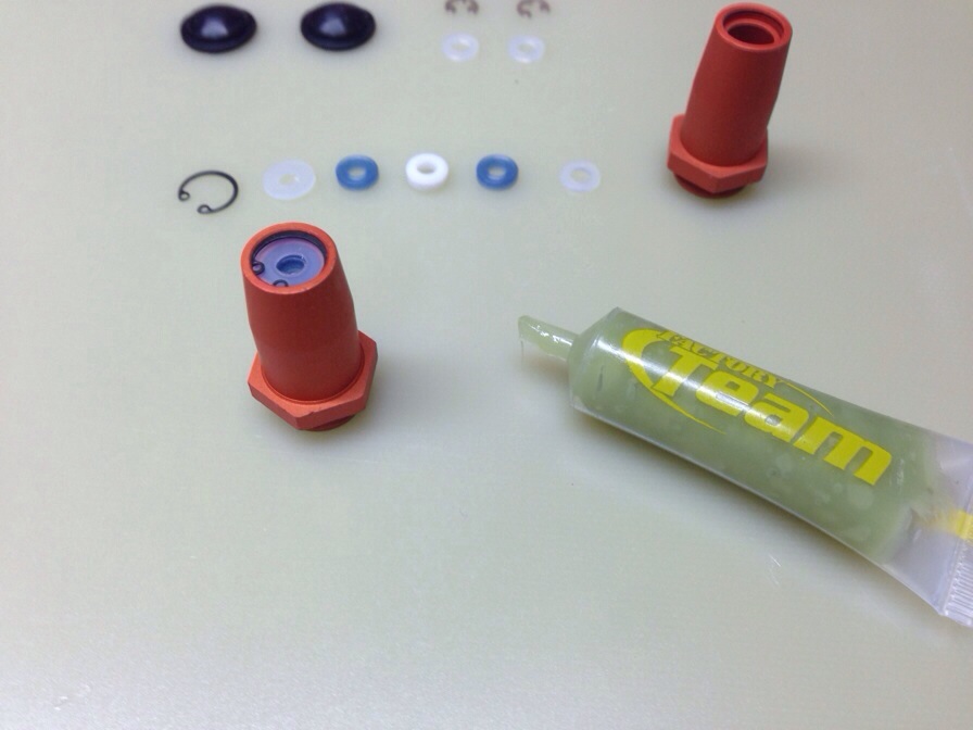

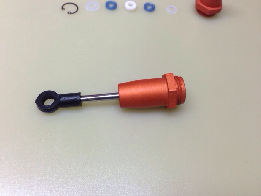

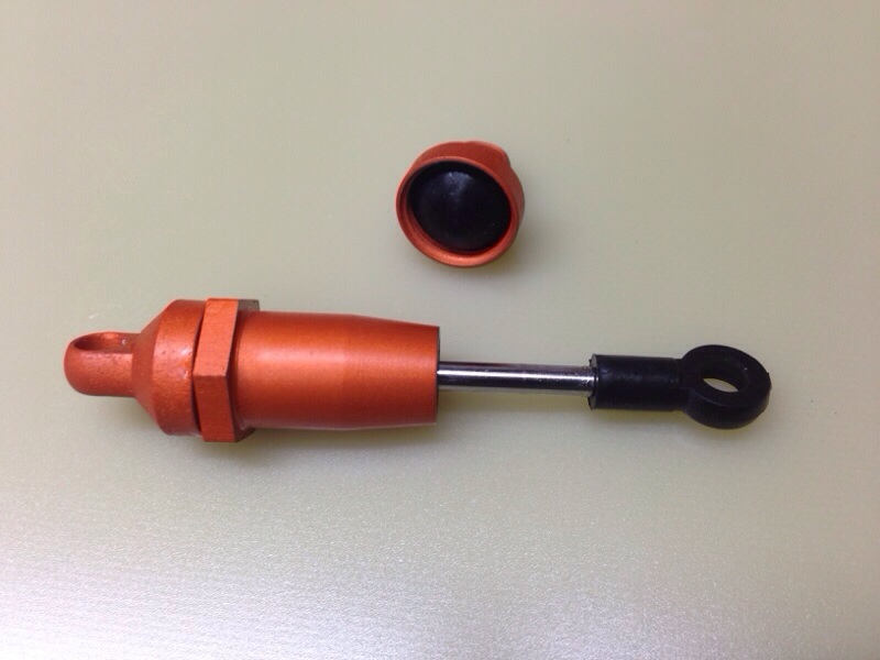

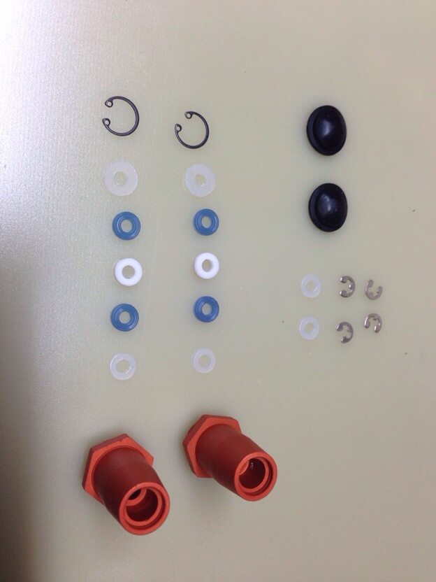

This is a popular way to rebuild your bottom loaders. I would still recommend using associated cap and shaft orings
Rebuild in the same was as the manual shows, using associated orings in place of the blue ones shown in my pics.
You can use the diaphragms if you wish, i find that they don't seal well. Standard cap orings are better.
I recommend green slime during install, it will help keep from cutting the o-rings and make the assembly easier

gomachv wrote: Rebuild in the same was as the manual shows, substituting the blue x-rings for the orange o-rings.
So why did you put the blue rings in?
Is the height of the traxxas seals/spacers the same height as Associateds?
Posts: 12244
Has thanked: 1101 times
Been thanked: 3787 times
Re: How to: rebuild bottom loaders with Traxxas 2362 kit
don't use the blue x-rings. I found them to not seal well in these bodies.
The spacers are the same size as associated.
