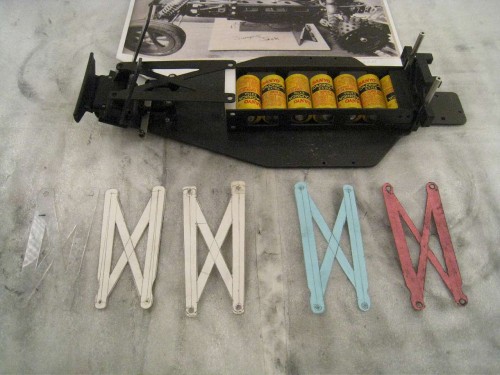

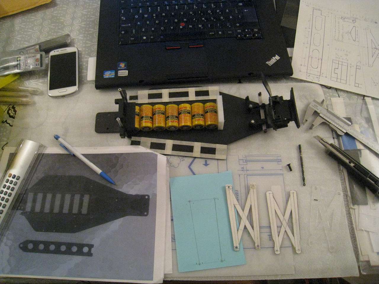

Finally some progress...

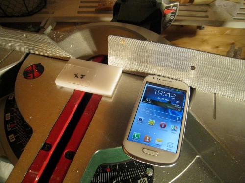

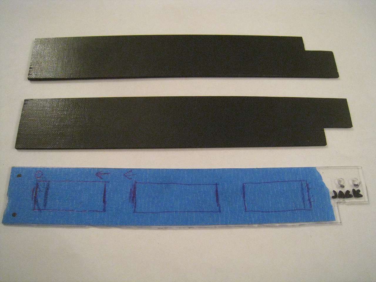

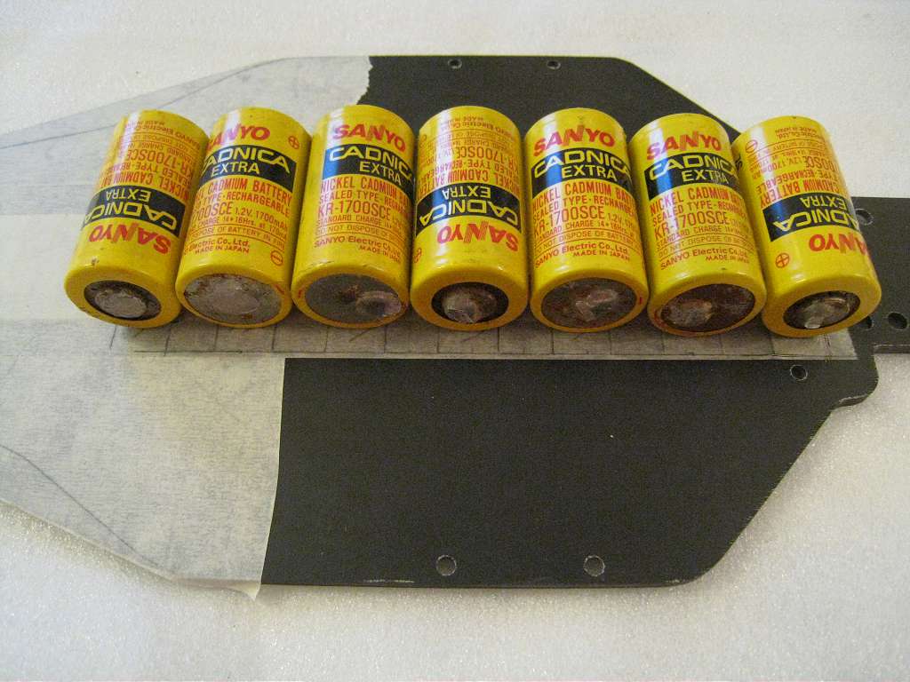

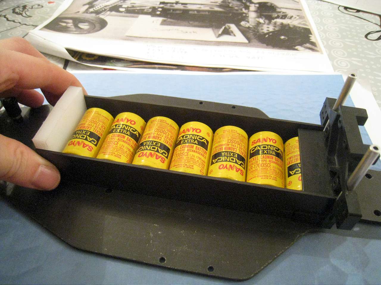

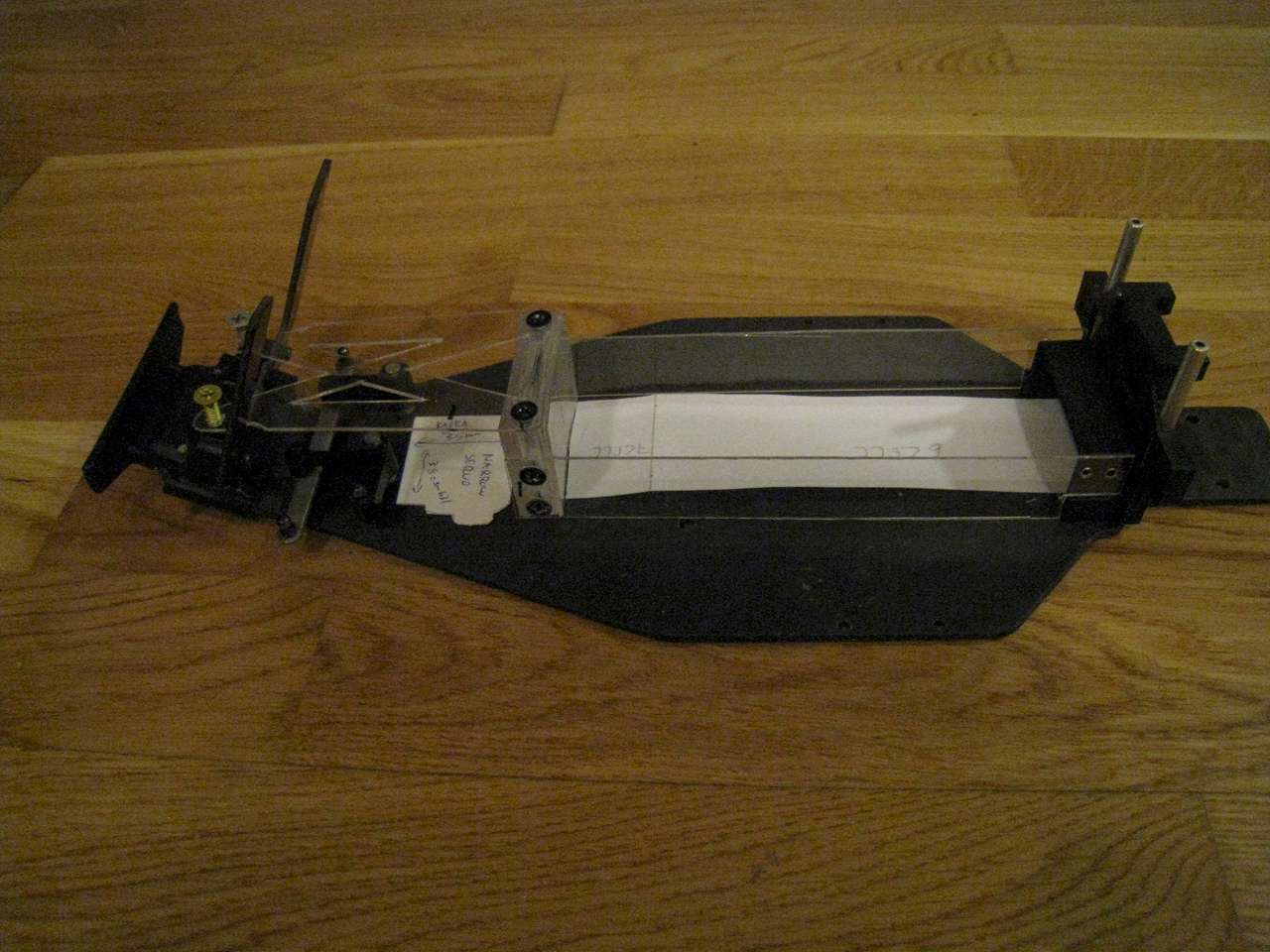

In 2012 November I made first chassis parts out of thin acryl sheet.
The white papers are just represents 7-cell long battery pack and as big servo as it would be possible to fit in servo area. The side rails are about right - they are just a bit higher than "battery box" in rear bulkhead. The part in front of battery, lest call this "middle bulkhead" is a bit too thick and because of this the "X-part" is too short and it is also a bit too beefy.
About year later, very late November 2013 it started to get cold in here. I had to start do parts if I wanted to something to do during winter time.

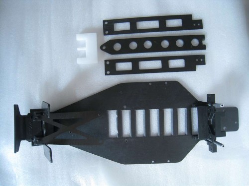

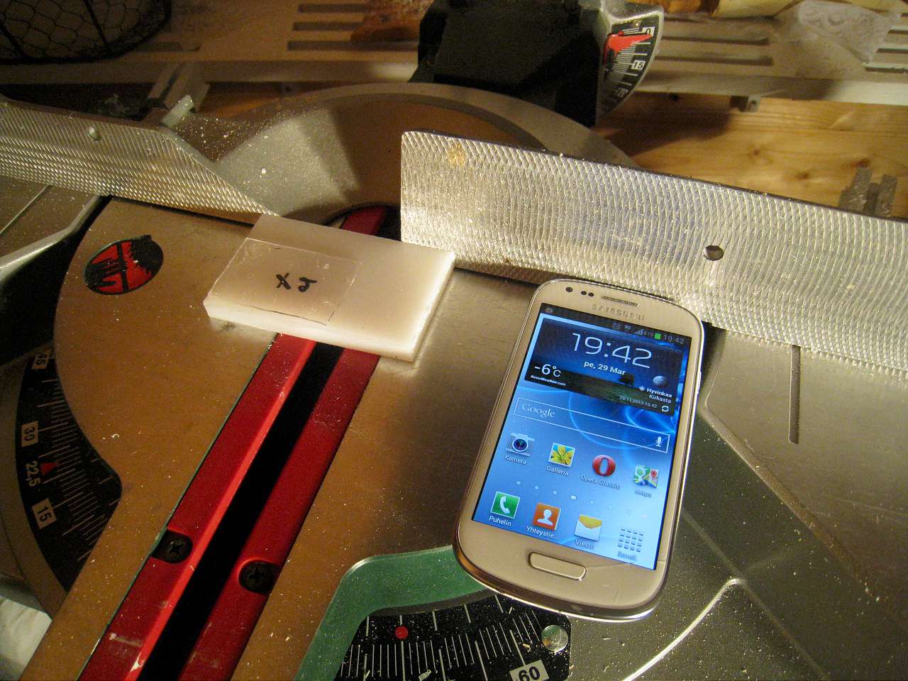

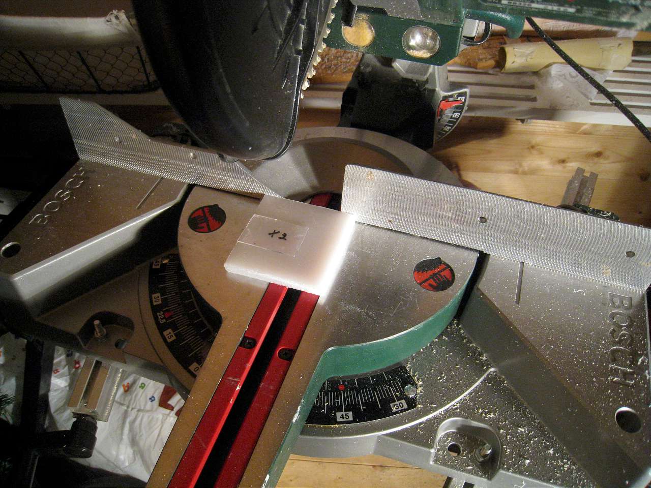

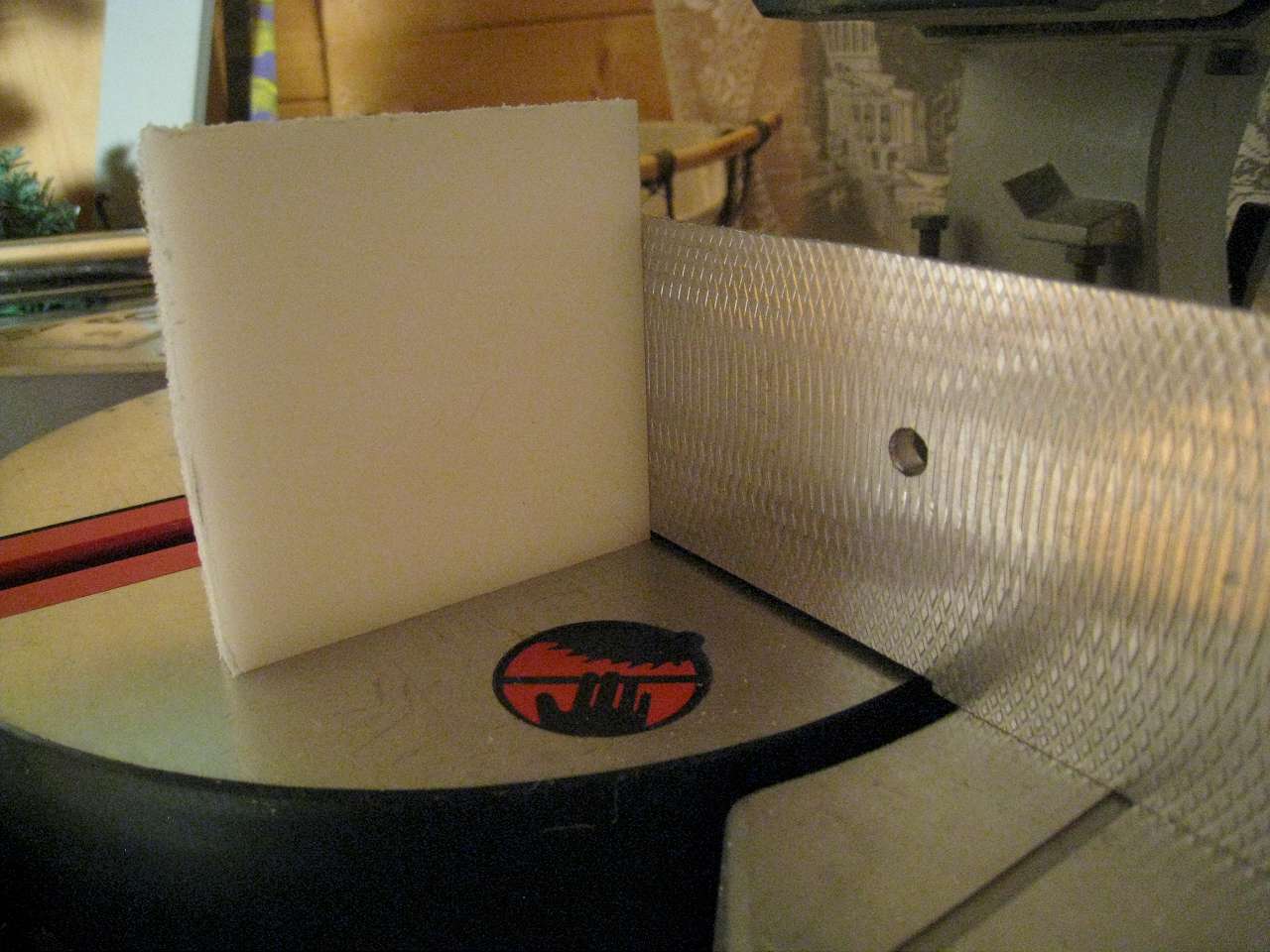

The first thing was to cut from white nylon sheet (thanks Jerzi!) the middle bulkhead to right external dimensions and so that all angles were 90-degrees. I did this with miter saw that I have from our housebuilding project and also with blade that was meant for wood. The machined surface was so much better than I ever expected, it is like factory made :) . In the last picture You can see the temperature in celsius from my mobile phone. I did also cut with same machine and blade carbon fibre (from that mammography machine) siderails. The blade was a bit aggressive and the cottage where I made this was full of flying individual carbon fiber sticks.
1st December 2013 it was time to test first parts to chassis:
It was also time to deside that I do a replica from Jack Johnson's 1989 ROAR nats winning car. All those Proformance Kit proto cars seemed to have small differences in chassis parts and in Jack's car the lightening holes in siderails were squares.

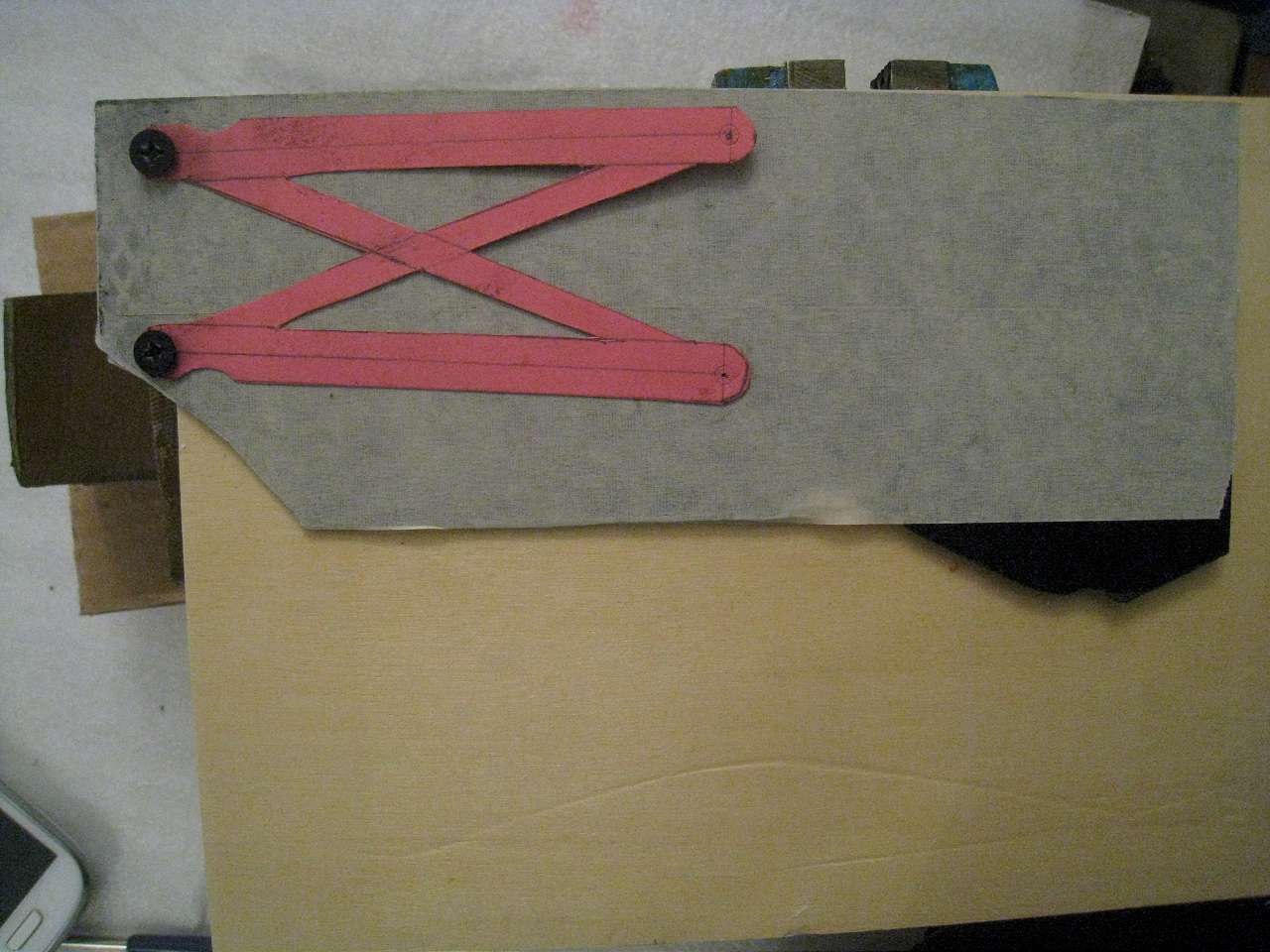

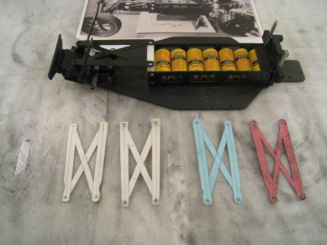

Then I started to do correct looking "X-part". That was so far the hardest thing in this project. I made maybe 6 or something of them before I managed to make one that looked like it should. These two were not good enough:
Then finally the pink from carton one was close enough and I started to cut carbon fibre using it as a model:
The "X-part" started to get it's shape. Only hacksaw and a hand drill was used to get it this far:
Mid January2014 and side rails got their lightening holes:
Side rails are now practically done and so is also the "X-part" except it still needs small curves to rotate front shock tower. Below are some of those "X-part" experiments:

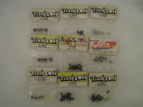

Some progress: I got misc hardware, some to this project some to future Losi project(s).
Those nuts and bolts are not the biggest issue this month but this is:

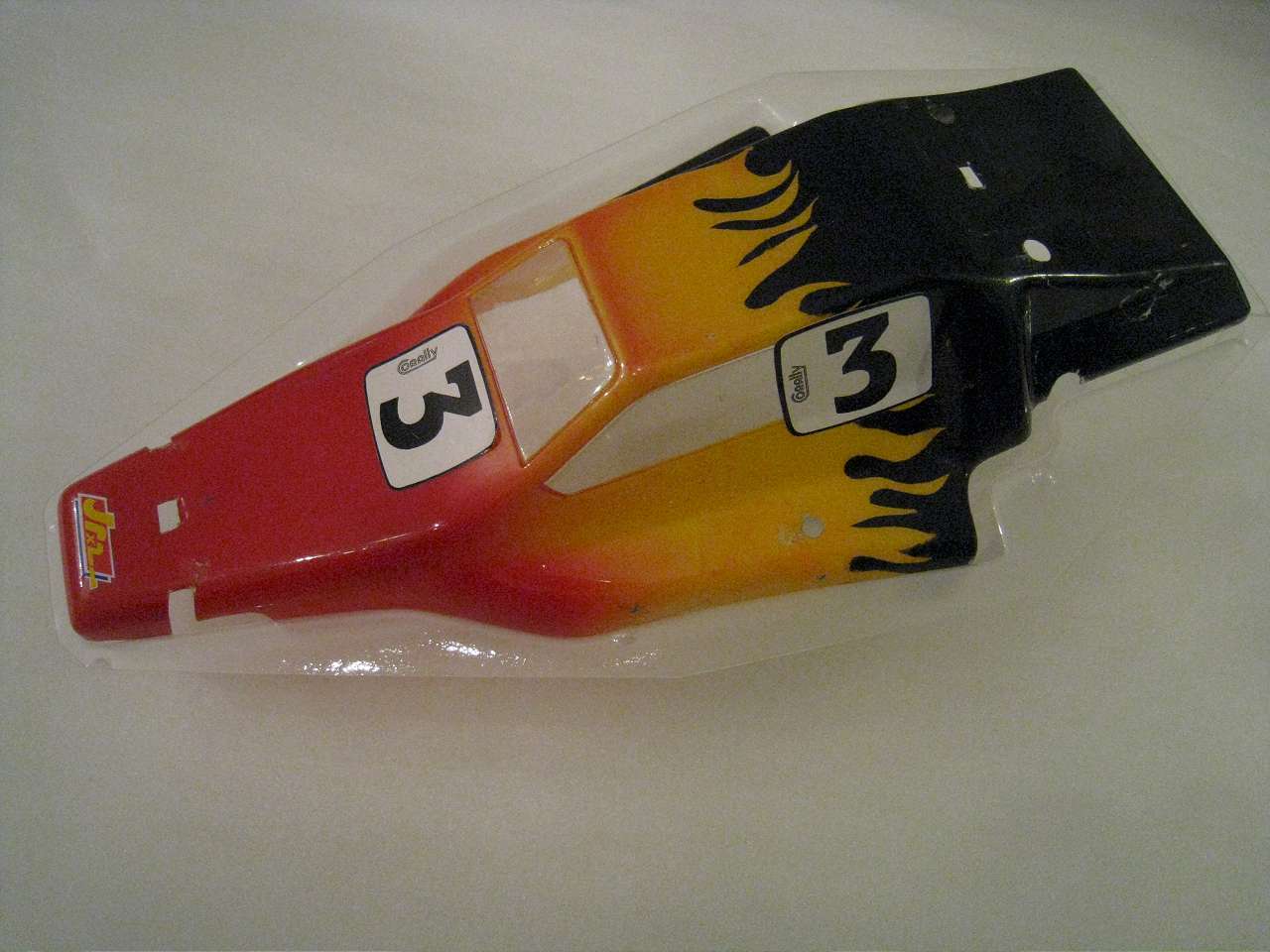

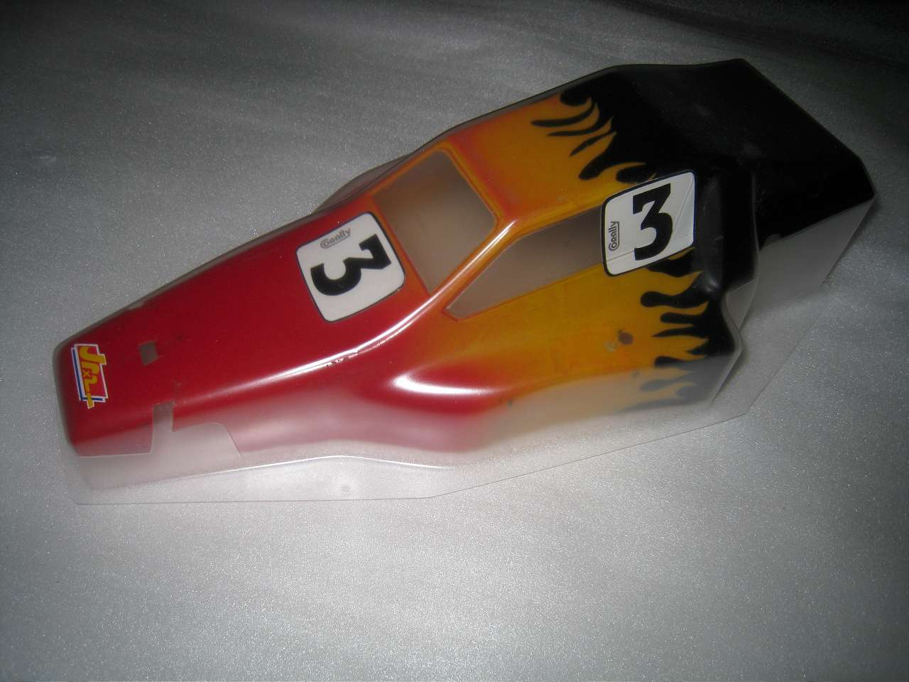

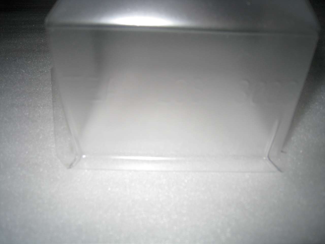

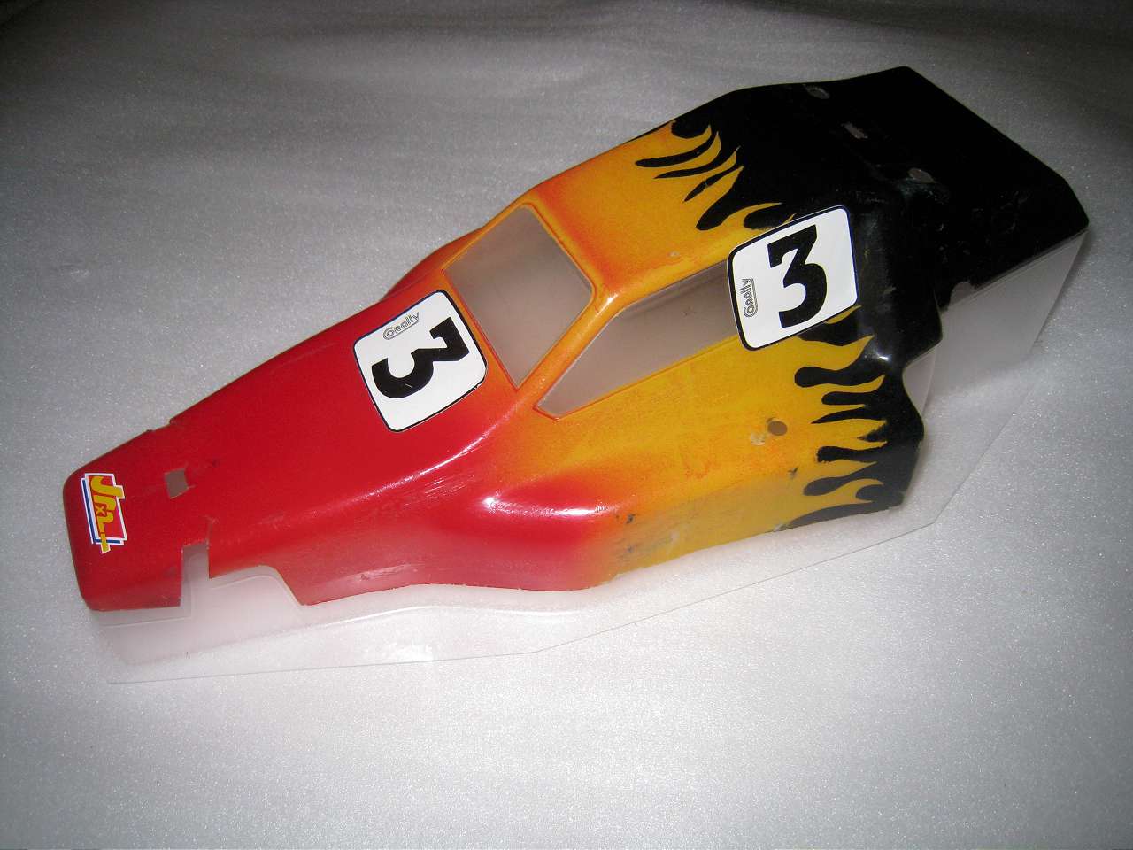

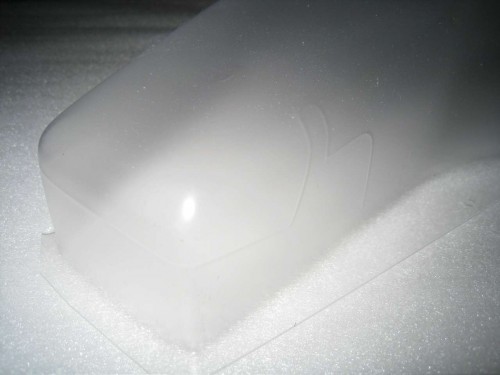

I managed to be the first or second to purchase one of these Jrx2 repro bodies a few weeks ago from ebay that are done with original Jrx2 body and wing molds. The box come with body and wing that both seems to be covered with protection film. There was also window masks and certifigate with Pop Losi's signature that really look like hand written 8) . Next, something exciting: Something about the quality and size of this repro body. First cutting lines and details:
All cutting lines are highly visible as is the text in rear end, much better in real life than in these pictures. I took these pictures with flash light that I found out to be the best method to show them.

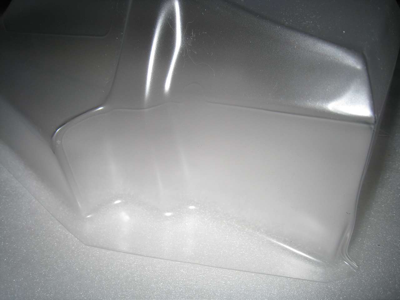

And then to the size question that seems to be always an issue with repro lexan bodies:
Since I have one original Jrx2 body, I did drop it over this repro body to see possible differences. Both bodies are so equal in size that the front nose area of the original body outside did not even fit nicely over repro body. Then the same but opposite way, original inside repro outside:
Bodies does stack this way the same way as they do stack other way around.
And then one test more:
Here the repro shell is upside down and I did put the original shell in to it. They fit nice again.
So I am very pleased with this repro body.

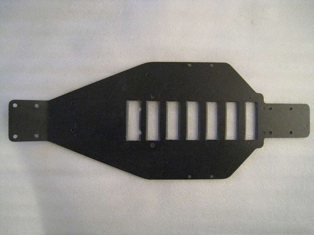

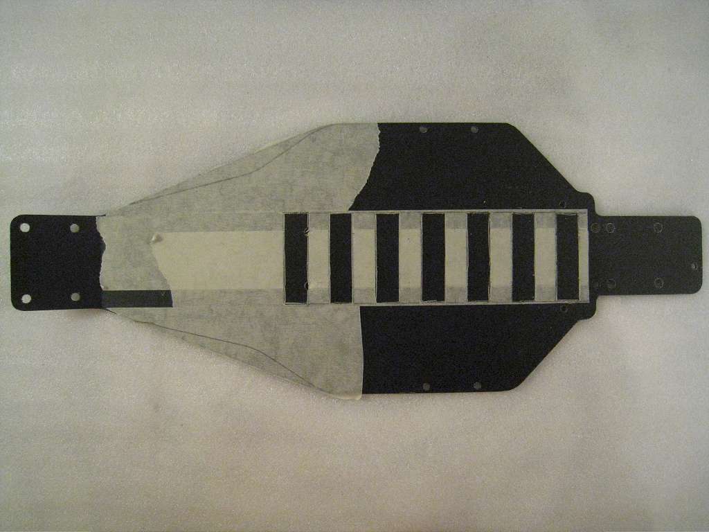

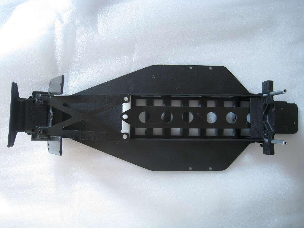

Post by Jirka »

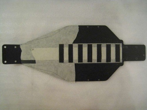

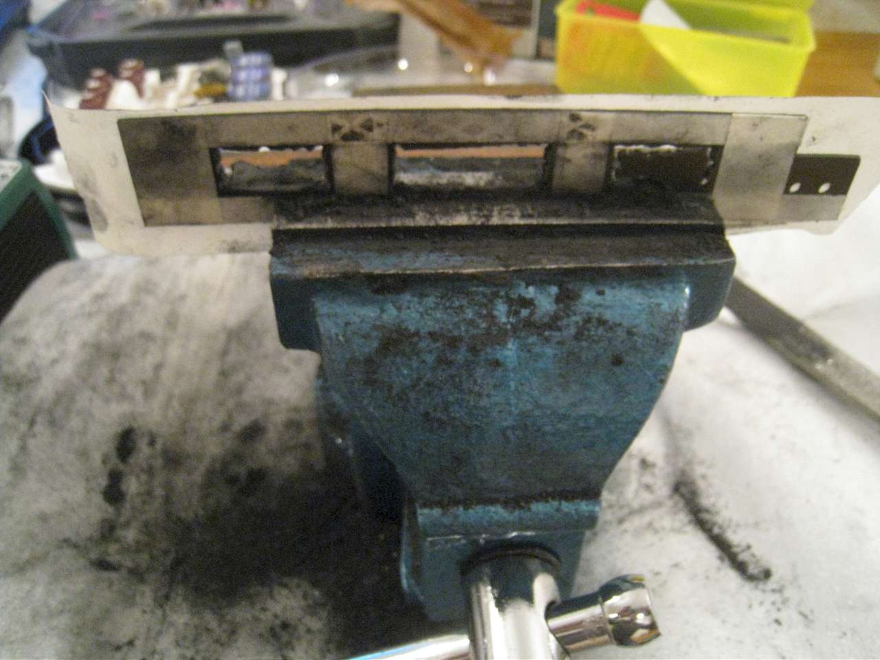

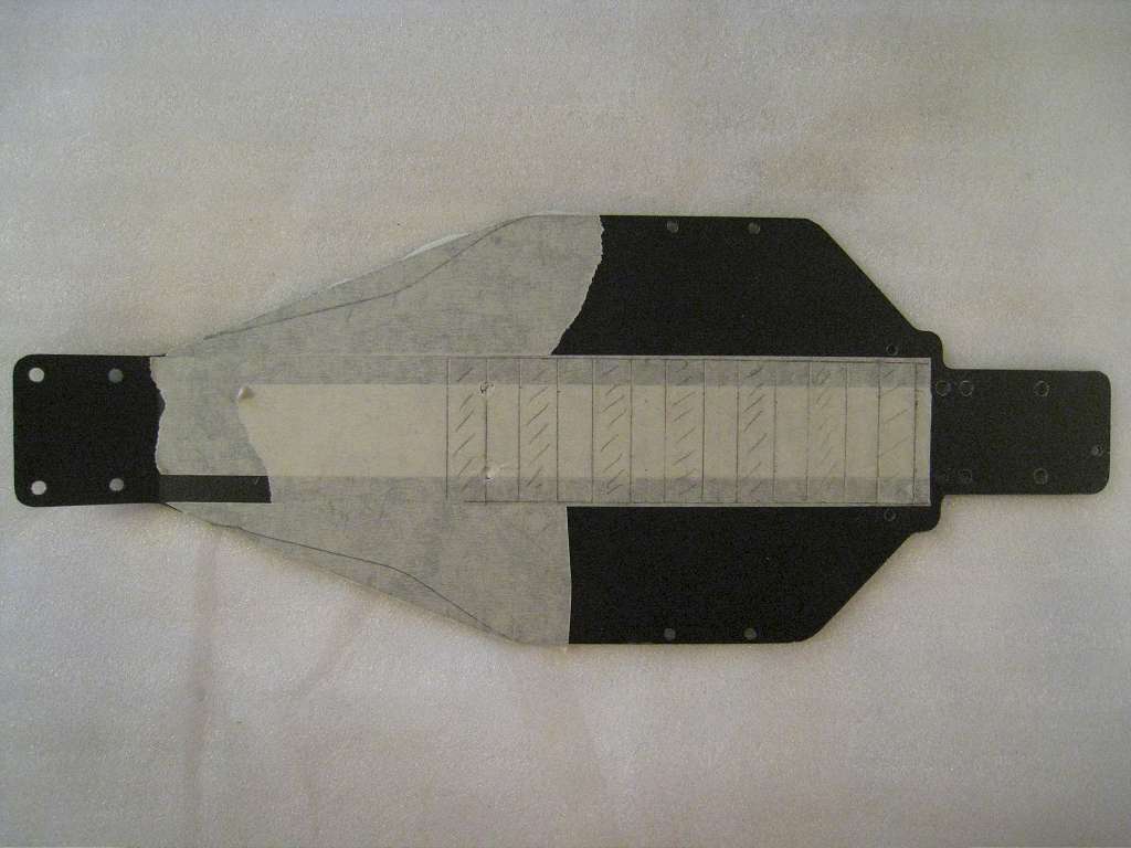

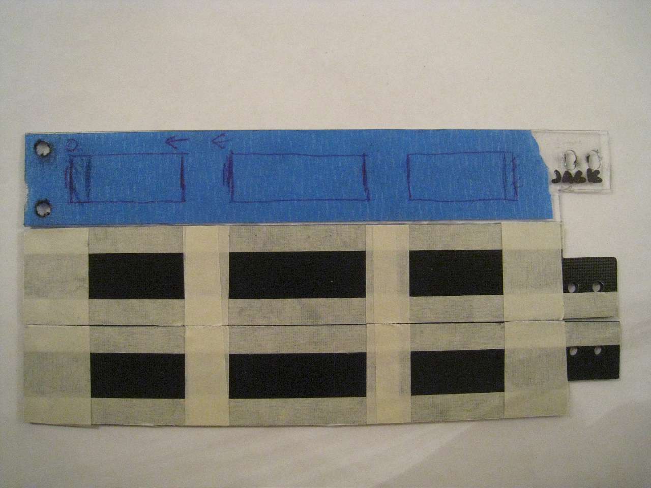

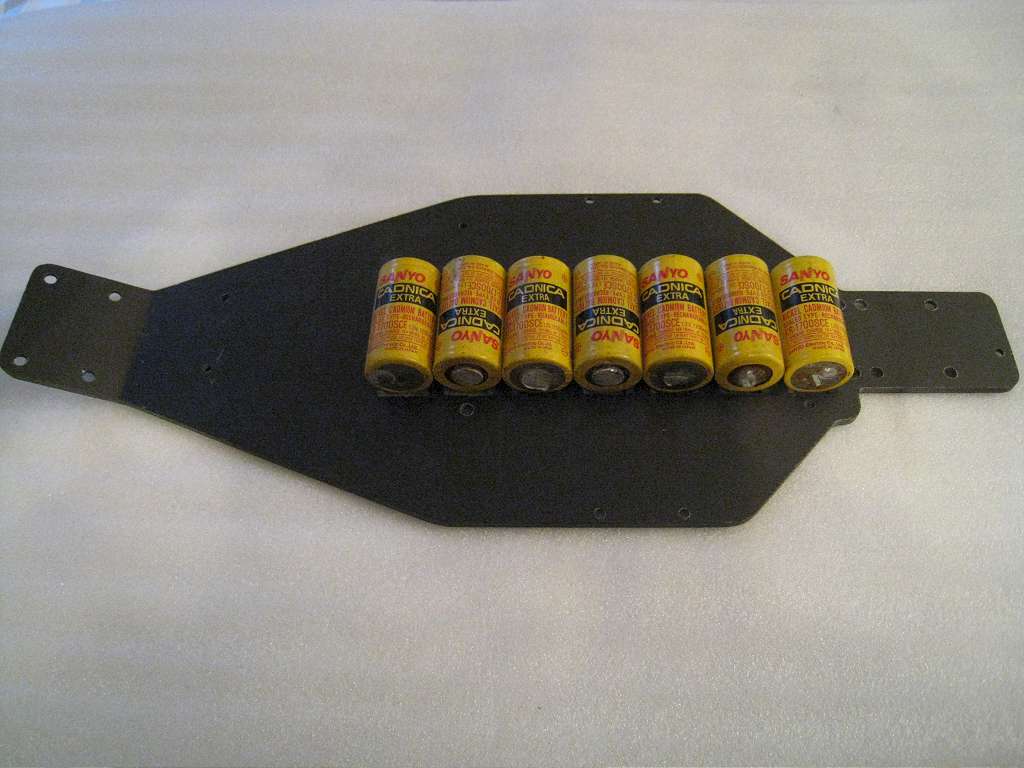

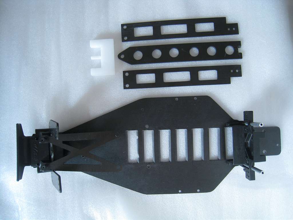

Some progress from last few months:
The cell slots here/below are not done 100% yet, that are a bit too narrow and all not in line:

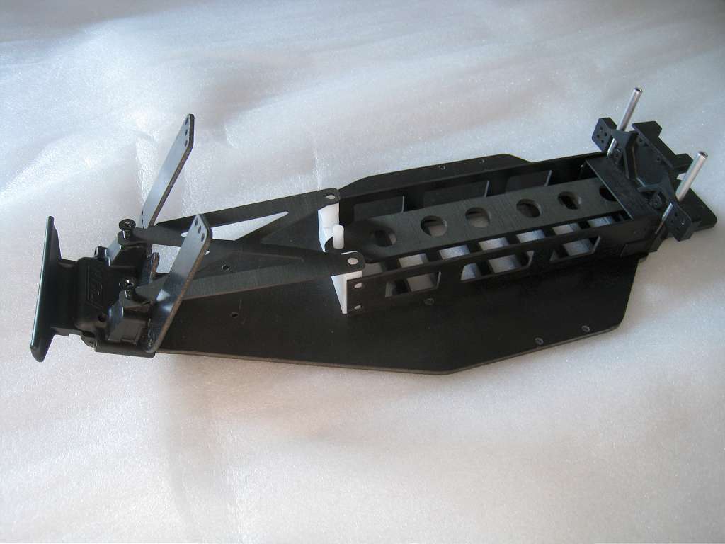

The car looks like this now:
Jirka
Jirka
Posts: 797
Location: Europe
Has thanked: 30 times
Been thanked: 24 times
Re: Jrx2 Proformance Kit proto car from 1989 ROAR nats repli

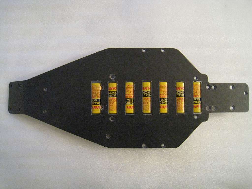

Post by Jirka »

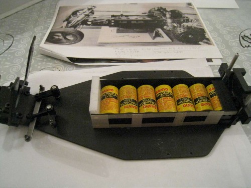

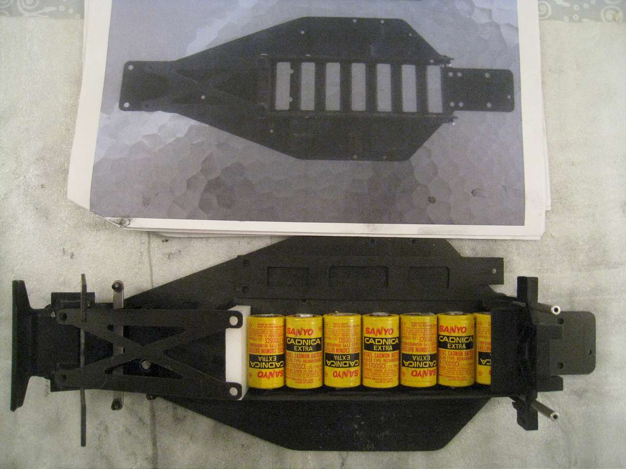

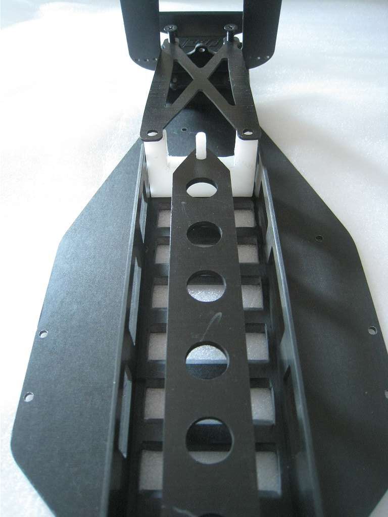

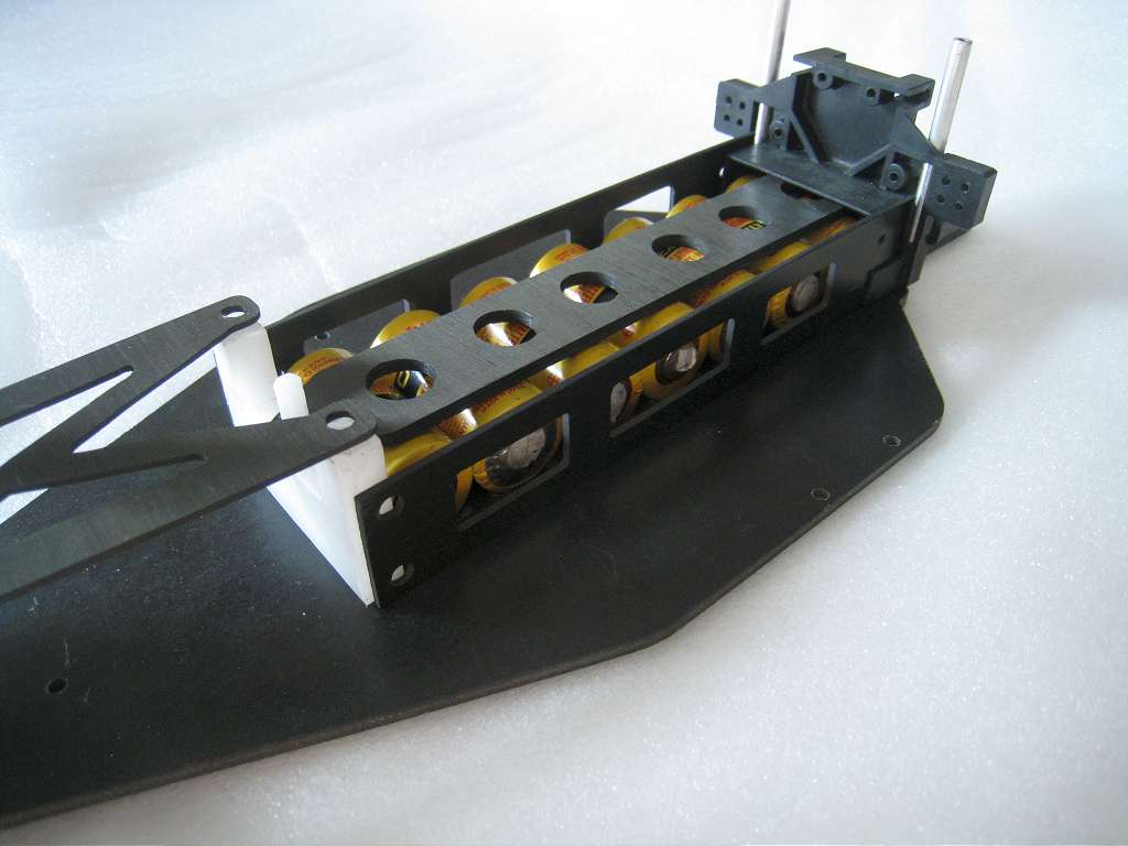

Cells fits really nice between cell slots and the carbon fibre "battery support stick".
Jirka

Post by DerbyDan »
Great updates Jirka & very neat work - those chassis are so difficult to cut/trim or drill neatly!...
You can really see the development work (from the original prototype) that eventually found its way into the production Jr2/Pro SE but in the form of a molded chassis.
