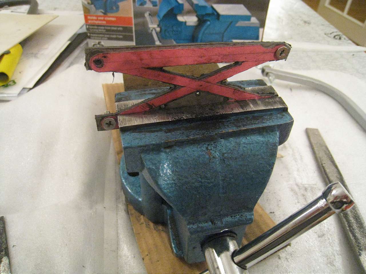

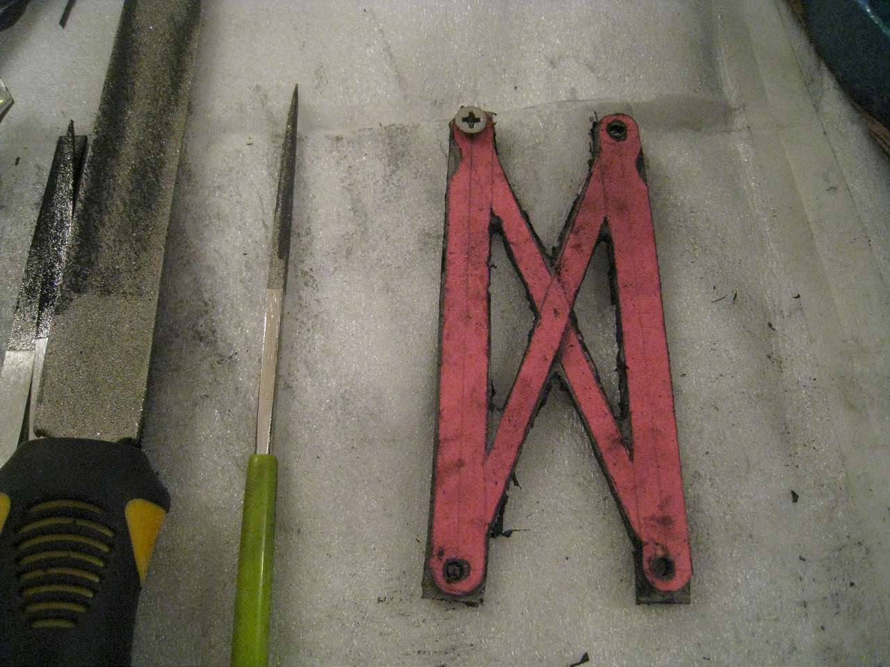

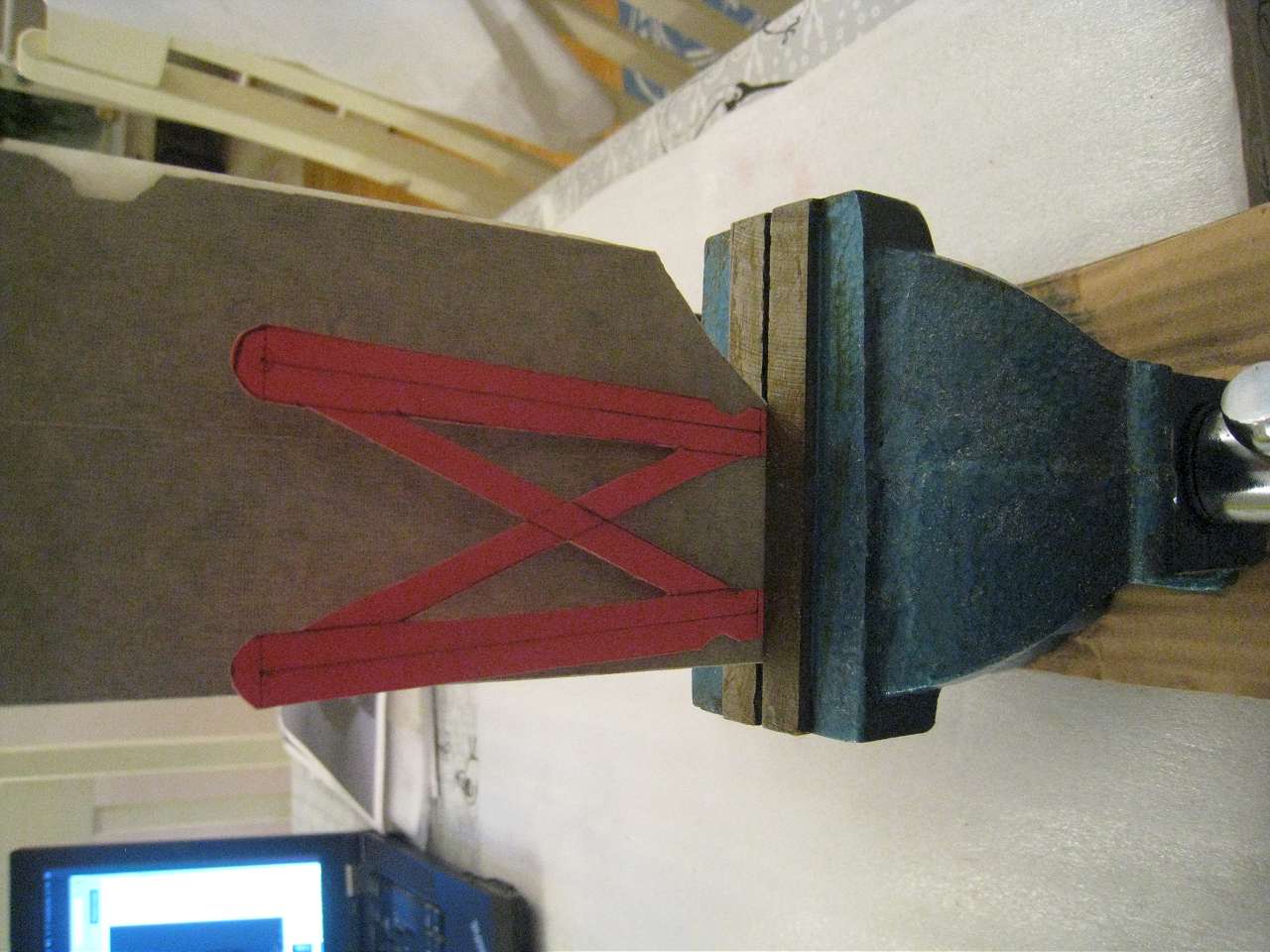

Then I started to do correct looking "X-part". That was so far the hardest thing in this project. I made maybe 6 or something of them before I managed to make one that looked like it should. These two were not good enough:
Then finally the pink from carton one was close enough and I started to cut carbon fibre using it as a model:
The "X-part" started to get it's shape. Only hacksaw and a hand drill was used to get it this far:
