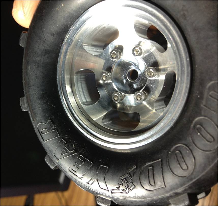

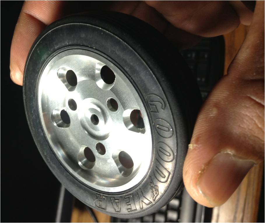

Hi, I am glad you like the resistors and clamps, I had no idea at first what those clamps were for, until I looked closely at the scorpion manual. Man, no matter how beat up a kyosho circuit 1000 series circuit is, it still looks new when cleaned up
I like the assault you have there, thats some cool wing mounts, for me anything vintage like the wing mounts and the vintage alloy wheels are priceless in my book. I cherish these things a lot. These buggies have so much character that you spend hours and hours on them and loads of dollars.
With the ladder chassis, I put them side by side to compare first if they are in line (no bends etc) and than compare the holes, do they match up. I take care of the bends by holding in a vise and pulling the bar or hitting it with a hammer to straighten it.
I guess RC10 tires will fit the 1.55" rims too.
I have gone with GEARHEAD's 1.55" slot wheels - old school design, just love it. Check them out. I did a bit of machining on mine and when I get the courage I will split it into 2 halves so that it will be exactly like the kyosho 2 piece wheels. For the front I have gotten a phoenix wheel, 1.9" I think.

Hi Ronit, nice to hear from you. Your lathe work is always a treat, thanks for sharing.
Been fitting bits you sold me last year but that Assault chassic has been the biggest bonus, the shocks, wheels and tyres alone were worth the price I paid. Put into the that the diff, unwork cups and dogbones, dead straight rails and I'll be able to keep the Beetle (formerly my childhood Scorpion) going for years. Next stage is trimming the original Kyosho shell I bought from a guy in the UK. Been out this morning and bought a brand new scalpel to make sure I do a decent job of it.
