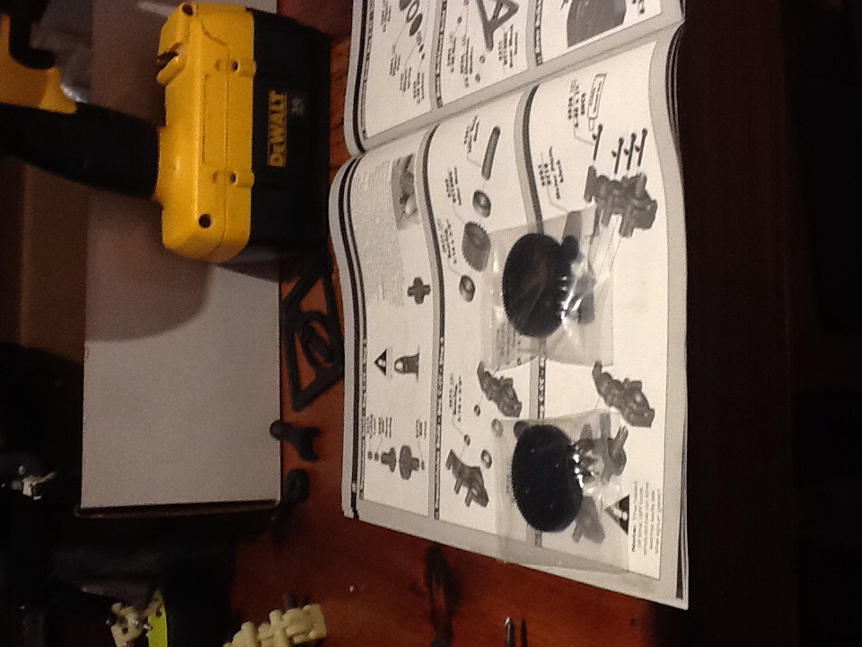

Far out no 4-40x1 inch screws for the diff/ motor plate not happy, thes things are not that easy to get in Australia. On the plus side I did get 2 spur gears. Diff feels tight as well

Have you checked all the bags? Any local hobby shop should be able to get them in, or contact Ace directly.
As for the diff did you fully tighten it and back off 1/8 turn? It will free up slightly the first time you run the car, you can also run it a bit looser as long as it doesn't slip. Just make sure the slipper slips before the diff.

Yeah mate checked all bags managed to rob 3 of the 4 from an old spare parts gold pan, , it's the binding between the gears that is tight, once a couple of packs go through it it will be ok, what part of OZ are you from mate
