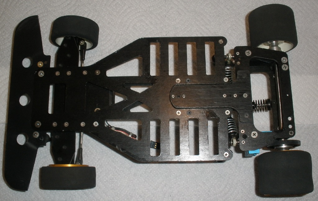

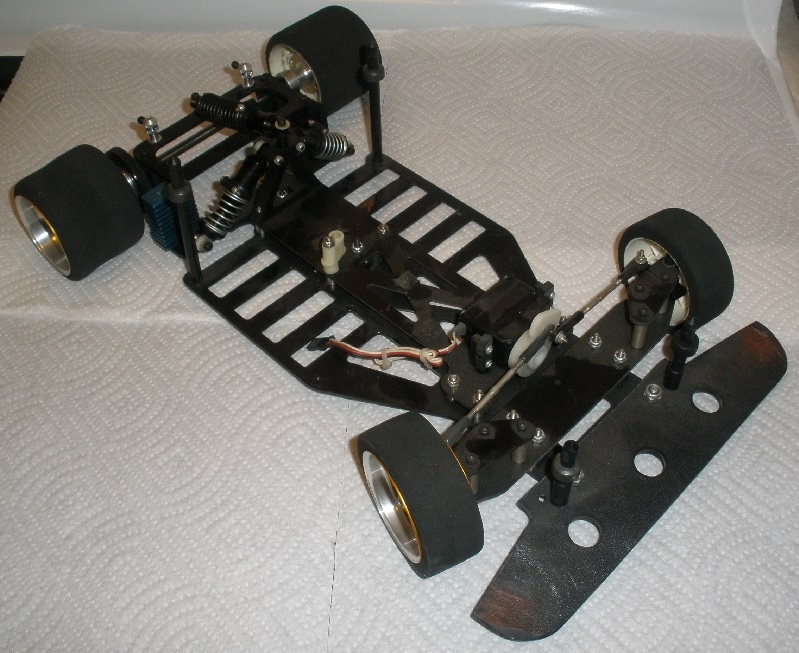

I just received this eBay score this afternoon...of course, the Sees wheels were what immediately caught my attention, even though it appeared that only one side of wheels was included. I wasn't familiar with the chassis, the front end & 3-shock setup in the rear wasn't like anything else I'd seen; the graphite chassis and the blue LiteSink all led me to believe this was no entry-level pan car, so I pulled the trigger on the $50 BIN. It turns out to be a Lucas/Advanced Racing Technologies Agitator, Pro 10 chassis from around 1988. (Thanks to Phin for helping with the chassis I.D.)
I was amazed to see the chassis and wheels were in such good condition! The bottom of the graphite chassis looks to never have been run; there's not a scratch to be found; the only part with the expected scuffs & scrapes is the T-bar. The wheels (plastic and aluminum) haven't the slightest curb rash or dings. The plastic wheels were glued but fortunately not the Sees. But what's the deal with having only one side of wheels? I could understand having a front pair or a rear pair without the other, but who ends up with just one side of wheels??
I find many intriguing design details with this chassis; the tri-shock setup really functions well, and the bulkhead is machined Delrin. The shocks themselves, although black, could be Kyosho Gold clones, the caps and bodies look identical. I'll know more about that once I've disassembled them and checked out the O-ring situation. The front end design is also pretty cool, the suspension here also works very smoothly. I'm not sure how camber is adjusted, though...I'm guessing by changing the 2 blocks underneath the steering plate? This looks to be a very nicely engineered, well-built chassis...a minimalistic but effective design. It looks like it'll be a breeze to restore.
One issue I can see, however, is there is some kind of black or clear stuff painted all over the main chassis plate, most noticeably around the battery slots...possibly to prevent shorting out the electrics, as graphite is conductive?
The body looks great too, the paint job is pretty sweet...it's reminiscent of some Andy's-painted bodies I've seen, but the only signature is "Dennis Fox". "Fox" was also written on the inside of the plastic rear wheel. Anybody happen to know who he might be? The body has some cracking issues unfortunately, both front wheel-wells are cracked and repaired on the inside with clear yellow cement of some sort. I was hoping to mount an HPI DeTomaso Pantera body on this chassis; the wheelbase looks right, but the track width of the car looks to be much too wide for the HPI VTA vintage car bodies.

nah, they're sees wheels. my guess for the singles wheels, if it was a shelfer, maybe the guy used the other 2 for display purposes on another car.
you can't adjust camber up front, but castor is adjusted by loosening the front mounting screws and tightening the rear ones more. if you take the car apart, you will see that the front beam rides on this pivoting 2 piece setup and see how it functions.
touring bodies will definitely not fit. even with some old, wide pan car bodies the rear tires would stick out of the wheel wells. i used to run narrow offset twinn-k wheels on mine, or i would just narrow up 2" wheel.
nice looking car for $50.

Shocks are reano'd Duratrax. I think it was Y'ernat Al that did a dissaembly on them. In the RCCA ads the shocks still had the gold color.
Camber was adjusted by bending the axle in the steering knuckle. Obviously a crappy way to make a suspension adjustment but at the time most cars were using fixed or beam front ends that dealt with the same issue. The Agitator front end could hold it's caster adjustment better than beam front ends though.

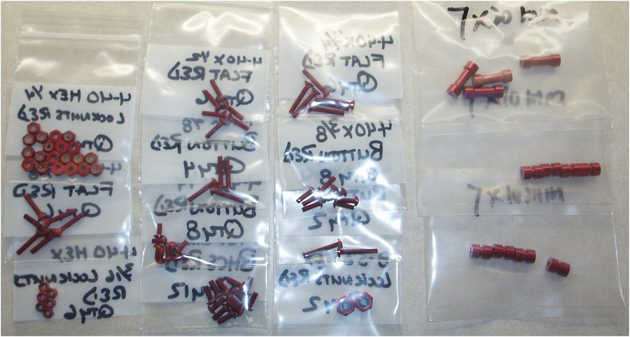

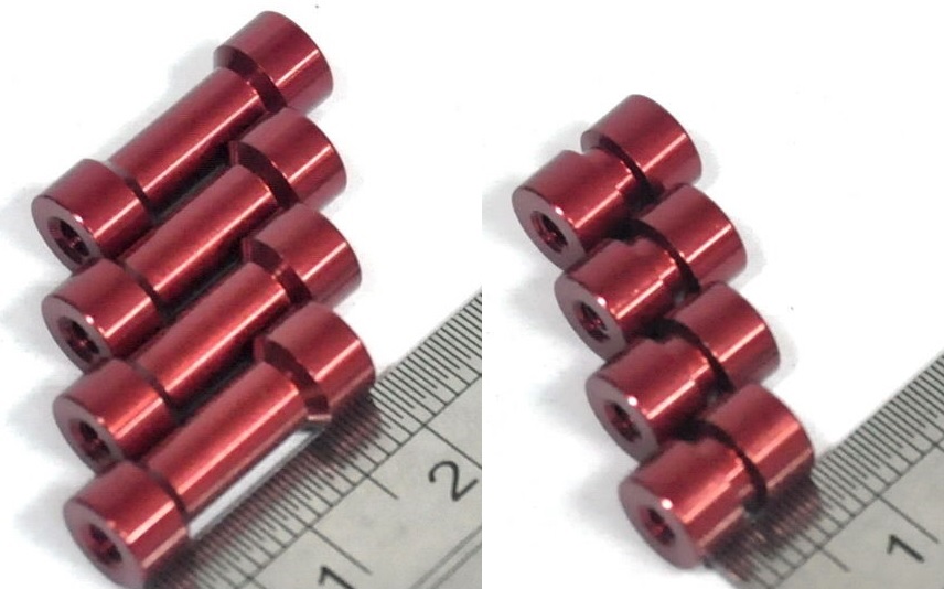

I figure this car is too sweet to simply restore (in its current condition, all it really needs is a clean-up). Dusting it off and calling 'er done just isn't how I do things; too boring. The chassis design is quite simple and I came up with a few ideas about how to spice it up--with a little cayenne pepper and Tabasco sauce! This car deserves more than just a cleaning.
So the recipe calls for--
Tabasco: The 6 front end spacers and 8 chassis spacers will be replaced with these: Cayenne: I went through almost every nut & bolt on the car and will be replacing almost everything with red anodized aluminum hex-head screws & lock-nuts. This will replace the Philips-headed screws, because I hate their tendency to strip & round out in the heads, and aluminum won't rust. I put in a custom order at Fastener Express for $29 shipped for a nice sprinkling of cayenne pepper.

I received my aluminum dress-up goodies while I was away on vacation. Now I can't wait to tear the car down, clean up everything and dress it up with these spicy little devils.
