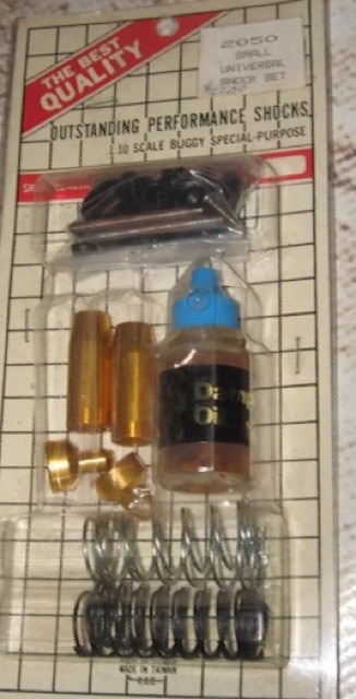

Yup- I actually assembled it to see how it would go- plastics had tons of flashing. The shaft looks kyosho and the body as well, the shock clamp has a weird tab on it tho, and the screw isn't kyosho. It looks like a kyosho but not quality of one. Has a larger diaphram than the duratrax too. The body was deep enough for an oring>thick spacer>oring>thin spacer>clip. I am thinking these may have been a knock off gold shock? Like these

Very interesting! Maybe Coel can chime in on how many o-rings were in his Agitator but another member said there was only one o-ring in the shocks in his Agitator.
In the old ads for the Agitator the shocks on the car weren't ano'd black but they were black and white ads so there's no telling if the shocks were the color of gold shocks, duratrax shocks, or something else. "The Best Quality" was Great Vigor's slogan wasn't it....could they be Beagle shocks :?:
The Agitator borrowed parts from Delta, Associated, and Litesink so I really don't see them having their own shocks machined.

Oh good thought on the beagle shocks, that would make sense. The quality of the piece looks about right- for example the flashing and type of plastic. Its not glossy and smooth like a kyosho/duratrax

Phin wrote:Very interesting! Maybe Coel can chime in on how many o-rings were in his Agitator but another member said there was only one o-ring in the shocks in his Agitator.
I have my 3 shocks disassembled, I'll get back to you on that, and will edit this post once I've confirmed the number of O-rings.
I de-anodized the shock bodies and they have that high polish that the Duratrax shocks had; Kyosho Golds have more of a satiny semi-gloss finish under the ano.

Did some googling..."The Best Quality" was actually Blue Bird's catch phrase and the shocks look more like they could've come off a Growler instead of a Beagle. Beagle shocks look more like bottom load Kyosho or Losi shocks.

I've got a bag full of those shocks. Admittedly a small bag but several nevertheless. I've got a set new in pack like that too. I have no idea what they are from.
